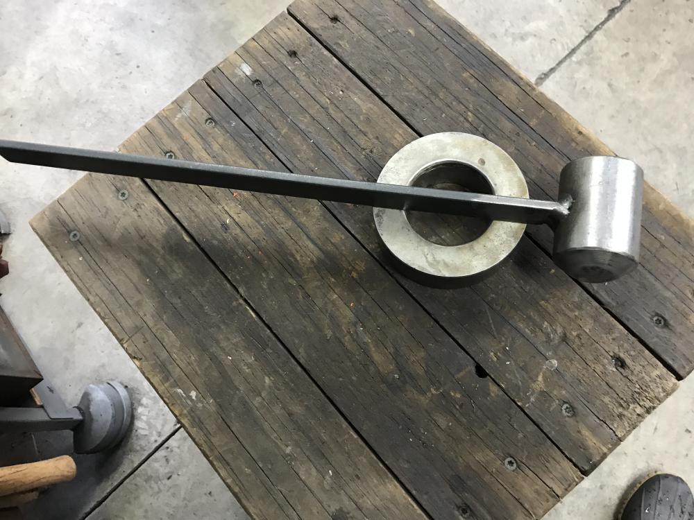

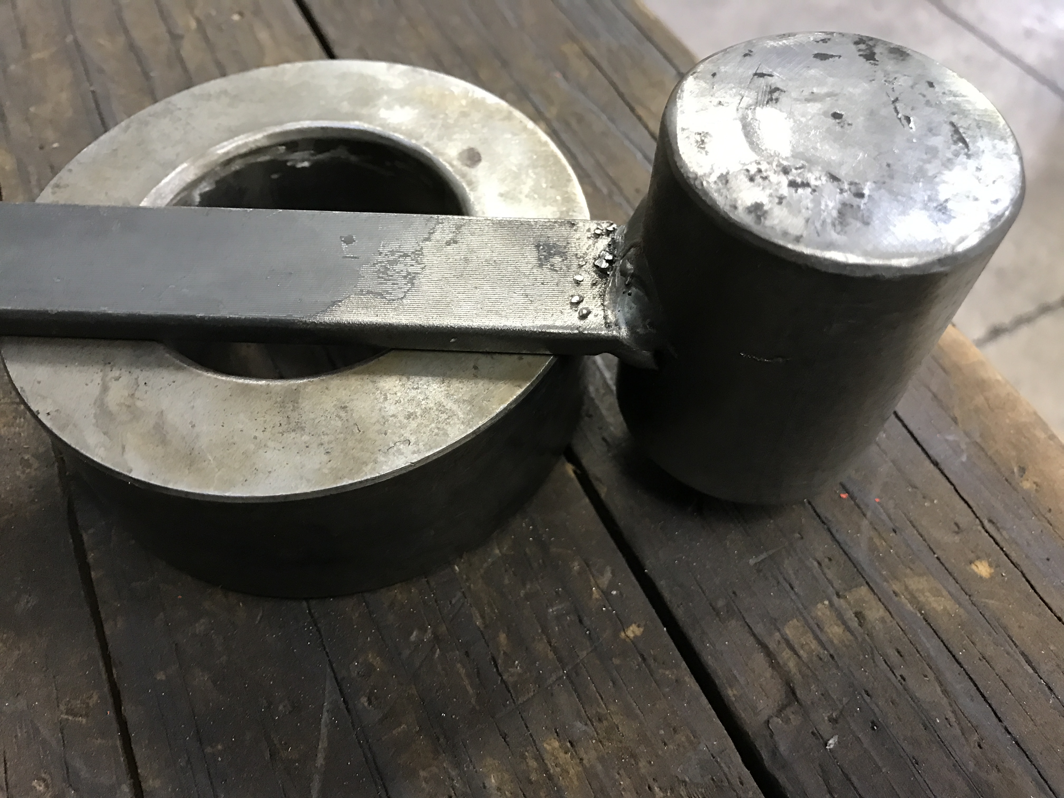

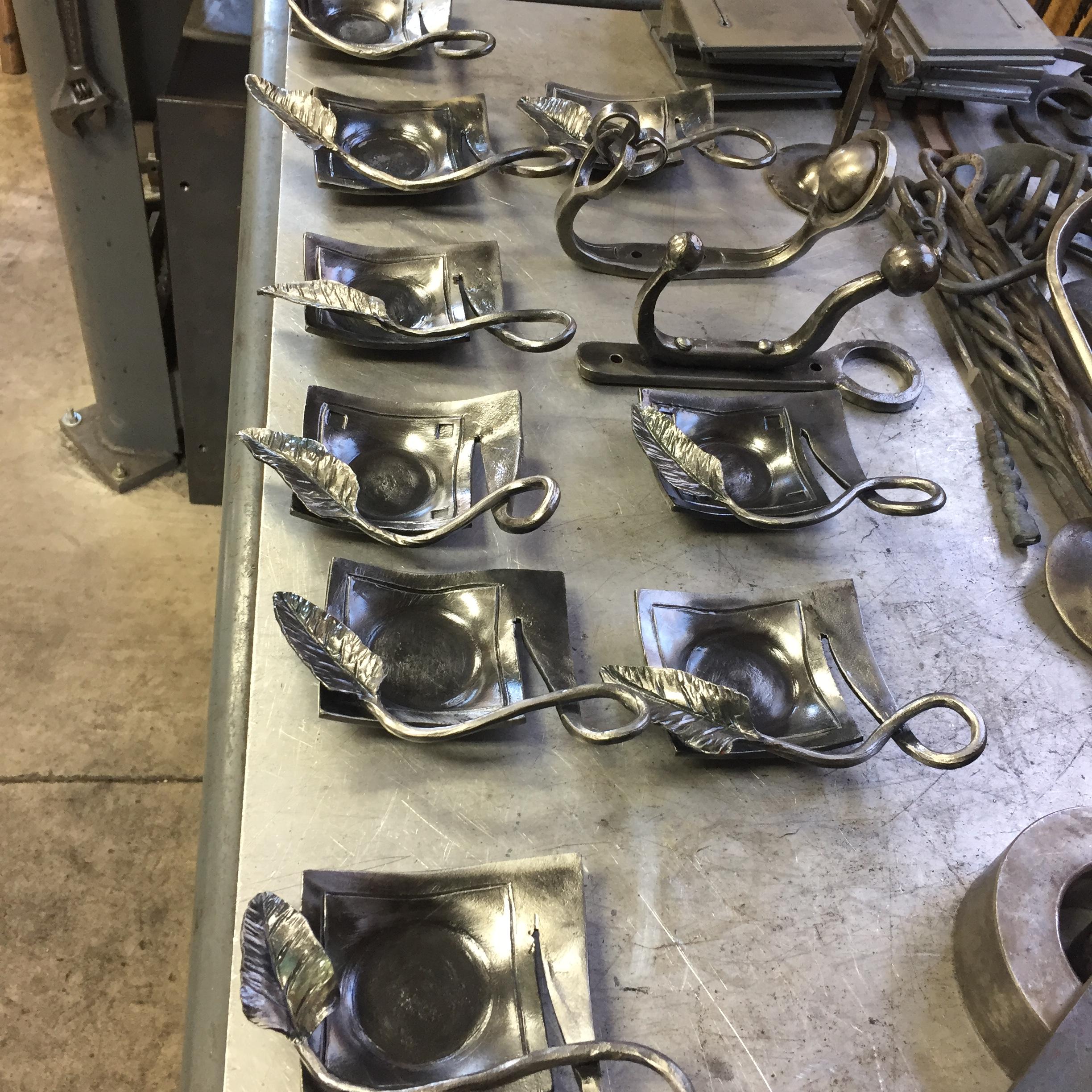

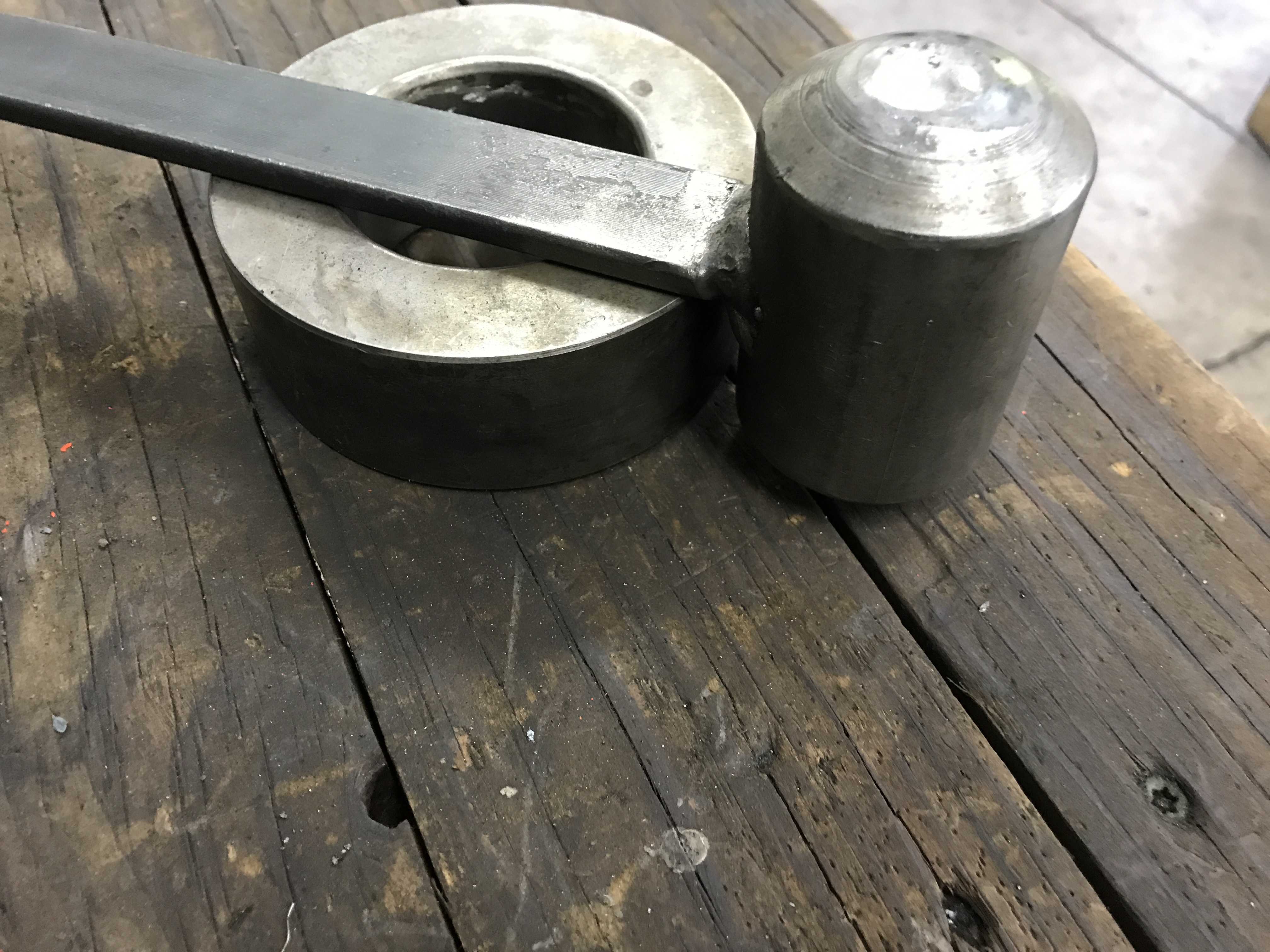

Greetings Gergely, I have been known to use my fly press to control the debth of the squish with the tools. My treadle hammer also works quite well. I taught a friend how to make them and at his last demo / sale he sold out at 40 bucks each.. Forge on and make beautiful things Jim -
Jim Coke replied to Mark Ling's topic in Blacksmithing, General Discussion
That depends on the candles you intend to use.. Most like the little frameless battery powered ones.. The ring is based on how much edge you want on the flat stock. They are fun to make so have a ball. -
Greetings Zero /JHCC, Da tools to get the job done easy. One smack with the rounded end down on the ring than flat end down on the anvil. I have made many.. Forge on and make beautiful things Jim -
