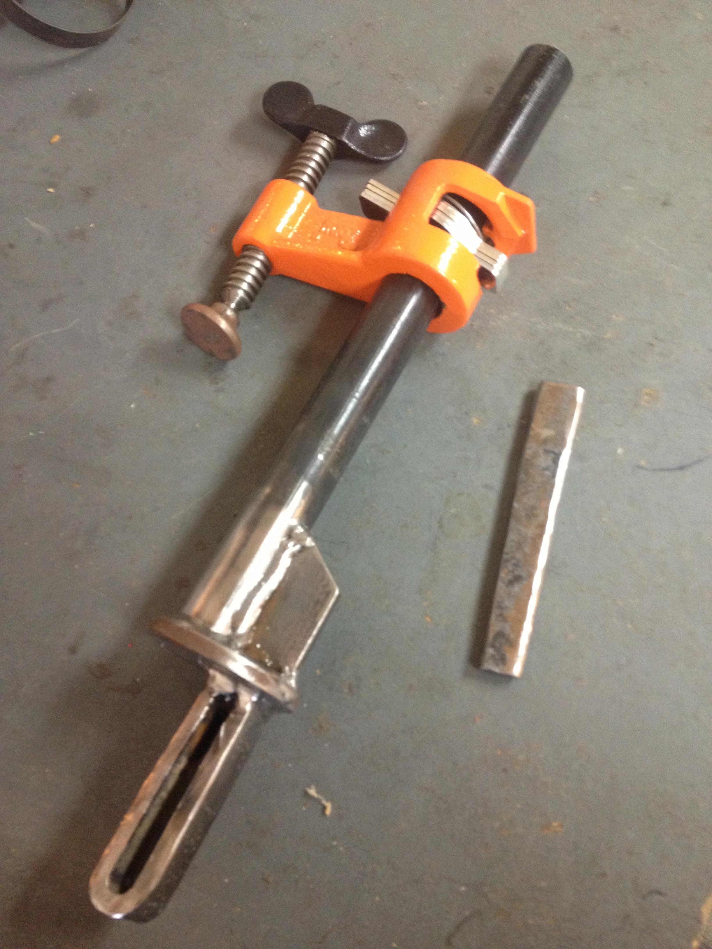

  12. Greetings Redsmith, As Frank mentioned the easy way to make the tool is to bend over a flat bar stock than weld in side pieces to match your tennon. I still have the ones that I made years ago. Have fun... Forge on and make beautiful things Jim

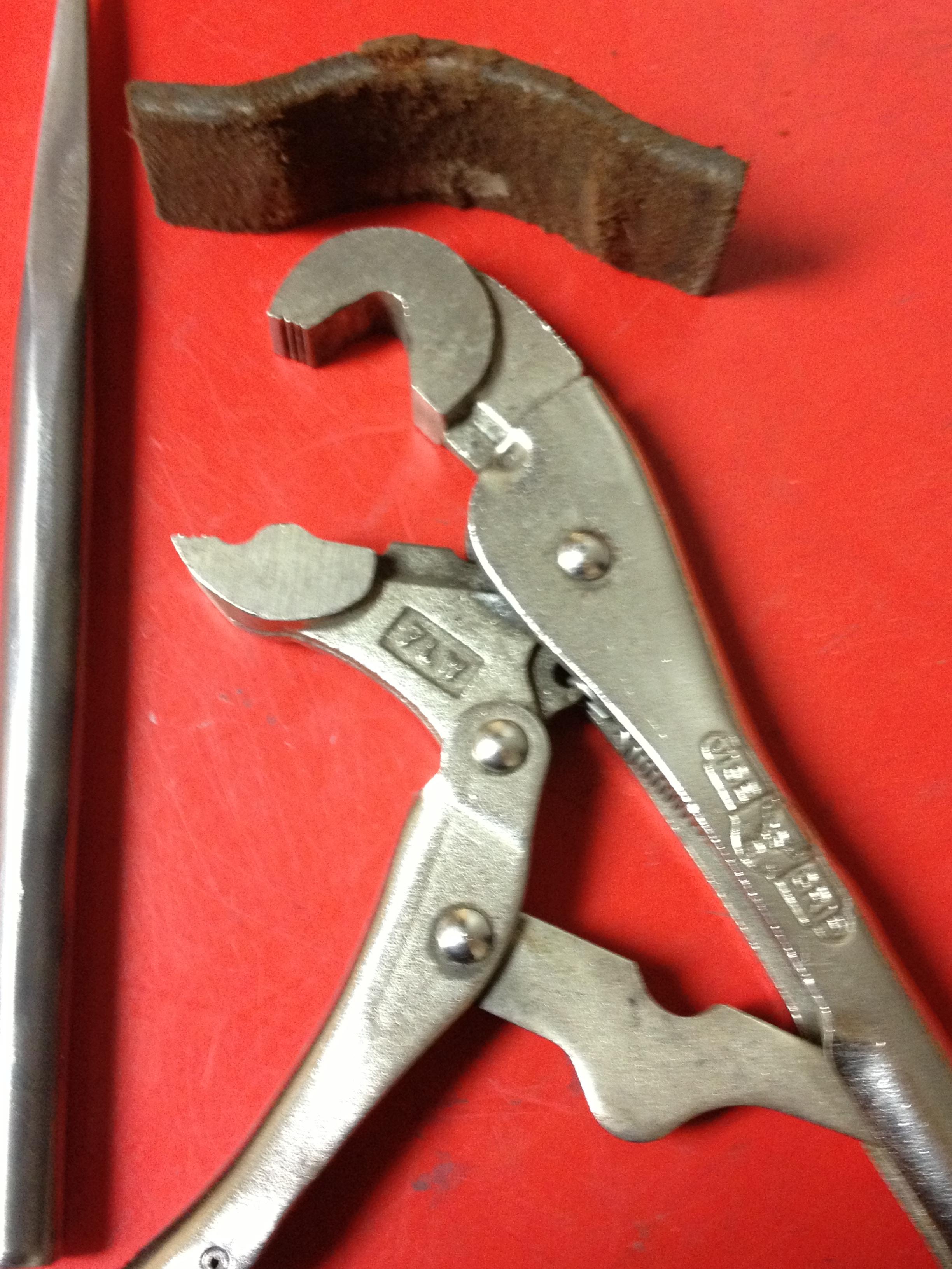

  20. The second is a lineman’s wire crimping tool .. I have two and they work great for holding small round stock bending .. also rivet trimming FORGE ON AND MAKE BEAUTIFUL THINGS Jim

  25. Greetings Biker.. Your Hardy tool problem with 1/4 x1 stock .. You can flatten you stock to 1-1/4 and form a loop 1- 1/4 wide to fit your hardy than weld it to the base of your tool. To work with short chisels and punches with hot metal wrap a chunk of leather around the chisel and pinch it with a pair of vise grips .. ( instant holder) I have done this for years and it works quite well. Forge on and make beautiful things Jim
