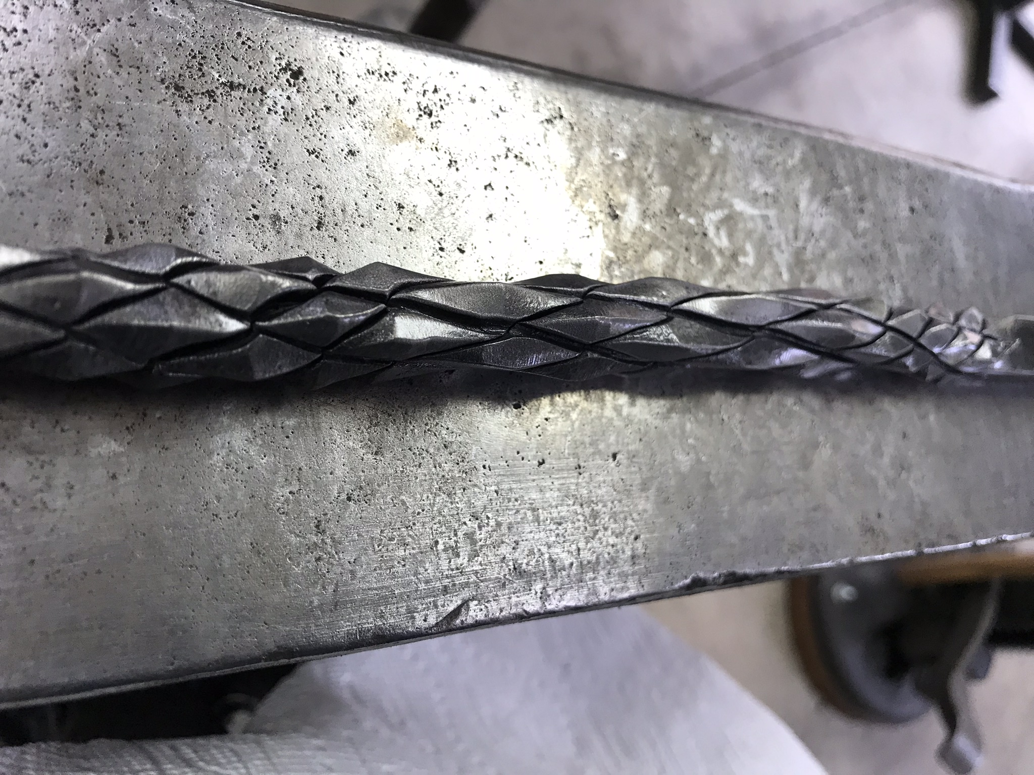

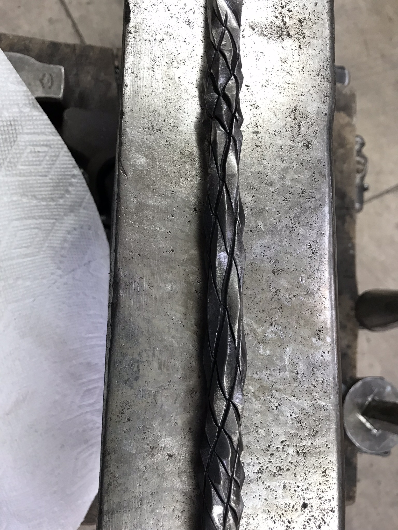

  15. Greetings all, I spent a little time at the forge today on our first snowy day in northern Michigan. I staggered the twist on a pineapple twist to a new look. The yield was larger diamonds in the center and smaller on the ends.. Kinda cool.. Great for a handle where you want a smother section for a easier hand grip.. Have fun... Forge on and make beautiful things Jim
