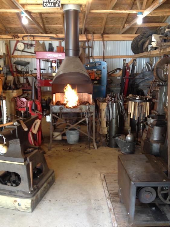

Greetings Seldom, I have been using the old wheel style hanger for years. I decided to convert it to a hammer rack and come up with a rack for my most used tongs. I found a large diameter steel tube , welded a few 1/2 in round bars across the center . Both work very well. I have another rack behind those two for less used tongs and hammers. Ahh the good old wheel has many possibilities.. Forge on and make beautiful things Jim

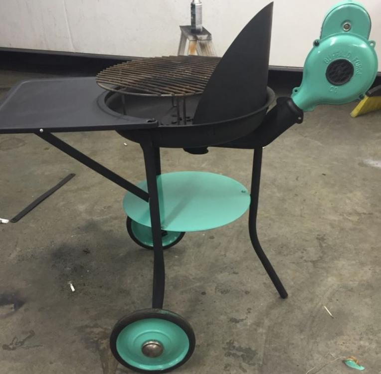

Frosty, Another picture.. They even made a smaller version for camping. I have one and the main difference is there is no ash dump. Forge on and make beautiful things Jim
