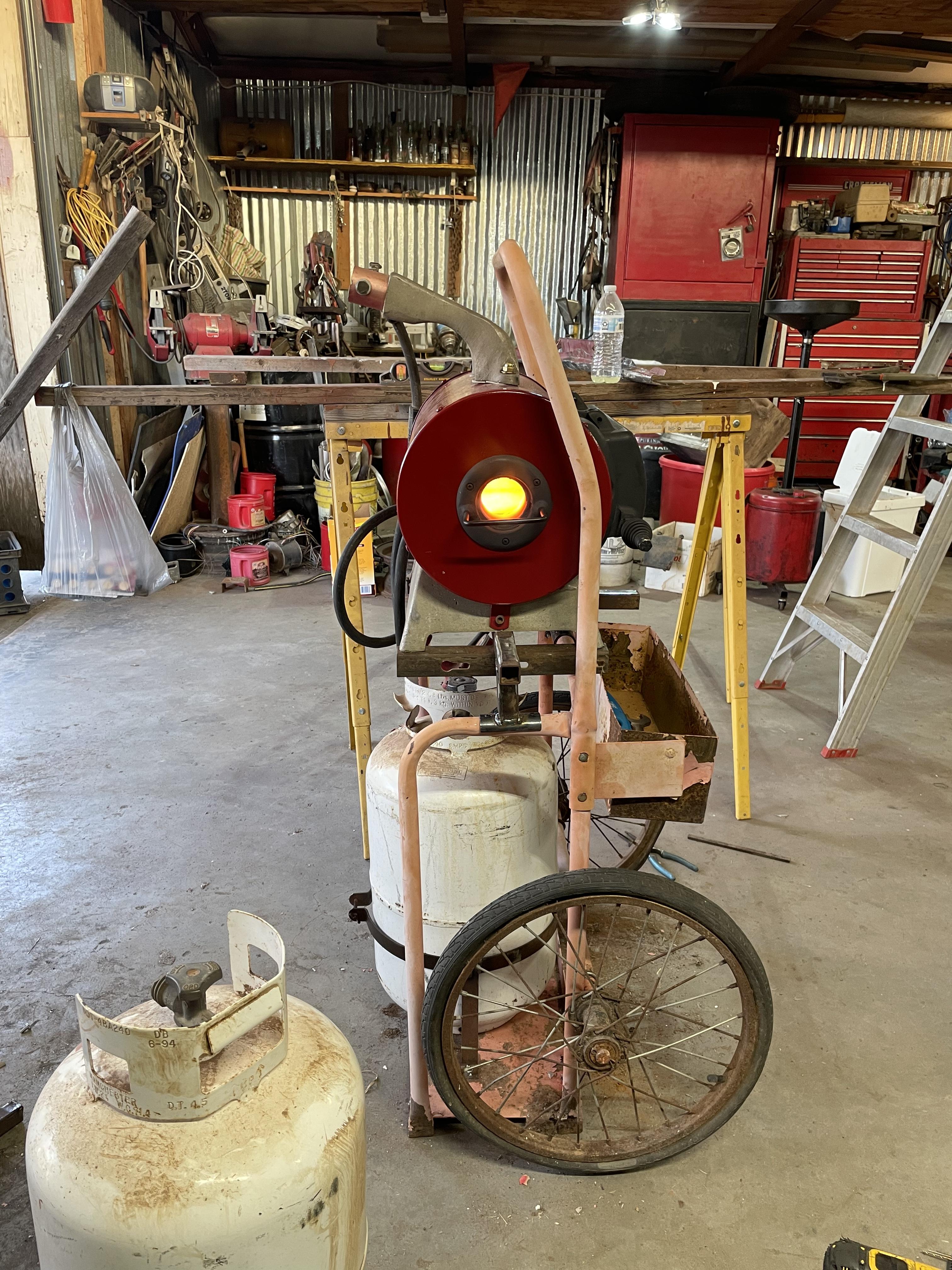

Mounted the rebuilt Pro-forge on an old oxy/acetylene bottle cart and fired it up.
in the  background is the old Samurai waiting parts and body work after hitting a deer.

That looks really good Charles, it shouldn't take much effort to load it with enough handy tools you won't be able to move it. B)

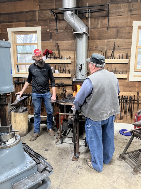

Had our chapter of the IBA’s hammer-in today at my place:D31D9645-5740-4C02-B595-646204FE7A90.jpeg.9cfff4348eda973e707152126d69b929.jpeg
(last pic is of Josh, an IFI member, setting a weld on a rasp tomahawk with the power hammer.)
Probably hand around 30 in attendance and I’m pretty sure everyone had a good time. I know I enjoyed it, and no one should have left hungry!

Everything is so clean!

John, it took me weeks of rack building, organizing, and hours of running the shop vac to get it that way! (Just don’t look in any draws or cabinets!)
If I keep hosting a hammer-in annually, hopefully it will keep me from letting it get out of control…

Goods, nice shop and it looks like everyone was having fun

Goods, looks like a good time. I wish my shop was like that. 3 people and it is pretty crowded. Hold these pretty often and your cleanliness problem will solve itself. I have noticed that people, especially myself, are much more inclined to put it back where it came from when they are at someone else's shop.

Looked like a good meeting David, were the members as nervous about maybe getting your shop dirty as I would've been? What's that old saying about a clean desk? :P
