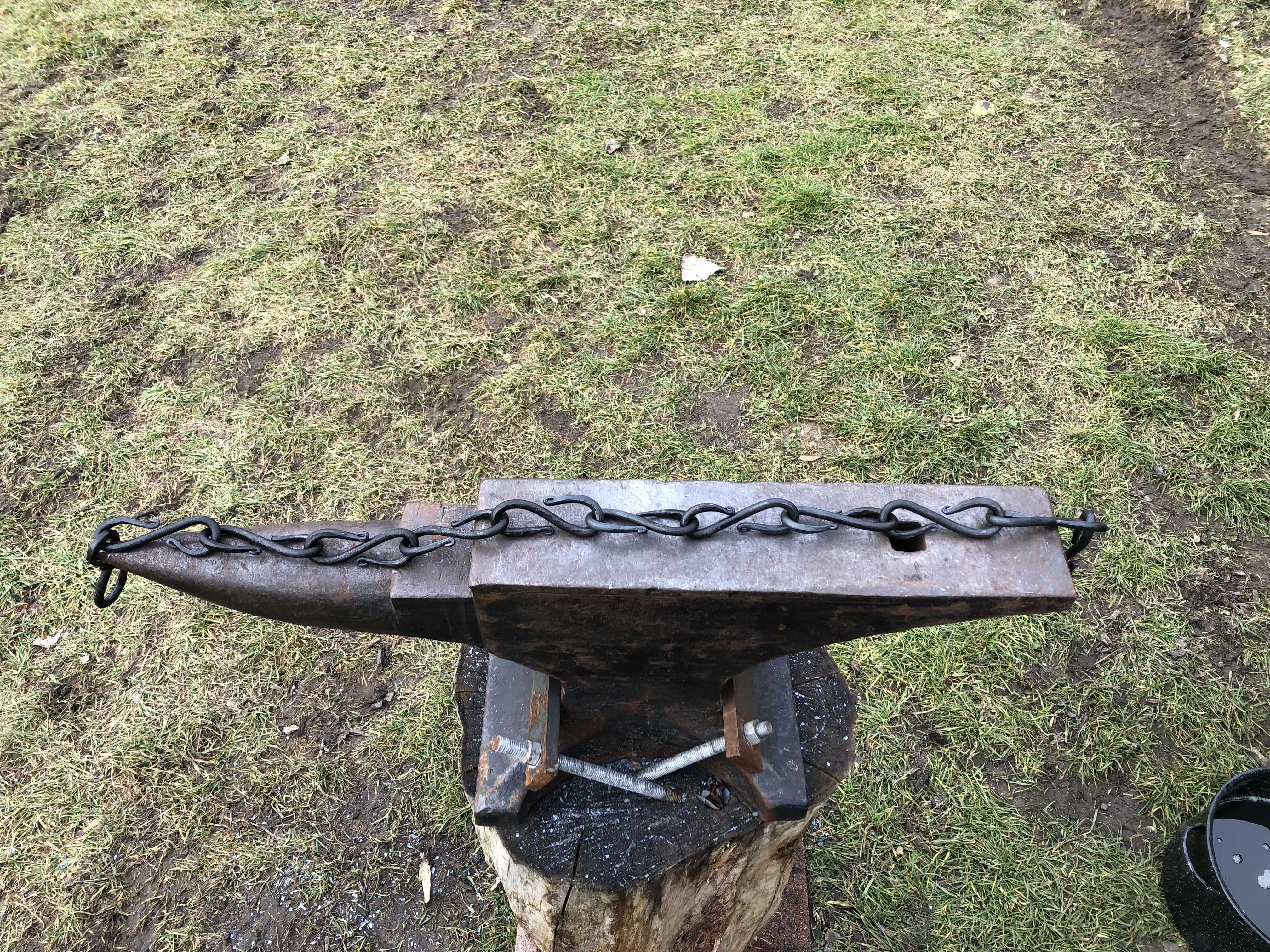

12 links in an hour. Very happy with my work, and even better, my wife is very impressed!! Now, what to use it for…maybe the beginning of a never ending chain?
“‘I wear the chain I forged in life,’ replied the Ghost. ‘I made it link by link, and yard by yard; I girded it on of my own free will, and of my own free will I wore it.’”
Sweet chain Will!!!
maybe hang some bird feeders or wind chimes?

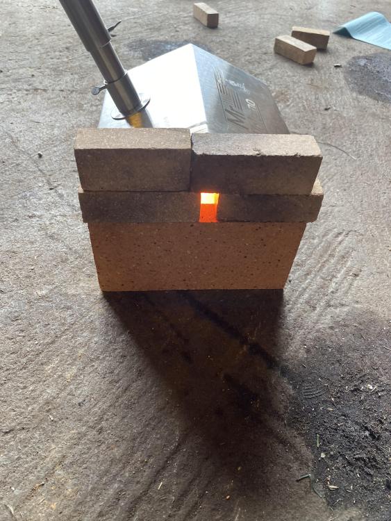

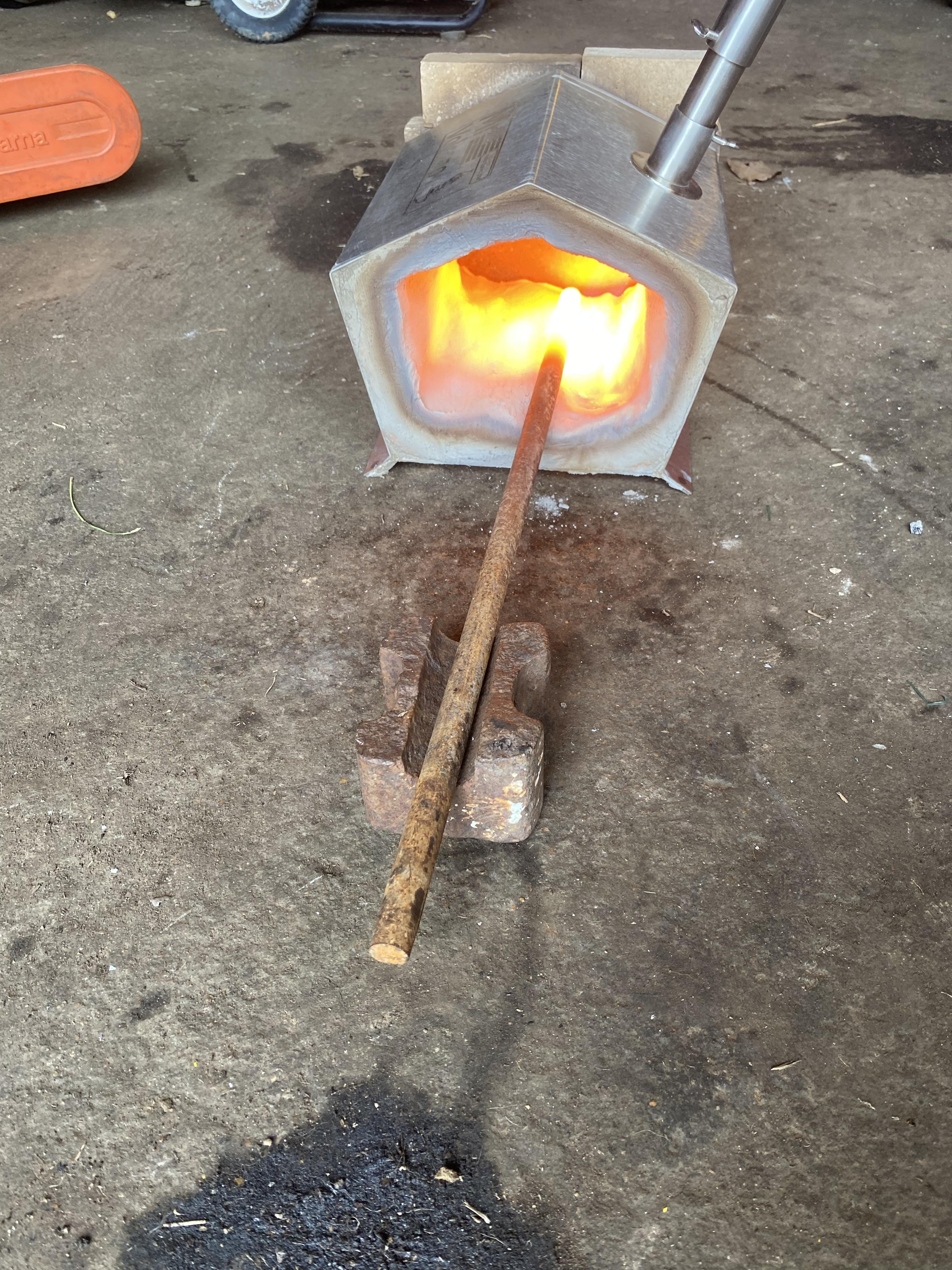

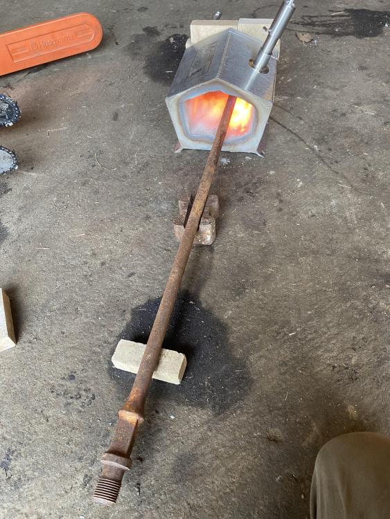

Got the little forge cured this morning, piled up some bricks I had on the one that came with the kit and played around with some different steel to see how long it took to heat up
i heated up 1/4” square bar in just a few seconds, then some 5/8” round in a minute or so and then 7/8” sucker rod in a few minutes
this was a fun little project I might make myself another gas forge later
One thing I did notice is it’s pretty loud it sounds like a rocket ship engine!
I think imma order some of the ITC-100 from Mr Volcano to see what kinda difference it makes
I dunno much about gas forges but over all I’d definitely recommend this for someone wanting a kit with everything in the box ready to put together, the instructions are very straightforward and easy to understand, if I can put it together then anyone can! Lol
One advantage of the NARB (naturally aspirated ribbon burner) is that it is much quieter than a regular gas burner.
Looks good Billy. It needs something of the floor but not that full size fire brick that comes with. If all you can find is 3,000f hard fire brick use split brick, it's half as thick and will use half as much propane coming to heat.

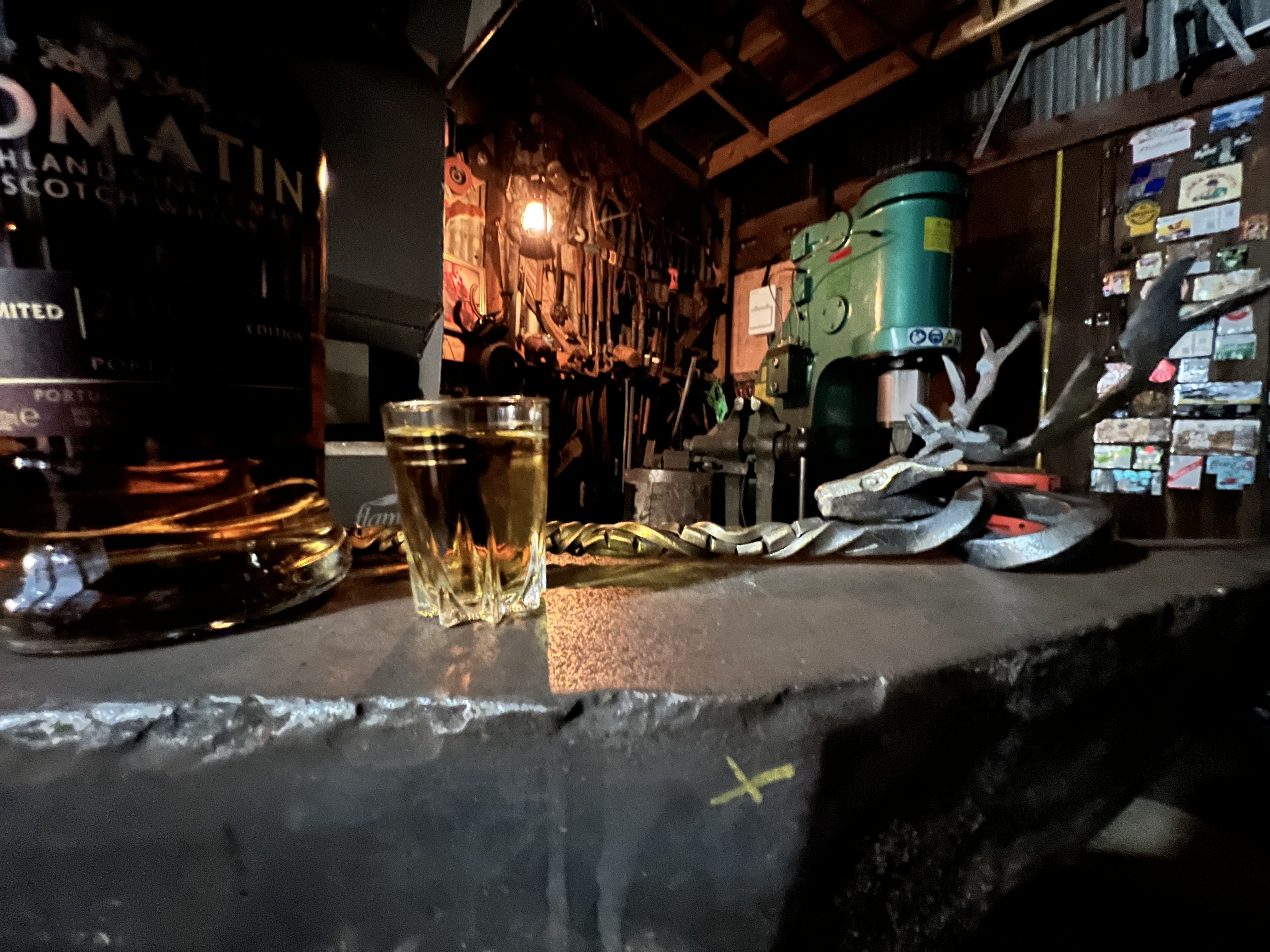

Nice chain, forge and press. Last poker of 2022 for me, but not the last dram.  Thank you again to everybody on ifi for all the information and advice. All the best for 2023!:D
Mac, took me a minute to see the poker. I was focused on that wonderfully full glass and wondering what sort of damage I could do it.

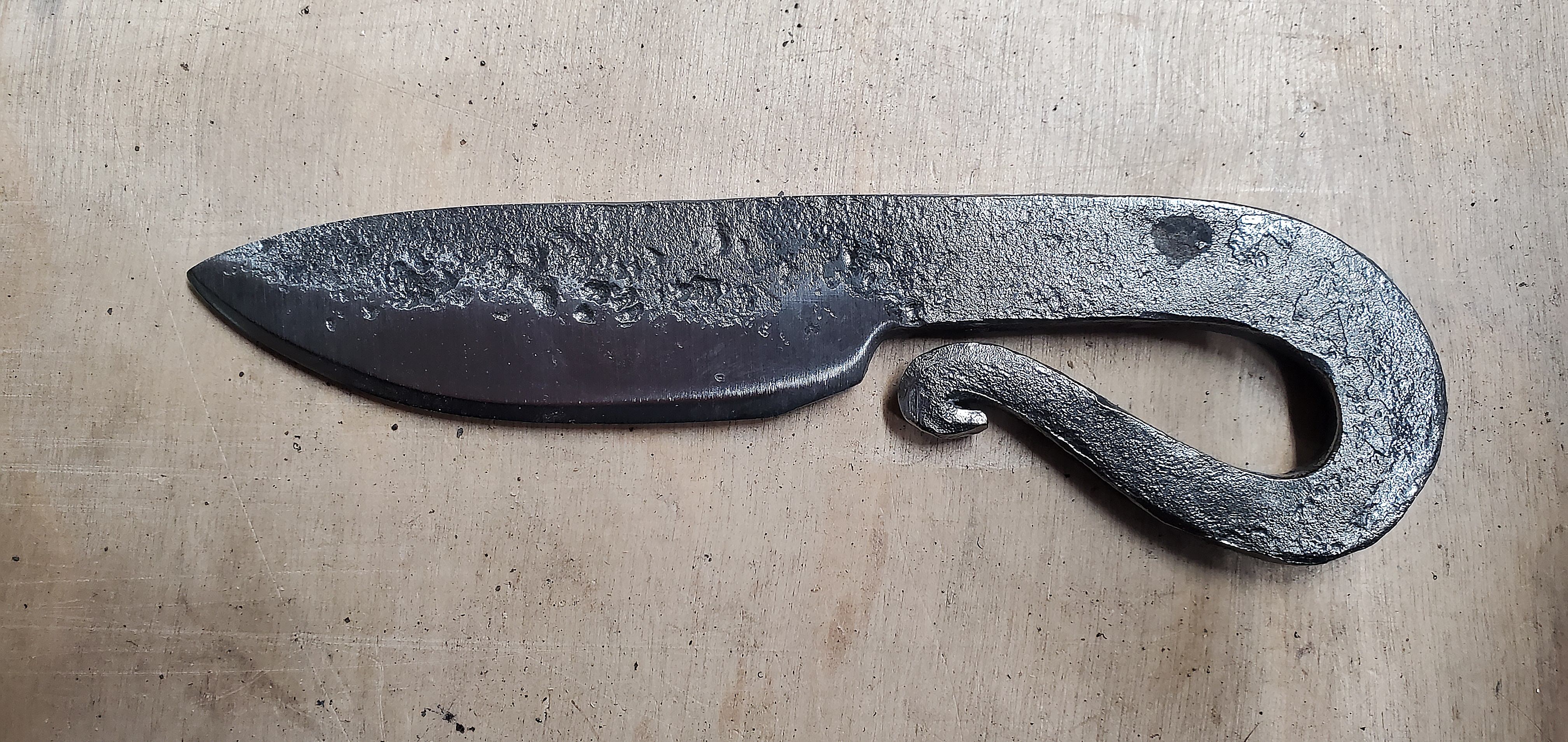

I also finaly forged and finishing a blade, a little blacksmith's knife from new 5160 that I sold to my daughter's new father-in-law for a dime that I gave him. Sounds a bit weird, but my native friends taught me the tradition that if you give someone a blade, versus selling or trading it to them, you sever the relationship you have with them. I like that tradition so I follow it.
Fire bird, that is not that weird. It is a penny around here though. As a matter a fact i was just watching a TV show the other night and some did that as well.

Will, I went to a BA meeting last year and the host had this chain swag going all the way around his shop at least twice. He said he tries to add a few links at least once a week. His are the forge welded variety but concept is the same!
On 12/31/2022 at 4:34 PM, MacLeod said:
Last poker of 2022
Mac, that's an impressive handle on your poker! The head/antlers - is that all out of one piece?

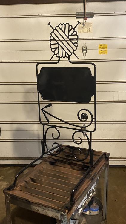

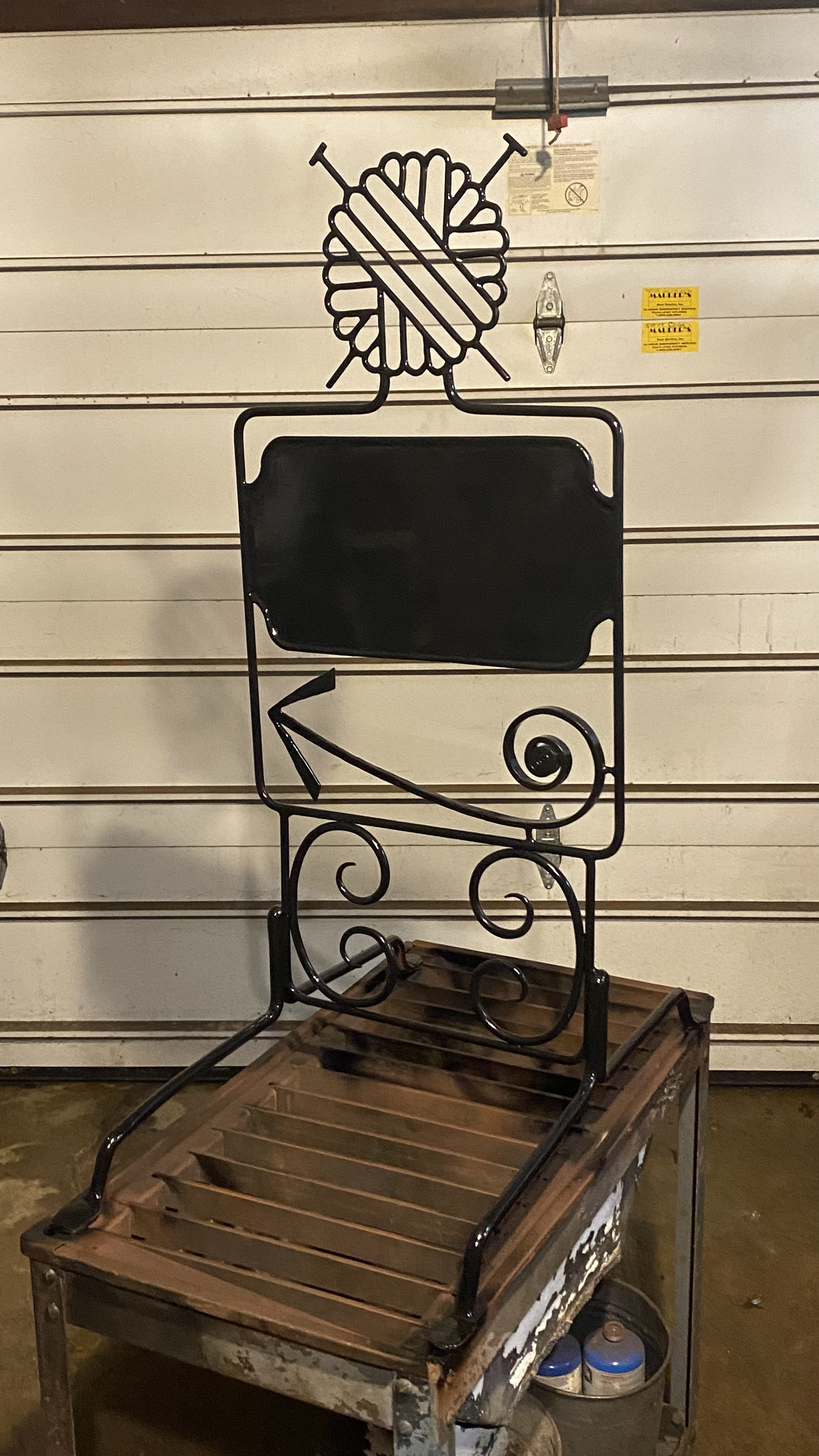

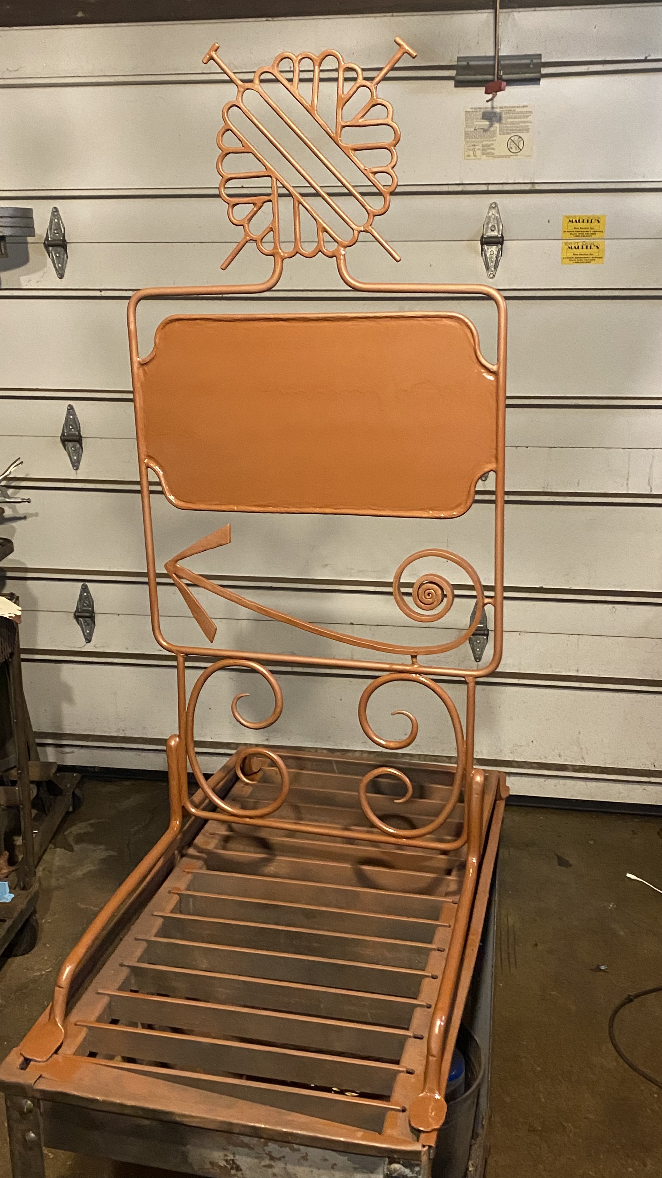

Lots of cleanup on the yarn shop sign, plus priming and painting.
