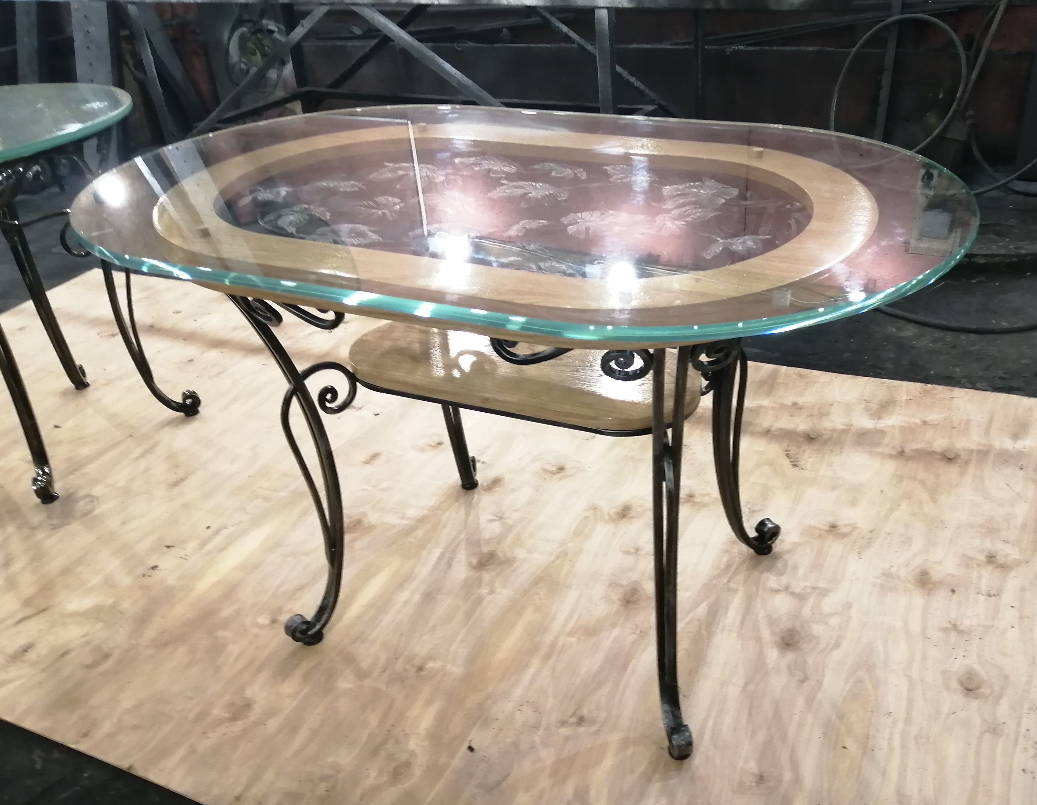

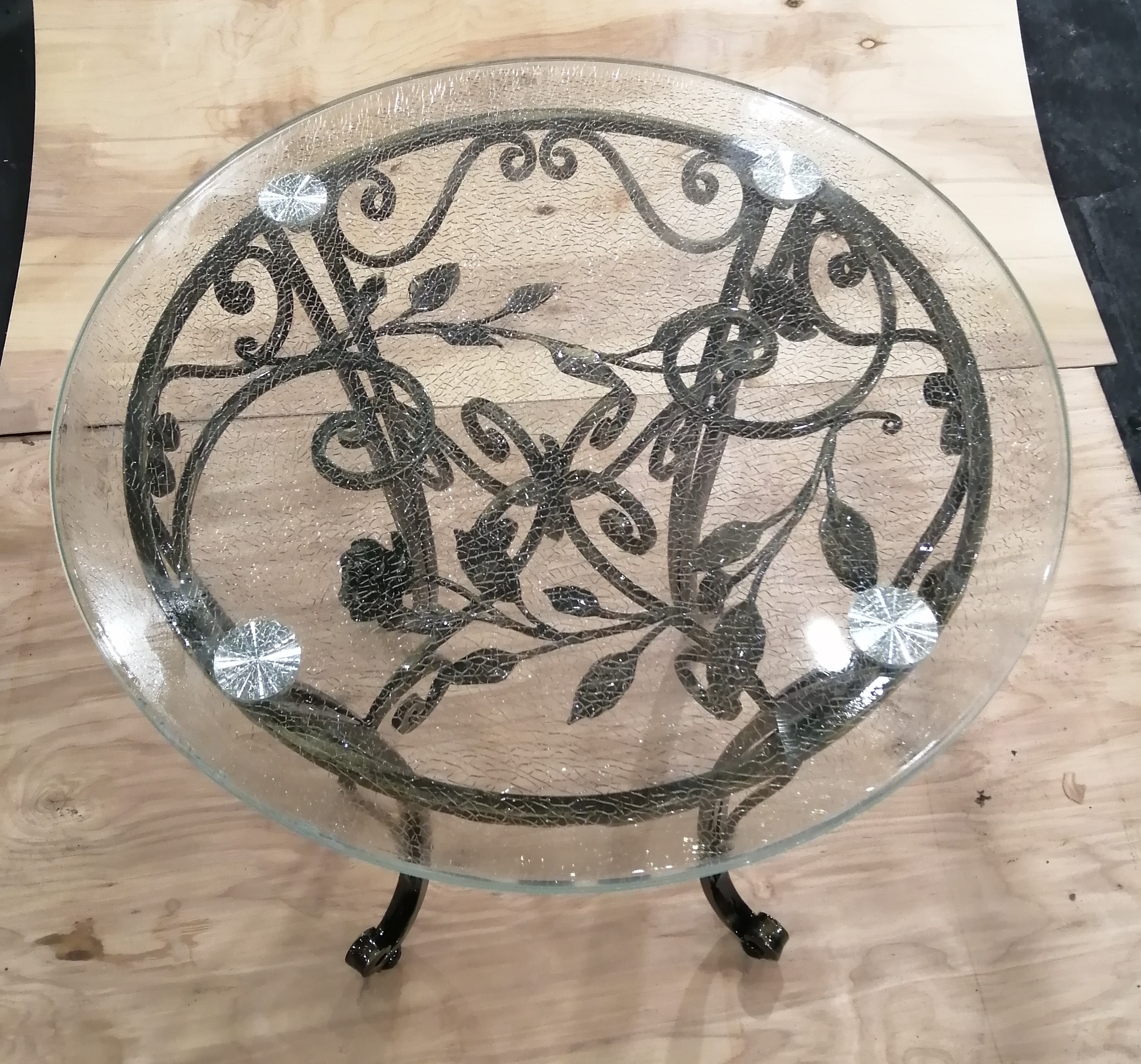

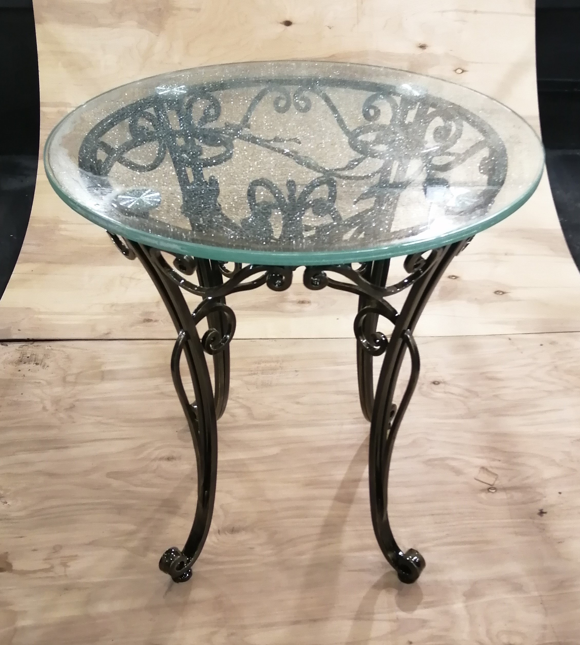

I love these table legs, they're graceful, attractive and are VERY strong. The way you connected the angle brace and carried it in to support the lower shelf is elegantly excellent. I love sound structural engineering that is beautiful on an artistic level

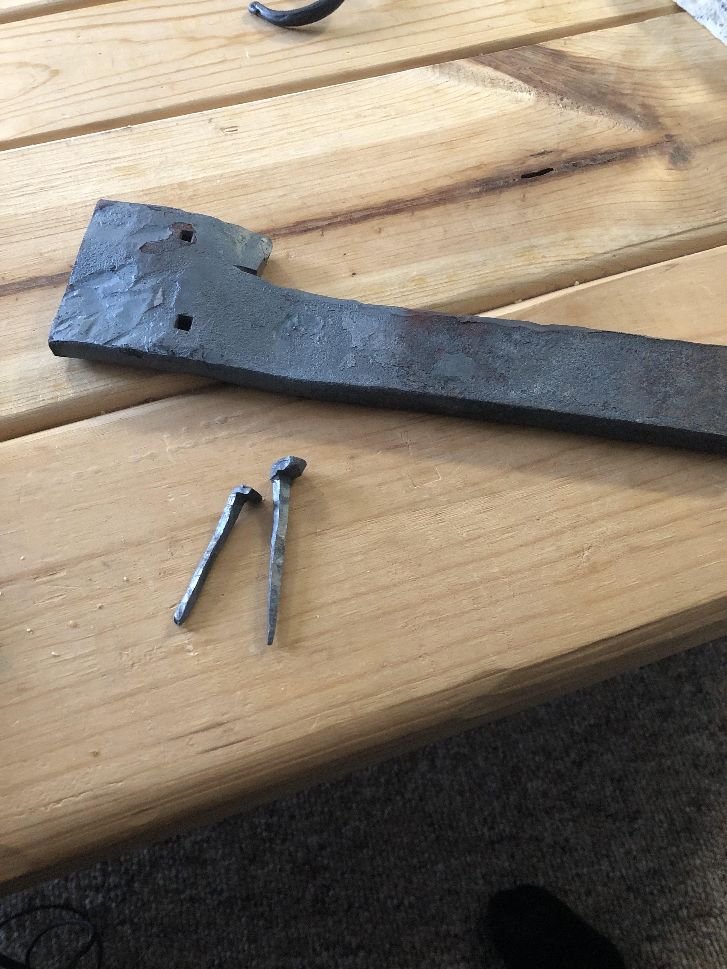

Today was a little bit on a lot of different things. I started on something quiet, roughing out a sledge hammer handle, and then at 10 I started with squaring up the holes I drilled in my nail header and made my first two nails ever! I'm pretty excited, even though they weren't even close to 1 heat nails, and they look pretty ugly.

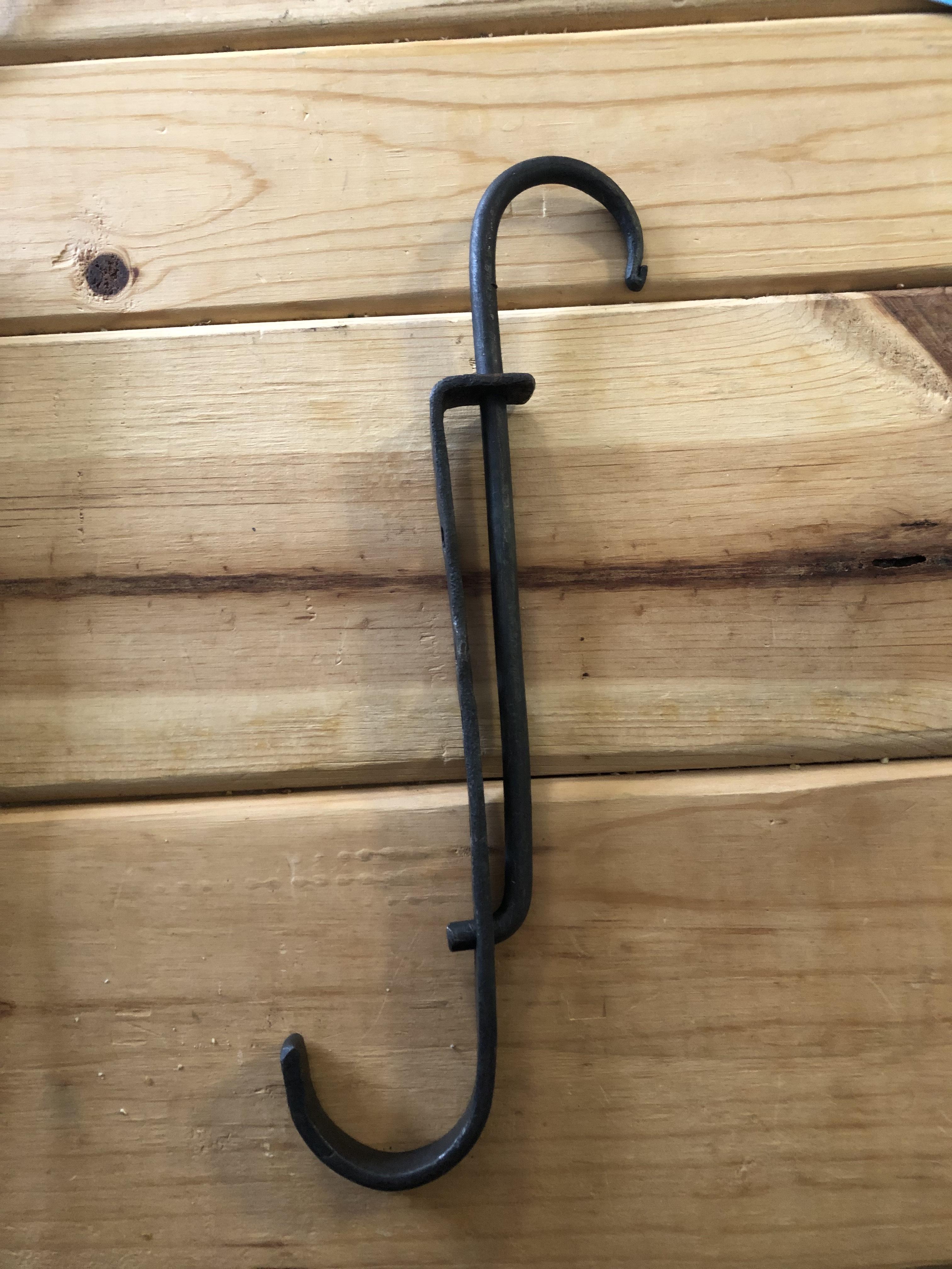

I also forged the top hook for my trammel hook that I had bent cold.

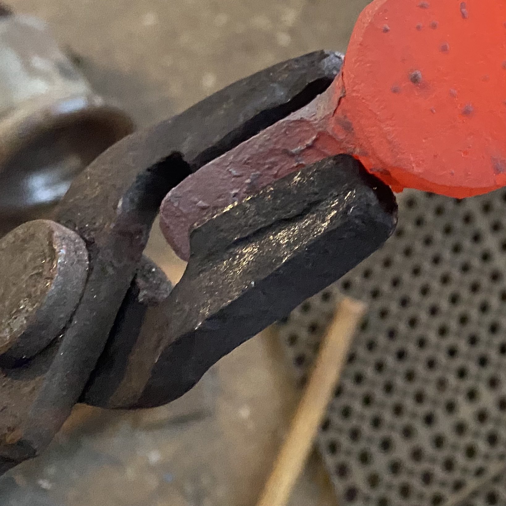

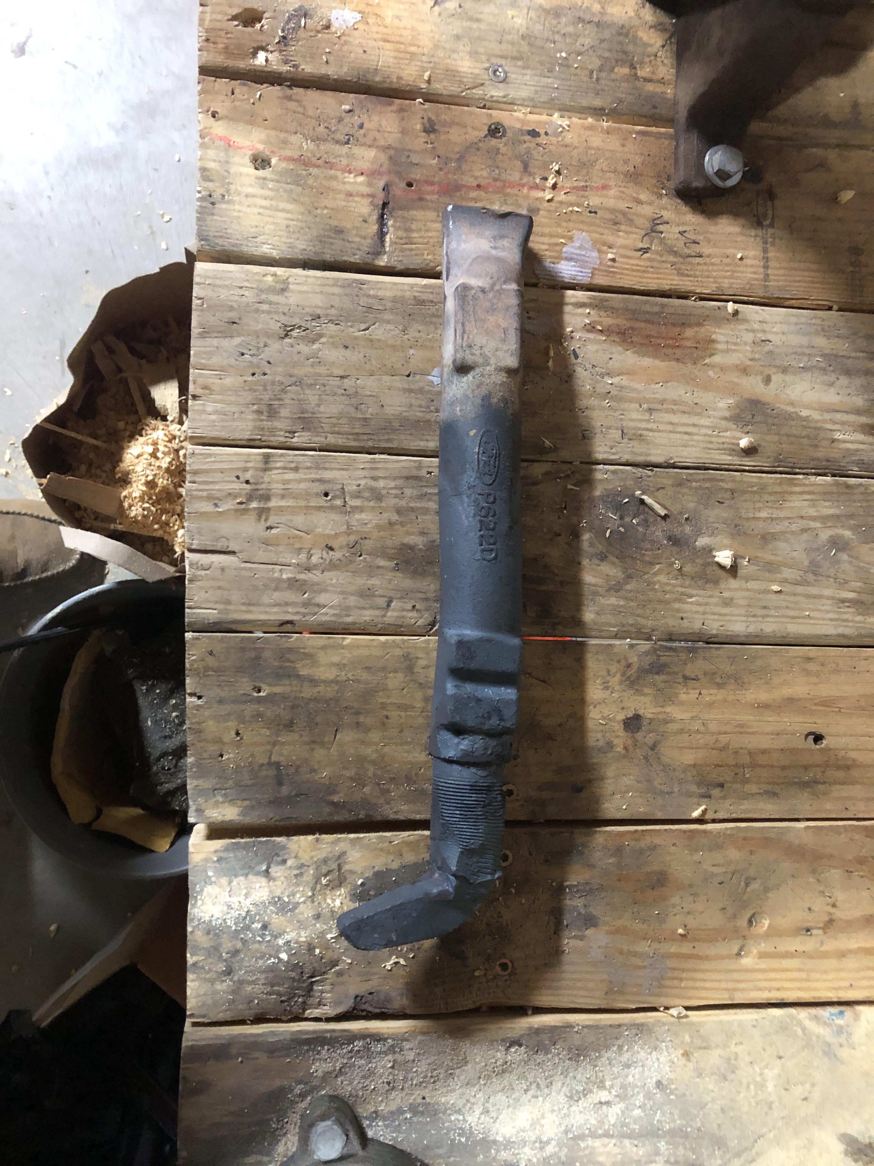

Finally, I started to tackle the hardy hole swage block made from a F-450 tie rode end. I was able to recruit a striker last time I forged to make the square shank, but this time I had to bend it and have it sit nicely on the anvil. Next time I will begin the depressions.

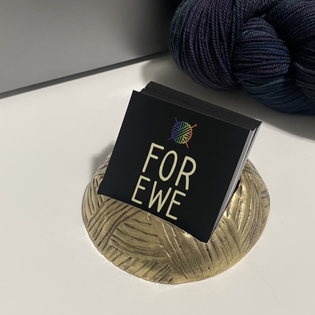

Finished up a little chasing project: a business card holder for the yarn shop.
So what's wrong with those nails Will? A little practice and a light hammer will make even heads centered on the shank easy. One of the guys here makes nails with a 3lb hammer and gets the heads mostly straight and centered. I tend to make specialty hook headed nails for hanging pictures. Very similar to that beautiful picture hanger nail you made. ;)
My GOODNESS John, that turned out beautifully, way to carry a theme!
Thanks, Frosty!

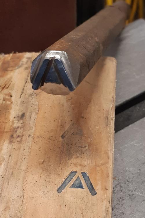

Hadn't had the chance to spend time in the shop since September. No forging today, but I was able to make my touchmark. Mostly used an angle grinder with a thin cutting disc, with a little filing work to finish it up. Took me much less time than I expected!
Couldn't try it on hot dteel yet, so I just used a felt marker and tapped it on a piece of wood. Much more even than when I used individual punches to make the mark. :)
Can't wait to see how it comes out on steel.
Looks good.  If you find that isn't stiking as clearly/deeply on steel you may want to reduce the surface area being punched into the metal by filing the lines on the sides to a sharper chisel edge and maybe making the triangle a bit smaller.  Don't do it, though, unless you aren;t satisfied with it as it is.

Really nice.
Looks good Arthur, well done!
Indeed George, I'll see how well it works on steel and adjust it if necessary.

Will, not bad at all for your first nails! My first 4 nails looked just like that. Then I FINALLY got one with an even head just in time for class to be over, lol. I have all of my nails hammered into the shelving in my shed to hold various things. Even with uncentered heads, they function just fine! I haven't made any more since - but it's on my list of stuff to do when my project list is finished (does that ever happen?)
John, that's awesome. Your wife is fortunate to have you to make all these things for the shop!

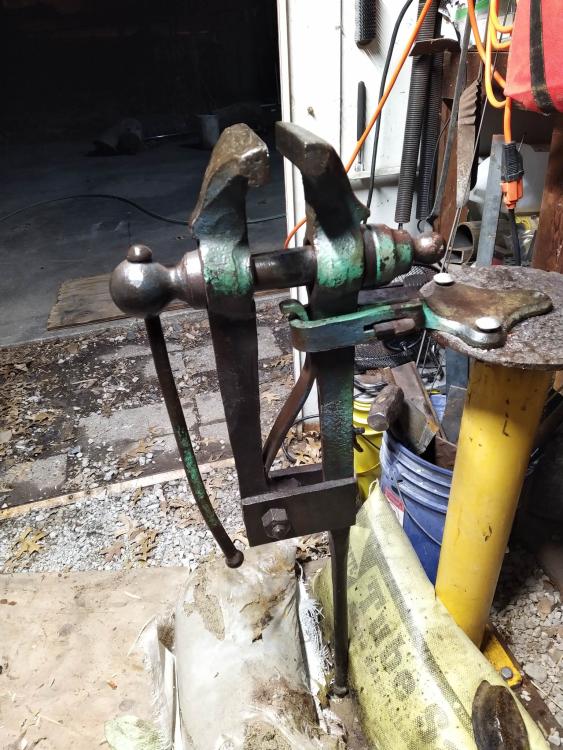

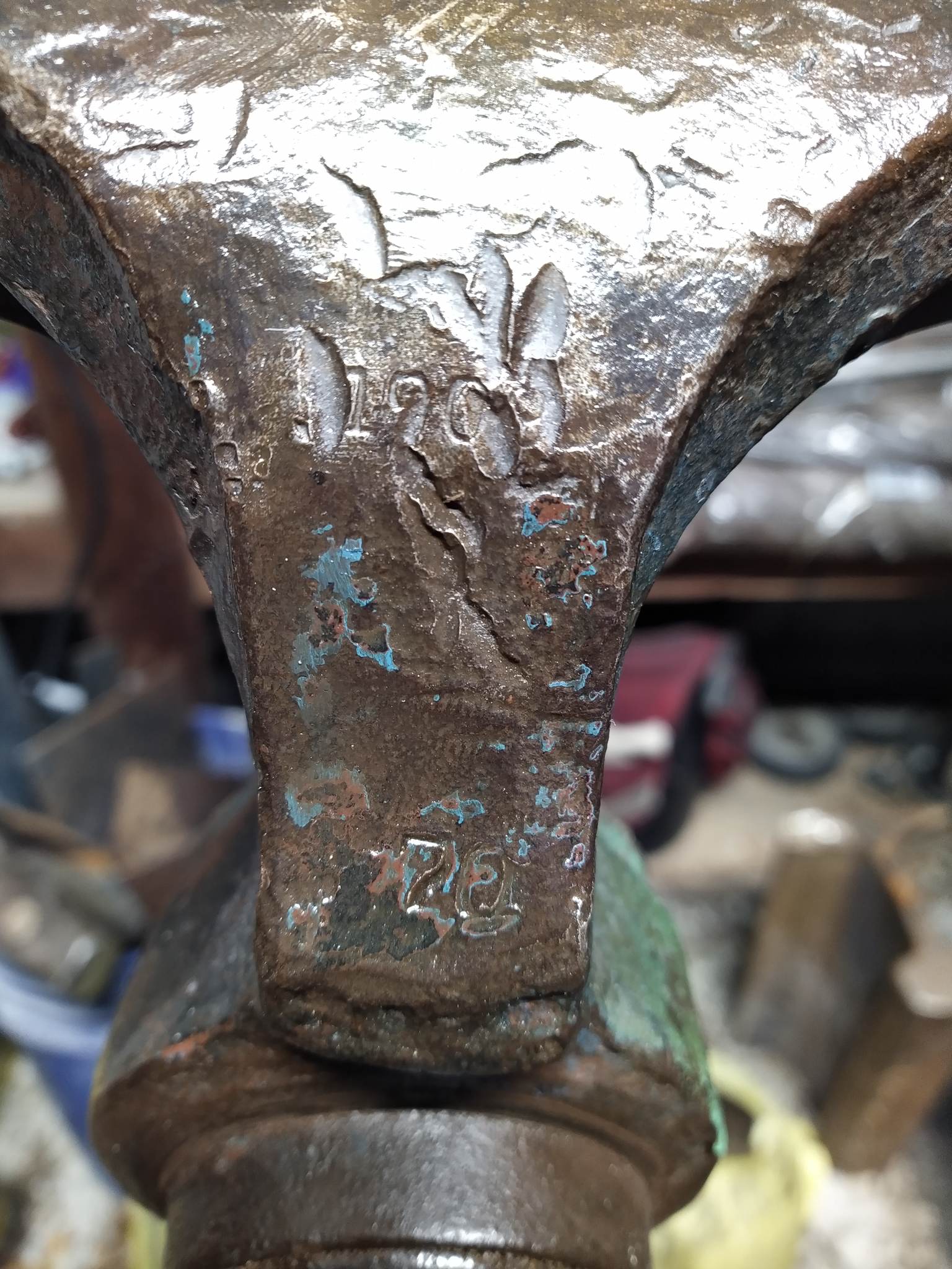

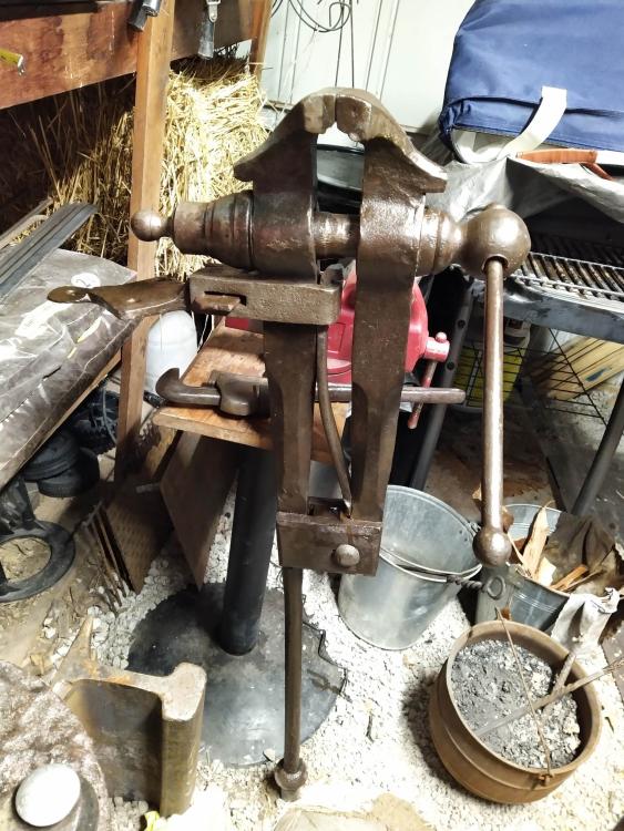

I also got the farm vice put back together! I never was able to get that screw box out, but I decided to reassemble it anyway and just see if it lines up and works as it is. And it does! I don't have the right size bolts to mount it though, lol

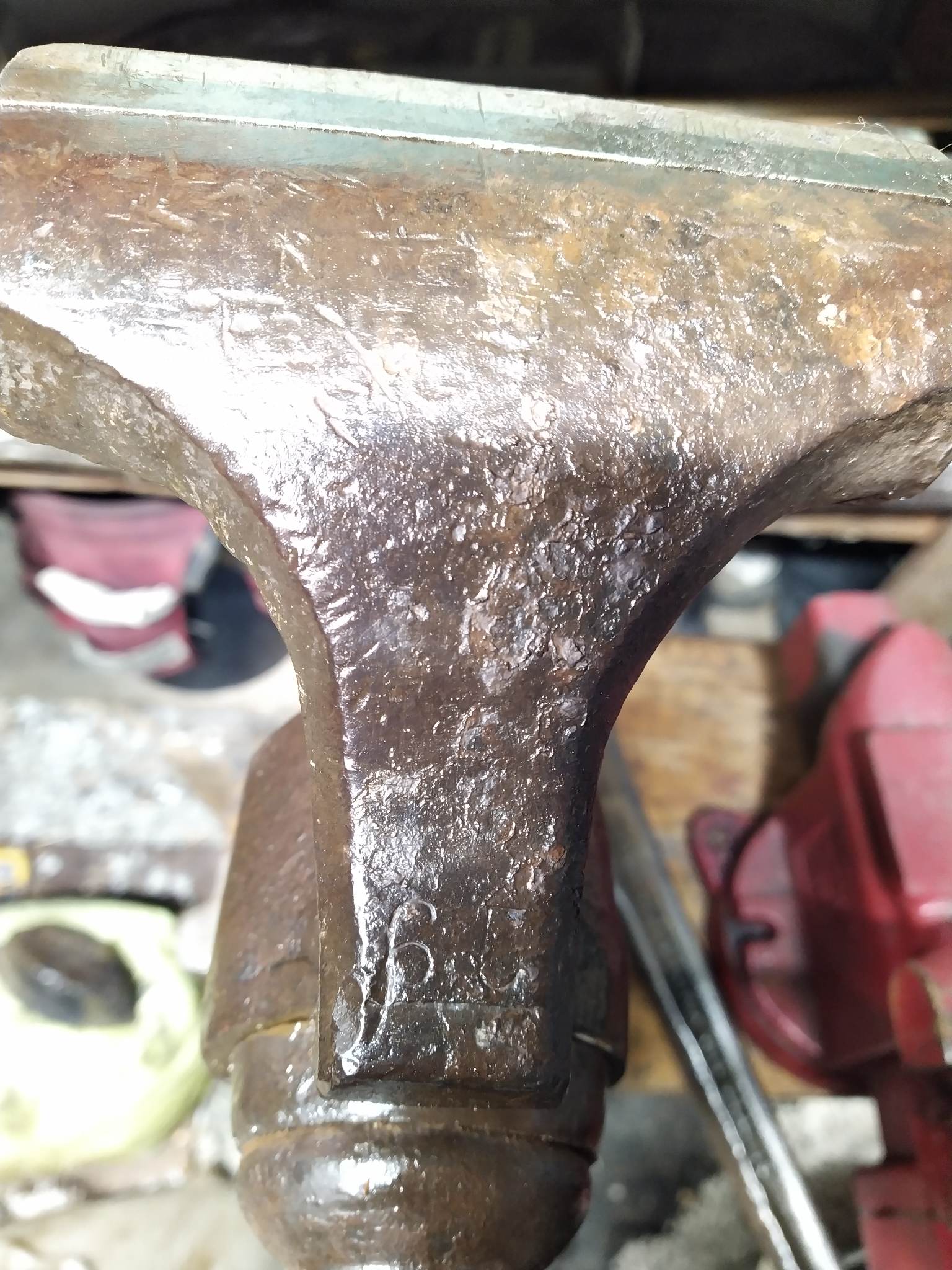

So I just gave it another coat of BLO and left it standing against the shelves. No idea what I want to do with it. I'm quite torn. I was thinking I would sell it once I got it all working but I'm also quite attached at this point and kinda don't want to.  But also, I don't need two post vices, lol. Jaw width is exactly the same on both vices. My current vice is slightly lighter & shorter than the other. I don't know that it's enough difference in weight to really matter though. Never weighed my current vice but it has '70' stamped into it so maybe 70lb? The other has a '65' stamped into it but the auction listing weighed it at 96lbs. So maybe the stamp doesn't have anything to do with weight. Now I'm curious to weigh both. Wonder who I could borrow a scale from...
Farm action vice:

Current vice:

That's real similar to what I use. For my initials JAW the bar on the left and right have a leg and the triangle is hollow.
Do you have a picture of your mark, Jim? I don't want to infringe if they are too close to differentiate. (But it sounds lile they are different enough not to.)
