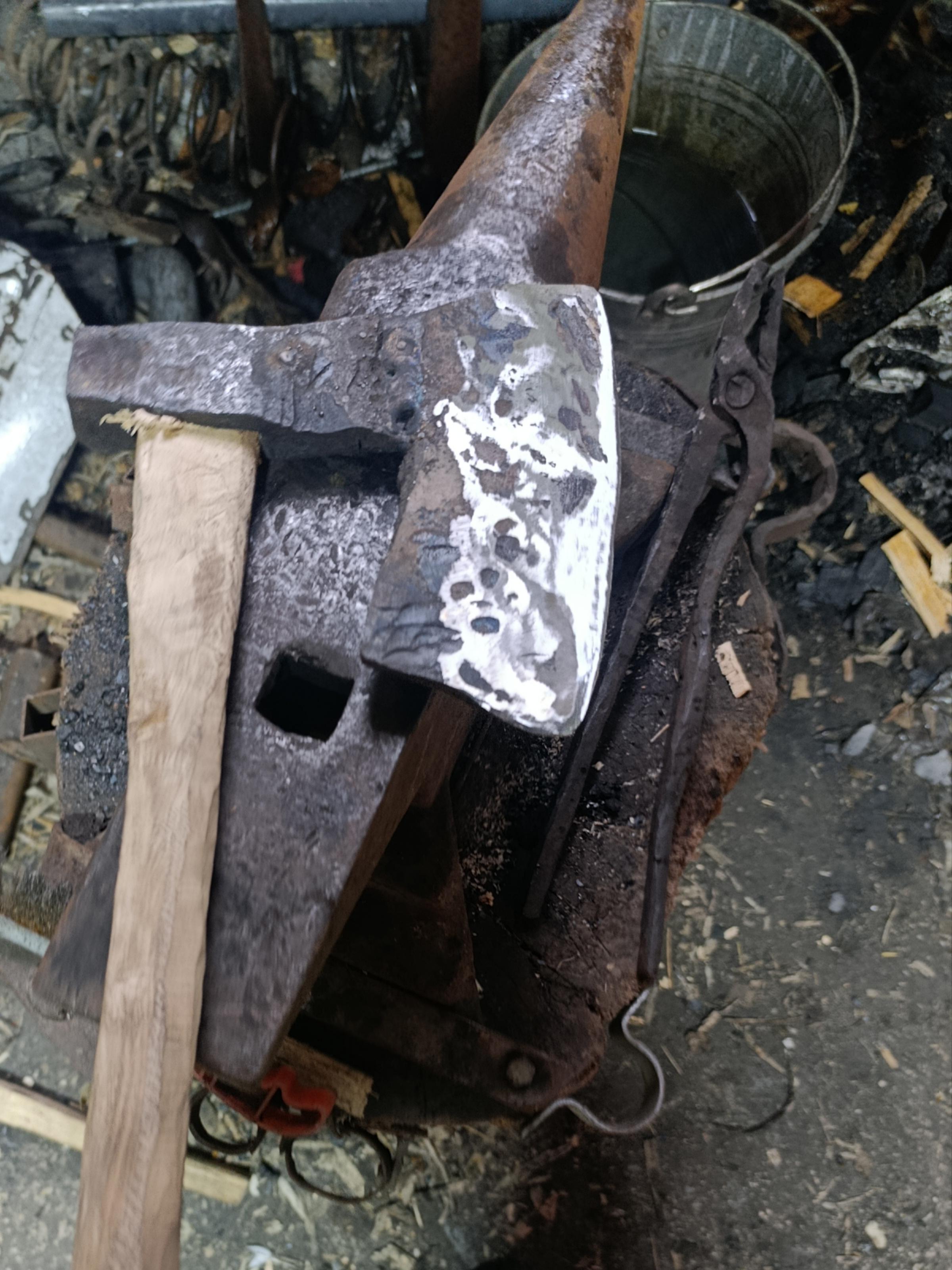

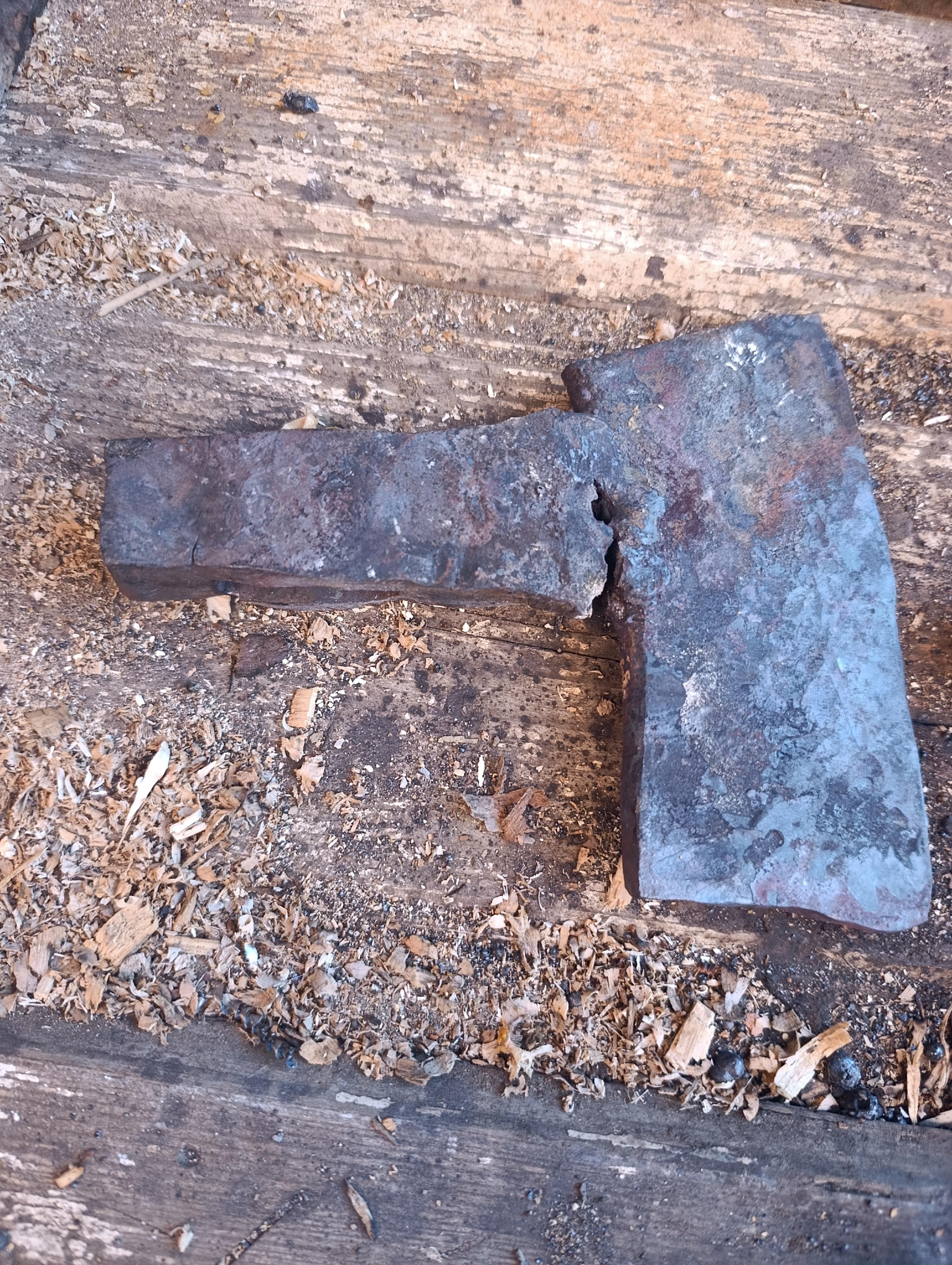

  1. I used to grind 45 degree bevel in, one one side and the other like in this video It look weak because it did break while I was forging so I fixed it like Nils Did . That picture was taken before right weld was made. Wanted to show how eye I made , and after I welded "right" way , I attached handle so it was not possible to see how eye look later.

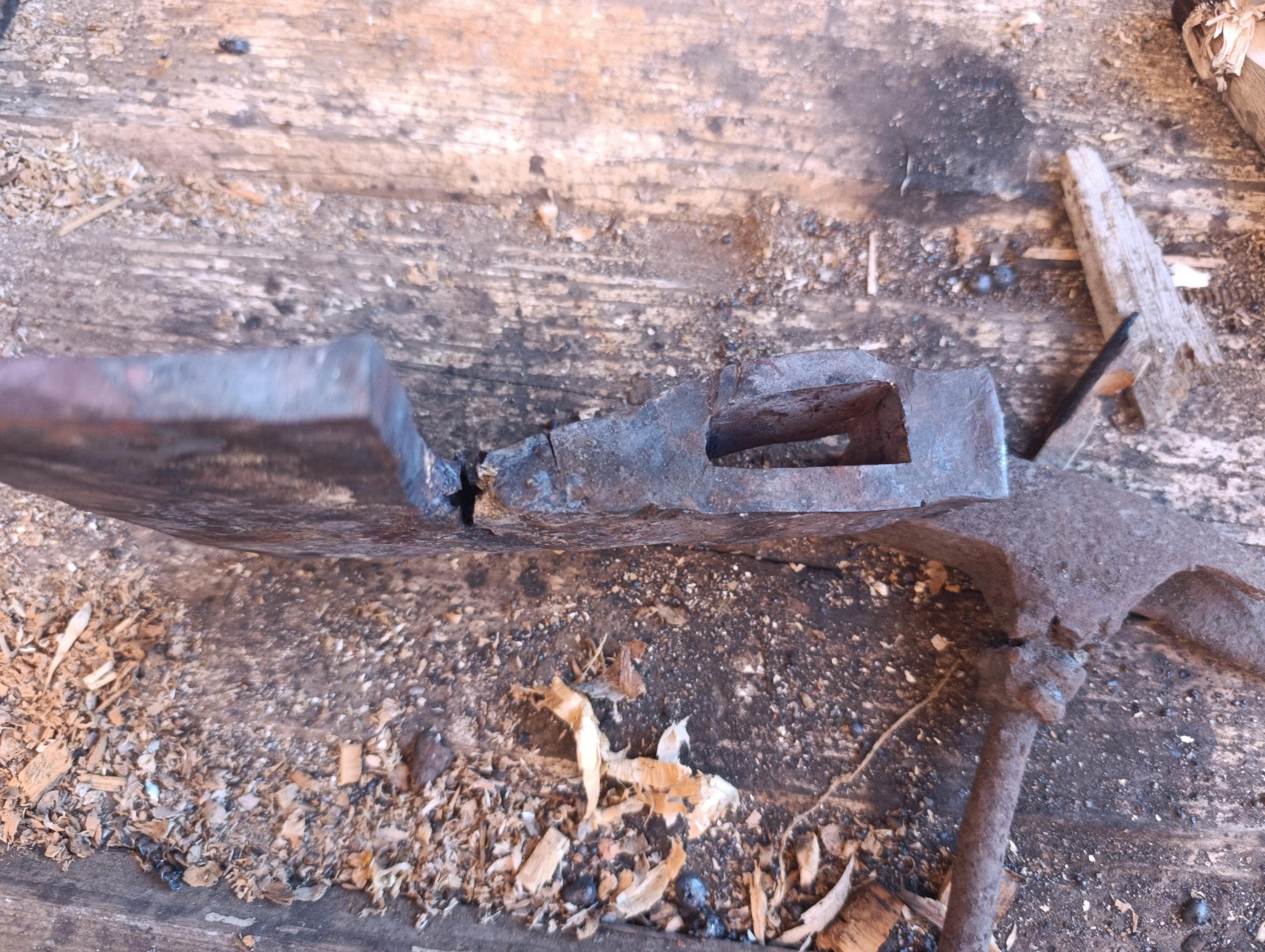

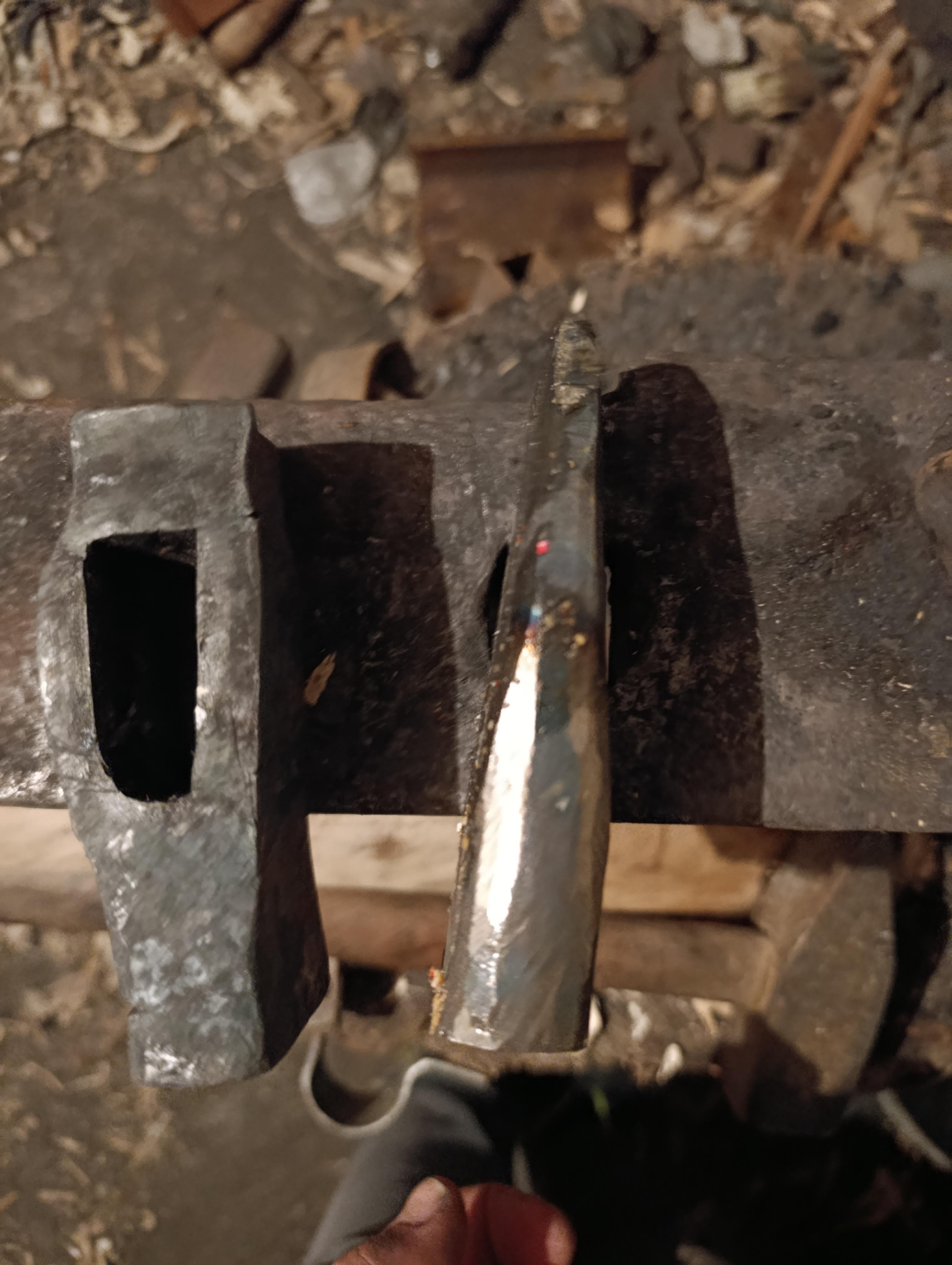

  2. I will never do this again , made mistake , I punched hole through leaf Spring drifted eye there and again made another lead Spring for blade. Eye is made in European style , it is where one part is like oval and other part of eye is squarish.
  3. I will just stick weld blade to it.
  4. Welded axe then used to draw it out , would be drawn out again later and weld will be fixed. Made mistake , part for eye was made too small to draw out later Edge for it. It's made from leaf Spring , then again I welded leaf Spring to it. Wanted to make it from one piece but made mistake in calculation. Tool would be functioning this way to, just it's not "proper way to do it " .
  5. Axe that iam forging in progress

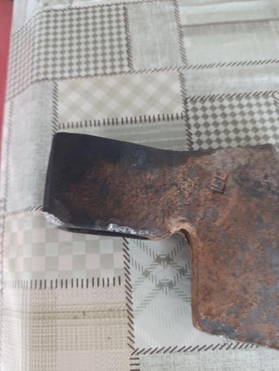

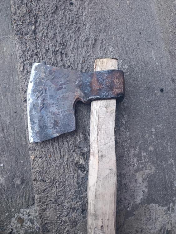

  6. My coworker wanted his axe to be drawn out resharpenwd then I did that . In Balkans it's tradition that we sharpen our axes this way. Before and after it was drawn out with hammer then I used grinders and file . Had problems with steel edge cause customer cut steel part of it. I charged 20 KM Wich is like 10 euros or 13-14 dollars for that sharpening. For price of 30 KM Bosnian convertible mark you can buy new axe. I made axe handle drawn out Edge sharpened it and it's ready now. He say it's good.
