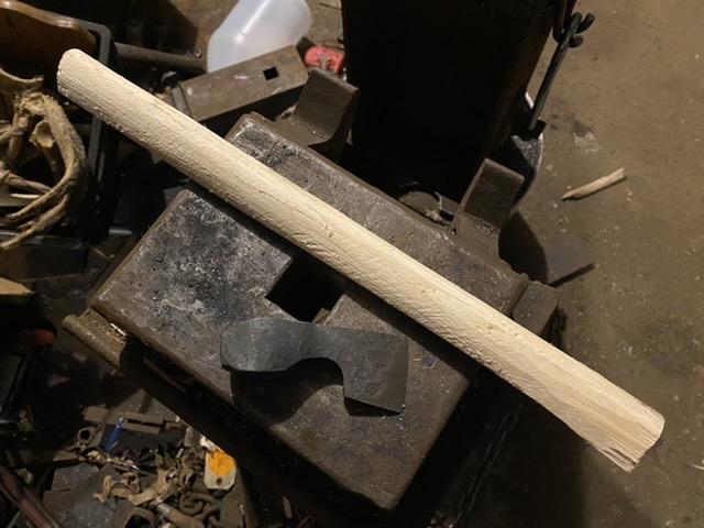

I had a fun couple of hours in the shop, working on a few different bits and pieces. Did some cleanup grinding on some chasing tools (no picture), started fitting a handle to the little axe:

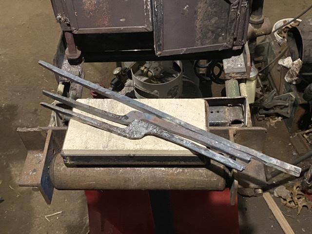

And worked on a long-abandoned pair of tongs:
I’d messed these up a couple of years ago, but realized that I could reforge the bits and weld on some extra steel for the reins. While they’re not finished yet, there was one wonderful little part of making them: when my son decided to come out to the shop and strike for me. It’s only the second time he’s done that in the last five years or so, and it was great.

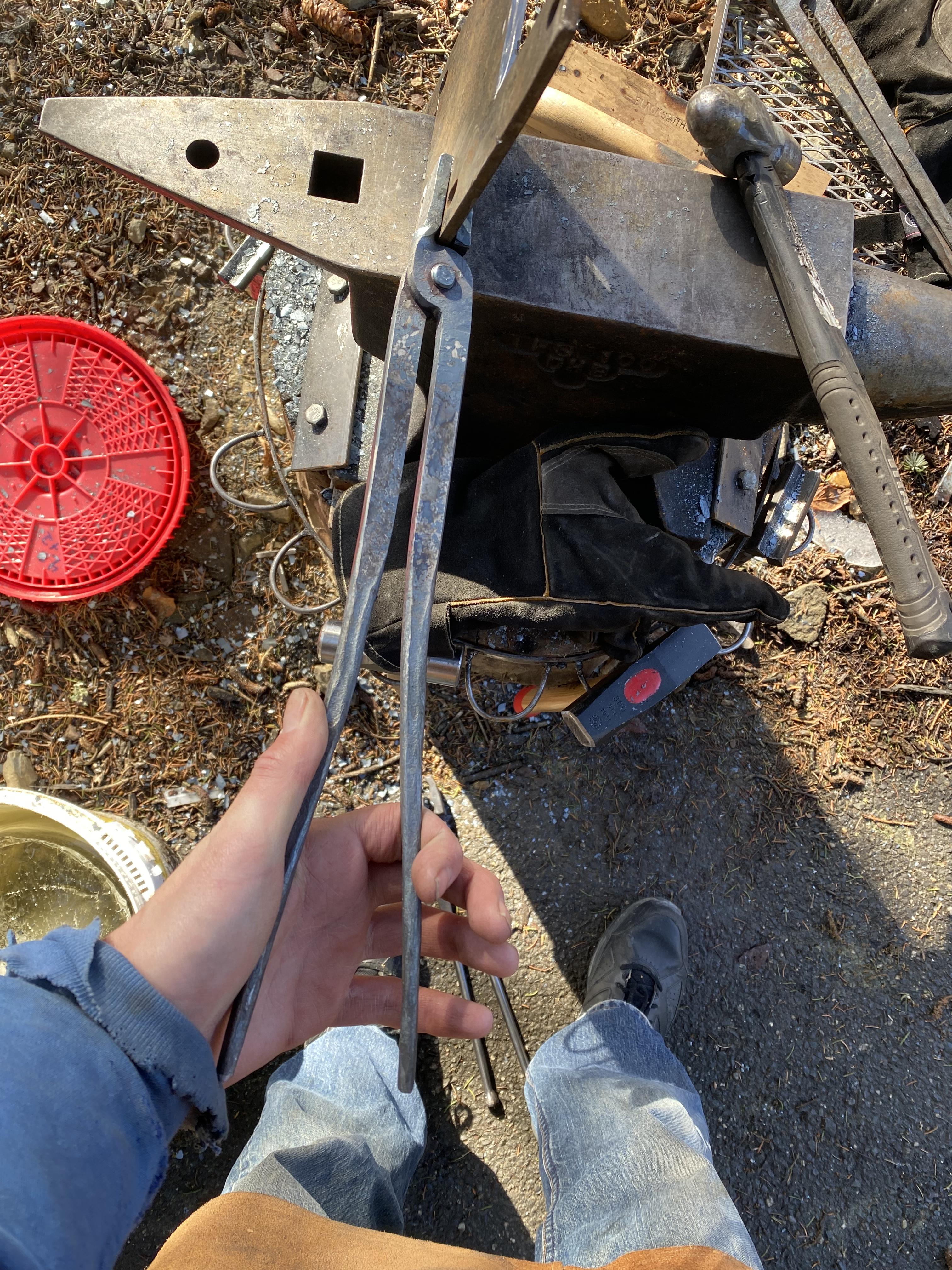

Made the flat jaw tongs from the blanks I bought. Super ugly but they hold 1/4 and 3/8 really strong and 1/8 and 1/2 just ok. Either way I’m happy to add another set and itching to get the other four sets finished because literally every single project I end up angry at some point because of the way I have to hold the work.

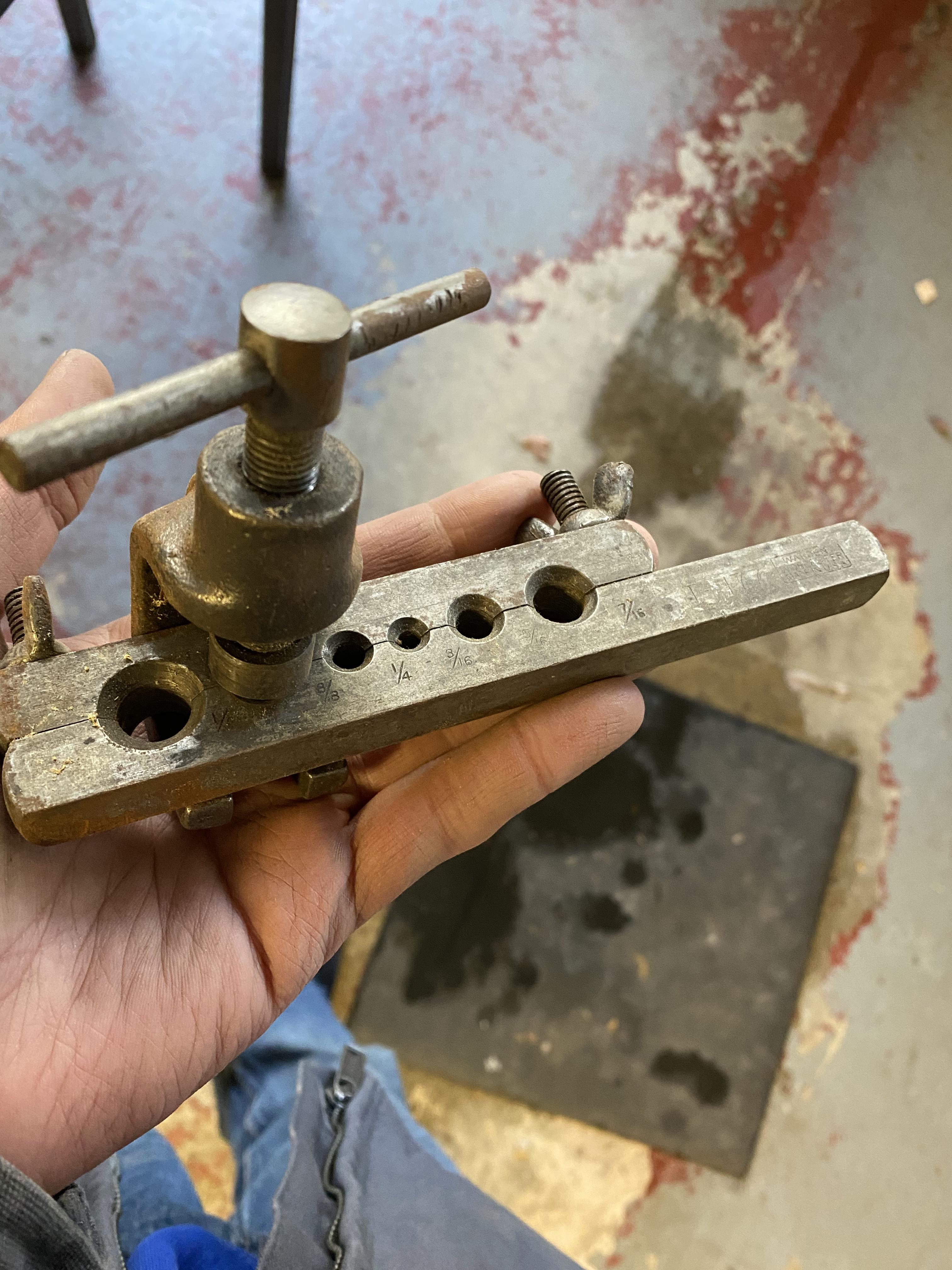

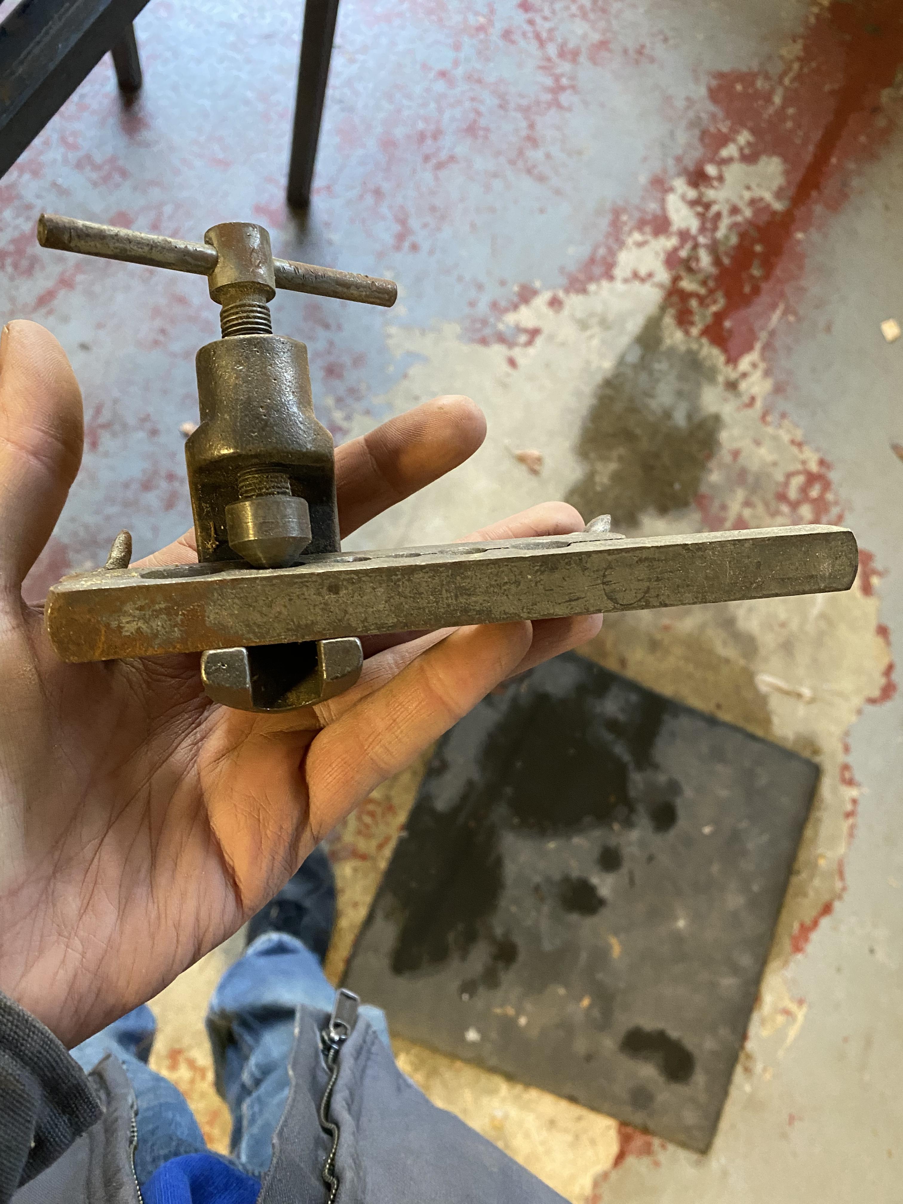

Also, anyone know what this tool is??
Yes, it's a flaring tool for pipe. Hang onto it; it's very handy for plumbing gas forges.
Nice job on the tongs. Being able to hold the work securely completely changes the game, doesn't it?
John is right. This used to be THE tool for copper tubing connections before compression nuts and shark bite connectors. I had to buy a set for making coils for my induction forge. I'm assuming that fewer physical breaks are better for electrical connections which is more important in induction coils than leakage of coolant.
BTW - If you get one of those China induction forges don't do what I did. I looked at it and figured it was a copper cooling system. In South Louisiana's hot, humid clime I needed something to keep algae growth down in my recirculating cooling water system. From my experience in corrosion control I knew that copper sulfate in water would protect copper AND kill algae. What I did not know until recently is that there is an aluminum heat sink inside that the coolant runs through. Aluminum is anodic to copper, so now I have a leak to repair AND I'll have to flush the system and find something friendlier to aluminum to kill algae.
Also good for flared connections on hard hydraulic lines.
To do hydraulic lines with it you will need the anvils to make double flares with. When you find them at garage sales, flea markets, etc. it is usually the anvils that are missing. There should be one for each size of line you can flare.
The new style flaring tools are hydraulic and will make many different style flares. Quite an expensive tool but man are they sweeeet.
One thing to look for on the old used flaring tools is inside the holes it should have "teeth" over time those will become worn down, especially on the larger diameters, and then when you try and flare the pipe it will just slip through.
Ah ok - I see how it would work to flare pipes. Still confused on what the “anvil” would look like but I can look it up. I’m going back to my uncles shop for a second load though so maybe I can find them.
In this context, the anvil is the cone that goes inside the tube to flare it out.
Ohh ok so I just have one anvil then? But there should be different sizes to match each size hole?
Lol ok brain was not working right. Had to stare at it one more time. Got it. Thanks guys.
