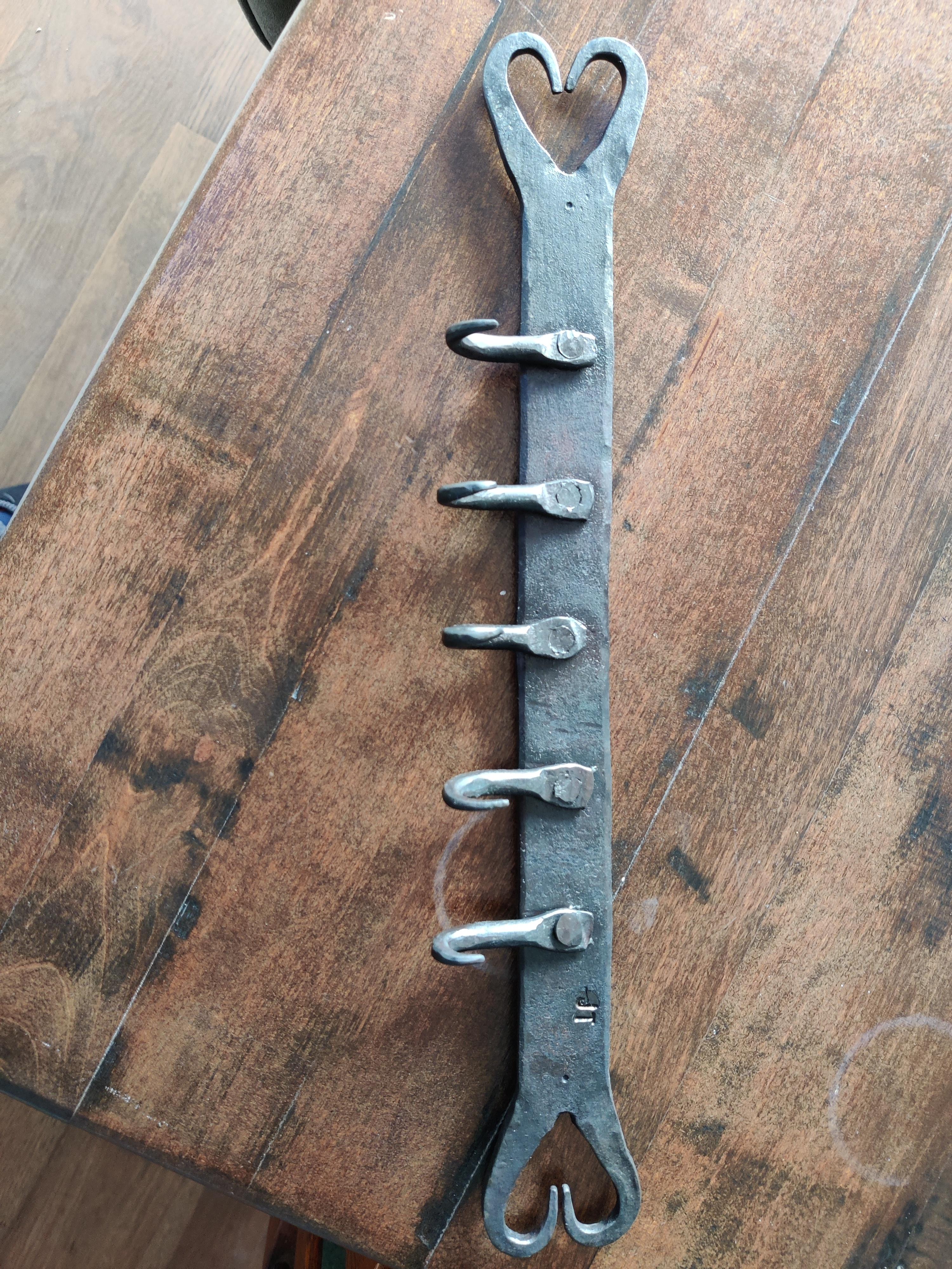

Jobtiel1 Posted February 2, 2022 Share Posted February 2, 2022 I finished a long overdue item my mother asked for a while ago, a rack to hang her keys on. They were using screws ever since moving last summer. Well, it's done, and I quite like it! Unfortunately I dropped my calipers after the first hook, so the hooks are not all the same. ~Jobtiel Quote Link to comment Share on other sites More sharing options...
Frosty Posted February 2, 2022 Share Posted February 2, 2022 Looks good Jobtiel. Not all the same? Of course not, don't be silly! Frosty The Lucky. Quote Link to comment Share on other sites More sharing options...
Jobtiel1 Posted February 2, 2022 Share Posted February 2, 2022 Perfectly alike would be silly, looking at it now they are close enough to look good, so I'm happy with how it turned out. ~Jobtiel Quote Link to comment Share on other sites More sharing options...

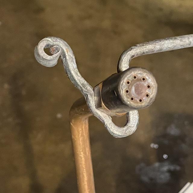

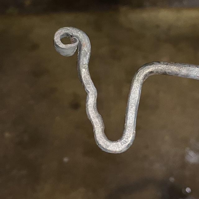

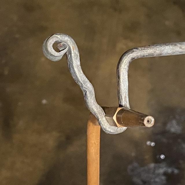

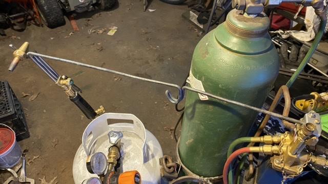

JHCC Posted February 3, 2022 Share Posted February 3, 2022 On 1/29/2022 at 8:08 PM, JHCC said: made a new control arm for the gas saver on my torch cart, to move the torch farther from the regulators. This evening, I decided to tweak the hook a bit, to fit the three types of torch tip. Here’s the new shape: With a brazing tip: With a rosebud: And with a cutting tip: Quote Link to comment Share on other sites More sharing options...
Gandalfgreen Posted February 3, 2022 Share Posted February 3, 2022 nicely done john. Quote Link to comment Share on other sites More sharing options...
JHCC Posted February 3, 2022 Share Posted February 3, 2022 Thanks. I might move the right-angle bend up a bit. Quote Link to comment Share on other sites More sharing options...

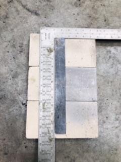

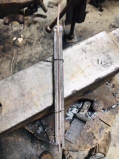

Goods Posted February 3, 2022 Share Posted February 3, 2022 Tonight got the gomai knife billet welded up and drawn out into a 12” x 1-3/8” x 1/4” blank. Planning on forging the blade mostly to shape. Not worried about that part, but am I crazy thinking about doing a through tang with guard and pommel for my first real handle? Keep it fun, David Quote Link to comment Share on other sites More sharing options...
Frosty Posted February 3, 2022 Share Posted February 3, 2022 Looks like it was made for it John. I'm looking forward to seeing how your blade turns out David. Frosty The Lucky. Quote Link to comment Share on other sites More sharing options...

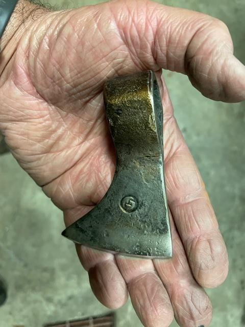

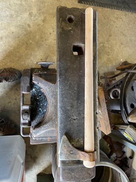

Les L Posted February 3, 2022 Share Posted February 3, 2022 I made a mouse hawk yesterday, my first wrapped eye and one of a few forge welds I have made. 1/4 X 1 flat bar with a 1056 bit, sharp enough to shave. I still have to finish the handle, when I went to get my stain out of the cabinet I learned the "someone" had decided to throw all my cans of stain away to make room for her to store some of her things Quote Link to comment Share on other sites More sharing options...
ThomasPowers Posted February 3, 2022 Share Posted February 3, 2022 Maybe it's a good thing my shop is over on the east edge of our property and my wife only comes out to it about once a year and can't remember where she put the key I gave her... Make a black walnut hull stain? Or tobacco? Quote Link to comment Share on other sites More sharing options...
Les L Posted February 3, 2022 Share Posted February 3, 2022 Thanks for the ideas, but we don’t have any black walnuts in our area and I stopped using tobacco products about 35 years ago. My neighbor had some red mahogany stain that worked well on it Quote Link to comment Share on other sites More sharing options...
JHCC Posted February 3, 2022 Share Posted February 3, 2022 Rusty metal and vinegar is also an option. Quote Link to comment Share on other sites More sharing options...
Les L Posted February 3, 2022 Share Posted February 3, 2022 John, thanks for that idea, I’ll definitely try it.I don’t know how I said the bit was 1056, that should be 5160. Either no coffee yet or the awfullmatic correct got me again. Quote Link to comment Share on other sites More sharing options...
Frosty Posted February 3, 2022 Share Posted February 3, 2022 You had all the digits, so they were a little jumbled. Normal morning conditions. How about tea? Tea stains everything. Frosty The Lucky. Quote Link to comment Share on other sites More sharing options...
JHCC Posted February 3, 2022 Share Posted February 3, 2022 Most of my handles lately have been charred on the surface, wiped with a mix of linseed oil, turpentine, beeswax, and pine tar, and buffed with a cotton rag. Gives a nice look and a nice surface that's neither too slick nor too grippy. . Quote Link to comment Share on other sites More sharing options...

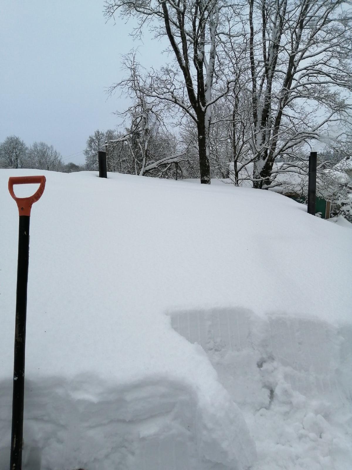

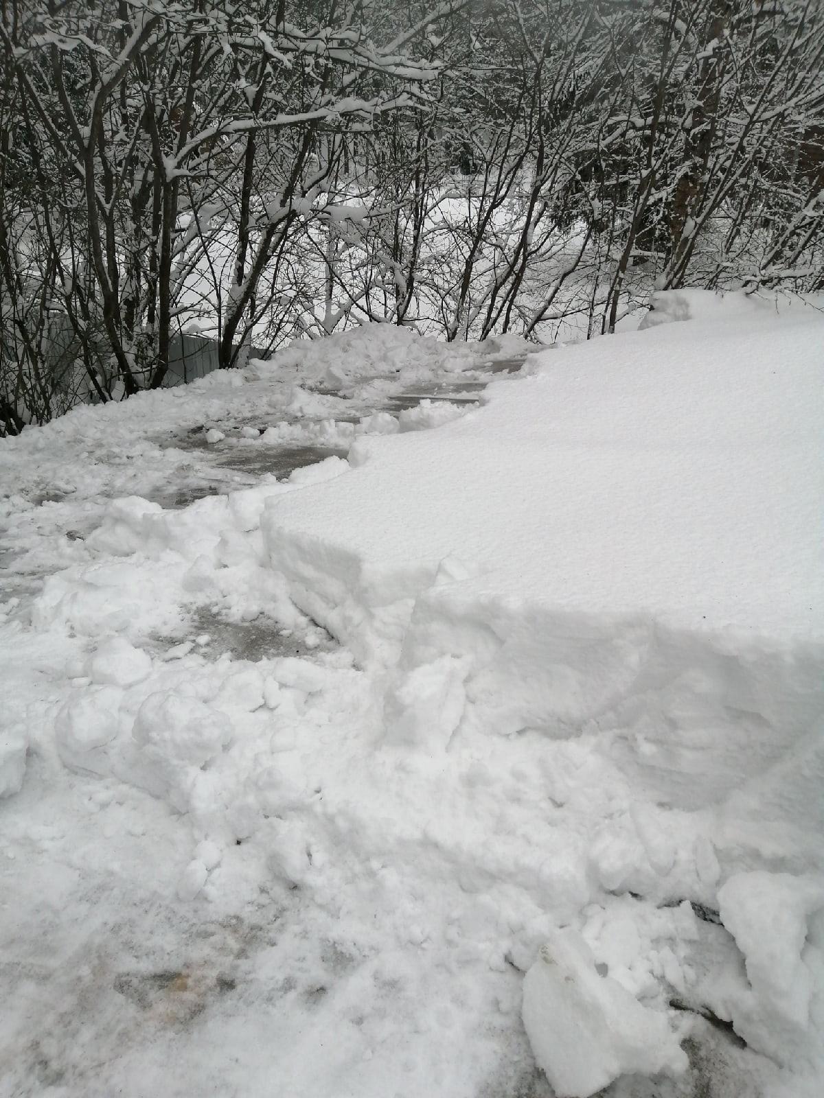

alexandr Posted February 3, 2022 Share Posted February 3, 2022 Didn't work today. For the third time during the winter, removed snow from the roof of the workshop. Quote Link to comment Share on other sites More sharing options...
Frosty Posted February 3, 2022 Share Posted February 3, 2022 I think that was a good decision Alex. Cleaning up after snow has collapsed a building is too much work. There was a quick spot on the national news last night about a young lady who left her college room window open while she was at classes and her after school job. There was probably half a foot of snow on everything. The snow storm had been predicted for several days in advance. The things you learn in college, eh? Frosty The Lucky. Quote Link to comment Share on other sites More sharing options...
