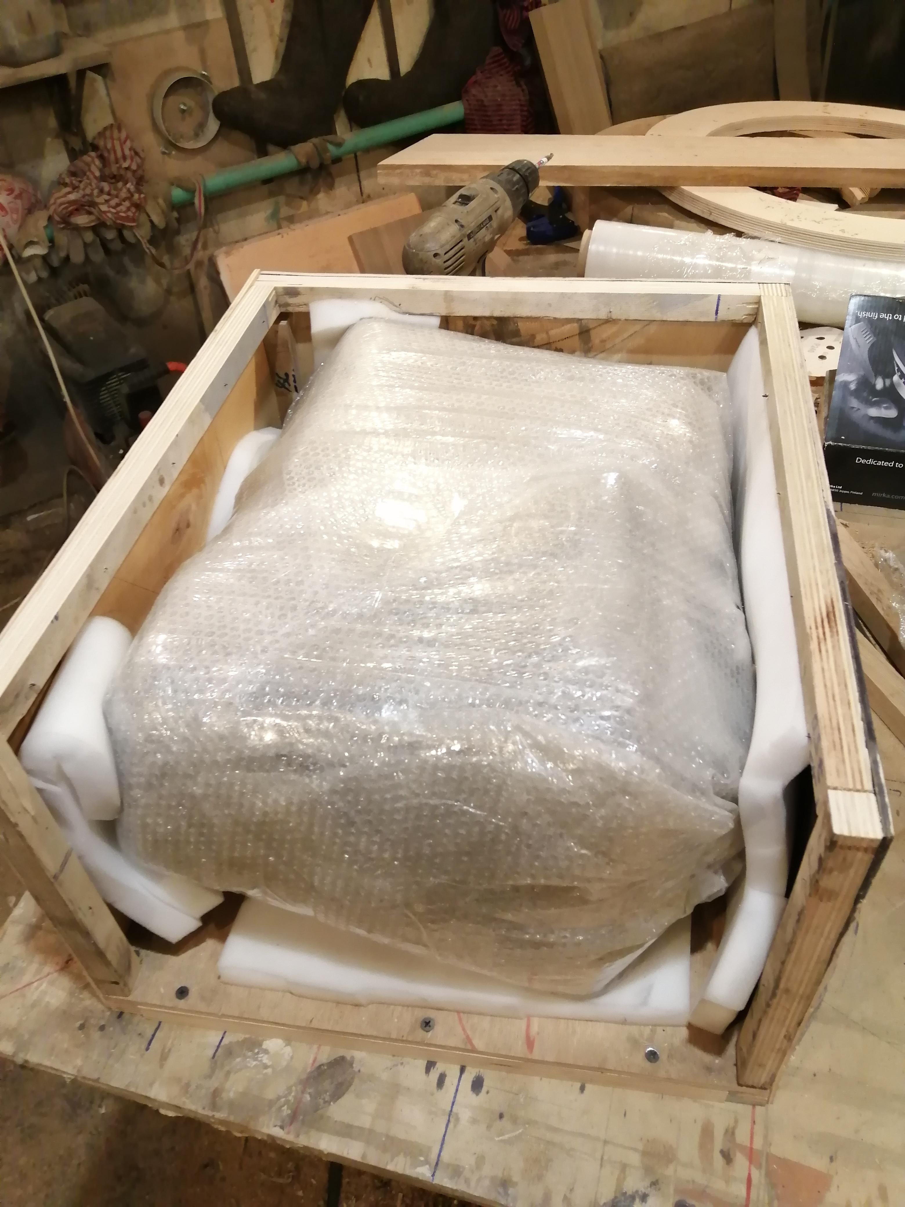

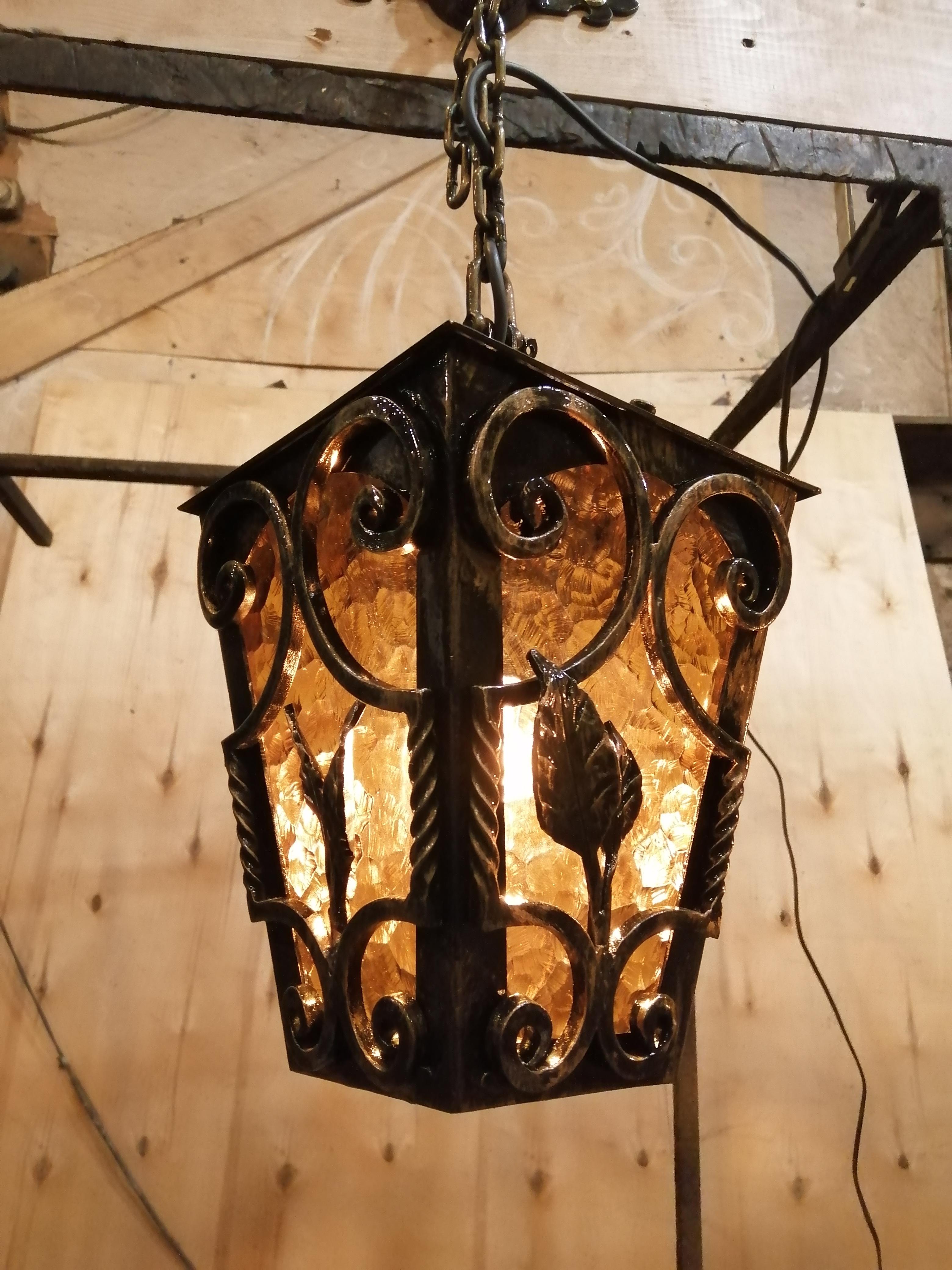

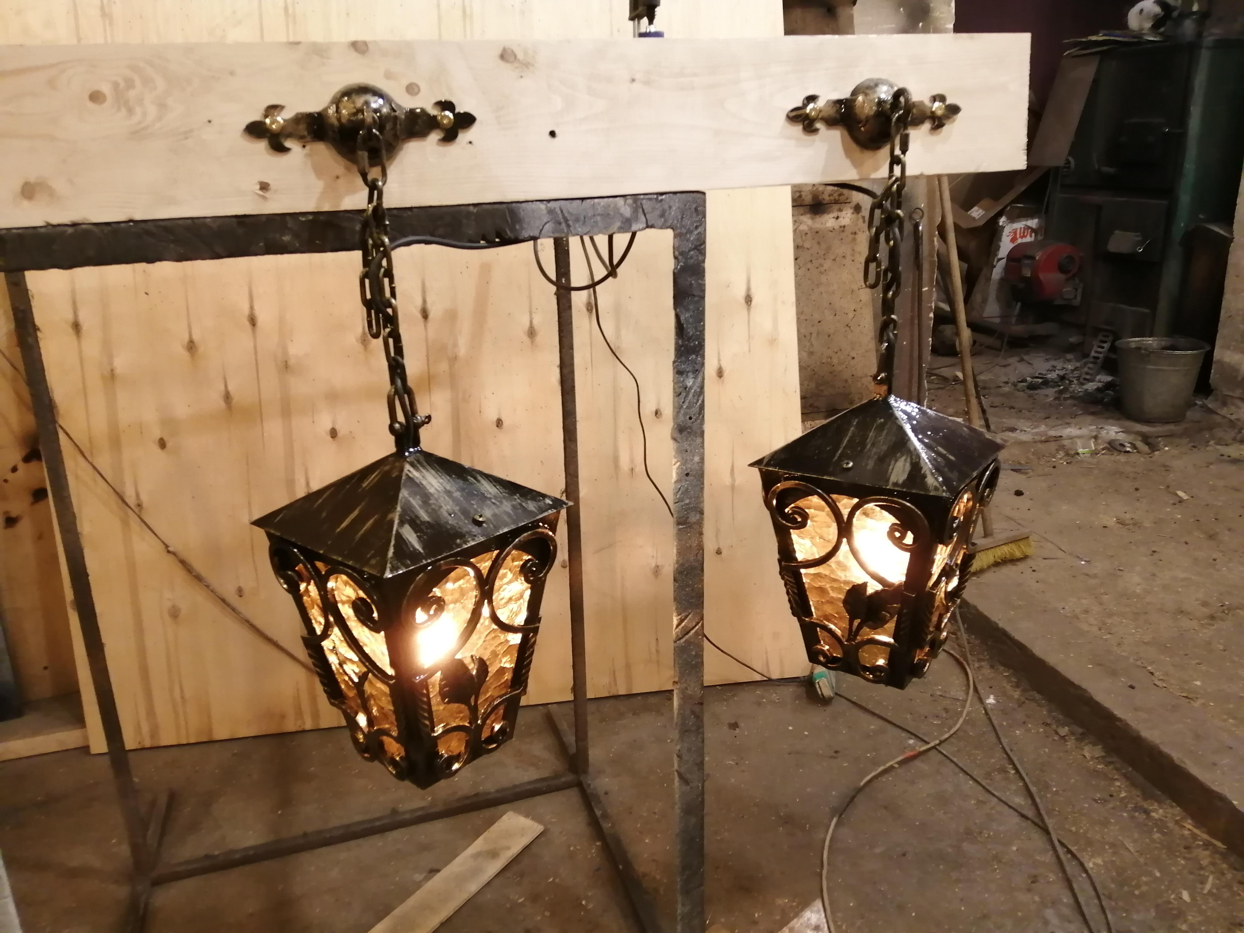

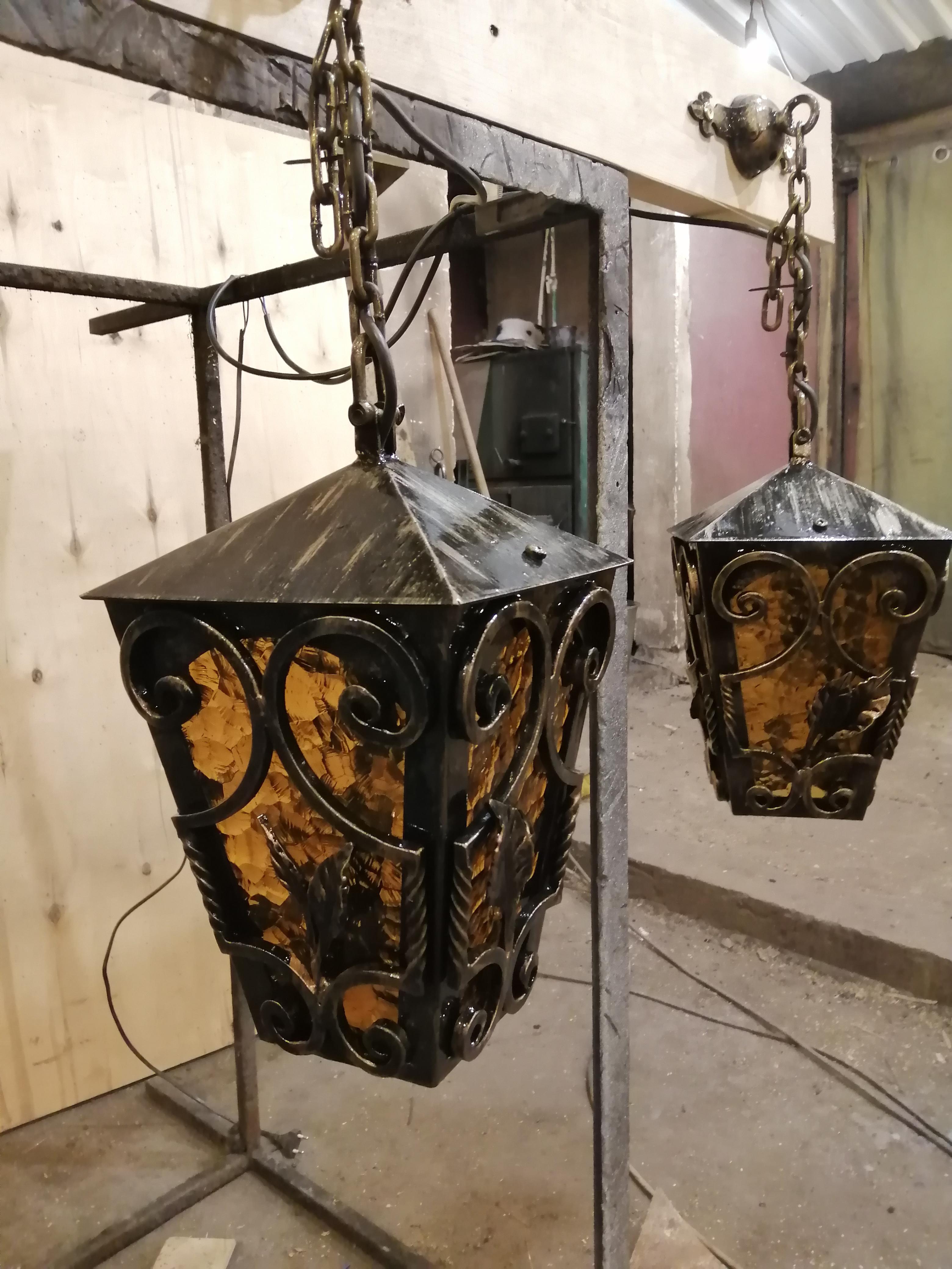

alexandr Posted February 16, 2022 Share Posted February 16, 2022 Another completed work. Spent 3 hours packing. The path is not near, to Texas. Quote Link to comment Share on other sites More sharing options...
Frosty Posted February 17, 2022 Share Posted February 17, 2022 Beautiful as always Alex. You're spreading happy customers all over the planet. Frosty The Lucky. Quote Link to comment Share on other sites More sharing options...

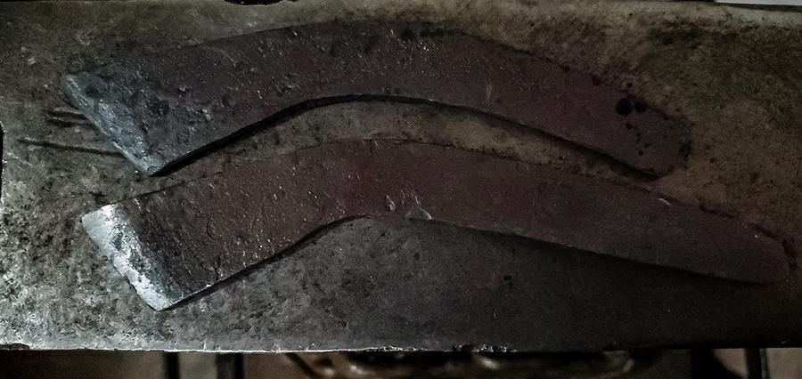

Fire plus Bird Posted February 17, 2022 Share Posted February 17, 2022 Just starting to dink around with knive making after deciding it was something I wanted to try several years ago. Figured I'd start with something simple, so I banged out these two kiridashi preforms from some steel I got from my pops. He's pretty sure it's 5160 that someone gave him (99 percent of the steel he smiths with is used/recycled). These to have had two normalizing sequences and are now annealing in vermiculite. I forged the slightly shorter one second and I like it's lines better. Because the first one I banged out is probably a bit longer than it needs to be, I think after I quench it I'll chuck it in a vice with just a bit of the tail end exposed and crack it with a hammer so I can see the crystal structure. I'll be able to grind the tail round and it should be good to go. For making knives, I'd think toughness would be a bit more important than overall hardness, so I was thinking two temper cycles at 450F, yeah? Quote Link to comment Share on other sites More sharing options...
Frazer Posted February 17, 2022 Share Posted February 17, 2022 Generally I would anneal then normalize, harden, temper. Depending on the alloy and whether or not I need to do any file work I'll drop the annealing step in vermiculite and will just normalize. Checking the grain structure is a good idea. If you have an old worn out file you can break that too to compare your grain structure to a factory HT (this only works if the file is through hardened). As far as the tempering temp goes, it depends on the use. On my kiridashi for cutting leather I tempered twice at 375 since I was more interested in edge retention than toughness. I also only quenched the end that would become the edge; the rest of it is just normalized. For a harder use knife toughness might indeed be more important than hardness, so a higher tempering temperature or differential tempering might be more appropriate. Quote Link to comment Share on other sites More sharing options...
Fire plus Bird Posted February 17, 2022 Share Posted February 17, 2022 (edited) Anneal then normalize, huh. I've always seen people doing it the other way, but I'm the noob. I agree that hardening the blade end only is the way to go. I'm only going to fully harden the long one so I can to the grain structure check. Good idea about checking another piece of fully hardened metal to compare. I don't know if any of my files is fully hardened vs just surface/case hardened. Luckily, there are lots of pictures only that show grain structure, so that should help. Edited February 17, 2022 by Mod30 Excessive quoting Quote Link to comment Share on other sites More sharing options...
ThomasPowers Posted February 17, 2022 Share Posted February 17, 2022 Annealing tends to increase grain size while normalizing decreases it as you want it small normalizing then annealing is going backwards. I anneal, if I will be doing a lot of stock removal, file work, etc, on a blade; then do a multiple normalize, then harden, then triple temper or differential temper. Quote Link to comment Share on other sites More sharing options...
Glenn Posted February 17, 2022 Share Posted February 17, 2022 Annealing Annealing is very similar to tempering. The metal is heated and held at a temperature for a period of time and then allowed to cool very slowly. The temperature allows the carbon in the steel to form carbides and then allows the carbides to grow larger. By allowing the carbides to grow large, the steel becomes softer. A full anneal involves heating the steel until it is fully austenitic. As we learned in the discussion about phase diagrams, this temperature will be determined by the carbon content. However, if the carbon content of the steel is not known, heating to a bright red heat will have to do. Holding is difficult to do in a coal forge but any time spent at high heat will achieve more than just heating and slow cooling. By slow cooling, we mean cooling in ashes or vermiculite for 12-24 hours. This gives more time for the carbides to grow and results in a softer steel. Sub-critical annealing, or heating to a lower temperature, will soften steel but not as much as a full anneal. Sub-critical annealing involves heating to a dull red and slow cooling. This may be sufficient for low carbon steels. Normalizing Normalizing is also similar to annealing. It requires the steel to be fully austenitic and this means heating to an orange to yellow heat, depending on the carbon content. Cooling is done in still air rather than slow cooling in ashes or vermiculite. Normalized steel will be harder than annealed steel. Some steels should not be normalized, such as the air-hardening grades of tool steel. They will get almost as hard from normalizing as they would if you intended to fully harden them. Tempering In many old books on blacksmithing, the word "tempering" actually referred to the hardening process. "Drawing" was the reheating of the piece to achieve the final hardness. Today, the process of heating and quenching is called "hardening" and the reheating afterwards is "Tempering". The alloy content of the steel affects how quickly the carbon can form these carbides. Molybdenum is a very potent alloy used to create a deep hardening steel and it slows down the movement of the carbon during tempering. This has the effect of maintaining high hardness at high heat. That is why hot work die steels like H12 or H13 have a lot of molybdenum in them. Molybdenum is also used in high speed steels (the "M" series) so that they do not become soft when they heat up due to friction. The surface of the steel will change colors during tempering if you remove the scale and brighten the surface before tempering. The color indicates the temperature of the steel, NOT the hardness. For this method to be effective, you must have some idea of the alloy content of the steel so you can choose an appropriate temperature for tempering. A simple way to determine the appropriate temperature (and color) is to harden a sample piece of the steel you are working on, preferably something about 6" long. After hardening the entire piece, grind the scale off, sand the surface smooth, and heat it from one end only. Stop when the opposite end is just a light straw. Quench immediately to preserve the colors. Take a file and strike a line through each color. When you hit steel that is harder than the file, it will leave no mark. This will give you an idea what color is appropriate for the steel. This assumes that you are trying to achieve a high degree of hardness. Tempering to lower hardnesses will improve toughness. Tempering of tools usually involves heating to the range of 400-600F. This can actually be done in your kitchen oven with a high degree of accuracy and success. Get the oven up to temperature before you put the steel in it and allow at least one hour per inch of thickness for a holding time. Minimum tempering time should be one half hour regardless of thickness. Double and triple tempering often improves hardness and toughness but every time you temper, you should increase the temperature by about 25-50 degrees. Reference metallurgy-of-heat-treating-for-blacksmiths Quote Link to comment Share on other sites More sharing options...
Fire plus Bird Posted February 17, 2022 Share Posted February 17, 2022 Great info. Thanks guys. I guess after I clean up the profiles on these two and flatten the backs I'll re-normalize them a few times to bring the grain size back down if possible. It will be interesting to see what the destructive testing shows. I was taught that the first time you make something new, as in start a new craft, you should give it away. I have a few friends I have in mind to give kiradashis to. However, I think I should treat these as pratice pieces as far as heat treating goes and, having learned what I can, make some more to give away. Quote Link to comment Share on other sites More sharing options...

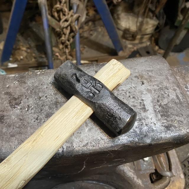

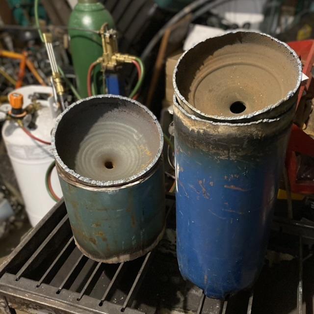

JHCC Posted February 18, 2022 Share Posted February 18, 2022 Speaking of which: Although I did finish another ball fuller: And torched the ends off a couple of welding tanks, to make a couple more bowl forms. So, painful, but productive. Quote Link to comment Share on other sites More sharing options...
Irondragon Forge ClayWorks Posted February 18, 2022 Share Posted February 18, 2022 Ouch, that looks painful. The ball fuller looks good though. Quote Link to comment Share on other sites More sharing options...
JHCC Posted February 18, 2022 Share Posted February 18, 2022 Thanks. Still needs a bit of grinding, but I think it will do what I want it to do. Quote Link to comment Share on other sites More sharing options...

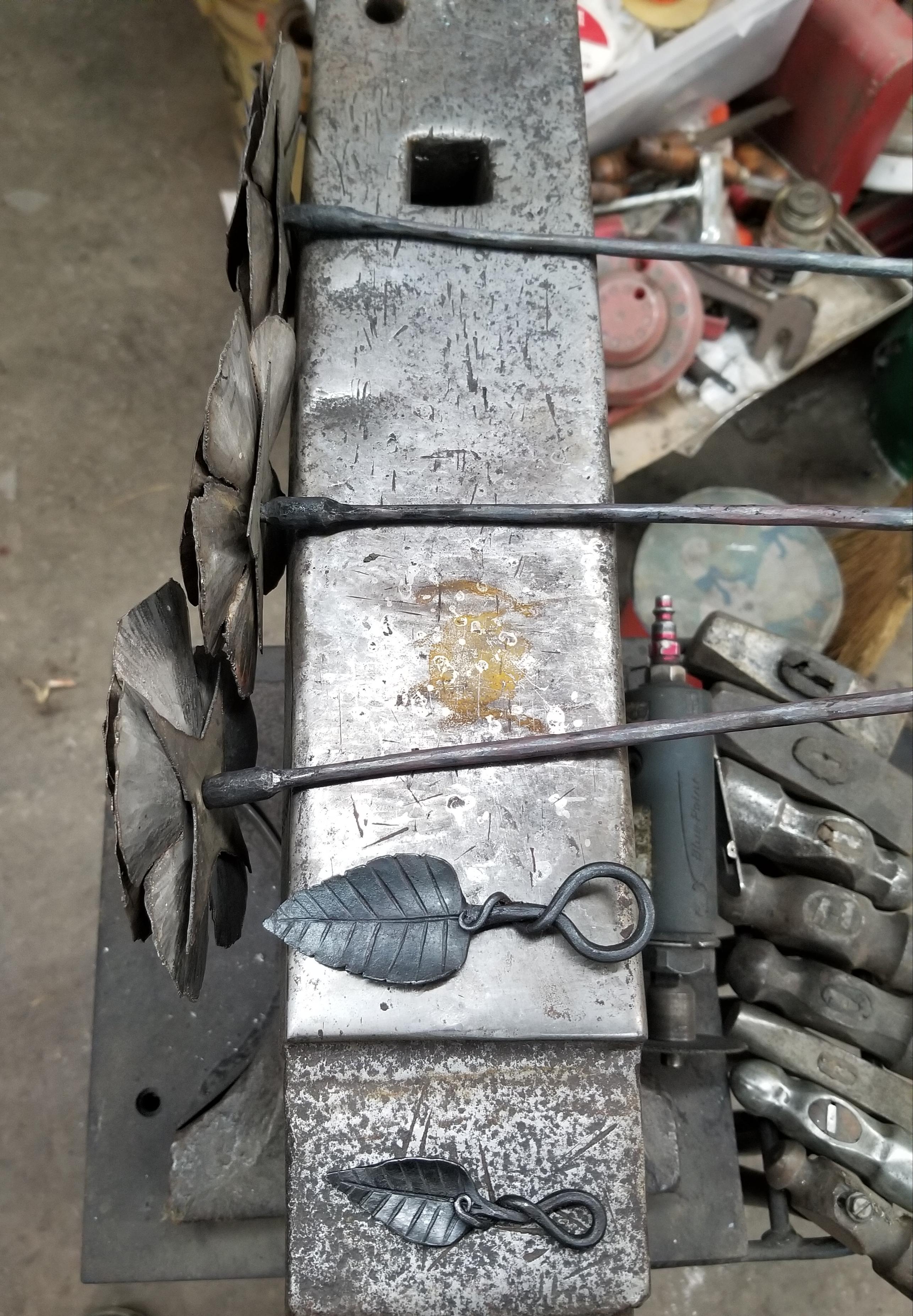

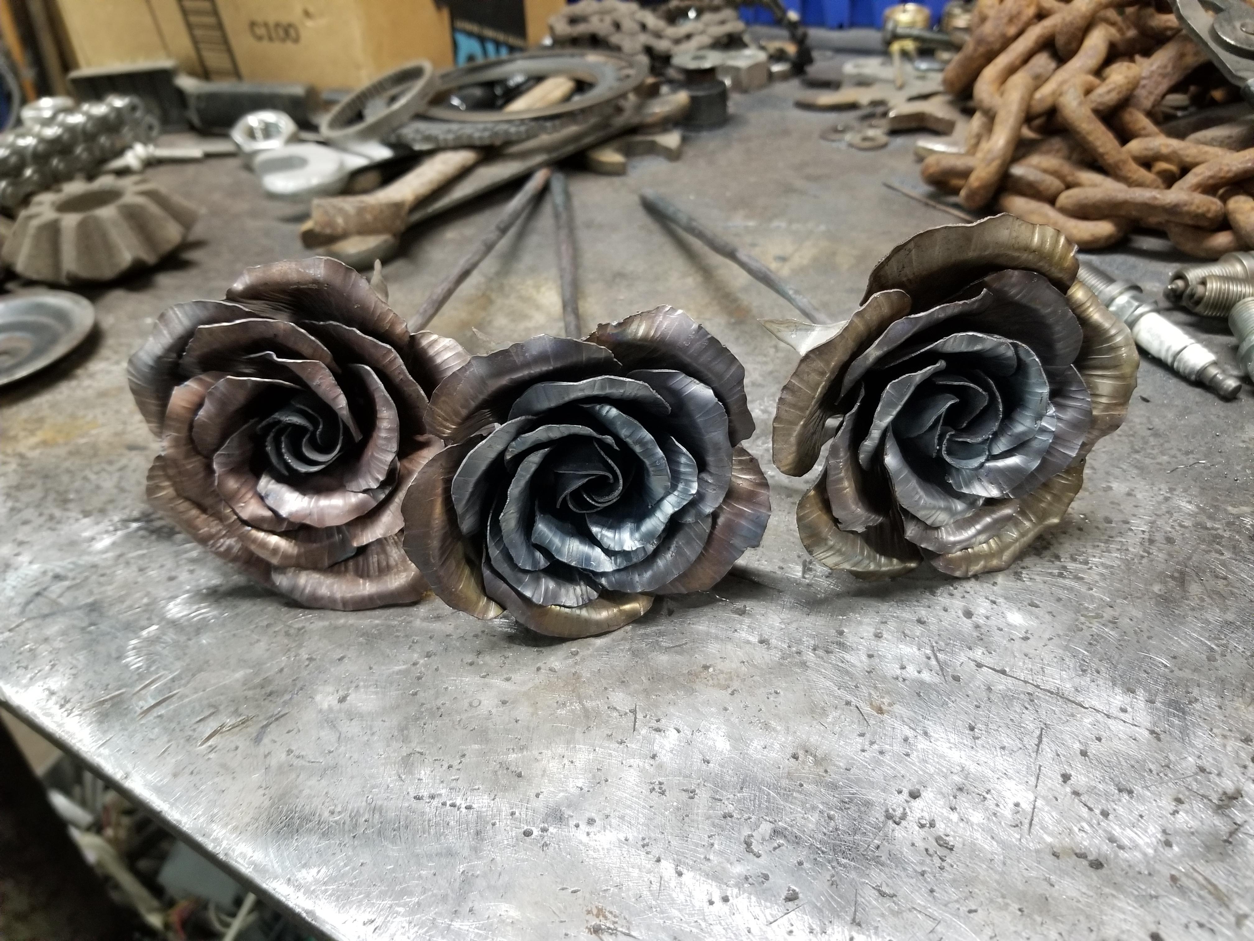

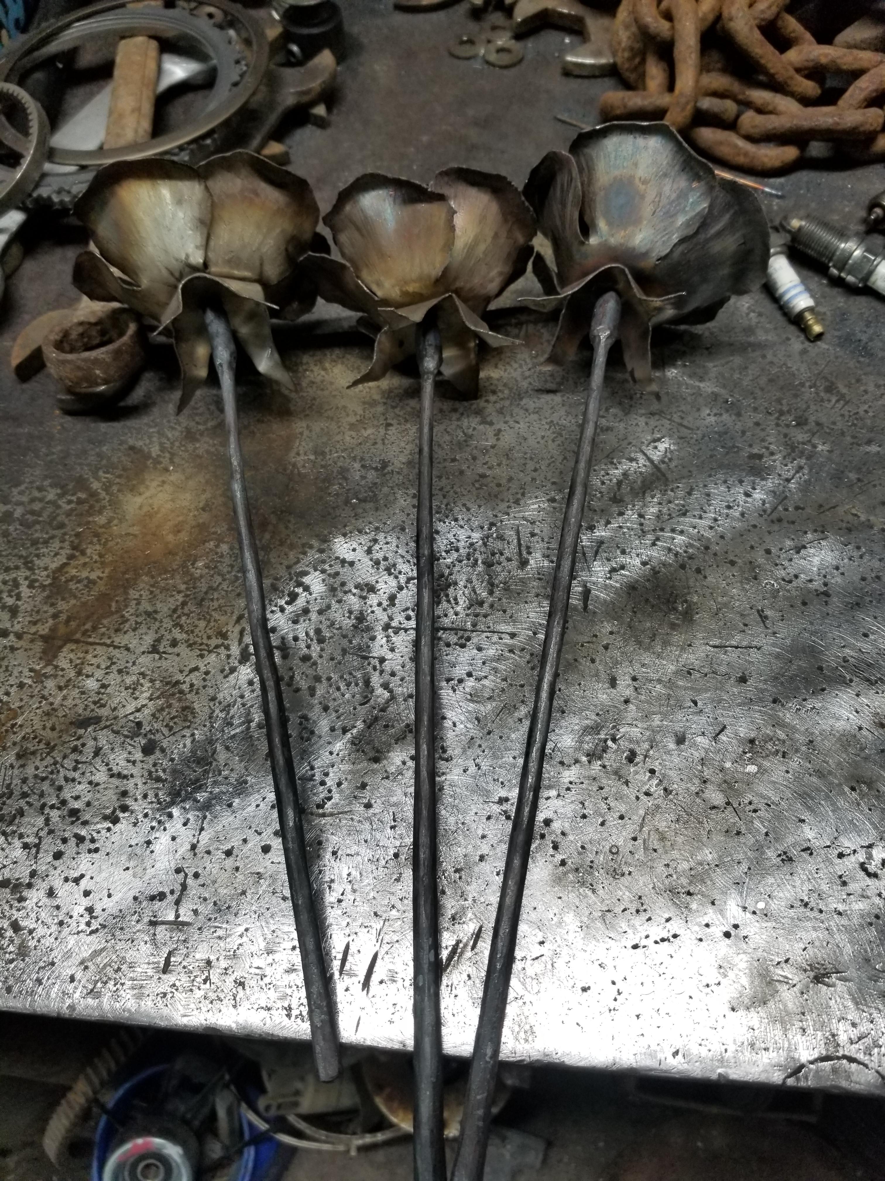

Daswulf Posted February 18, 2022 Share Posted February 18, 2022 I wouldn't suggest grinding on your hand any more. Blacksmith self surgery is Usually bad unless removing a metal shard. Im behind on new merch for an upcoming event but I Have to get these three roses done. All that is left is to forge leaves and weld them and thorns on. Petals are stainless. Funny enough I started with the OA torch shaping the petals on the first. After that I remembered the mapp gas torch is enough and easier. When finished i realized the higher heat of the torch did better to my liking. I will have to toy with that later. Tomorrow is leaf day. Quote Link to comment Share on other sites More sharing options...
