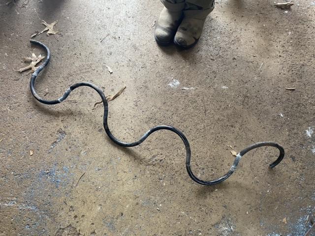

JHCC Posted February 15, 2022 Share Posted February 15, 2022 8 hours ago, Gandalfgreen said: JHCC i have not forgot about my stuff at your place No worries! Another thing from Sunday: needed to straighten some coil spring and had an idea to break out the treadle torch for it. I heated up 2” sections 180° apart and twisted them each 180° out, resulting in the following S-shape: This was then straightened further in the forge. Worked pretty well, but in retrospect, every 90° would have given a gentler curve that would have fit in the forge more easily. Next time. Quote Link to comment Share on other sites More sharing options...

BillyBones Posted February 15, 2022 Share Posted February 15, 2022 JHCC, when i glanced at the pic i thought it was a snake at first. Quote Link to comment Share on other sites More sharing options...
JHCC Posted February 15, 2022 Share Posted February 15, 2022 If there were a snake that big in my forge, I doubt my student would have been standing so still with her feet so neatly together. On the other hand, I could be wrong; she's pretty tough. Quote Link to comment Share on other sites More sharing options...
Gandalfgreen Posted February 15, 2022 Share Posted February 15, 2022 looks like snake for sure next one hammer into a snake haha. Quote Link to comment Share on other sites More sharing options...
JHCC Posted February 15, 2022 Share Posted February 15, 2022 Nah, the spring steel is for knives and tools! Quote Link to comment Share on other sites More sharing options...
ThomasPowers Posted February 15, 2022 Share Posted February 15, 2022 Sounds like a South American snake: La Coil-ebra. Quote Link to comment Share on other sites More sharing options...

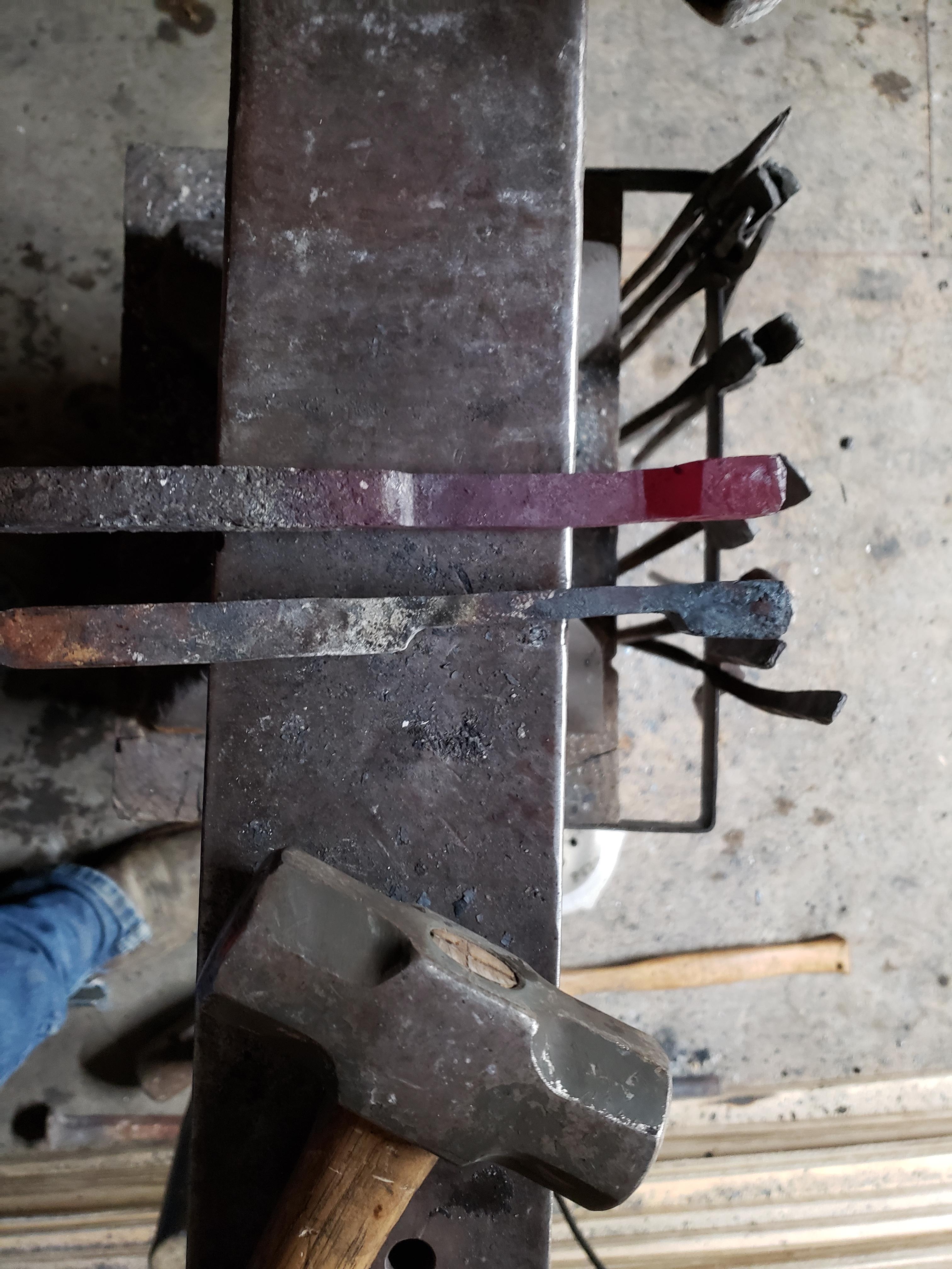

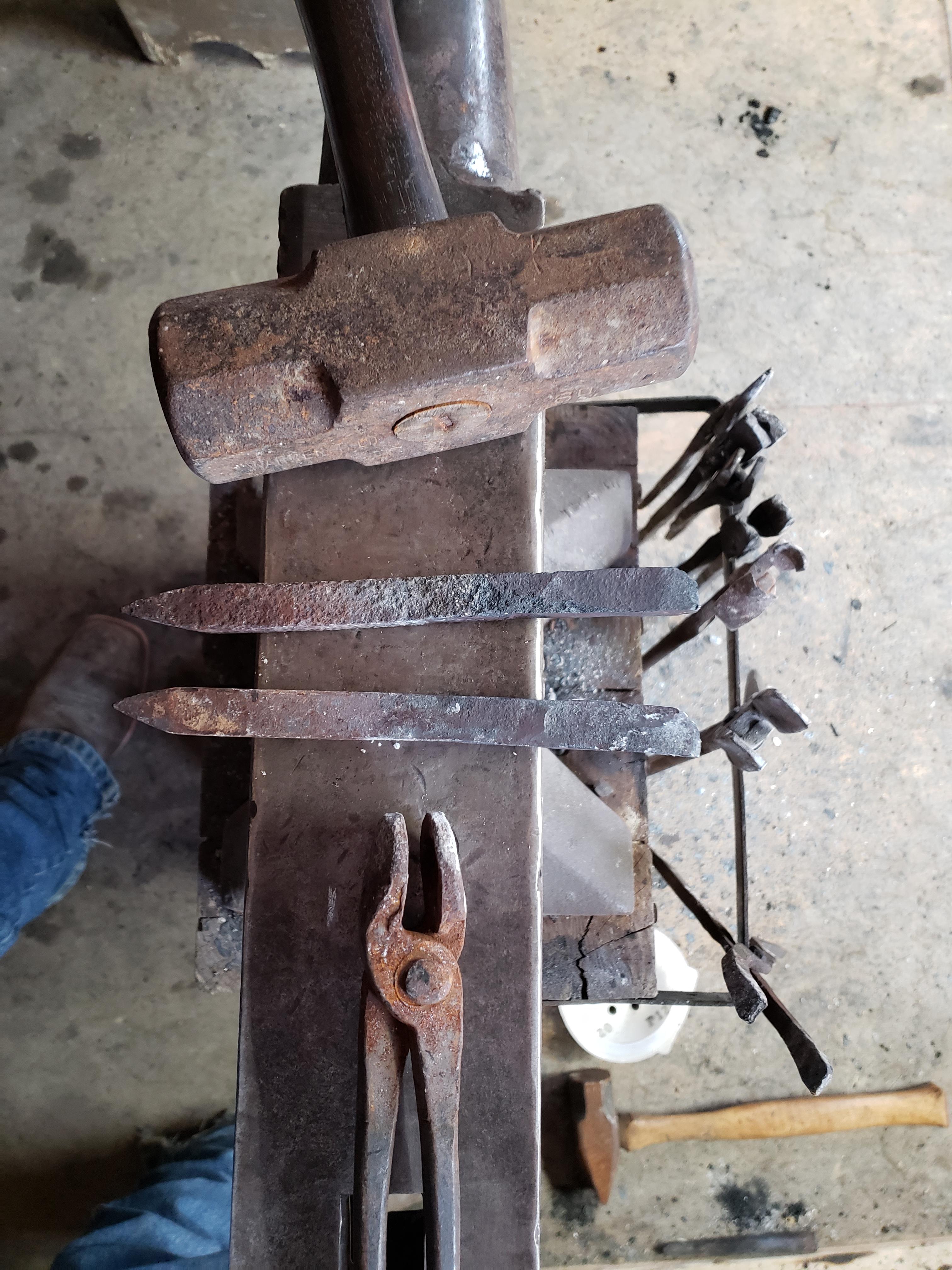

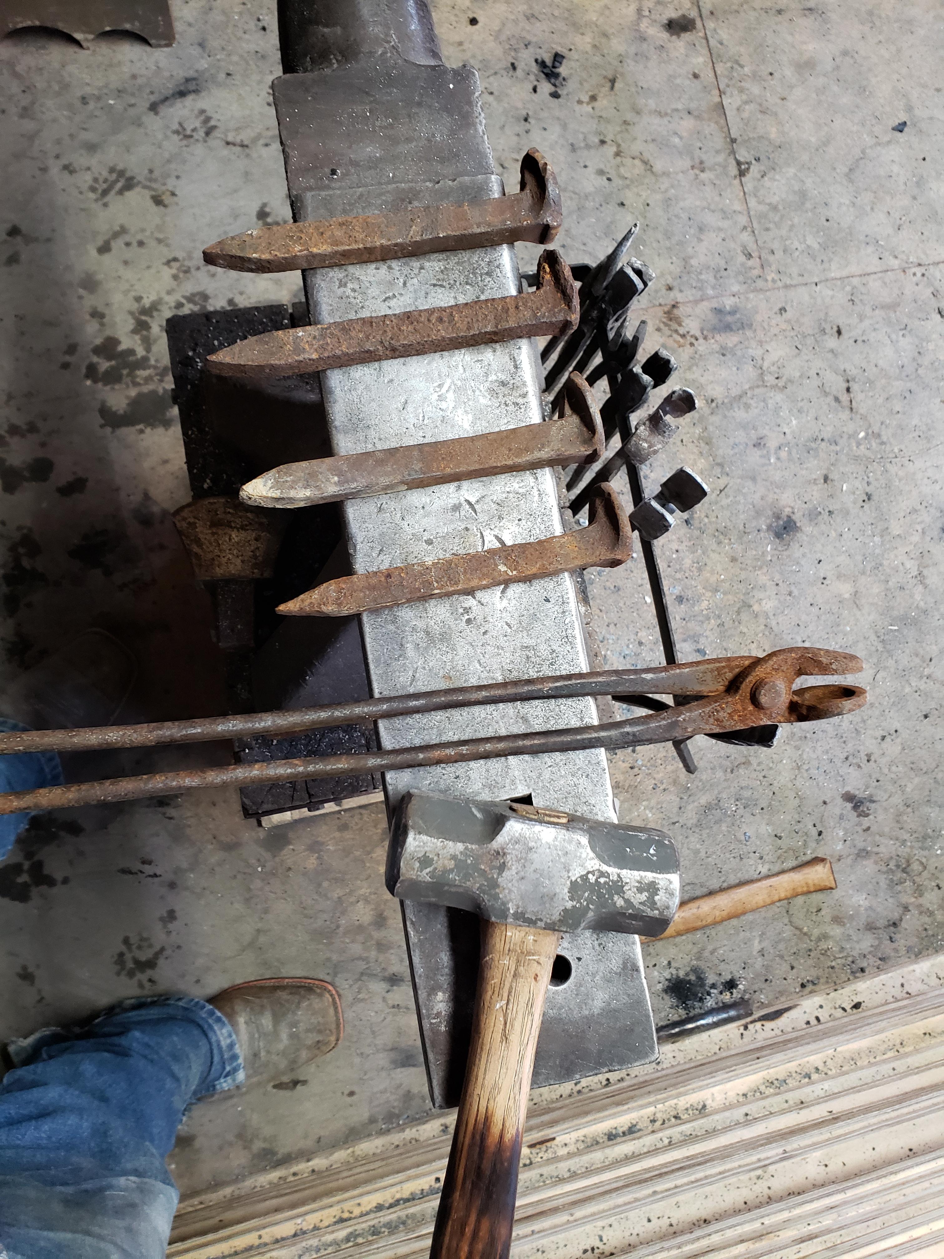

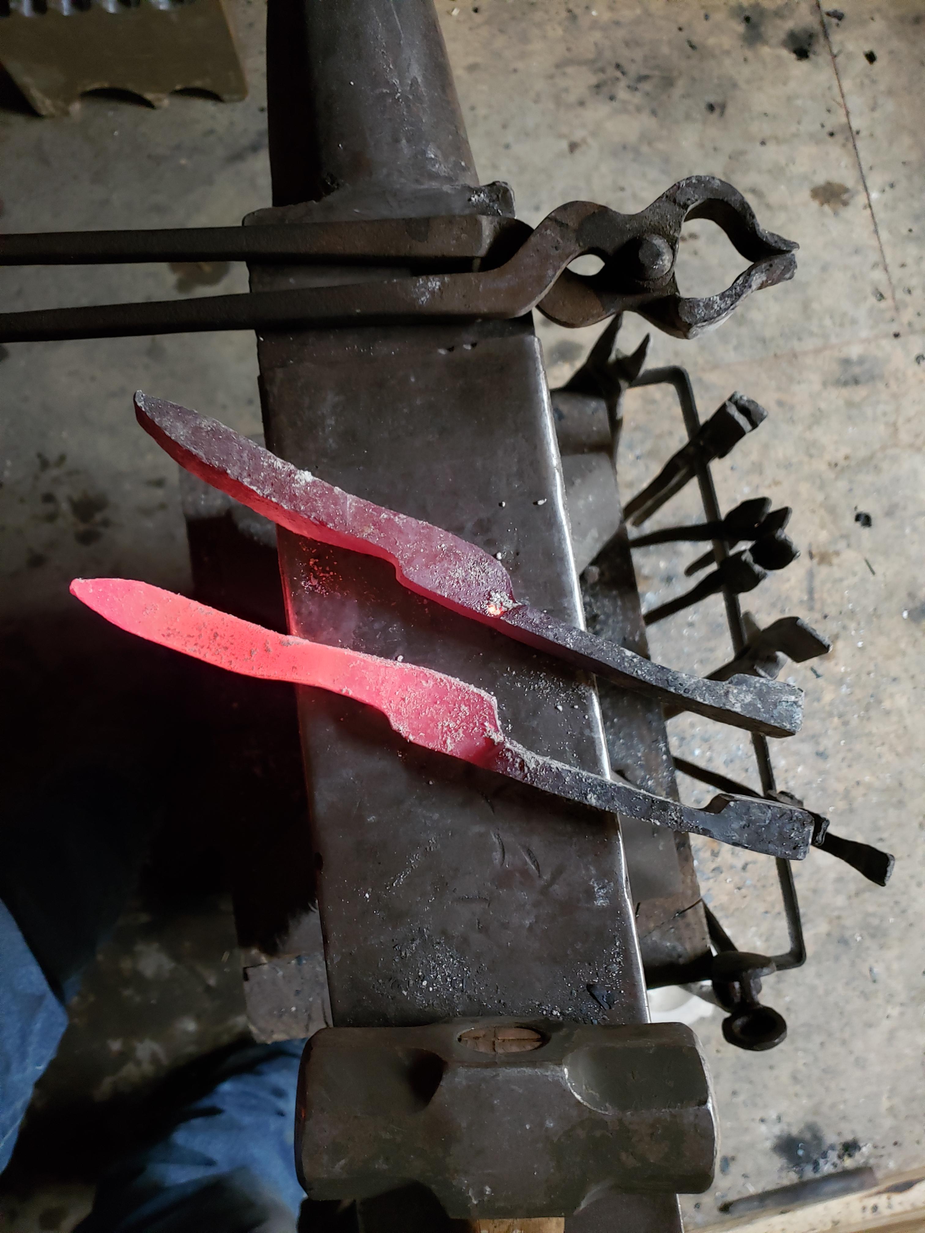

ChiefLittleBair Posted February 16, 2022 Share Posted February 16, 2022 Today I started a pair of bolt jaw tongs out or rr spikes, it was brought to an end when I brilushed my left elbow against the hood when I leaned in to check the steel while cranking the blower. Got a really nice burn on my elbow now.... packed some snow around it and kept going for a while, then when I went in for dinner it really started hurting. Put some aloe and honey on it and wrapped it up. Maybe I'll get back to the forge after work again tomorrow. For now, its quits Quote Link to comment Share on other sites More sharing options...

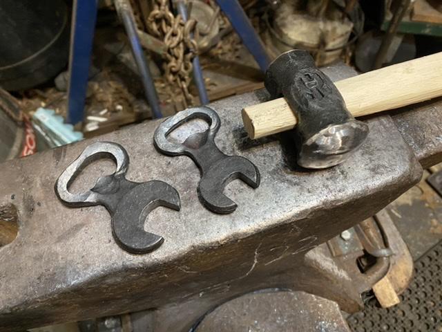

JHCC Posted February 16, 2022 Share Posted February 16, 2022 Looks good, CLB. Take care of that burn. I made an old wrench into a couple of bottle openers and forged a ball fuller out of a piece of car axle. Quote Link to comment Share on other sites More sharing options...

ChiefLittleBair Posted February 16, 2022 Share Posted February 16, 2022 17 hours ago, JHCC said: Looks good, CLB. Take care of that burn. I made an old wrench into a couple of bottle openers and forged a ball fuller out of a piece of car axle. Those are some neat bottle openers! I need to get ahold of some axle shaft to make a few hammers and top tools. My elbow is doing surprisingly well today. It itches more than it hurts, so it must be healing up. Quote Link to comment Share on other sites More sharing options...
