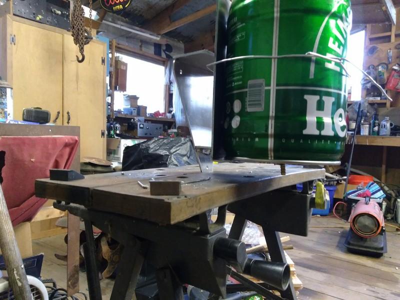

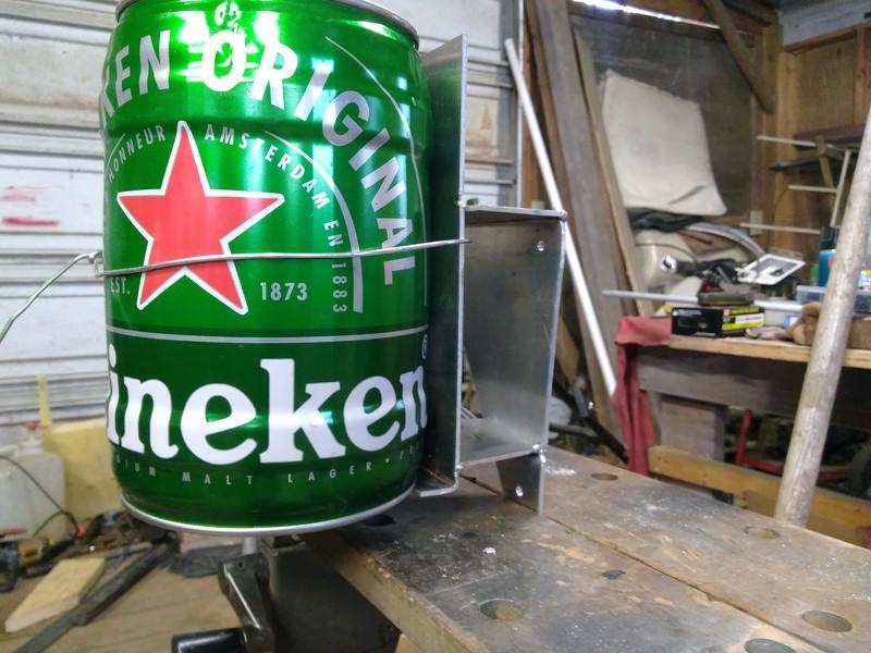

Too cold and windy to fool around at the forge. So, I set about the task of fabricating a larger gas tank for the air compressor at work. The existing tank may hold a litre if you're lucky.  I had a "mini keg" in the shop holds 1.32 gallons.  So I got the idea to make a gas tank of it. and fabricate a bracket of aluminum.  I still need to make the straps to hold it in place, and add anti chafe material.
You sure that that can withstand the pressures of an air compressor. I would be very reluctant to use anything that is not graded for an air compressor.
~Jobtiel
I believe he is making a gas tank for an engine run compressor, not the air storage tank. I would want at least a gas tank that would hold 5 gallon's, I made one for my generator because the factory one only held 1 gallon.
That's what I'm counting on. mabe 1.5-2 gallons?

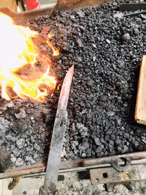

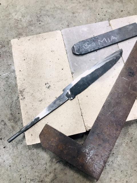

Spent some time working on my next knife. Got it forged out and cleaned up a bit.75BFB9A6-C12A-4122-B755-2F969DFE14DE.jpeg.af281839e7edf144b434da2466a7f746.jpeg733AB0E6-5562-4389-A7CE-ADDD15355813.jpeg.6786d78a10dbc89f5a54349d4f9ccb2e.jpeg

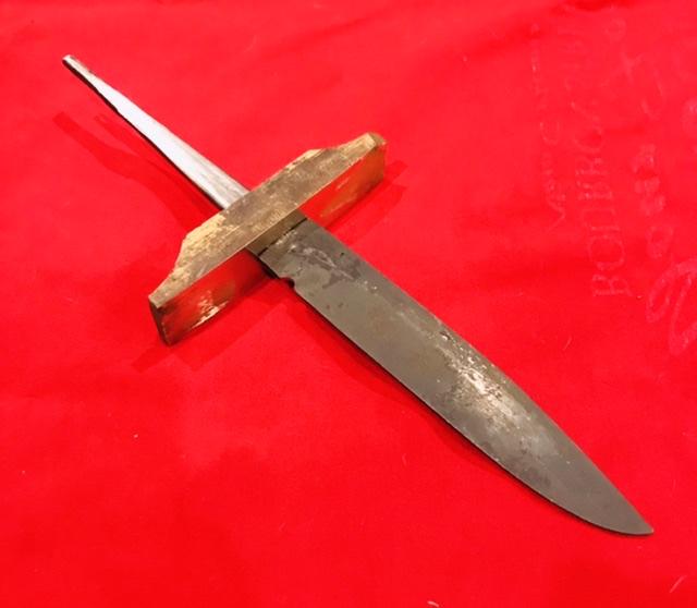

Then started on the guard. 50256493-B570-47CD-8741-F62DAB35454D.jpeg.e166c0efed95e4b96de4e21292c3e092.jpegEFCF0E53-9D84-47FD-9302-FD96FBE0C89D.jpeg.45838854ac13449dd88c5567177bfd05.jpeg
No, the guard is not going to be so ridiculously large. It was much large and needs a lot more.
