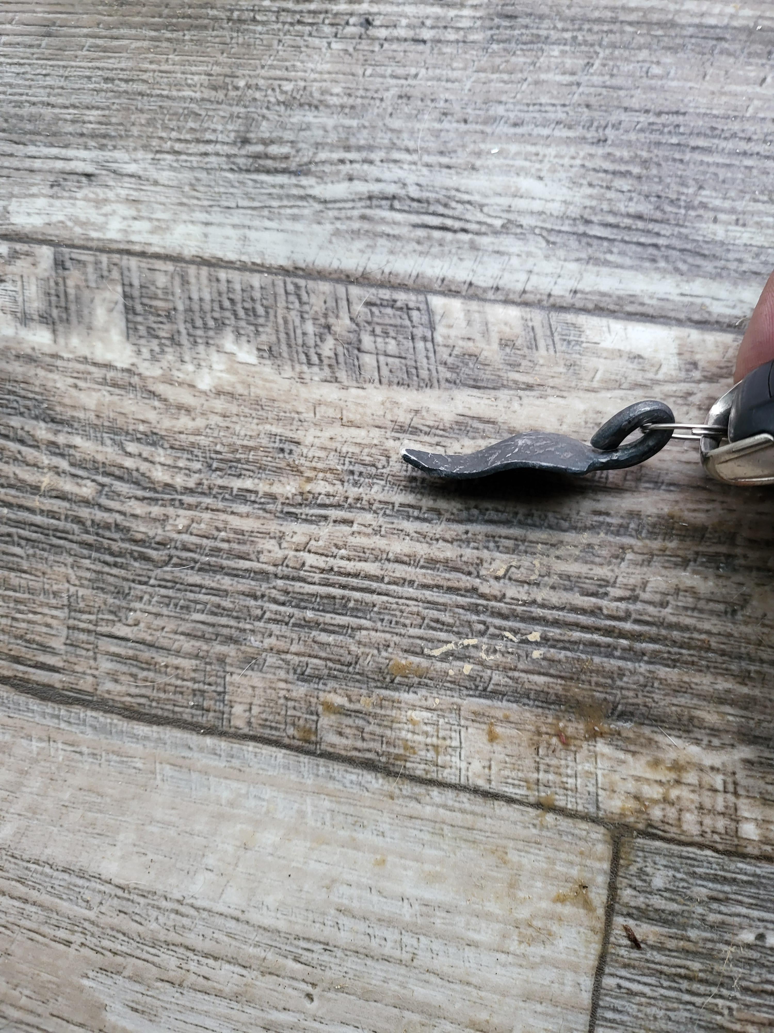

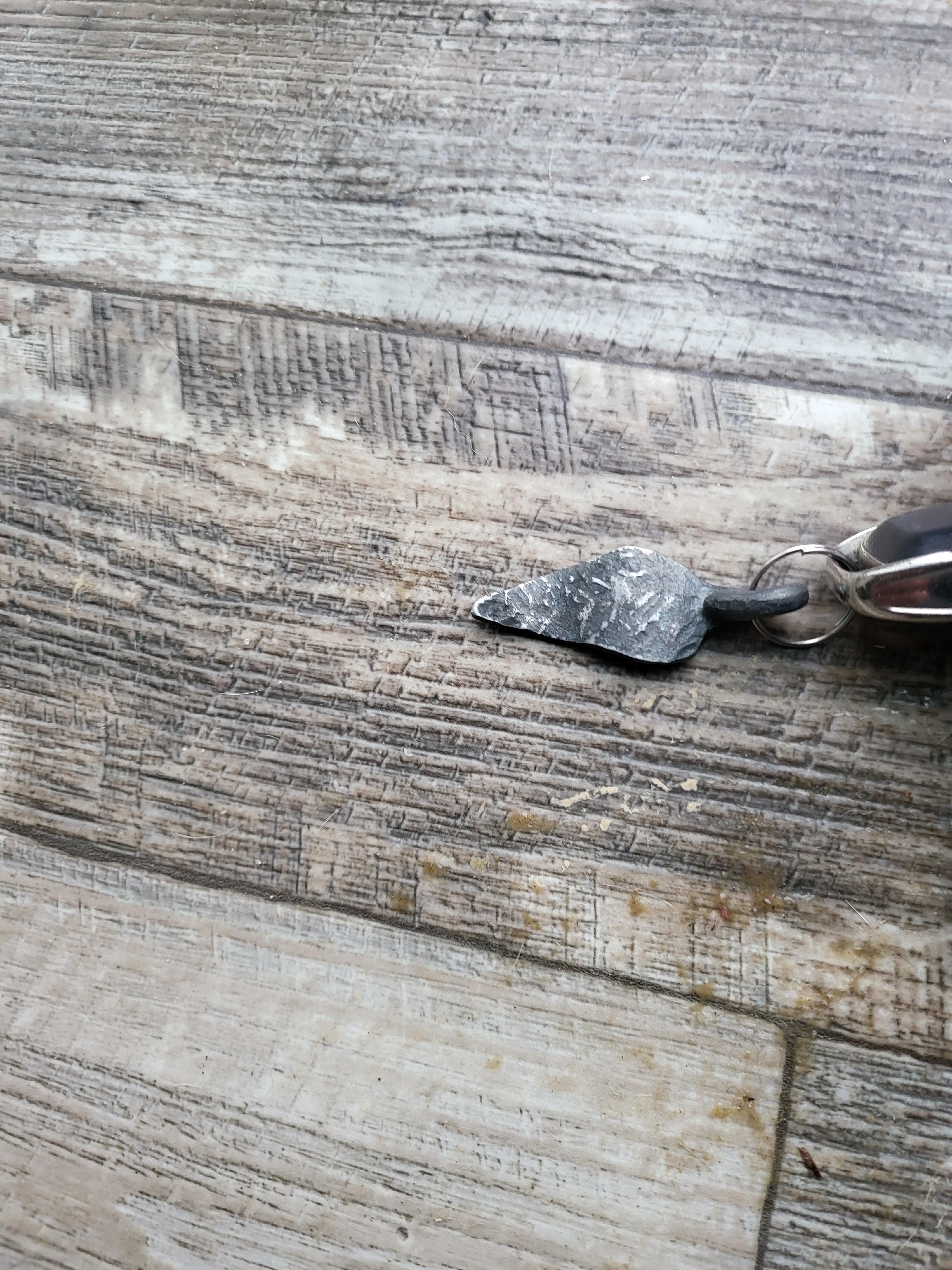

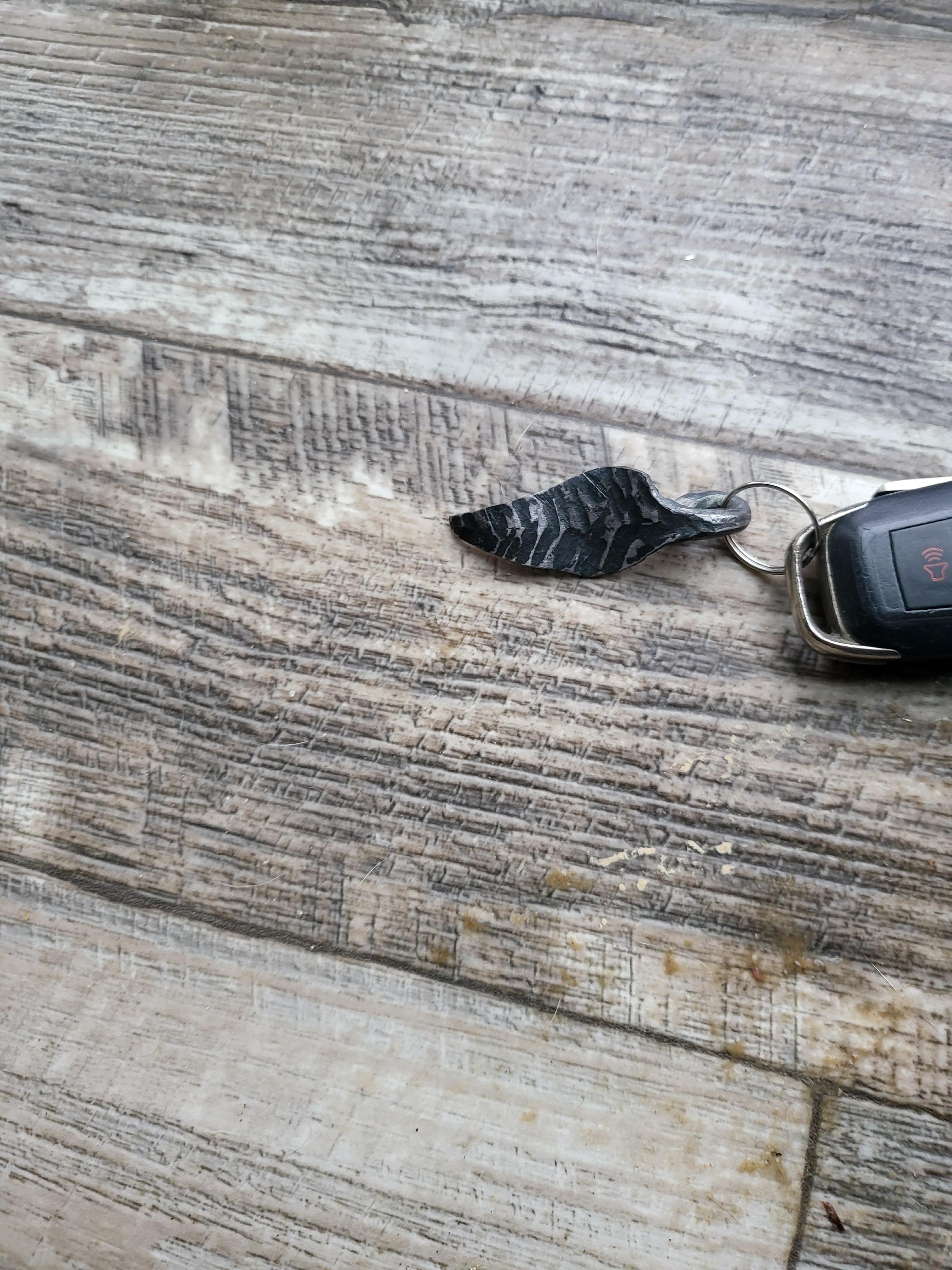

February 9, 20224 yr Had 15 minutes this evening quick leaf. Nothing yesterday, basketball season so off to watch the kiddo play again tonight.

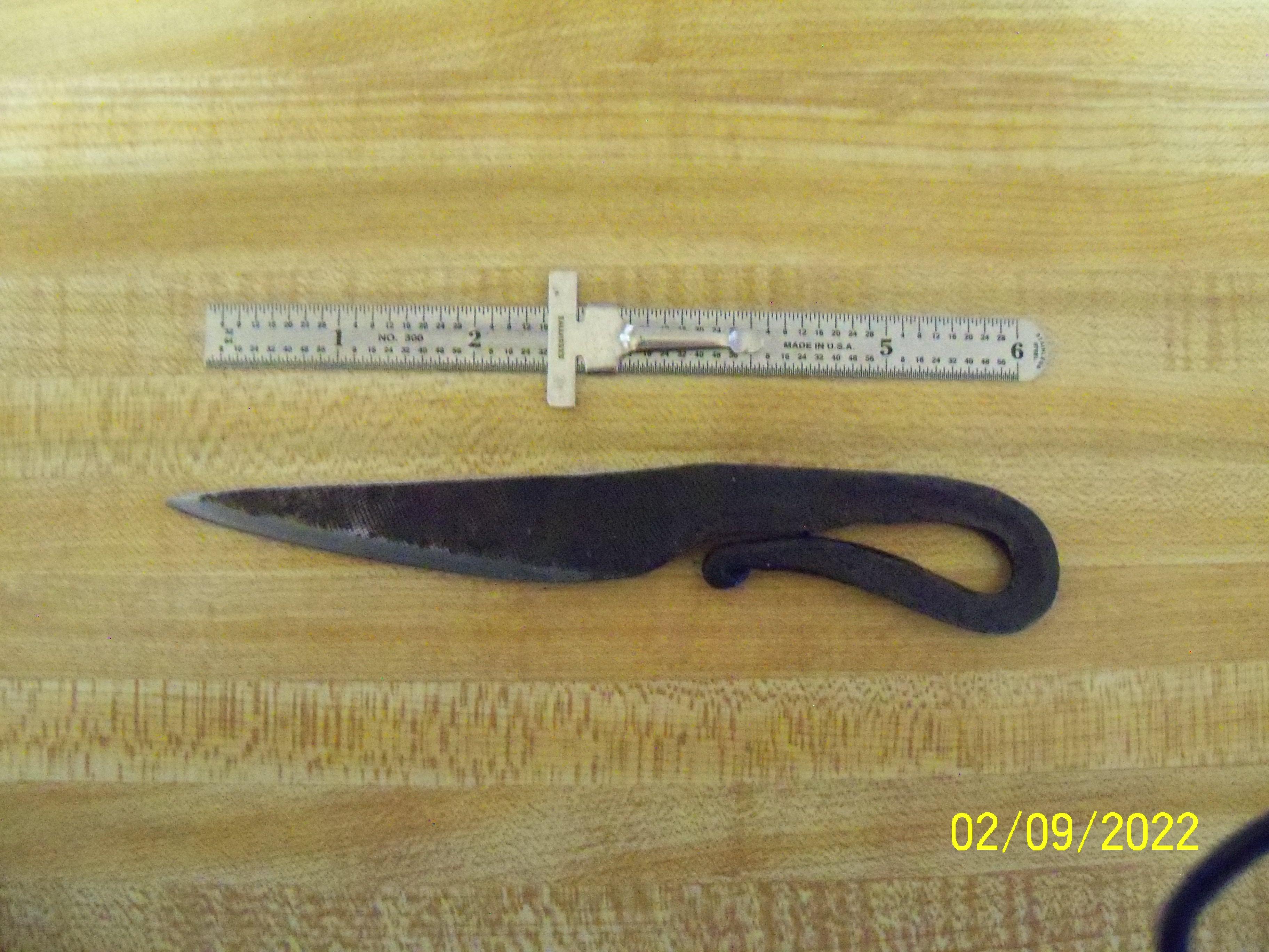

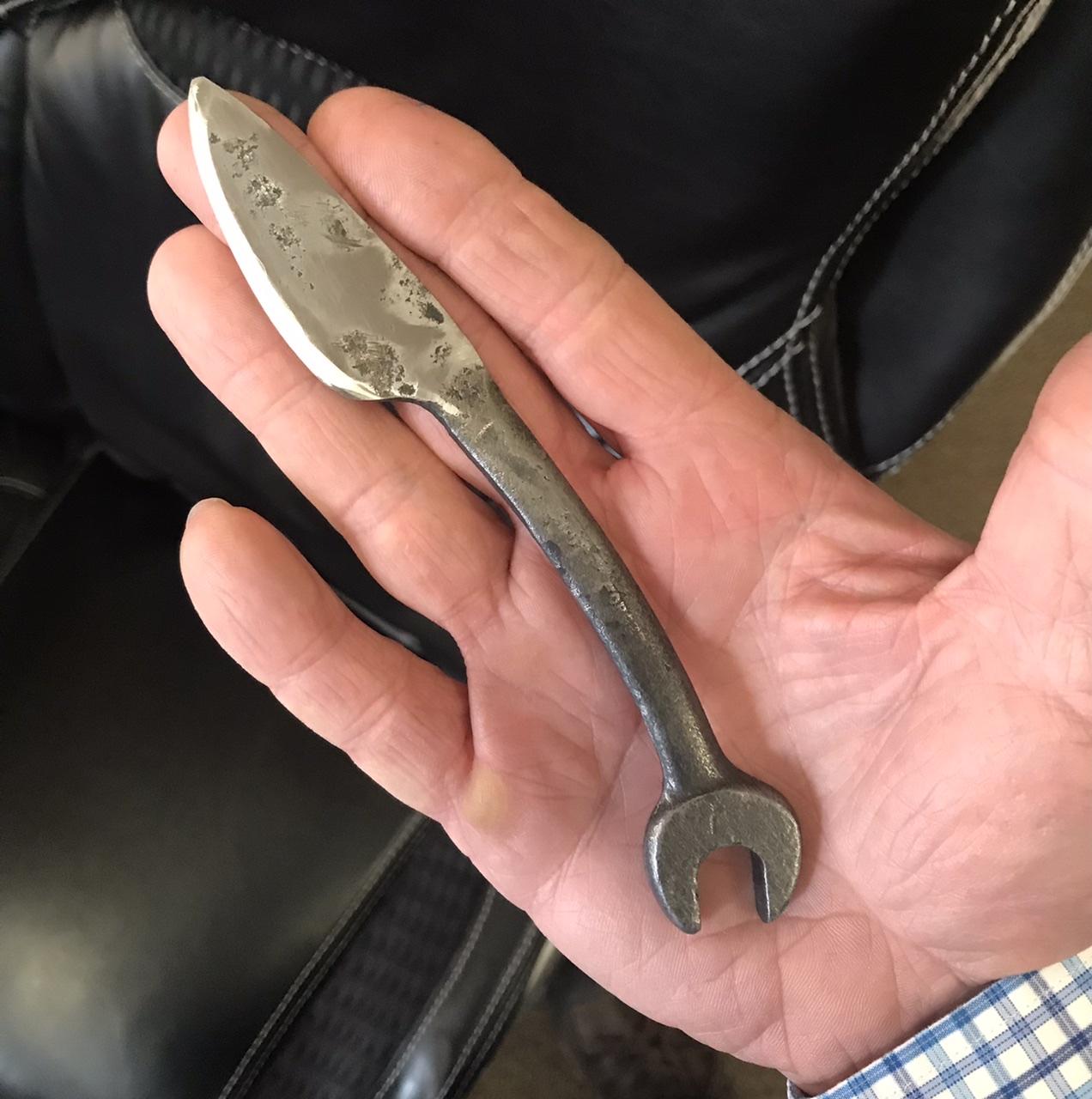

February 9, 20224 yr The trade item for our BOA meeting this Saturday is something that cuts. So I made a cute little blacksmith/ladies knife out of an old file. Actually that is the second one I had to make. While forging the first one the tang (handle) snapped off. I have a habit of knocking the stock against the forge when pulling it out of the fire, to knock the coal off before hammering, completely forgot with thin stock there is a possibility of breaking it especially with HC steel. You would think after all these years I would remember that.
February 9, 20224 yr File can be chancy stock in the winter anyway. Even down here contact quenching can be an issue.

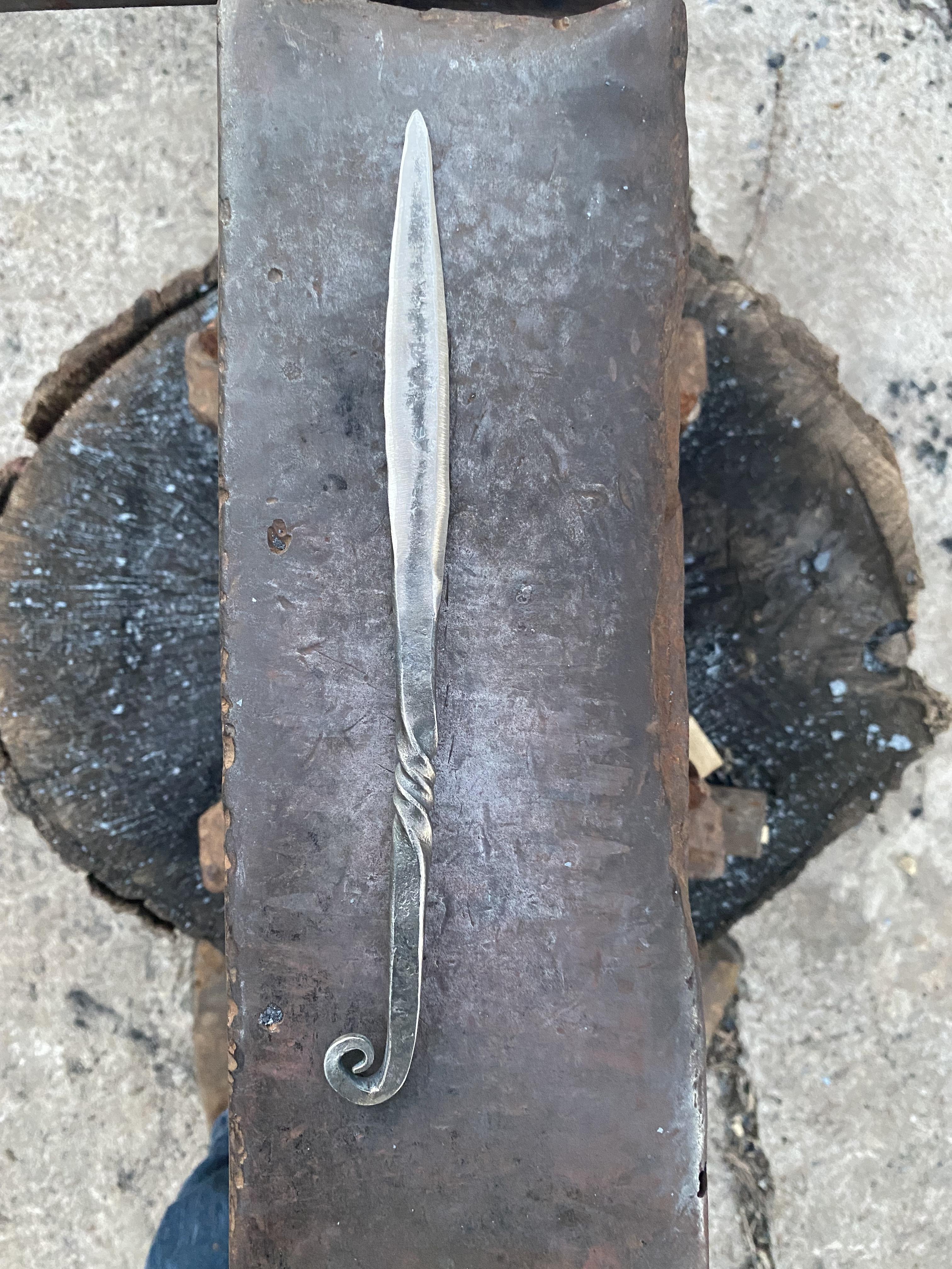

February 10, 20224 yr Looks awesome Irondragon! you beat me to posting my trade item for the meeting Saturday, it’s a letter opener, I made it from a piece of drive shaft out of a pole saw, I have no clue what kinda steel it is but it took a lot of heat and was pretty hard to work for some reason, I had figured it was just some mild steel but apparently I was wrong it must be something else, I prolly shoulda done a spark test before messing with it, I forged it to shape then used a paddle wheel to dress it up

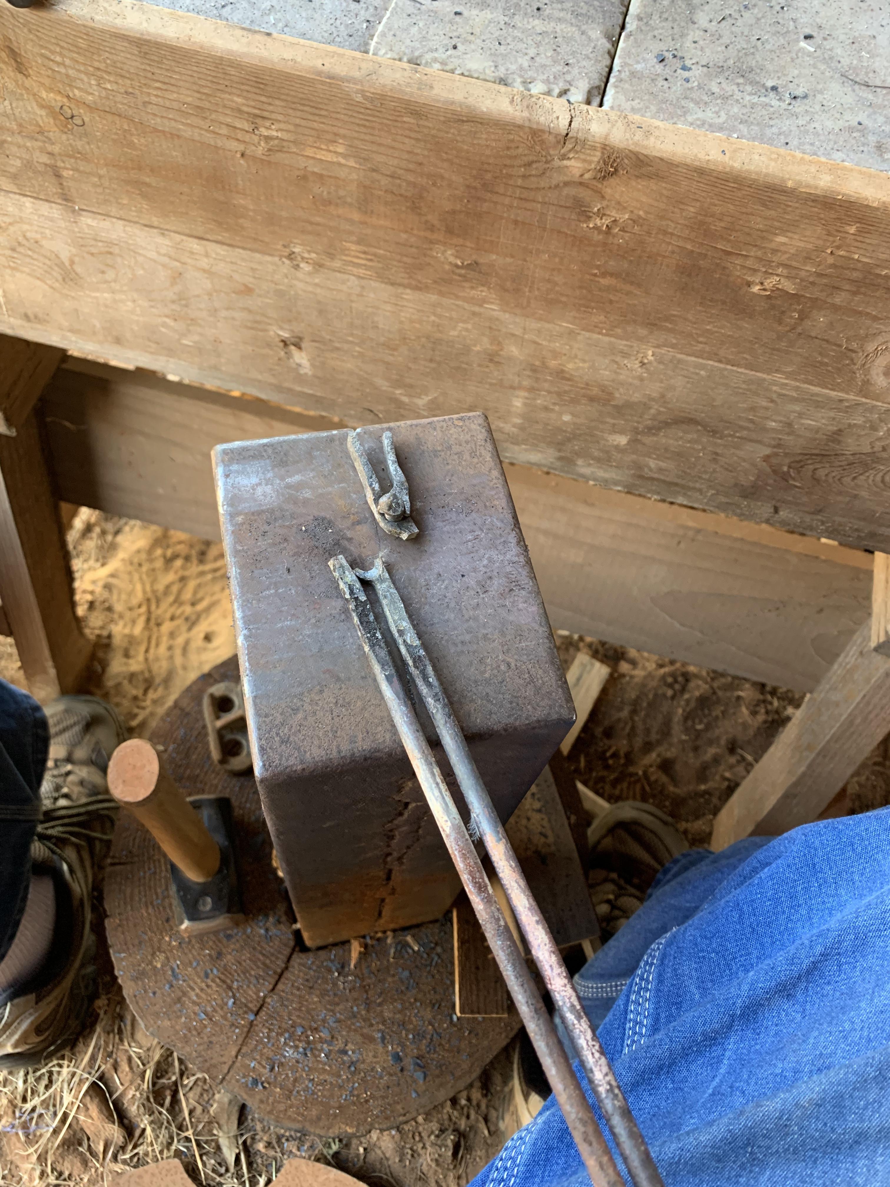

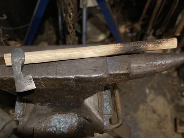

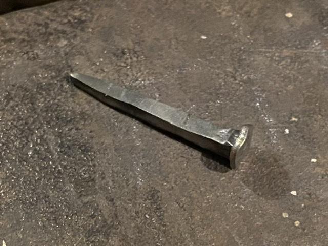

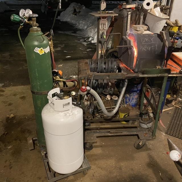

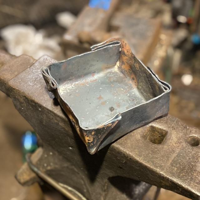

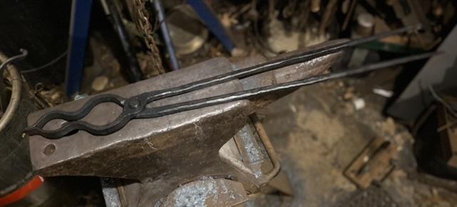

February 10, 20224 yr Knifemakers don’t make mistakes; they just make smaller knives. Bunch of little projects in the shop this evening. The biggest was finishing the rescue of a long-abandoned tong-making semi-failure, resulting in a decent pair of pick-up tongs: Made a replacement lucky nail for my daughter: Fitted the handle on the little axe: And played around with a hot-folded sheet metal container: Hardened the chasing tools I’ve been working on, and managed to spill canola oil all over the floor. Oops. Finally, I ran so low on propane that I had to borrow the tank off the oxypropane torch:

February 10, 20224 yr Yup, powered by a standard NARB. I didn't do a thread for the build, but there are some decent in-progress photos HERE and HERE.
February 10, 20224 yr John, looks like you are trying to re-invent the electrical outlet box. Bend the corner overlaps to go up and down so it can be mounted to a stud in the wall.... Spilled oil on the floor of the shop? Just shovel it up and replace with a bit more sand/gravel from the local arroyo! I know, a lot harder to do with concrete. I have a spare bag of kitty litter that I have to hand for oil spills on the "clean shop" concrete floor. My wife was going over our policy for the house insurance yesterday; they were seriously messed up on what our house+ actually looked like including a glassed in porch which we don't have, the 24'x30' storage building, (my wife's studio if she ever does anything with it but store stuff in it) and the 20'x60' shop, half with dirt floor all with 10' walls and a peaked roof.
February 10, 20224 yr Lisa is about to open up her own yarn shop, but I have no illusions that this will reduce the overcrowding in her own knitting studio. As for the oil, I mopped up most of it with paper towels, and then got the rest with the dust, scale, and soot that accumulates under my floor mat.
