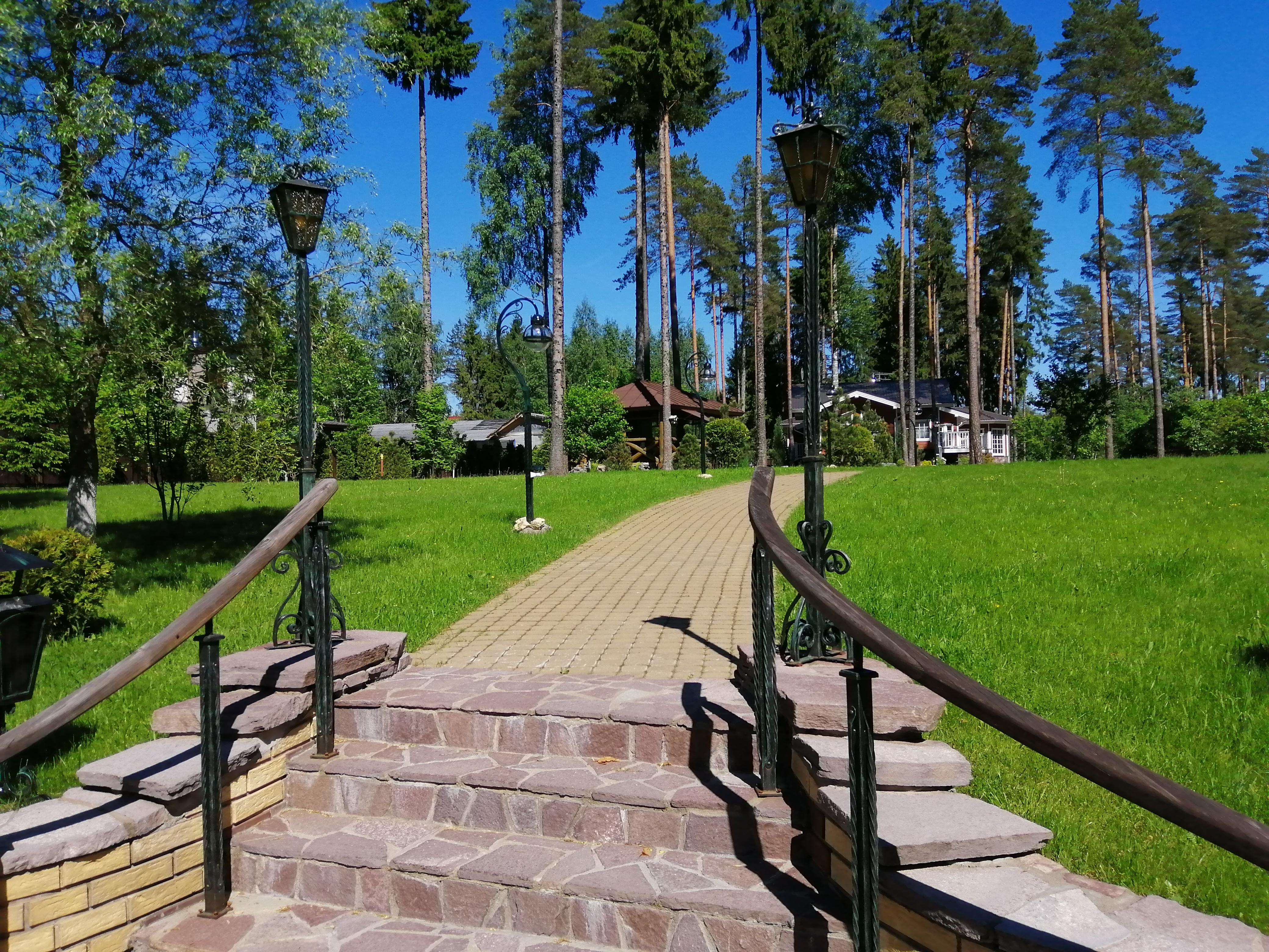

Finished with bedroom furniture. Made chair and stool covers.
At the same time photographed the lights.
2 minutes ago, TWISTEDWILLOW said:
How tall are they?
More than 2 meters.
4 minutes ago, TWISTEDWILLOW said:
Is it pipe or solid stock?
Pipe.
