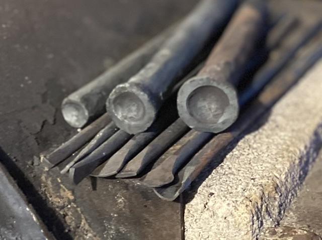

Practiced torch cutting for a while, then fired up the forge and made some rivet sets and chasing tools.
Looking good John, you’re going to learn that the torch is a valuable tool in your tool box

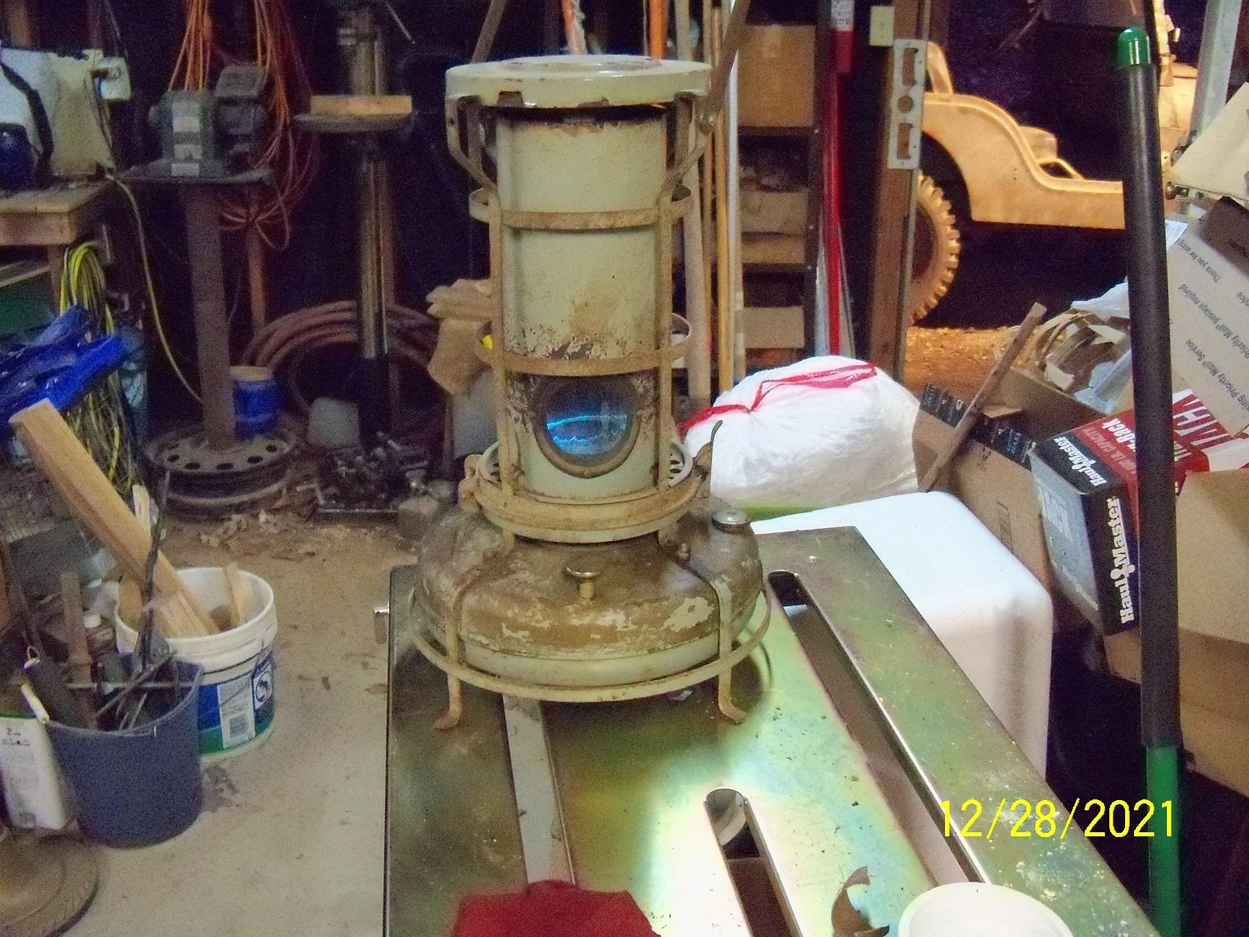

I worked most of the day getting our antique Aladdin Blue Flame kerosene heater going. Probably been over 10 years since it was lighted. It will keep the shop warm unless the temp drops into the teens. We used to use it in the bunny barn decades ago, before We converted the barn into the smithy.
That’s pretty cool! Err I mean hot! Lol,
I think Saturday and Sunday we are supposed to have lows of 12 and 15 so you may wanna forge with a extra big fire those days lol,
ive got all my stuff shut down an put away since we are looking at a few more rains this week,
it’s a bummer because I wanted to forge this Sunday after all the storms pass but with a high of 33 and a low of 12 out in the wind I probably won’t feel like getting outside,

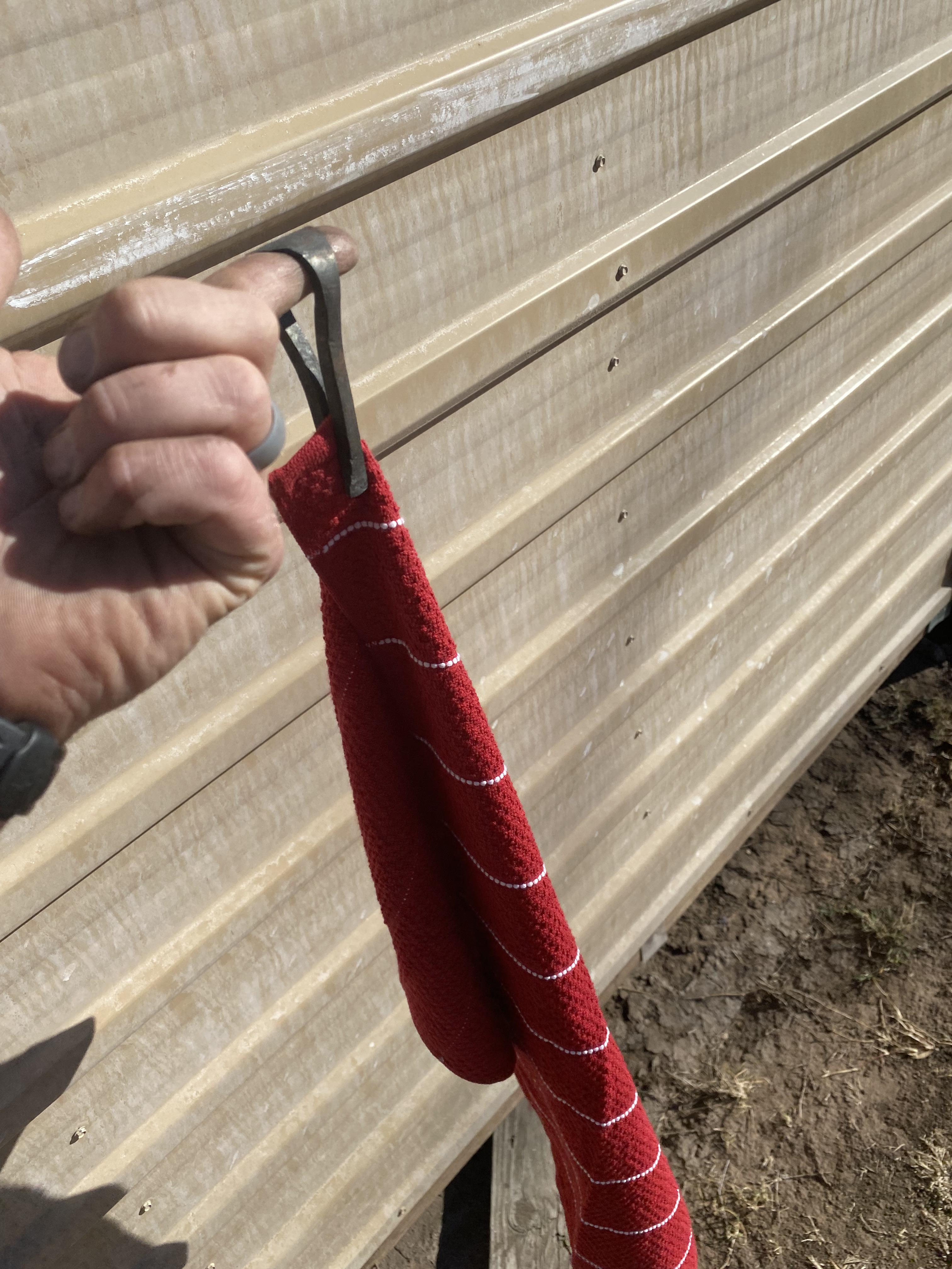

First blacksmithing project that my 7 year old son has helped with.  He was able to do most of the hammer swinging, while i held the tongs.  It was exciting to see him so exciting to get to do some smithing! It is a clothes pin that we will use to hold washcloths on our fire iron cook set that I made a few months back.  just stick the corner of the cloth through the loop, and pull it down into the pinch point.
That’s pretty slick BenW!
I can’t wait till my son is old enough to come play in the smithy!
Thanks, it sure is a blast getting to hang out with my boys out there!

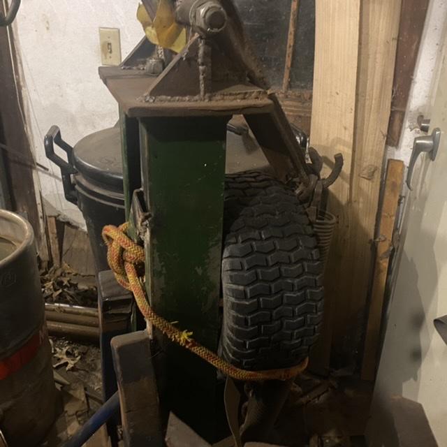

Forgot to mention: added a (fairly low-tech) shock absorber to the back of the treadle hammer, to absorb some of the recoil on the up stroke.
This should help alleviate the walking-across-the-floor problem.

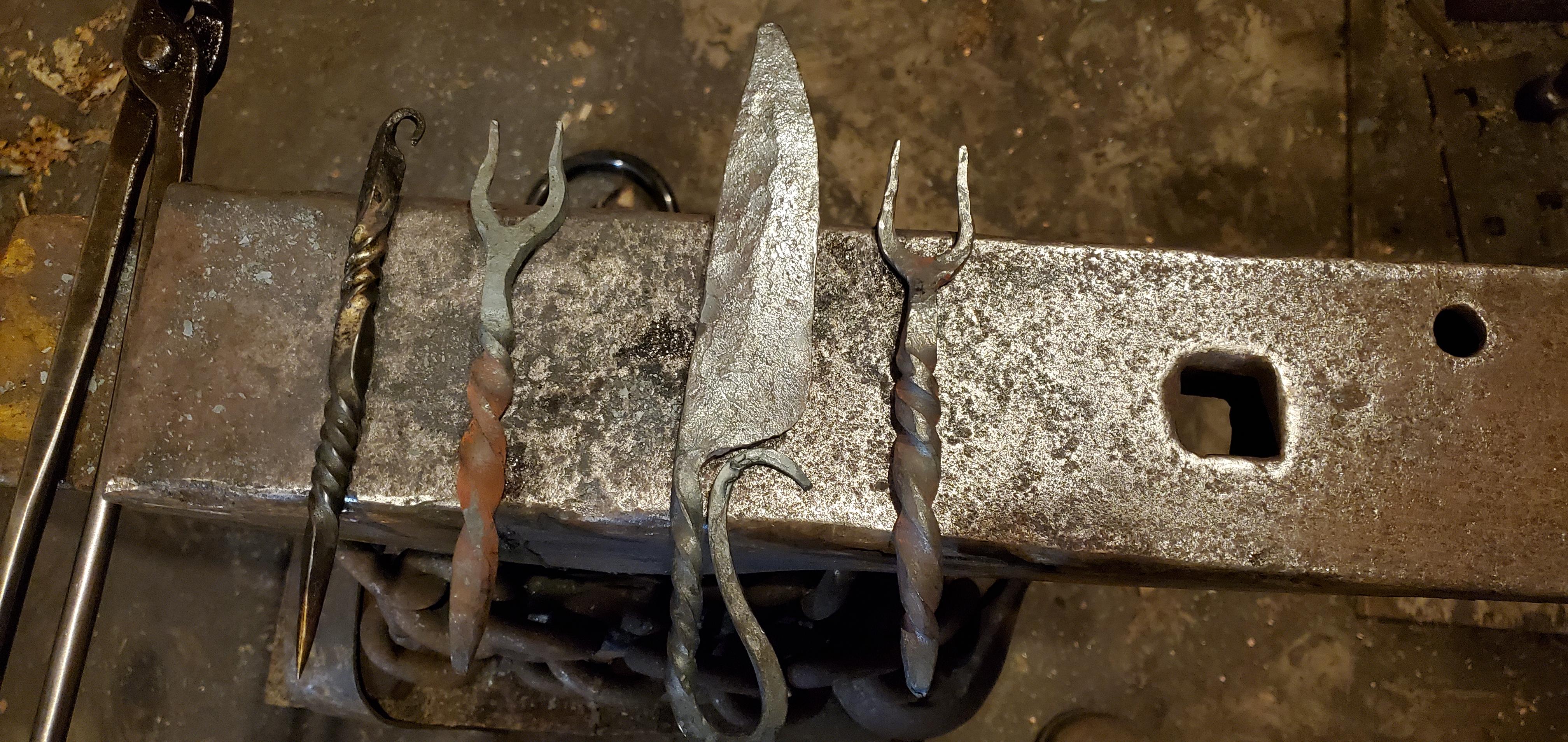

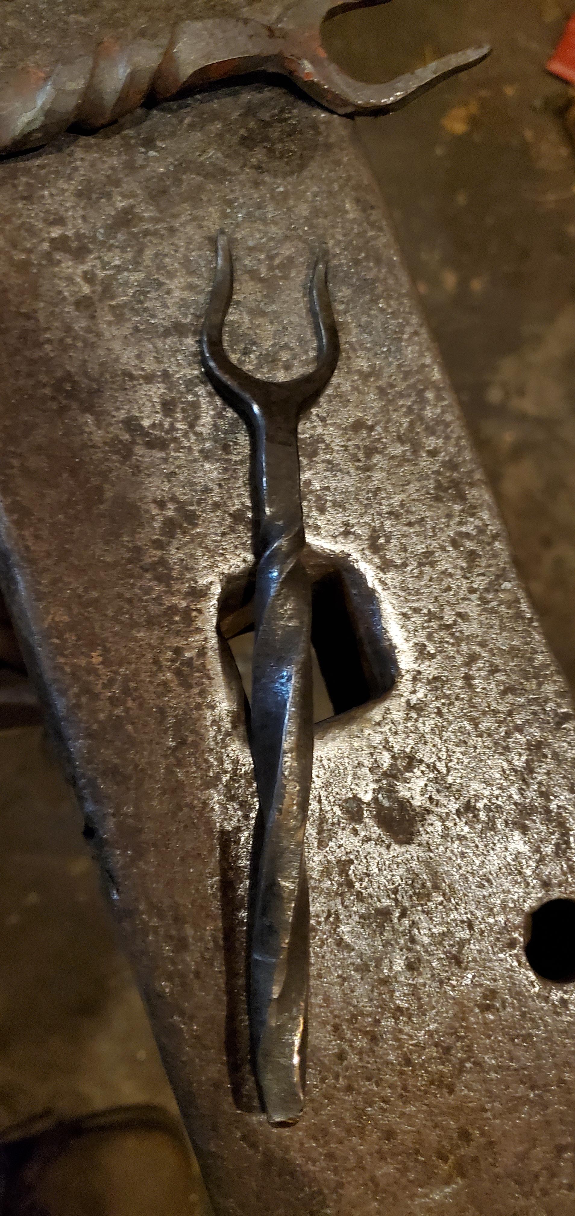

Been focusing more on my tool making and smithing small items.  The other day I made a fork and spoon, made the fully finished fork last night. and spoon.  Today I knocked out the knife, a pair of forks,  and a scribe.  My current goal is to make a set of 8 place settings including the knives.   Maybe I'll pull it off,  maybe the sub zero temps coming will sidetrack me.
Nice set of tools John.

Ben, you might want to run some sand paper through it in progressively finer grits to smooth where the cloth runs through to minimize damage to the cloth.  It is a brilliant idea and I love the friction hold. Also Great getting the little ones involved. Like TW, I can't wait to get my daughters in the shop helping. My 3 almost 4yo. might be ready to come start this spring. She is getting good at listening and following direction. Might be short bursts at first but that's how they learn. Happy for you and excited to get mine in the shop.

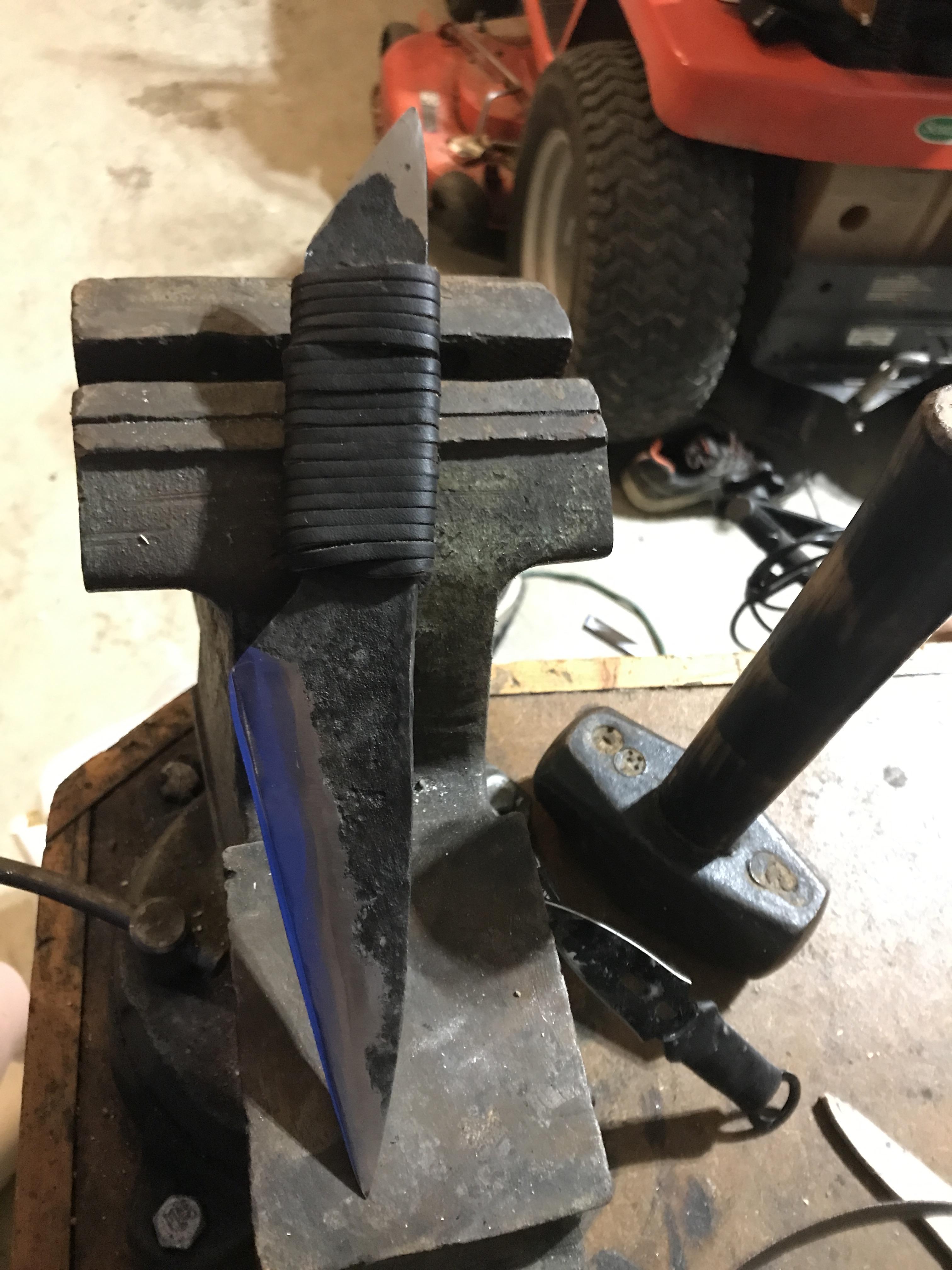

Had family in town and a cousin wanted to forge a knife- mainly for throwing, but still with a blade. Here’s a quick and dirty one we forged out of some leaf spring. 3/16” leaf spring, oil quench, with a heated block temper and a concave grind. A simple leather wrap gives it enough bulk to use as a knife but doesn’t impede throwing. While it’s tricky to get a good throw (like any throwing knife) it will embed up to an inch in pine logs. It was really fun making it, and I’m thrilled with how it turned out. One more step towards making a halfway presentable knife! image.thumb.jpg.87fe7b89b3fdc23d4ff637ba277e8e37.jpg

Chimaera, its all about the experience and coming out of it with a useful tool is a bonus.

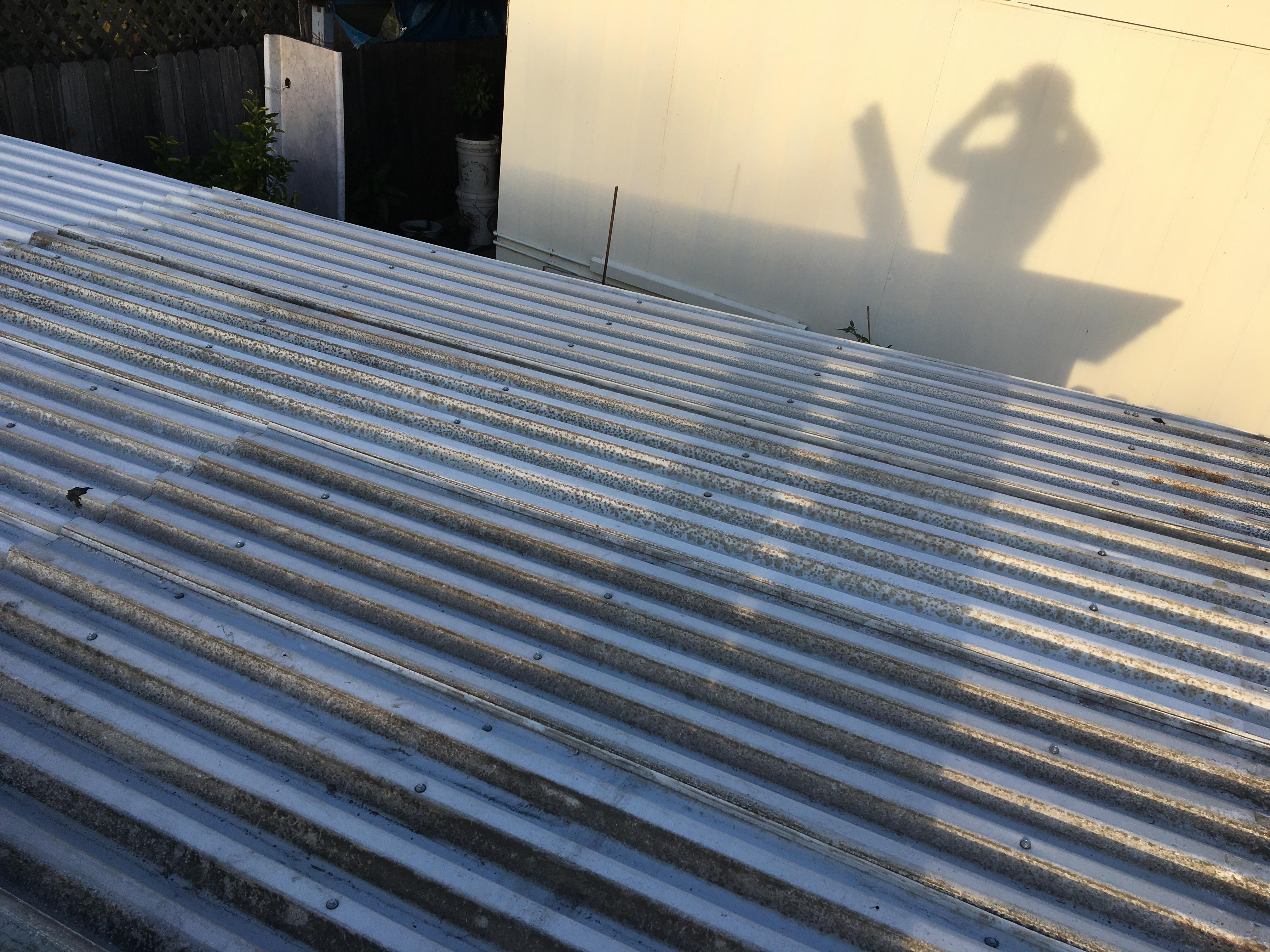

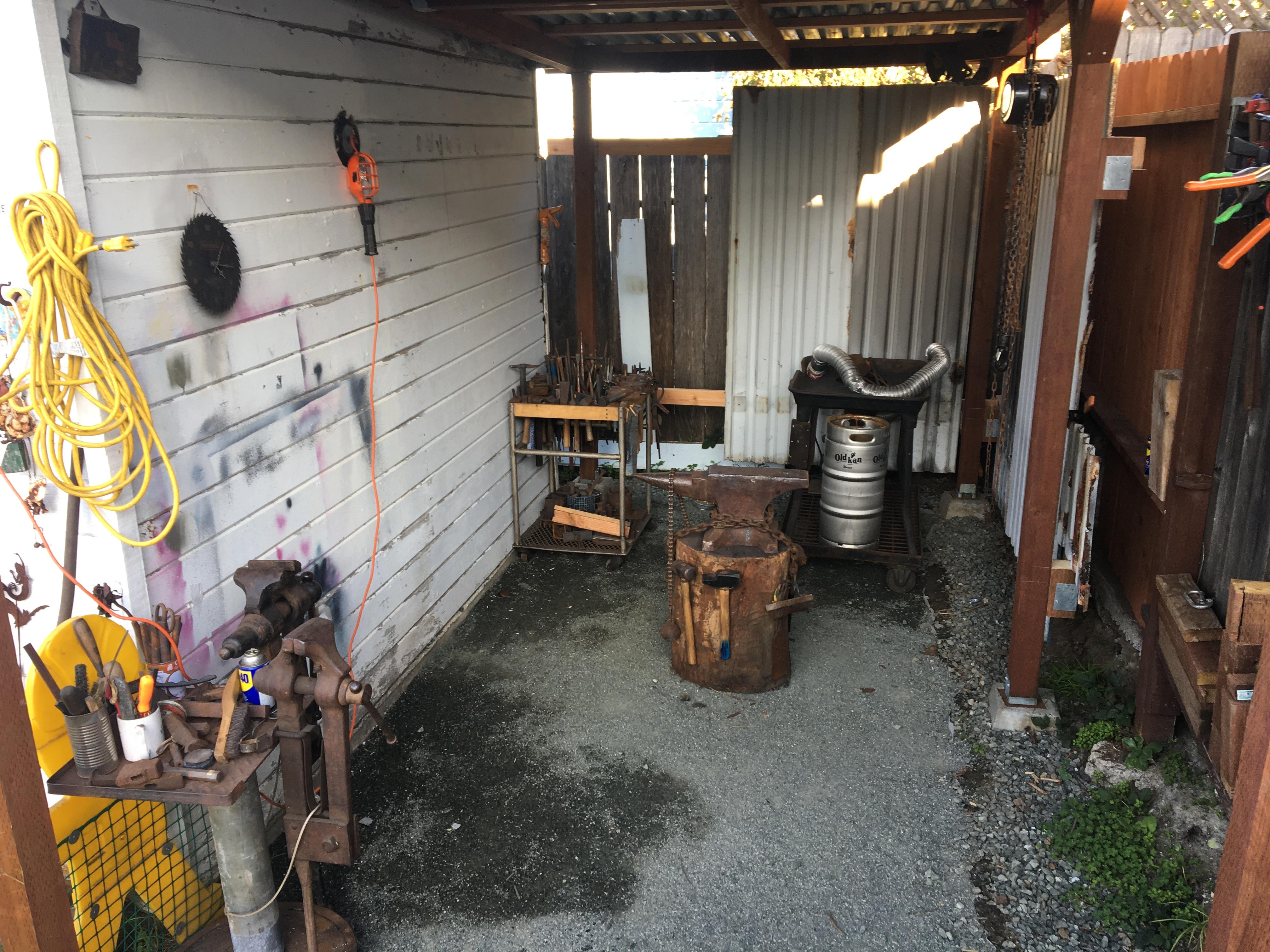

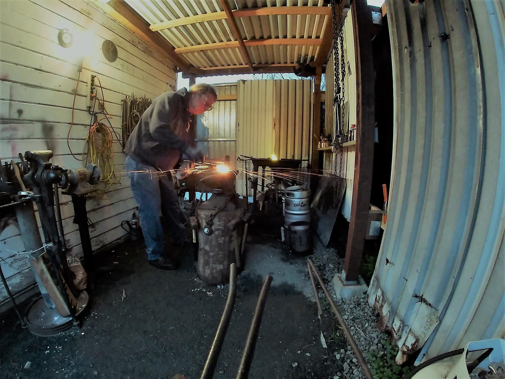

Lit the first coal fire in the new smithy in the back yard! Made a bracket to connect the "building" frame to the woodworking shop next to it.

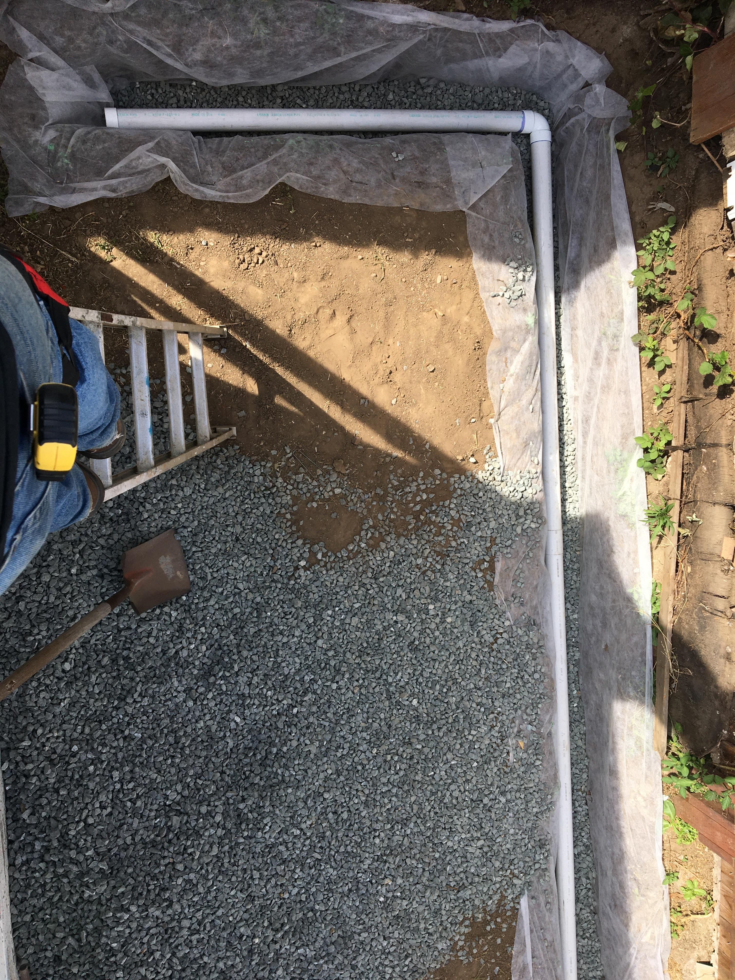

New space is 8x16 feet, tucked into a corner of the yard after some significant drainage work was put in place. The spot was/is, in the path of water flow from all the houses uphill and had to be accommodated.
Old space was a covered patio with rusted out roof panels and intact wall panels. The panels were swapped for the new space, with the walls making up a nice corrugated roof and the rusted roof making workable walls. A bit of a squeeze getting stuff in there, coal and propane tanks may need to be housed outside of the perimeter but the new space works, in the rain especially.

BenW; great idea, you might think of doing the next one out of stainless and cleaning up the grab area and passivating it with citric acid.

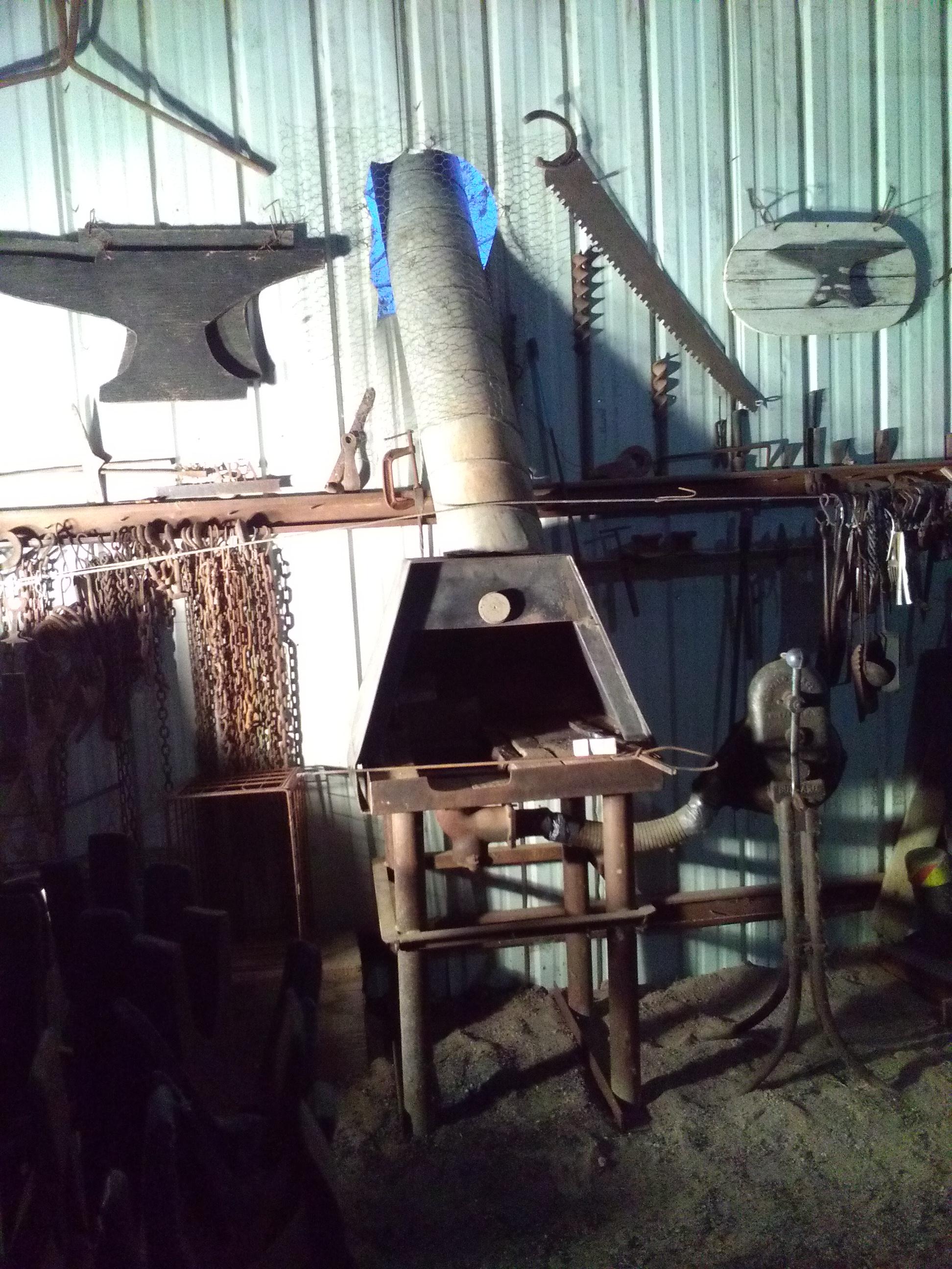

Current status of the NTM forge: cast iron firepot with firebrick table.
Thomas, what is that old tool about the anvil silhouette on your wall?
