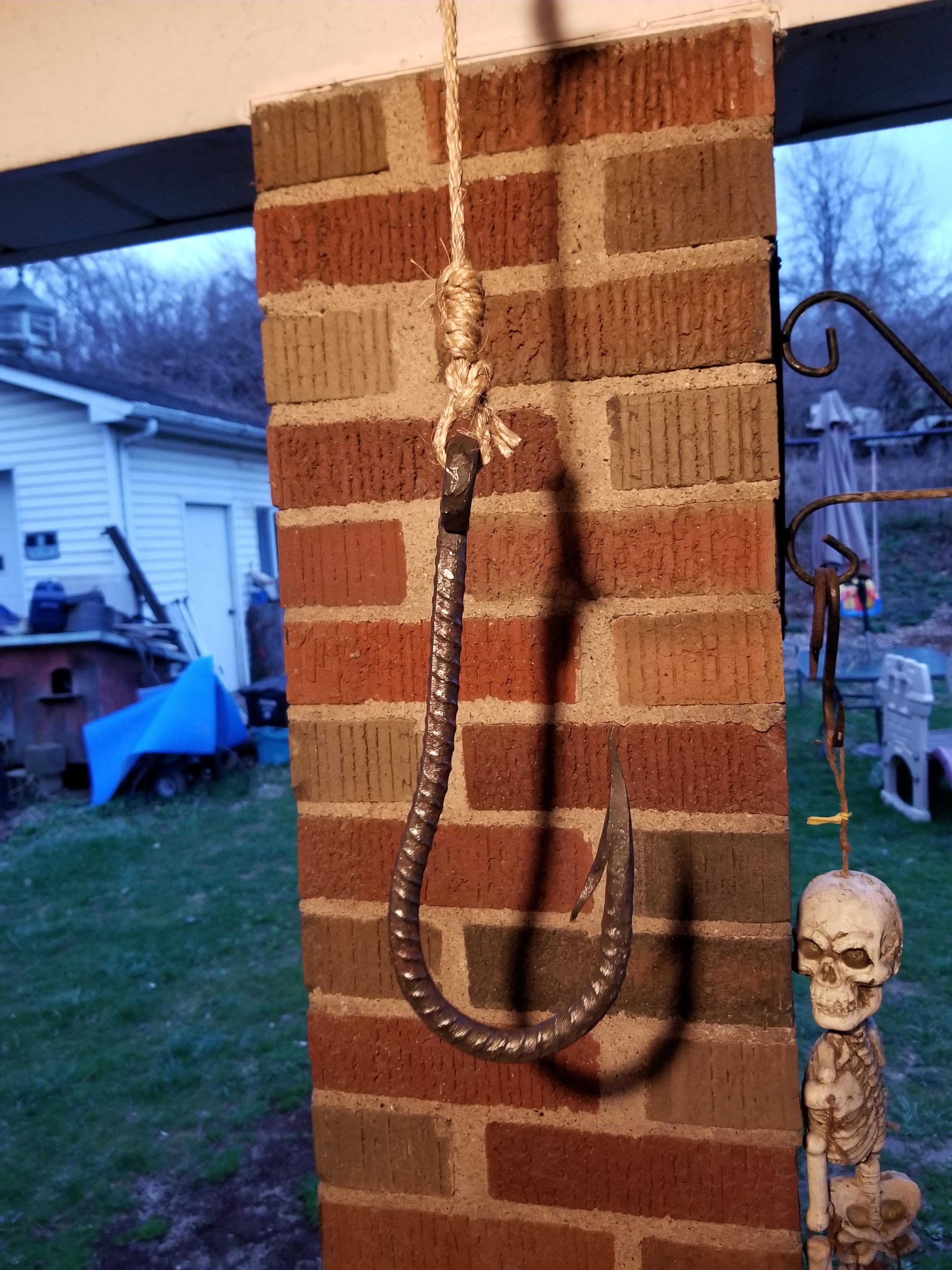

I haven't made a gig but have made some over sized fishing hooks as art for people. The concept is the same with the barb.  I don't have any pictures on my phone of the nicer ones I've made just one I made for someone for halloween.
The barb could be shorter and the point not as long on a gig.  When I get home and can dig out a few I still have Ill get pictures. If not just make a gig. Lol
For a gig I wouldn't weld tines, but raise them with a chisel by shaving it up from the parent stock.  Like dragon horns, and wizard beards are done. That is how commercial gigs appear to be done. FS-4XPK-400px.jpg

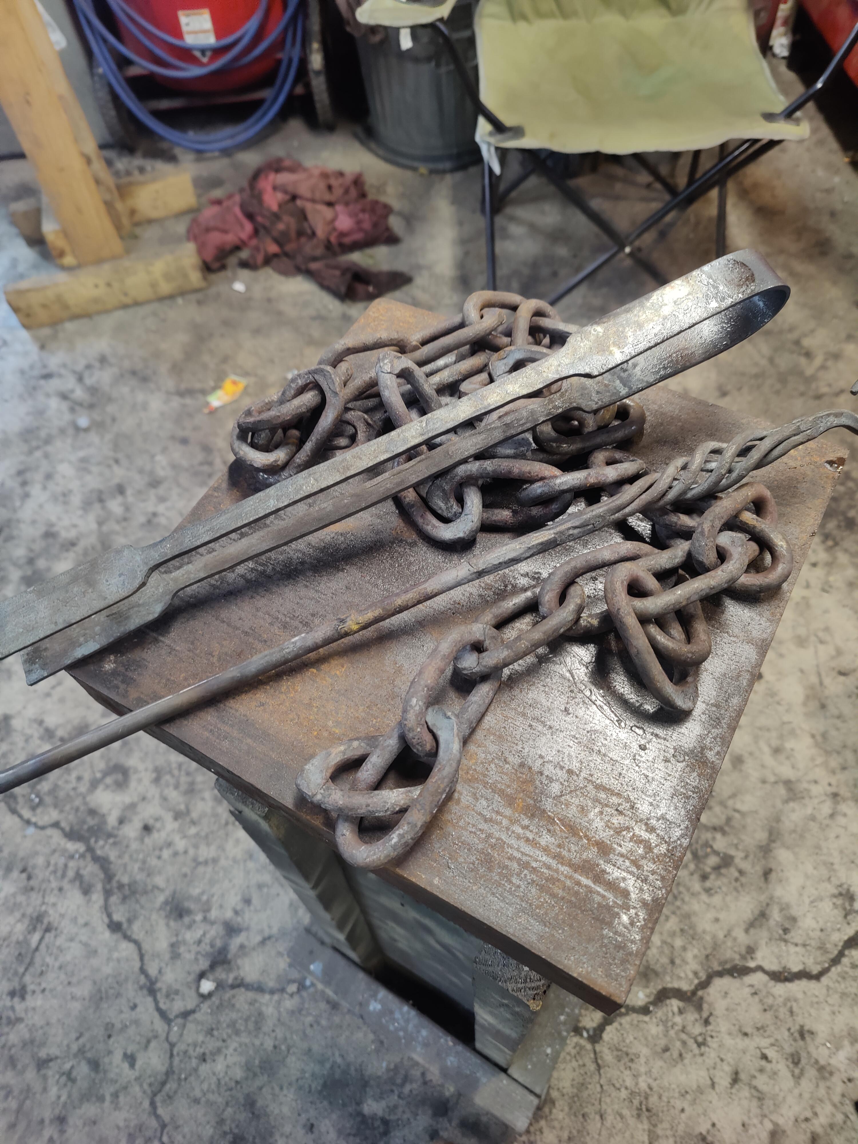

A pretty good day (yesterday, me and the wife got into a discussion and i forgt to hit submit), no one home so shop time for me. Made a fire poker for JLP's challenge A few more chain links, up to 31 now. Tried a BBQ tong thing.

We used 1/4" round, forge a flat taper on one end like a chisel, cut or grind one side off so it looks sort of like a Y with one arm removed. Heat and bend the remaining side over to the shaft. Leave a space, it's the barb! Then we ground the outside to finish profile and sharpened.
With just a LITTLE practice we were k nocking these out in a few minute. A couple guys in class were making decent money selling 3 and 4 point fish spears. I put mine on a 6' push broom handle with IIRC, 2' of rod between stick and points. The fish wouldn't stay around if I got closer enough to use the 3' handle.

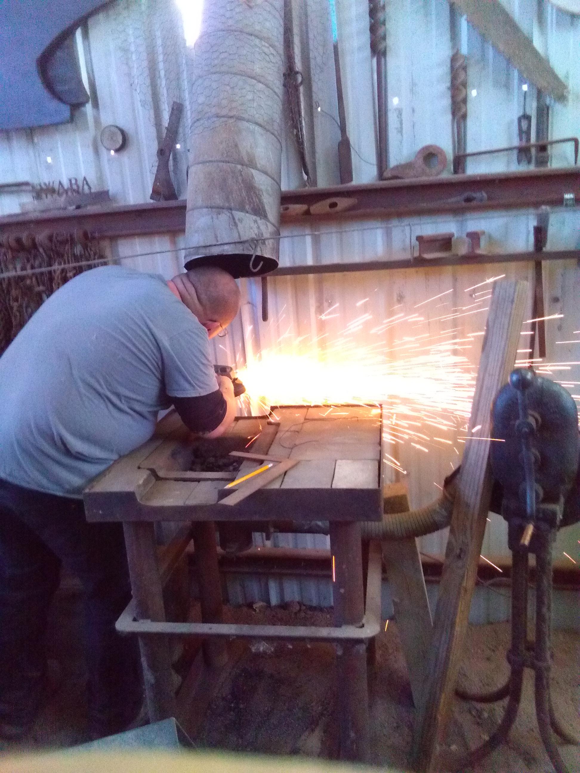

Had a friend stop by yesterday with his angle grinder and cutting disk and we cut a small passthrough hole in the wall of the shop and in the hood for the NTM forge.  We also roughed in the chimney and after they left I used a block and a piece of soapstone to mark a better fit to the top of the forge and cut it with some bulldog tin snips.

Also love the large fishing hook. Needed to find a whale to test it.
I've really been wanting to make a very large functional safety pin for a while now for no real reason. (maybe Ill get on that in these winter months). Now you are making me debate how large a fishing hook I could actually forge with my equipment.

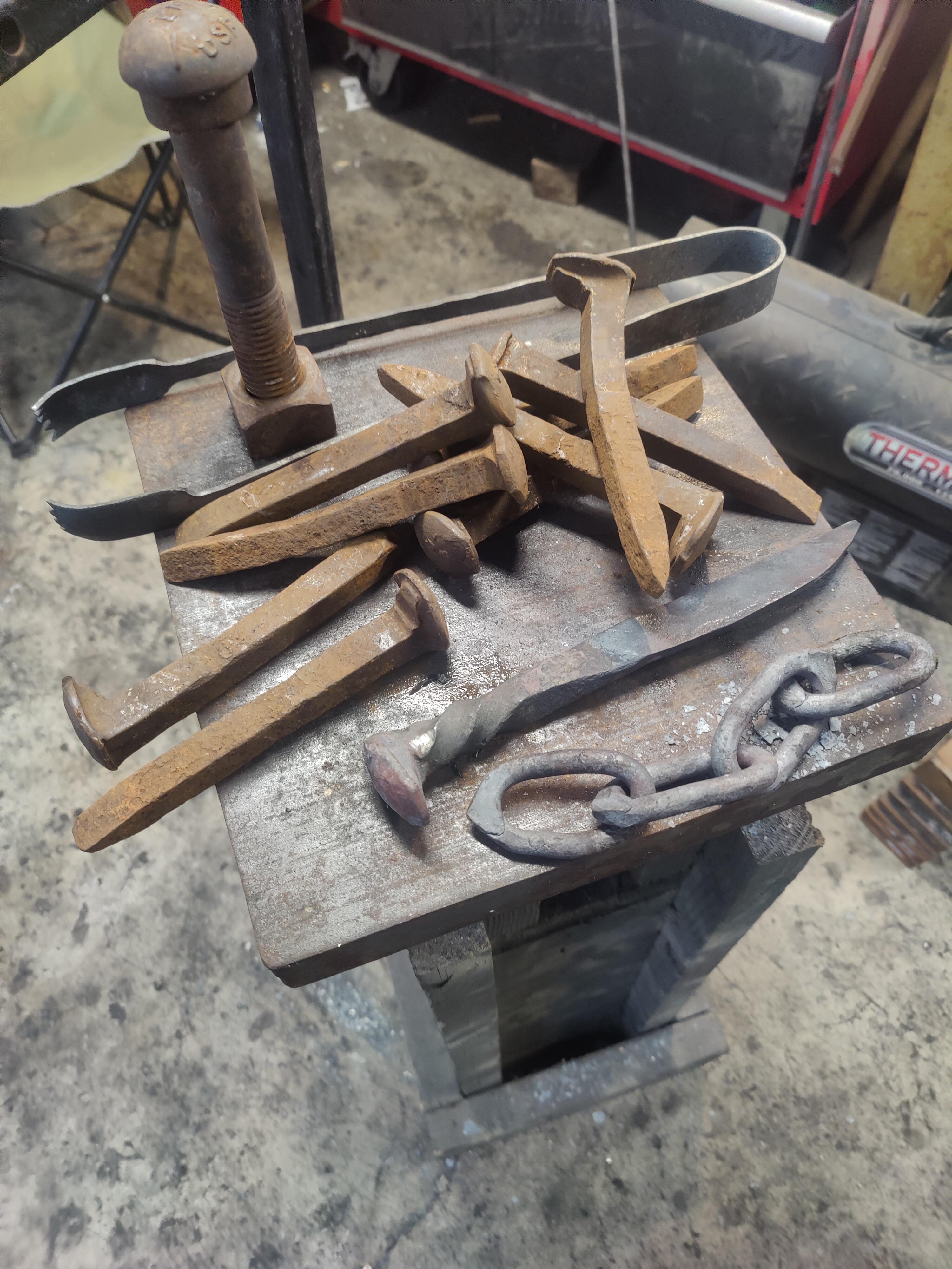

Got my BBQ tongs finished, another bit of chain, and (not in pic) a bic with a groove to maybe, hopefully start getting round links where they are welded. Also made something i never thought i would make, a RR spike knife. My neighbors son brought me over a bag full of spikes and a bolt. He then proceeded to tell me he was going to go get more for his uncle, also a smith, and there were piles of them just laying around. So i proceeded to tell him that is not a good idea and could get him into a lot of trouble. Said he will wait till today so he can ask the guys working on the tracks about them, i said that is the best course of action. Even if he did take them he is 10 or 11 years old so they provably would not do much more than a good talking to about what he did and no real legal consequence.
Is there some unwritten rule that all blacksmiths must at some point make a spike knife?
No; I never have after 40+ years of smithing.  I make knives from HC alloys not LC!  (Save for historical replicas that are plain WI.)

Well, 40+ years just means that you have not yet. :D Just seems that you see these things all over. I know they are not good steel and i do not expect much more than a show piece.

No, and I won't let my students make one in my forge. What they do in their own shop is a "Don't ask, don't tell" kind of situation.
I have found that if you use the spikes marked HC (high carbon) which are used on curves and switches and quench (no tempering) in Super Quench they aren't great but are OK for edge holding.  Certainly better than mild steel.  That said, real high or even medium C steel makes much better blades.
