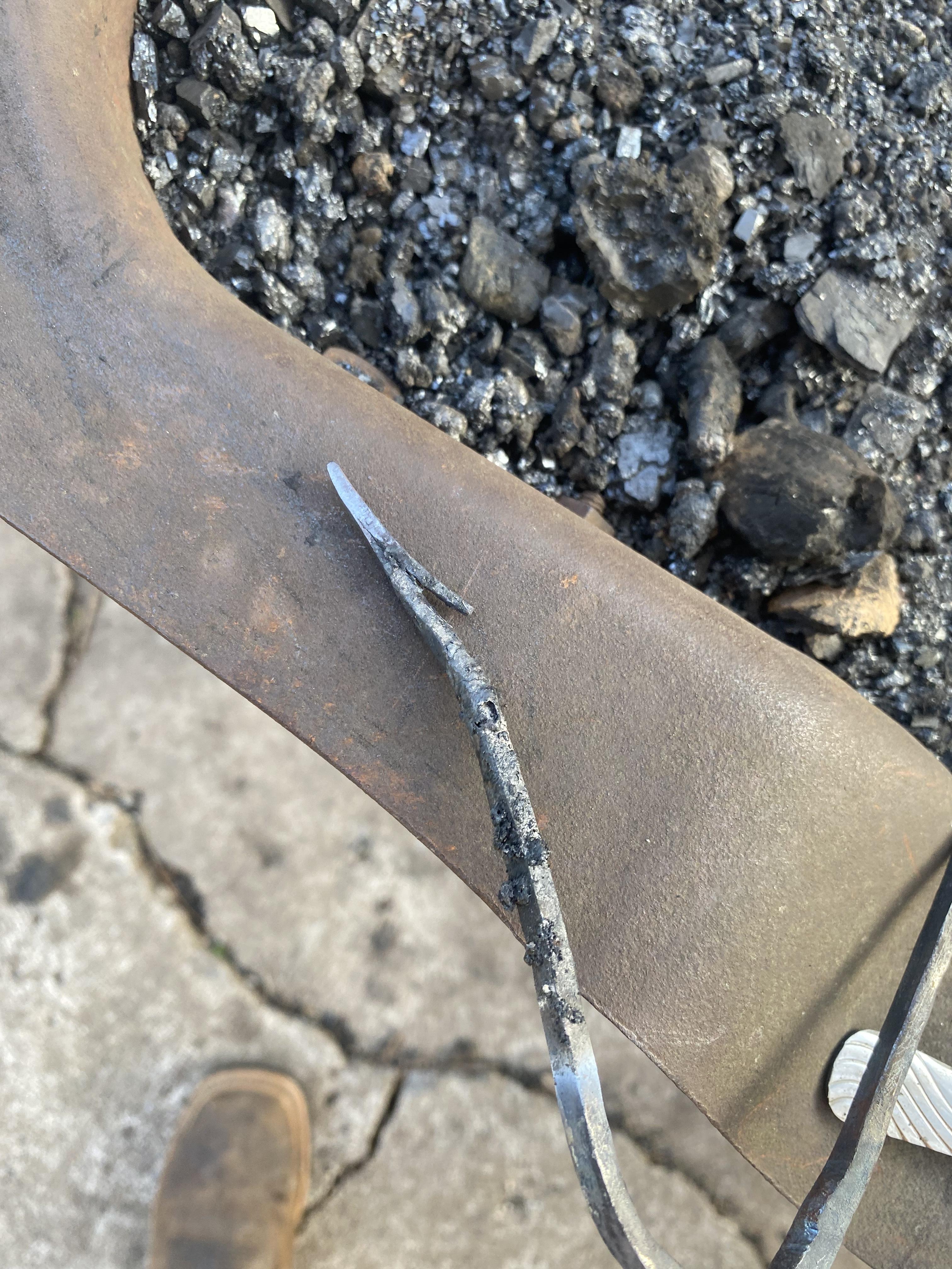

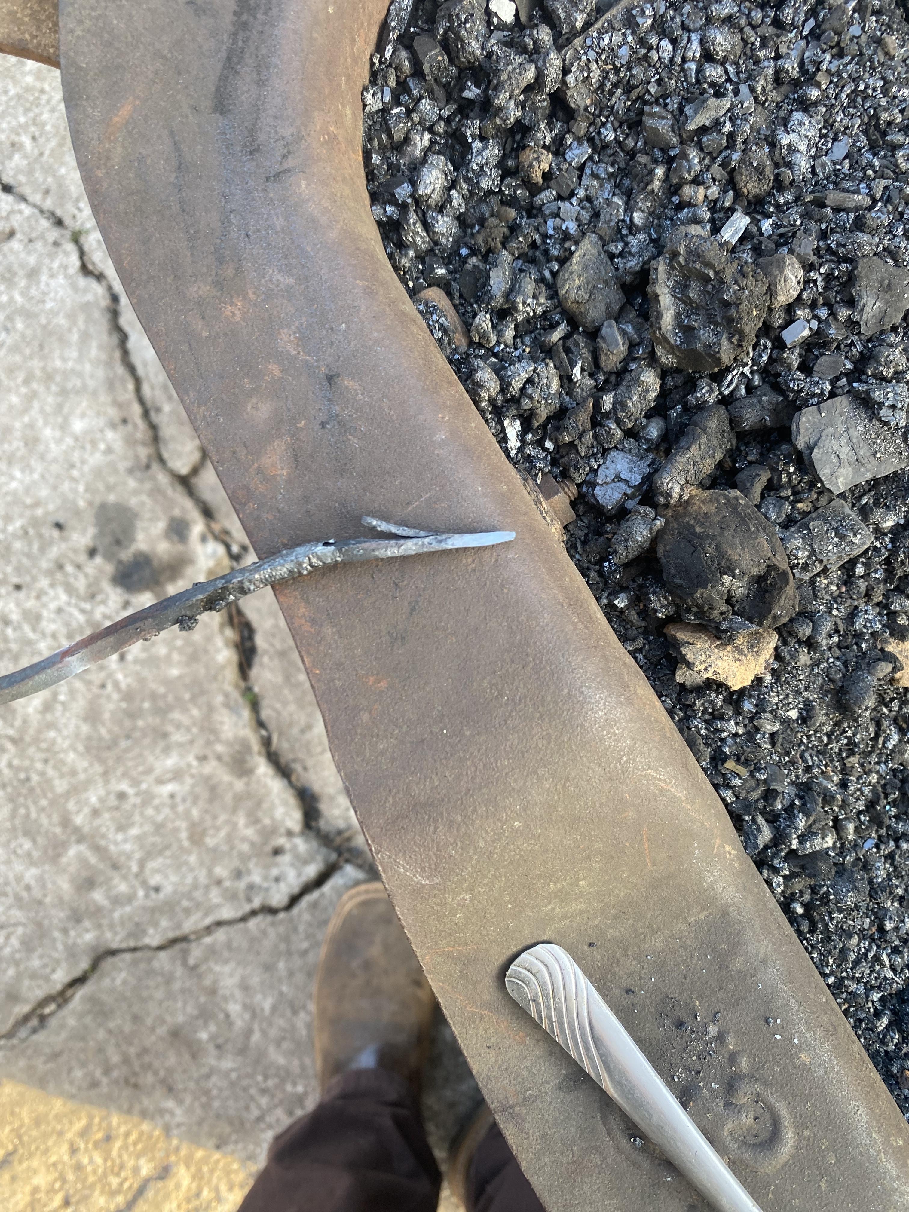

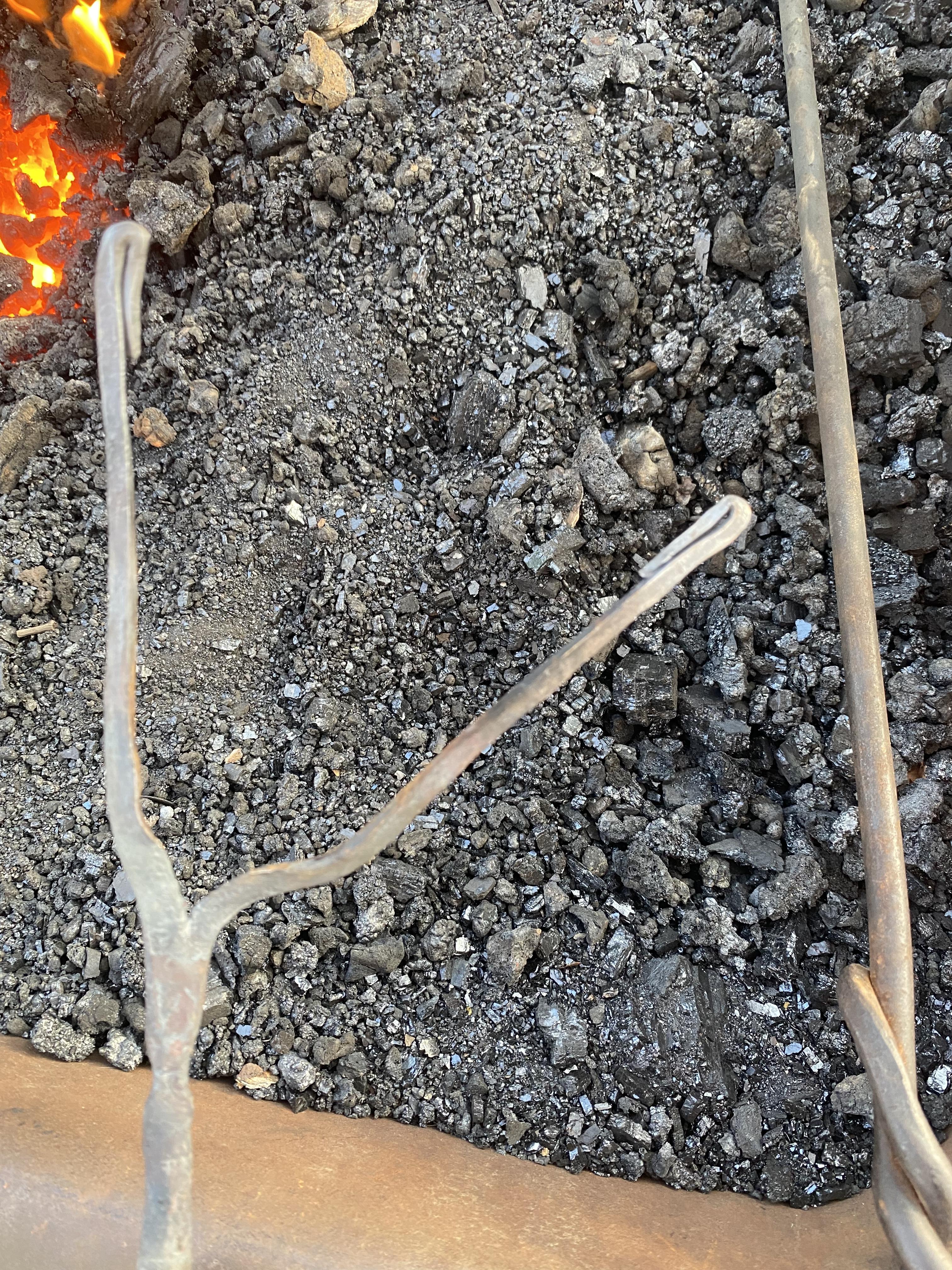

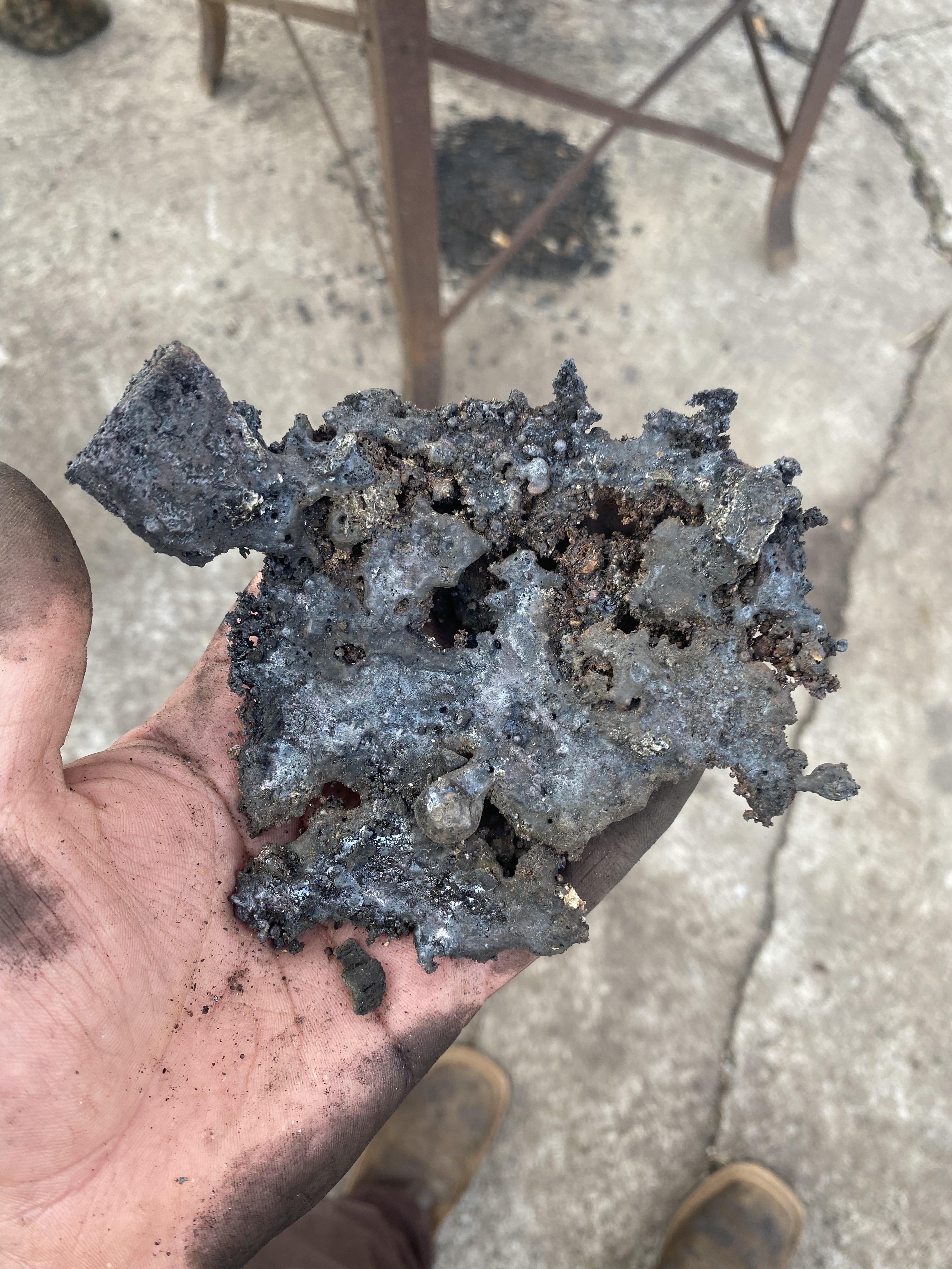

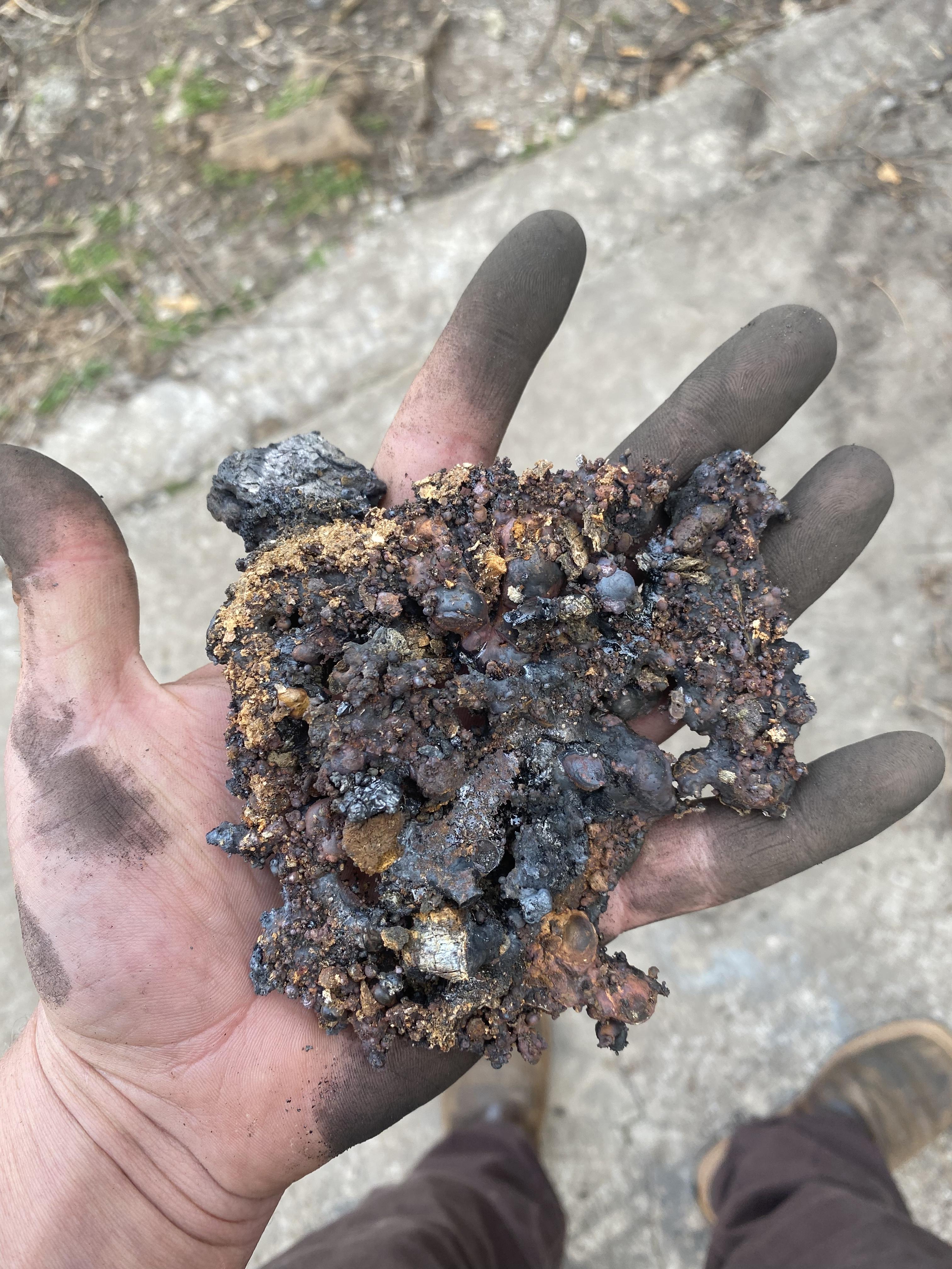

I was just getting ready to fire up the forge to try my new wolf jaw tongs out, and I remembered I hadn’t cleaned out the fire pot after I shut down on Christmas Eve, so I thought I’d dump the ash gate out and check the fire pot for clinkers before starting… :blink:
That’s one solid piece!? Lol I’ve always got one or two but never bigger than half dollar coin, I’m not sure if I accidentally got some dirt in the forge the other day or what, but the crazy thing is the last project I did was a fire poker with a forge welded tip, so I dunno how I ever got the fire that hot lol,
TW, that clinker mass appears to have some bits of gravel or stone in it.  Your coal may have some pieces of non-combustible rock in it.  I once had some coal that had probably 10-15% limestone in it that I had to pick out.  I suspect that it was picked up by a loader from a coal pile that wasn't on a concrete slab.
TW, if you were using flux for the forge weld that hay have aided in that bigger than usual clinker clump.
As for still getting heat, air must have still been getting through for the hot coal above it. Usually the issue is with clinker blocking the air.
Preserve it and give it to a kid telling them its a dragon booger lol.

On the backside of Das's post.. Or clinker spitting..  The edges of the clinker stay hot enough to get picked up but the airstream and spit it onto the metal..
One of the reasons to crank the blower more slowly when forge welding, so they say..

George I’ve been using this same batch of coal for awhile and this never happened before
Daswulf, I was using flux, and I’ll admit I’m still trying to tune in on how much to use so I have kinda been going a little overboard with it, I didn’t know that it could cause clinkers though! I just learned something new!

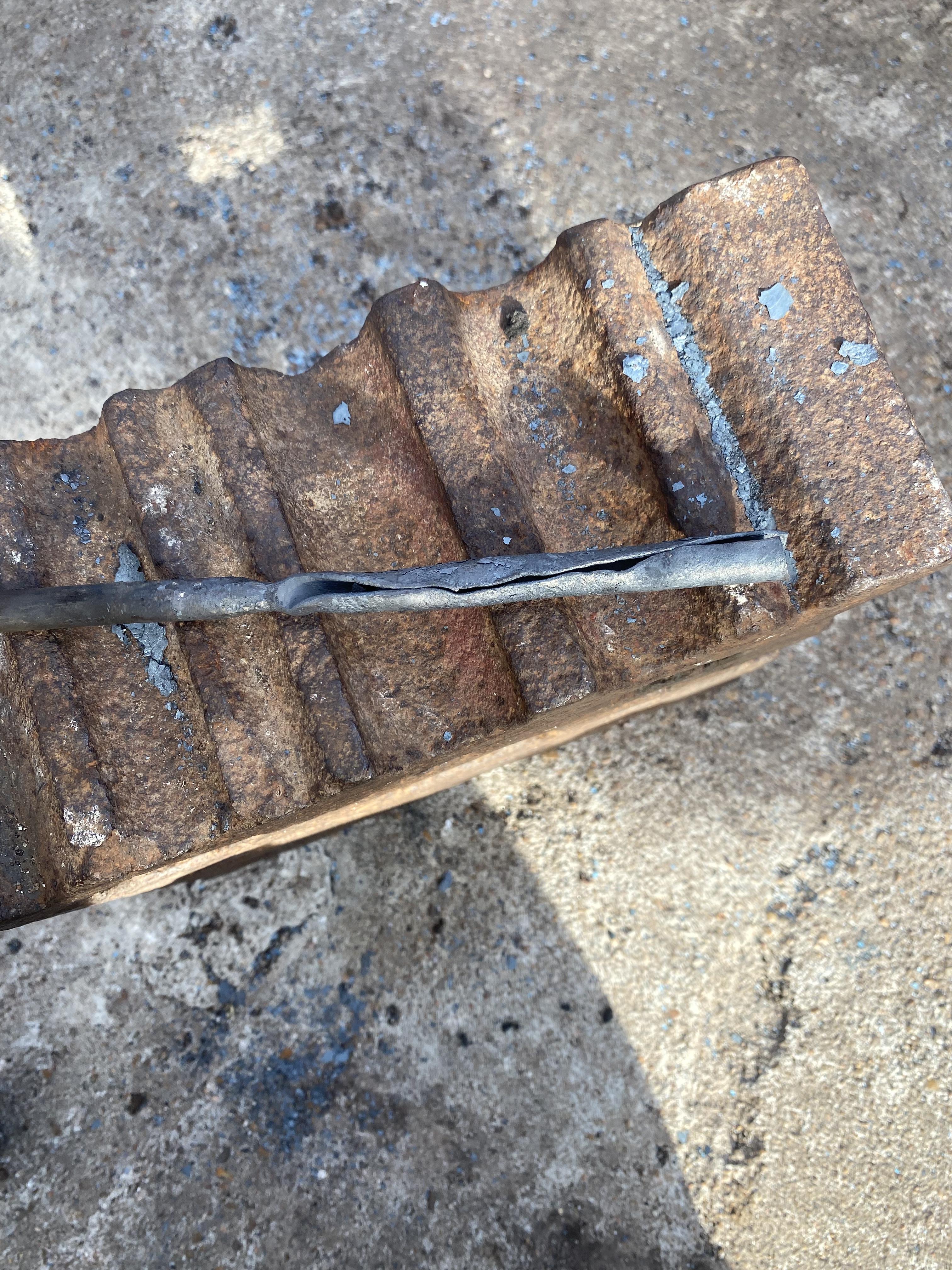

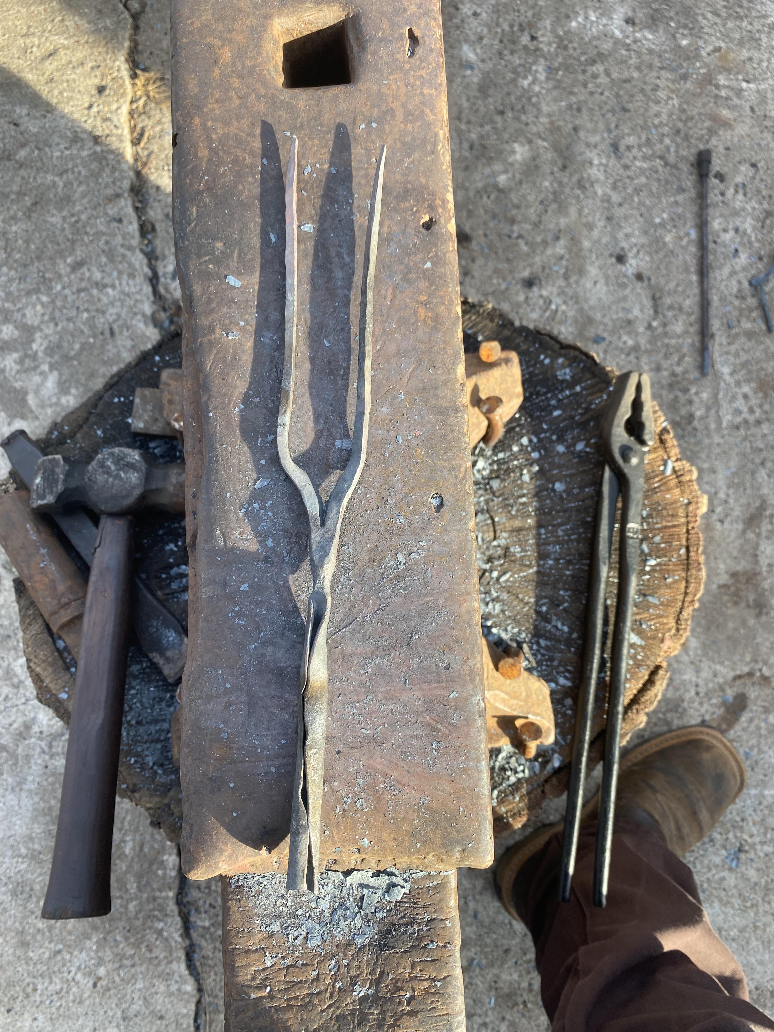

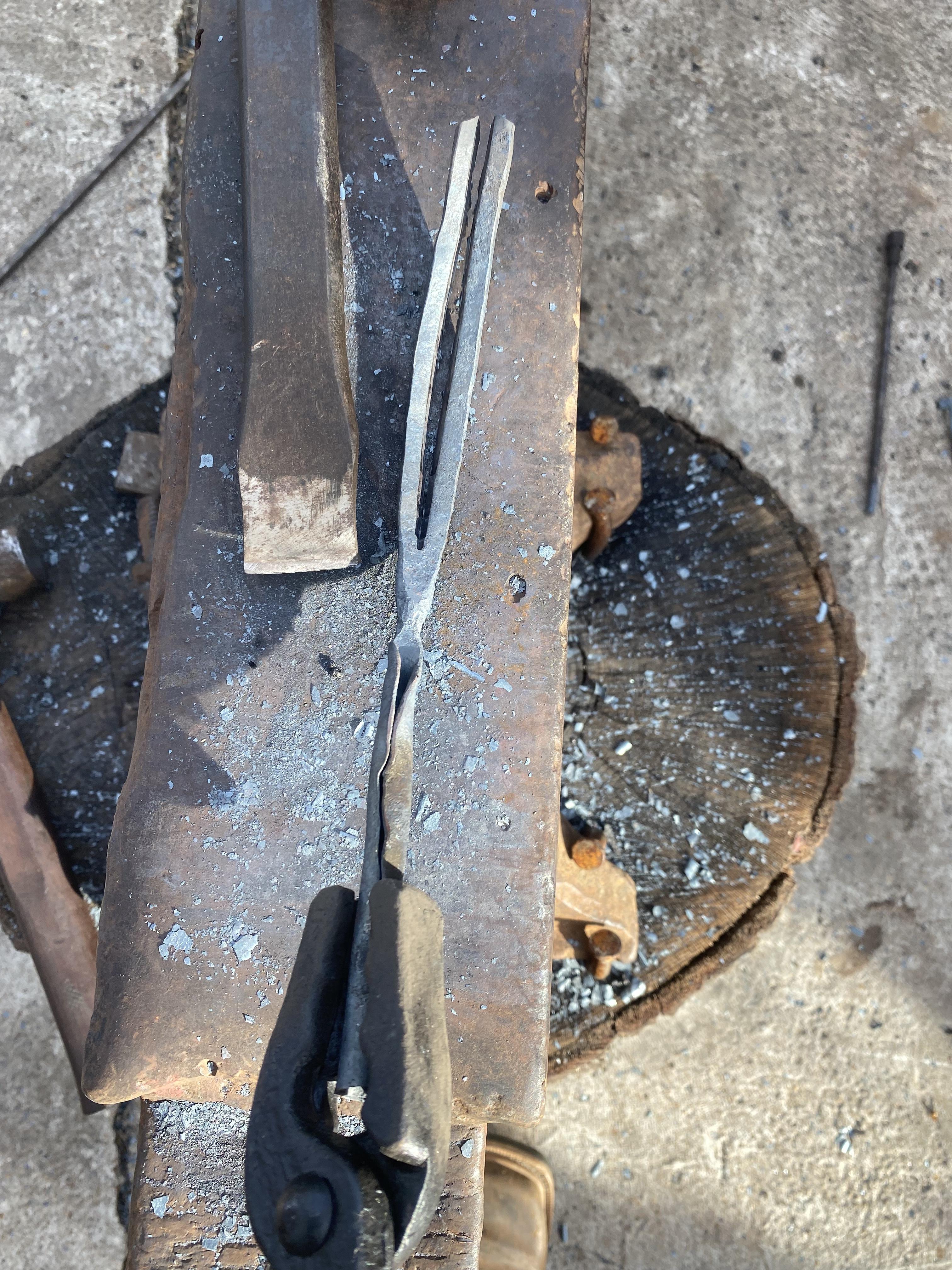

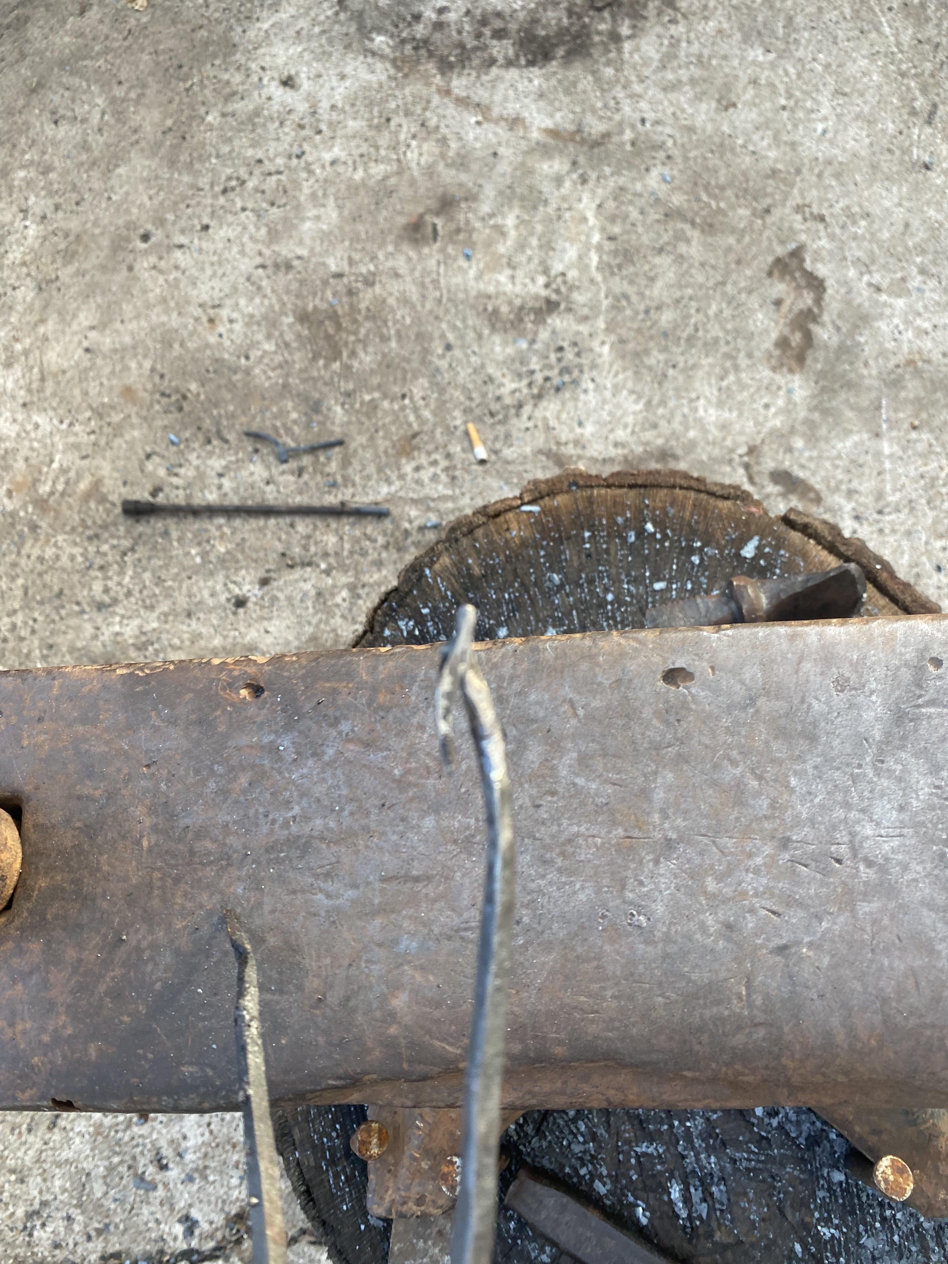

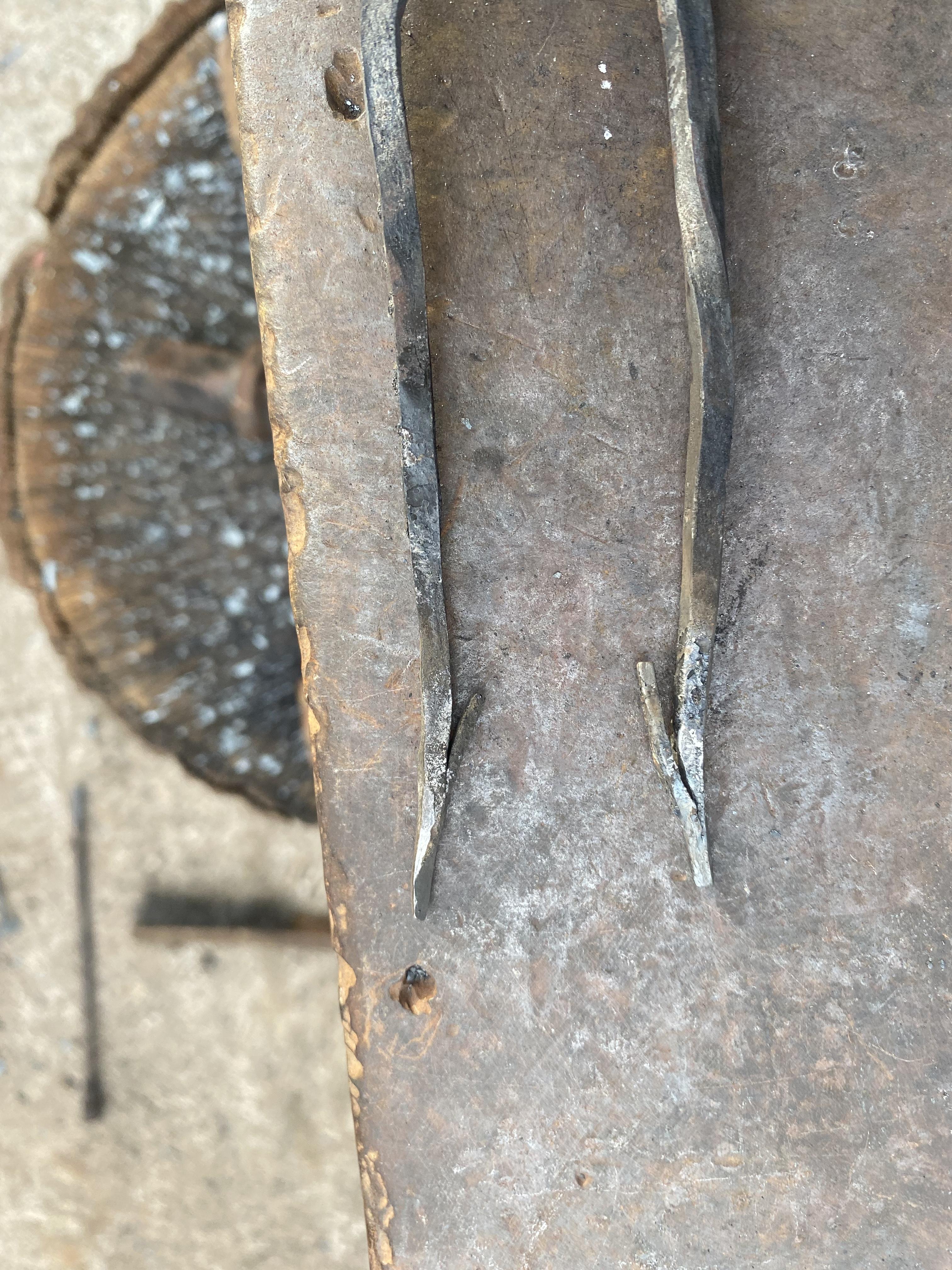

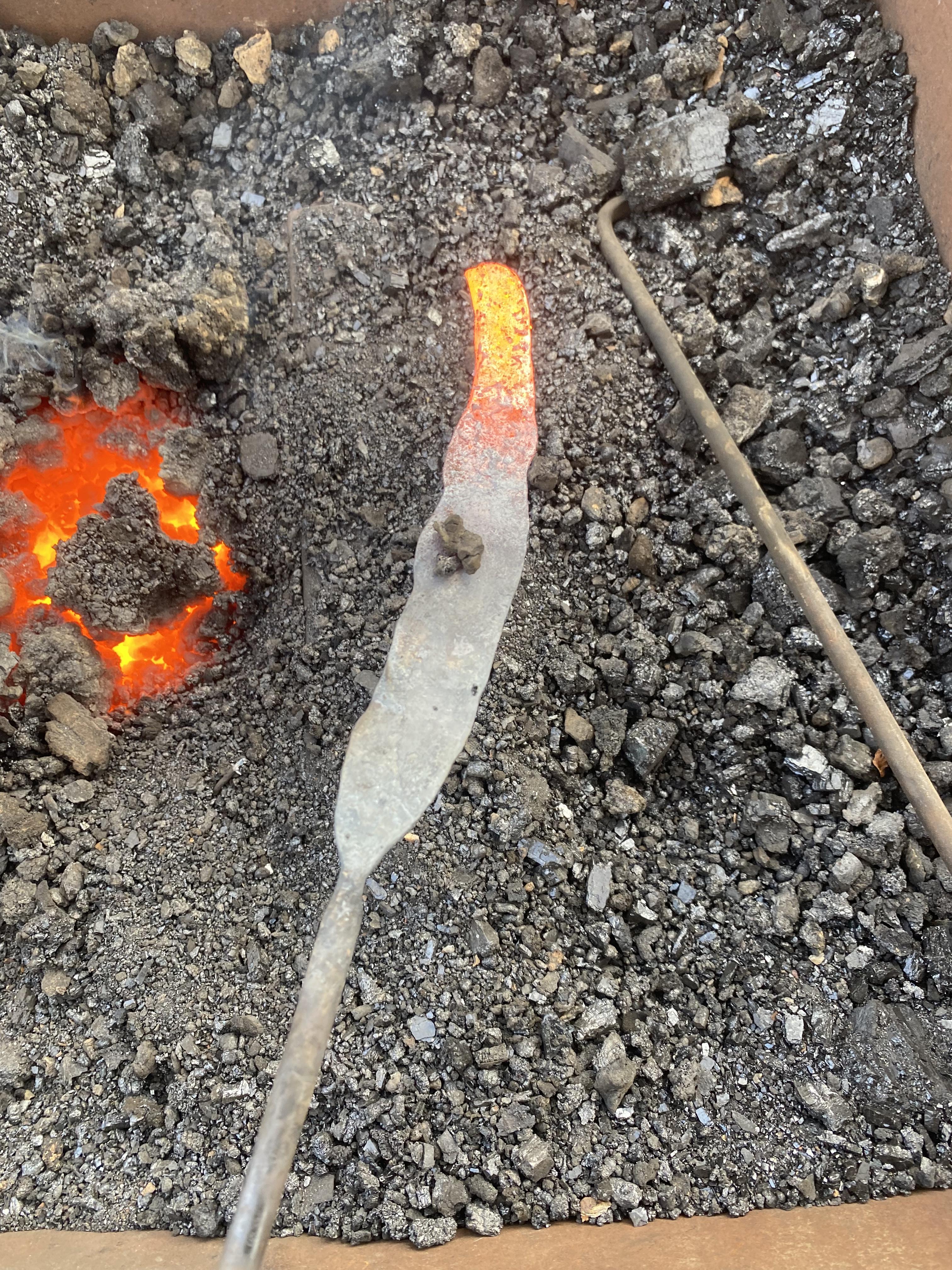

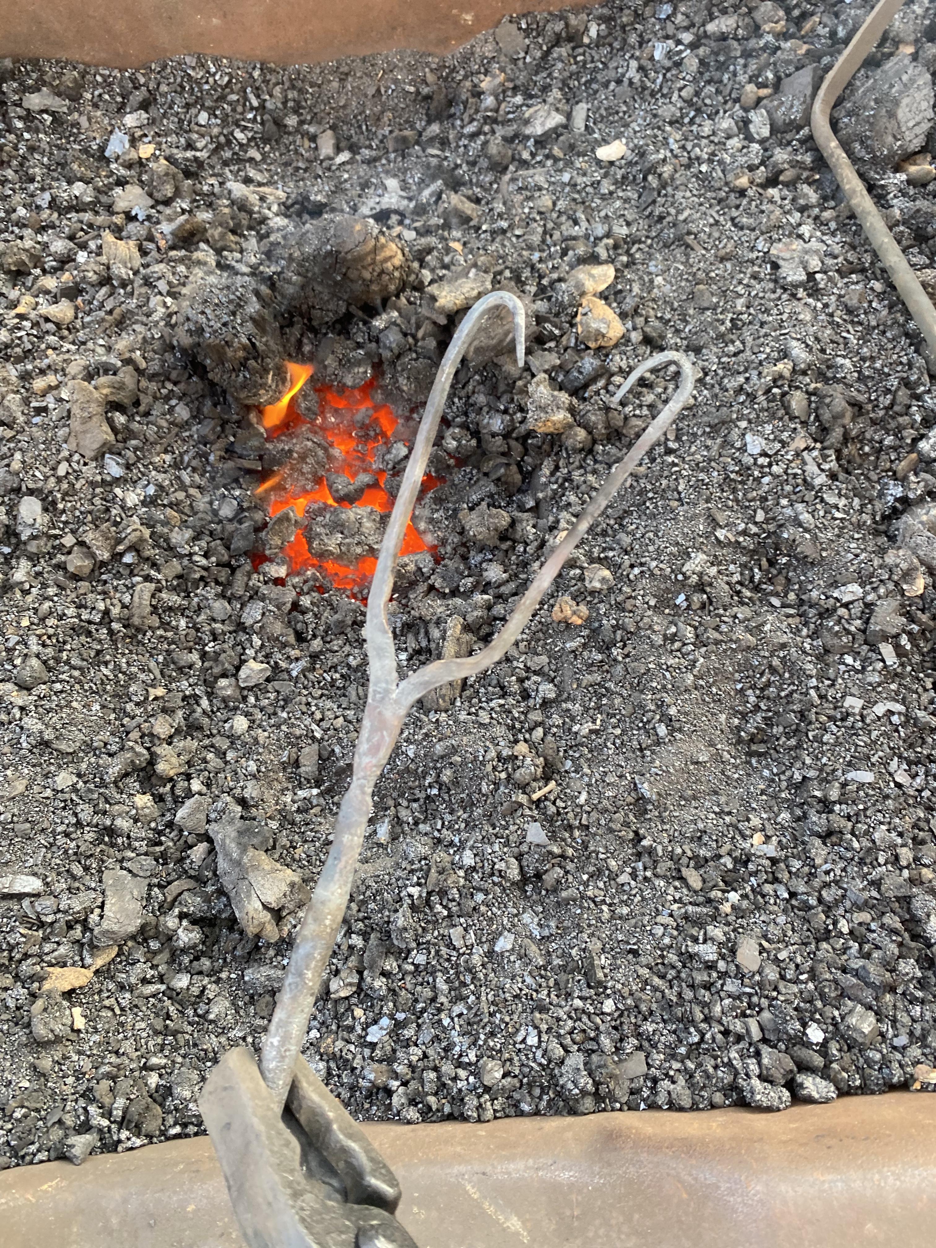

Well on another note, I just got done trying out the wolf jaw tongs on a new project I’d never attempted before,
tongs worked great! project on the other hand was a dud…
I had some leftover 3/8” round setting there from the other day, so I thought I’d play with it,

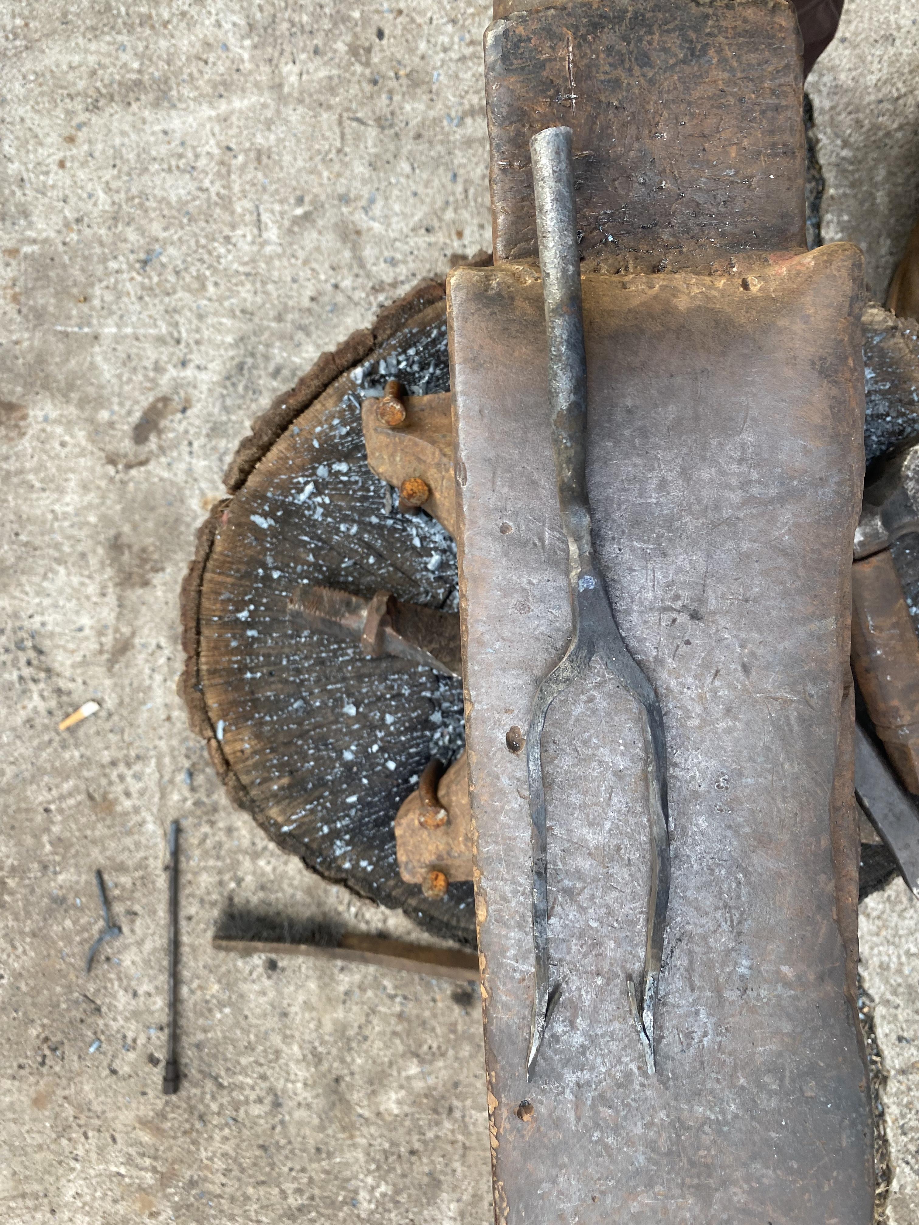

I decided to make a frog/crawdad gig!
I failed miserably but I did learn some lessons lol,
I recently I have been making cookout forks so I thought A gig wouldn’t be much different… boy was I wrong lol,

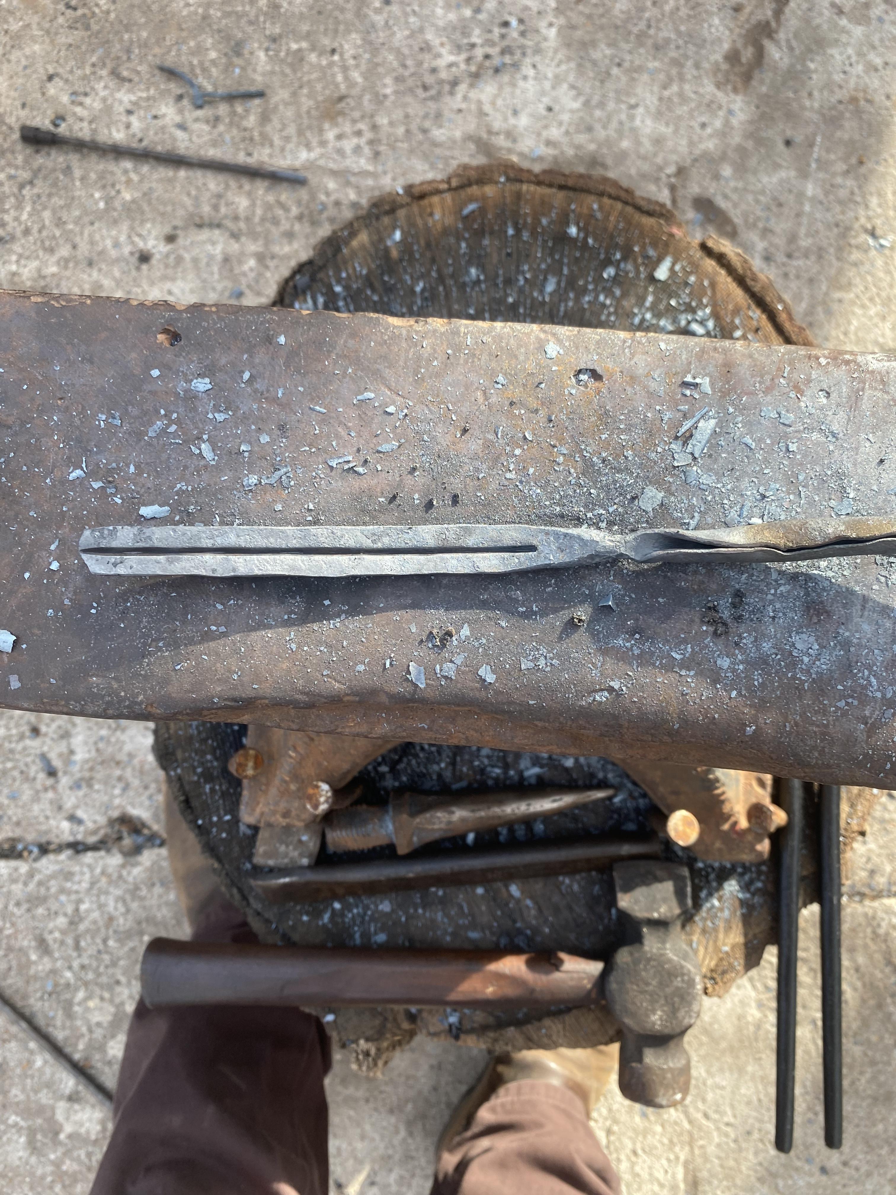

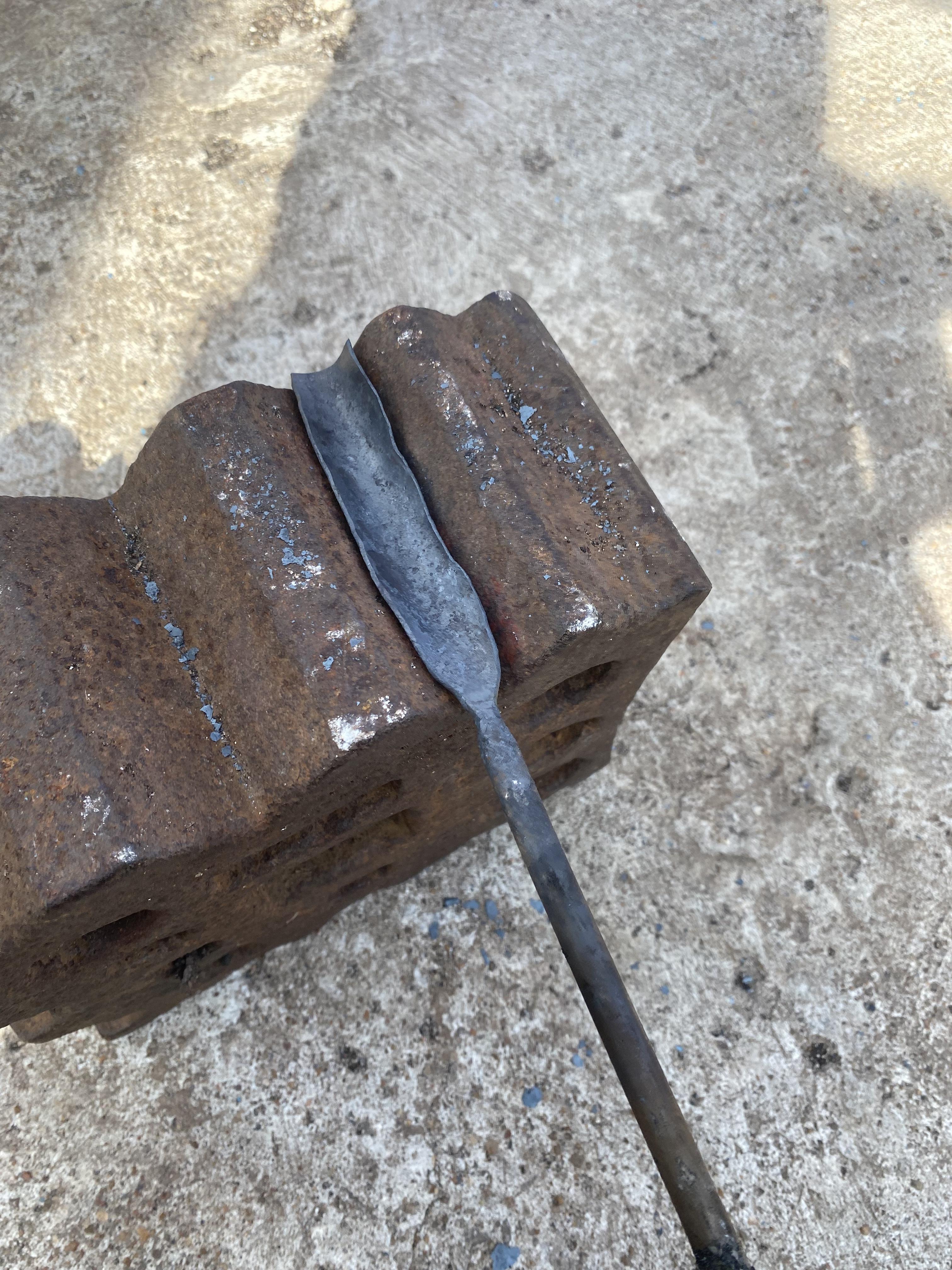

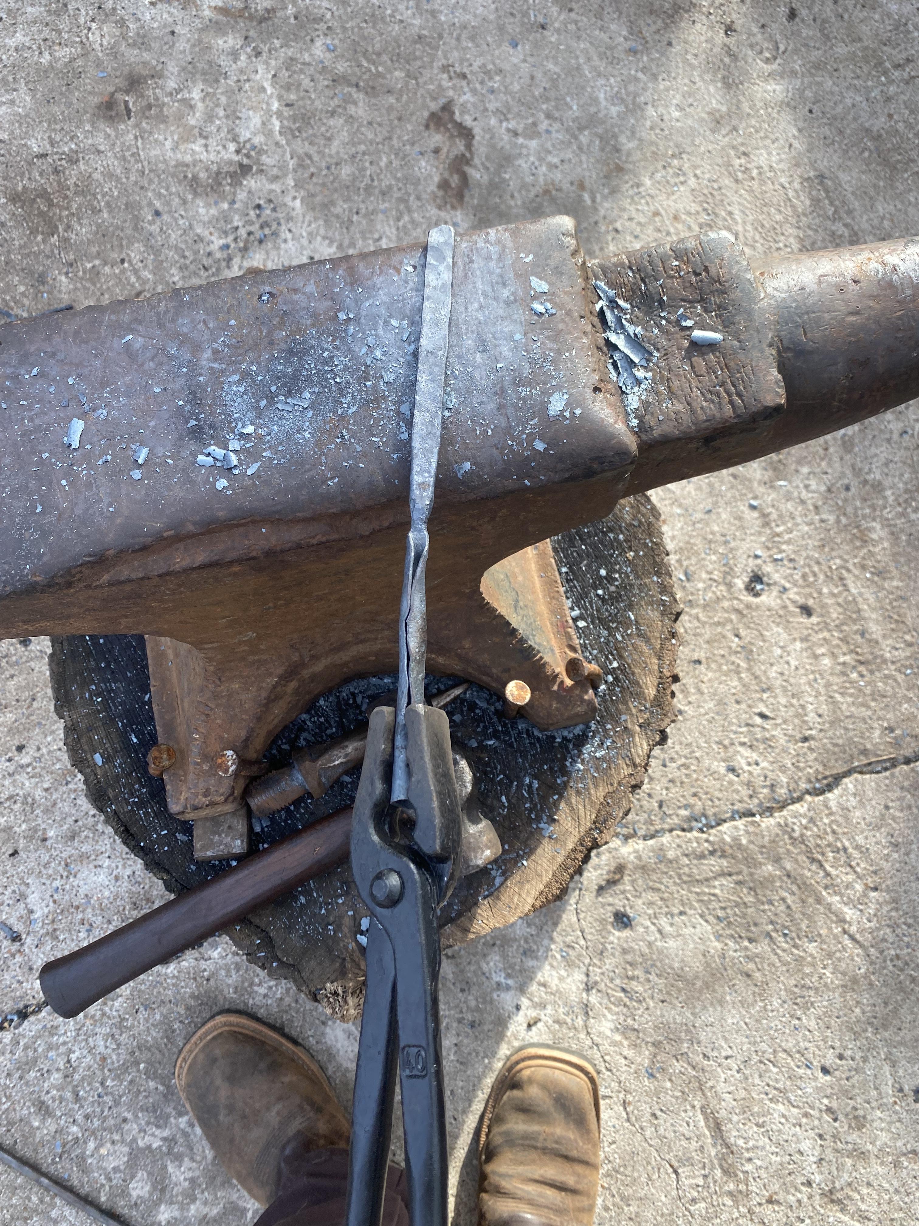

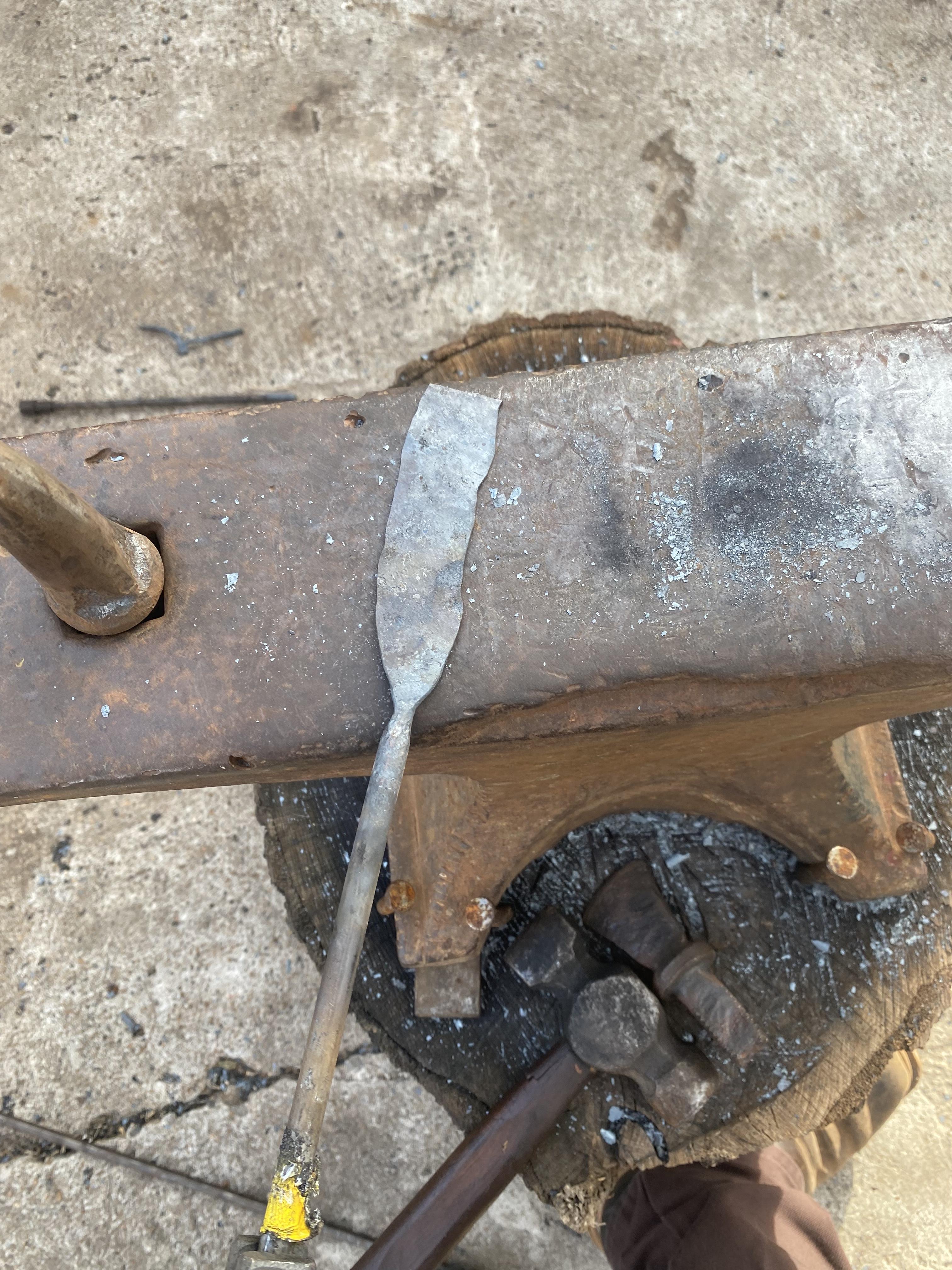

first off ive never made anything with a socket before, so lesson one I learned is you need stock bigger then 3/8” round,

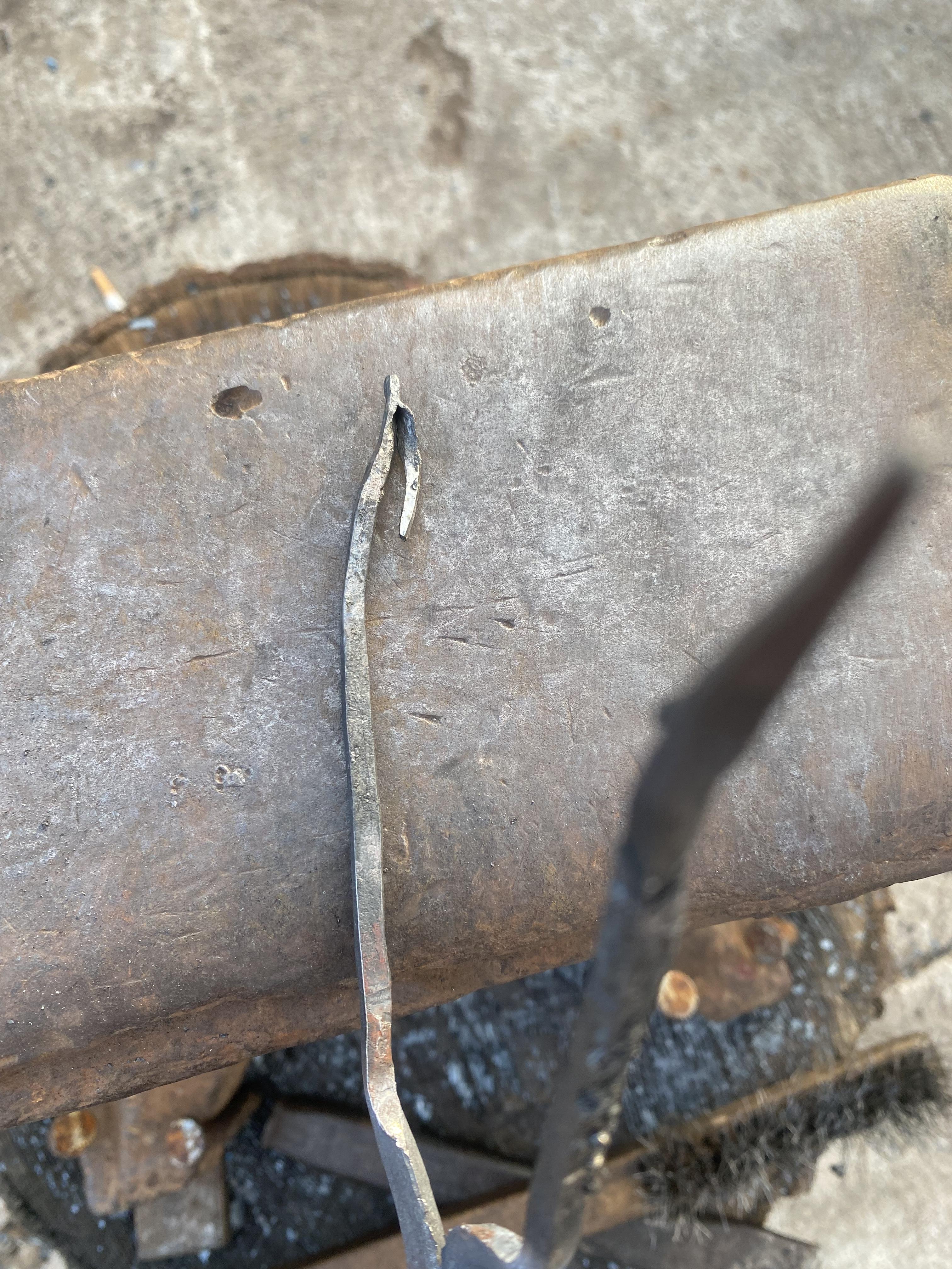

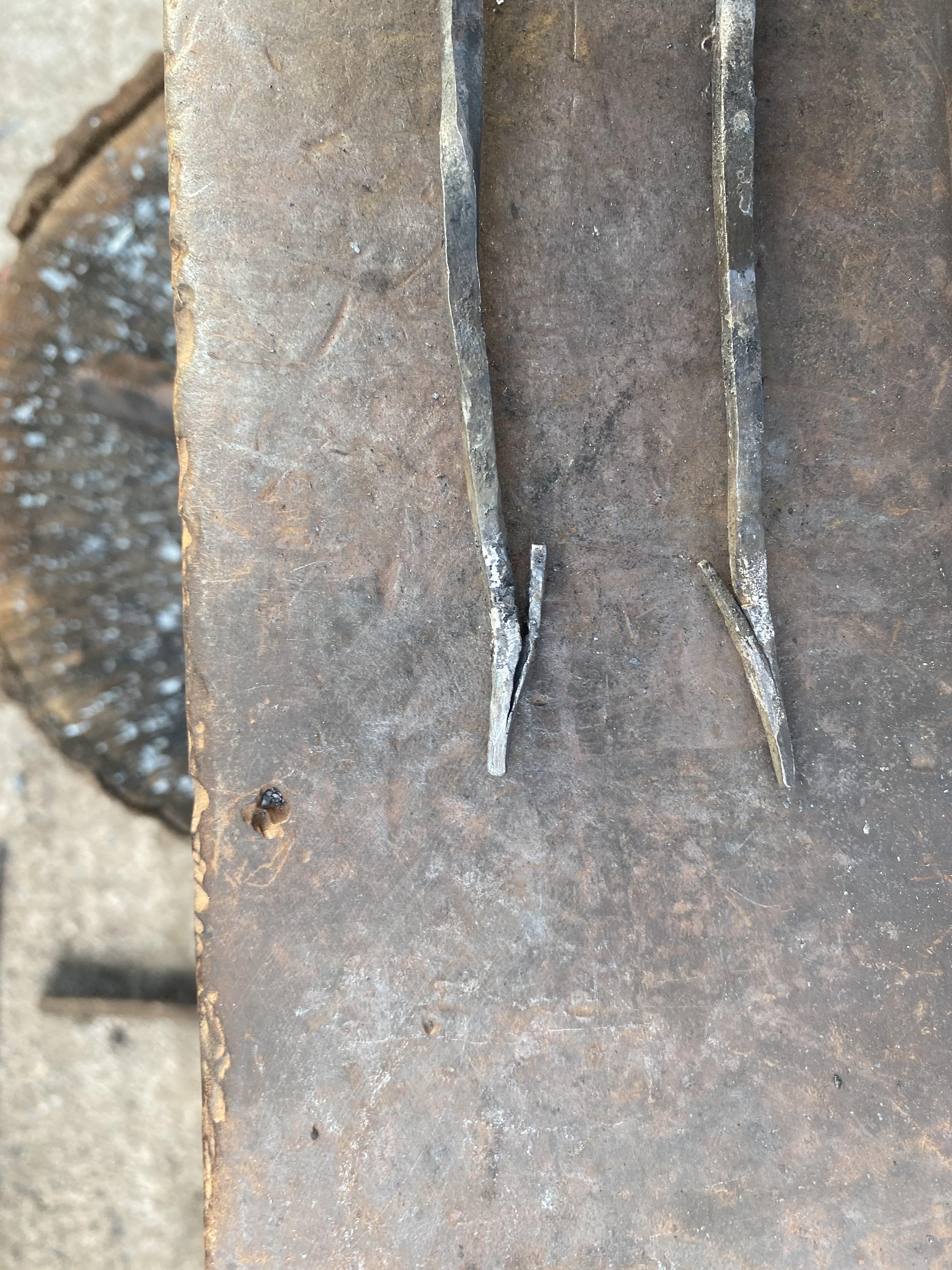

second lesson I learned was when trying to weld something as small as a barb on the end of the tine that I need to bring it up to temp slowly,
the first barb worked out great, but the second barb I got so how it was sparkling on the tip but the part I needed to weld wasn’t hot enough,
I cut it off an retried but that weld failed to, so 2 hrs for a piece of scrap metal but I know more now then I did two hrs ago, so imma call it a partial win lol, 37B46B5A-AA4A-4F94-81FA-BA128C9960A5.thumb.jpeg.4f5ebf2311028031ec013d35b8826a1c.jpeg6E81C827-93D1-45D9-B109-768244BD23C3.thumb.jpeg.fe0ef126040a5b388f4218cc9c0e4e03.jpegB9DDFC93-3421-4088-855C-A057FF95735F.thumb.jpeg.f76e2ac17187a3681764e083d295f9c1.jpeg670A9591-1626-4531-80F0-583D4C7F4F02.thumb.jpeg.99dddb4df089649939a375397af20158.jpegB649C156-6A86-4D64-8657-49B81AF1038F.thumb.jpeg.17ee5903b1ad503b544285e28b9aaa54.jpeg8125BE8C-671D-4AD6-9959-04CF4850B326.thumb.jpeg.f39d34cc2a32a0d7e81037e9cdeddd66.jpeg6D5740F6-4C36-421F-A06B-A8C95EB2F230.thumb.jpeg.f5087fefbfd86f43eaf614d0fcd1759e.jpegA782EBE1-1209-4268-9CDD-AAAF21D03FE9.thumb.jpeg.f41c0c9c430083e3f85e1cb76bf0c255.jpegA4BA2AD4-1E09-454C-A099-D88735501712.thumb.jpeg.e92c5472f09d2116659c5b9a5bd54493.jpeg050163F9-10B1-461D-8F92-05933013AE8C.thumb.jpeg.9526efea776434b7357e499169e1d419.jpeg0935422C-FD70-47EF-86EF-C3ADCBF65529.thumb.jpeg.05e5b2465cdcc29912a584f3ac74b0f1.jpegA2452334-C9FC-4F4E-B45B-B94A04E4F704.thumb.jpeg.bac7a305341f2a419132b0fff7195df1.jpeg07AFA4AC-4301-43C3-B921-340EA2BCE020.thumb.jpeg.7be88f85032187fa6db43d45dd4758f6.jpeg39602BEA-41E9-4FBD-8DDF-ACB7E4631731.thumb.jpeg.2fb02017054e052ddd2b05c4e85c6d6d.jpegC52B5641-3A21-44C6-B5E6-43E496EB12B4.thumb.jpeg.c327b286c43a6720e98ba5130fe025a6.jpeg1DB8A82E-DEEC-44DE-B8DB-172A9A900504.thumb.jpeg.92a66f1f8895e5a388e7d6a58f555552.jpeg6C43ADD4-C54A-4382-AD9D-3559F8CC47B1.thumb.jpeg.ff688a34bcb05cd5e9b40141e5123192.jpegA8F54D5D-486F-4E1E-ABE1-1A1EF3744D19.thumb.jpeg.0c64e490c103aafa268632a15252b3aa.jpeg
Make your barbs like Jennifer made the hook on the fire poker. Just don't forge it so thin and no need to weld the fold. Frogs and crawfish aren't as hard to hook and pull as a log. Hmmm?
Either upset or fagot weld the socket end before you spread it. It's just like an arrow or spear socket, just adjusted for the stick.

Hondo, do a few taps then cool the punch and repeat. The more whacks and the more the punch gets heated up the harder it is to get out.  There is also "punch lube" explained here somewhere on ifi. Also you can sprinkle a little coal dust fines or charcoal fines in the hole to help. Or after you dip the punch in water to cool (if you can depending on the punch steel) dip it straight into the fines/dust (charcoal or coal) and continue the process.
TW, the flux creates a bit of clinker and helps regular clinker bond to the kind of big clinker you have. It forms a glassy clinkery blob.
For the gig, Frostys advice is good. Also get the straight diameter of the tines then make a short spike at the end then fold and do like a faggot weld just being careful of the short spike that will be the prong. Once welded then you can spike the end also again being careful of the prong. If the prong gets tight to the prong you can use a sharper chisel to coax it away from the prong while hot.
Sorry if my explanation isn't the best. I'm having a harder time explaining what I mean but could demonstrate better. I'm in rochester ny with Elizabeths family at the moment and far from my forge.
TW, here is how I have made sockets for arrowheads, spear heads, tools, etc.:   1) figure out what size shaft you will use.  Then, calculate how wide the "fan" will need to be, e.g. if a 1" shaft, you will need the fan to be 3.14" wide. 2) calculate how thick you want the edge of the socket.  If you want the edge to be 1/16th inch (.0625") thick multiply that by the width (3.14") and that will give you the area of the edge of the socket, .19625 square inches.  Take the square root of that and that will give you the square stock you need to spread out for that size socket.  In this case, .443 inches.  Round that up to allow for loss of metal due to scale and you get 1/2" square stock to start with. 2) decide how long you need your socket to be.  Let's say 4".  Mark 4" from the end of the 1/2" square bar.  3) start drawing it out into a fan shape with the 4" mark being the center of the base of the fan.  Keep the edges of the fan straight.  4) as you are spreading the fan use a compass or divider to maintain a 4" distance from the mark all across the fan.  The edge of the fan will be a curve with a constant 4" radius to the mark.  5) once you have the fan made do any edge adjusting you need to with a file or grinder.  6) gently start to curve the socket.  Use a swage block if you have one starting with the widest curve.  You will need to use more gentle blows near the edge and harder blows near the base of the socket near the 4" mark because the metal is thicker the closer you get to the mark.  Use decreasing size curves on the swage block.  Once you are past 180 degrees you can start using outside blows on the anvil. 7) once you have closed up the socket align it with the rest of the stock which will be used to make the pointy end(s).
If you want you can weld the seam of the socket.
It is probably easier to do this than to describe it.  I have found that the trick is to start with the correct size stock for the thickness and diameter of the shaft that will have to fit the socket.  It does involve math but that is easier than wasting time and steel on trial and error.

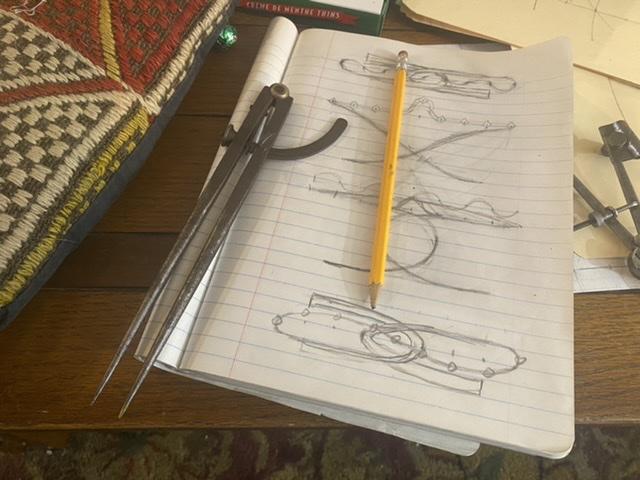

No forging today, but did manage to get an idea out of my head and into some sketches.
Starting to think that time spent designing can be just as beneficial as forging, in its own way.

Honestly I dont know how Gigs were supposed to be made, I was just kinda shooting in the dark,
I was just guessing the barbs were forge welded, same goes for why I forged the tines so small,
I probably need to watch someone else make one to give me a better idea on how to do it,
11 hours ago, Daswulf said:
use a sharper chisel to coax it away from the prong.
That’s what I did that on the first barb, that came out good,
Thanks for the info George! This was the first time I’d ever tried something with a socket, I’ve never made a spear or arrowhead before but I might give that a go after I get gigs down,
