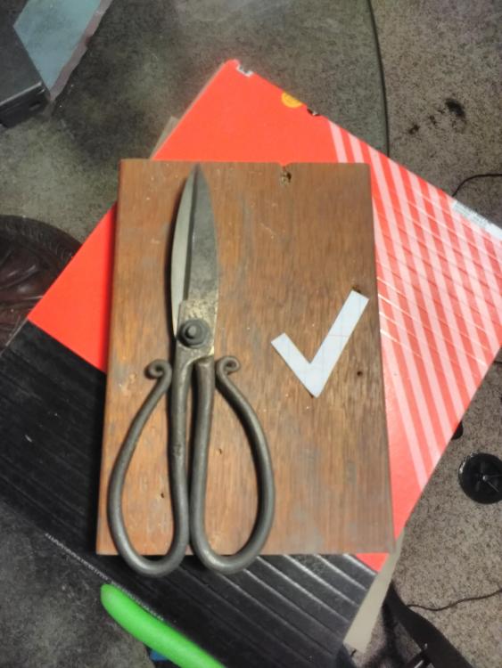

After quite a lot of tweaking I finally got the scissors to where they cut paper/cardboard very nicely. They are still just bolted together, last thing to do is hit the parts with a wire wheel to brighten them up a little and rivet them together. I will say scissors are a pain in the butt to get flat then curved in the way I wanted.

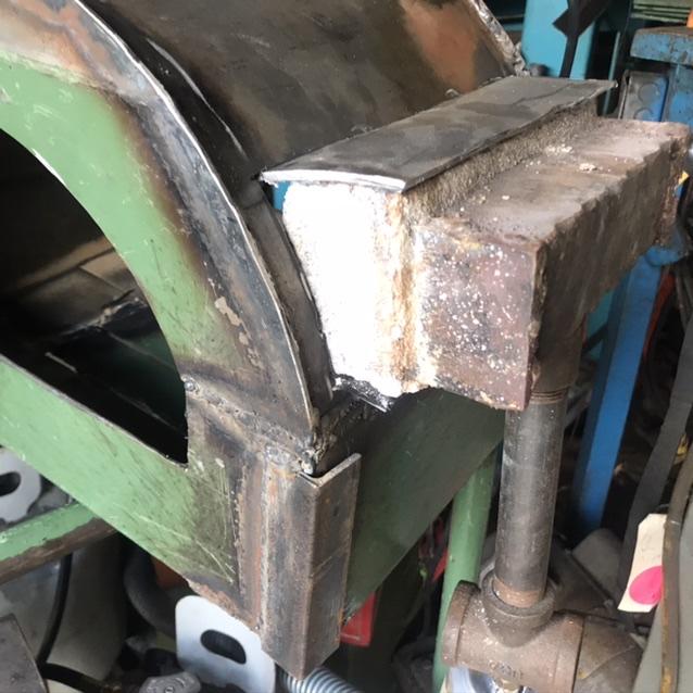

Nor much today, but I did sneak into the shop to put the opening for the ribbon burner in the new forge. With some judicious measuring, cutting, scoring, and bending, I managed to get the top and bottom the right size and still integral with the rest of the shell. Now I’ll just need to cut and weld on the ends.

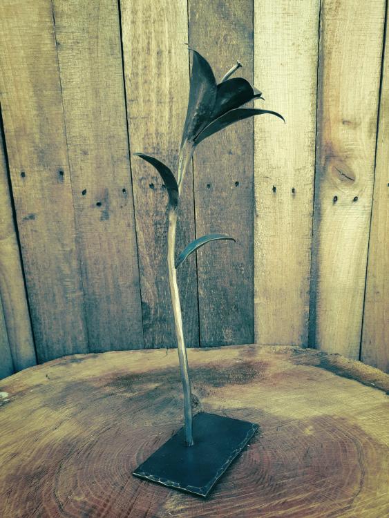

I love the look of those metal flowers! I used to have a ton of copper sheet laying around... maybe I'll give that a shot.

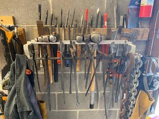

I got some good work done in the shop, which was getting a little cluttered and disorganized. I was thinking of the layout and realized its inefficiency. Here was my solution!
image0.jpeg.94d7f6c76db24e70fa3a8b4e69c5c4bb.jpegimage1.jpeg.a11a6844a3c9ece1b6725a057e0f3354.jpeg
Basically there are two right angled supports meant for a shelf that hold the whole abomination together. On the backside there is a 2-4 that I drilled 3/4 holes to fit my hand tools, on the side of the wood I hot glued in some cheap neodymium magnets that are holding the majority of my files and other oddities. The hammers are on two channels of aluminum in the middle and finally the tongs are on a chunk of rebar that sits nicely on a hook on the end of the right angles. On the end of the rebar I can hang PPE and jackets. Overall its a big improvement from past, of course as this addiction takes its natural course I will need to expand as more tools are piled on.

John; those forge doors (aka "gates")  demand a nice motto---how about "Lasciate ogne speranza, voi ch'intrate"?

I'm thinking Frederick Douglass: "It is not light we need, but fire."

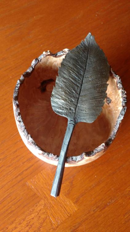

Gofishunt, the leaf looks great, but one very small critique. You may want to radius the edge of your texturing tool. That would lessen or eliminate the tool marks near the the center vein.
As for the stem breaking, try to keep it hot, maybe. Honestly, I struggle with the same problem.
