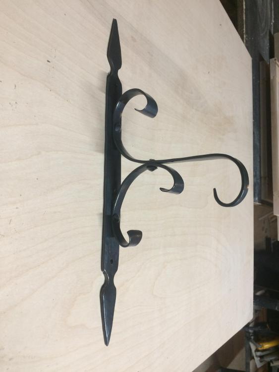

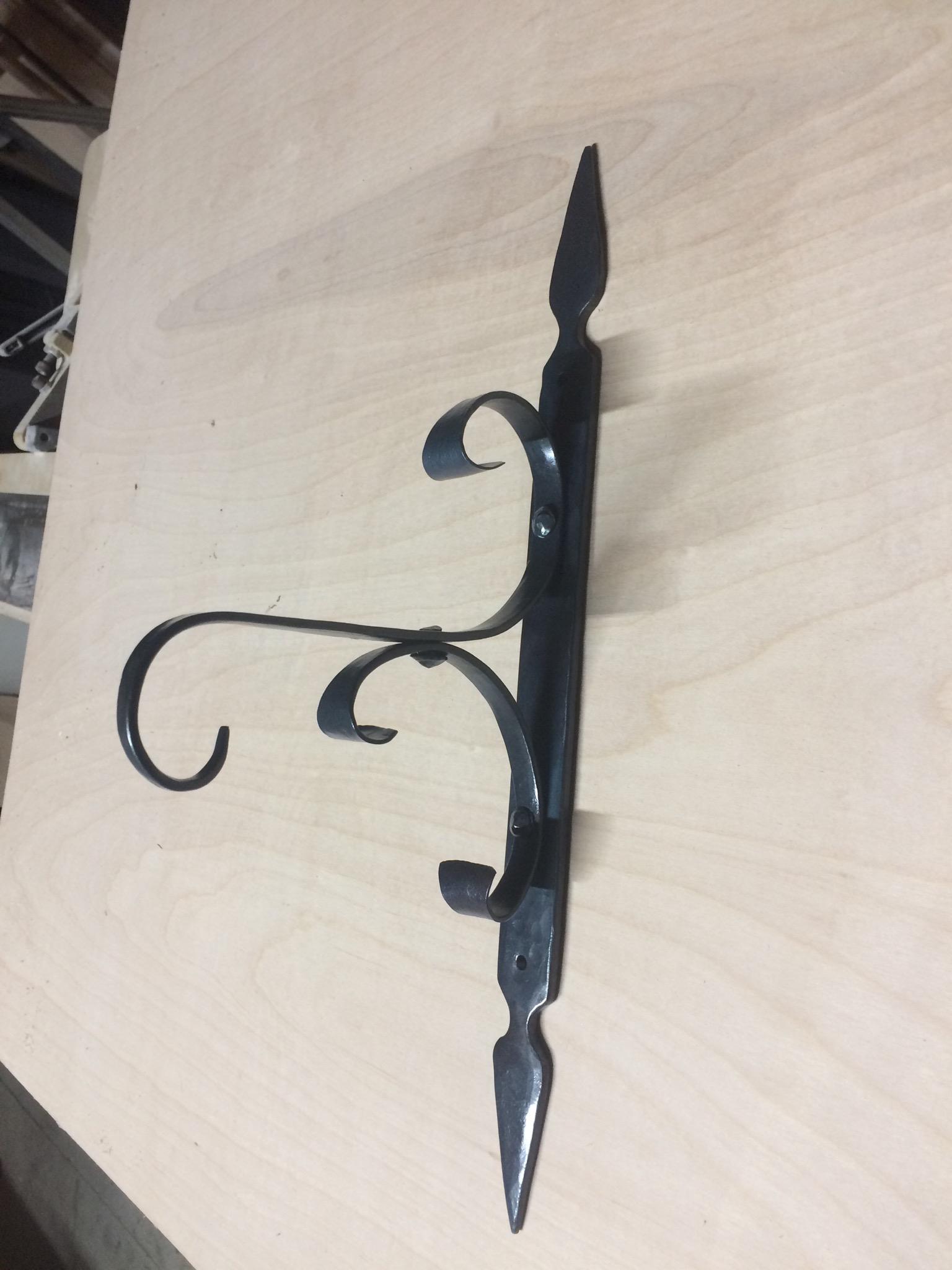

I’ve been busy cutting fire wood and getting the tractors ready for the spring, but I did have time to make this for my mom. I had some issues with the rivets, but overall I’m pretty happy with it.
Just "happy with it"??????  I'd be turning wrong side out bustin' buttons.  Heck, I'd probably go out to the road in front of the property and put up a sign saying "Come look at this plant hanger!"  That's really nice.

Very nice. I can't wait to get my forge up and running again.  What size stock did you start with? 3/4X1/8

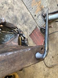

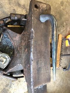

One of my friends at work asked for a meat flipper and toasting fork for his dad. My 2nd.try at each, the tongs on the fork were longer until I decided I needed to heat them up again to make a little adjustment and left it in the coals a couple seconds too long. Also made a bick , from 7/8 sucker rod, to work smaller circles because the end of the horn on my anvil is too large and blunt to make things like bottle openers. I made the opener on the end of the meat flipper using JHCC's design before I made the bick, thanks for the idea.
Thanks for all the nice comments. I have had very little time in the forge the last 6 months, so it was nice to have something turn out how I wanted it to ( minus the rivets.)  That was also the first plant hanger I have made.
Punt, I used 3/16”x1” for the upright, 1/8”x1/2” for the scrolls,  and 3/16” rivets.
Les, I love the bick, but that is going to be bouncy at the tip of it..  Ideally you want to keep them as short as possible with the correct profile for the item desired..  IE sockets, holes, etc, etc.
nice job on the fork and stake flipper/bottom opener..   Will be a good one for catching the unsuspecting skirt wearer standing along or behind while opening that bottle.

Good looking fork and steak flipper Les. Ditto Jennifer about keeping bics short and sweet they shouldn't extend any farther past the edge of your anvil to allow room to work all sides of a piece. However, bics with a profile like yours are very handy for turning tapered helixes. (Visualize a giant cork screw)
In general though, short and close work better.

Jennifer & Frosty, Thanks for the advice on making a shorter bic and for “another use” for the flipper, if I was 20 years younger I’d have another way to get in trouble.
