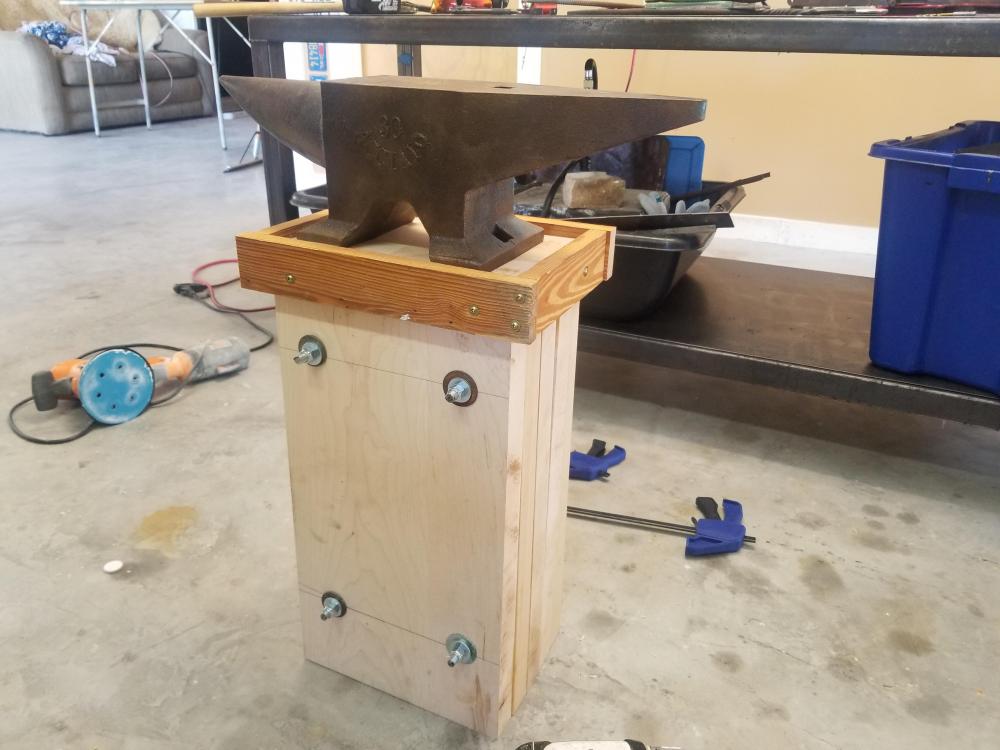

  3. There's the rub. It's a mixed use shop, and things get moved around a lot. It won't always be in the the same spot, so I can't shim it for a particular location.
  4. Ive been trying to upload one but it's not working. Maybe this link will... Not trying to get it perfectly evel, just need it not to rock back and forth.
  5. Stand is 5 pieces of walnut countertop (scrap leftover from a remodel) glued/bolted together. We got the top true so the anvil sits doesn't rock, but the bottom is pretty jagged. We lack the tools to plane it smooth, so planning on using 1/2" T nuts and feet designed to level pool tables, which should have the added bonus of allowing it to be more portable and sit evenly wherever it is. Anyone have any experience with a similar set up?
