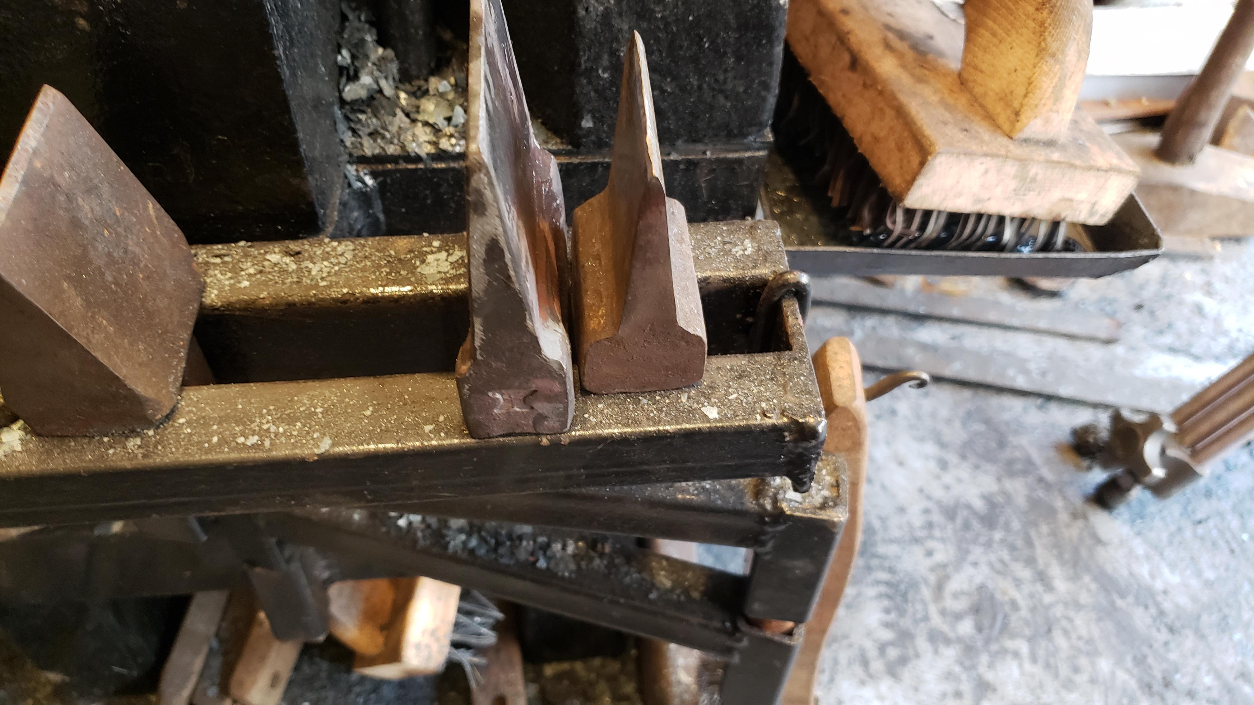

jlpservicesinc Posted April 1, 2020 Share Posted April 1, 2020 Well, today was one of those days.. really it started yesterday.. Where the metal just does not want to move where you want it to.. No matter the prodding.. It just won't move where you want it. I started a new hot cut hardie build for the Refflinghaus and after 4 hrs I ended up with this.. It's decent but no matter how I heat it, or hit it. the bottom section would just not upset.. The problem I have is forging that size material of 3/4"X 3.00 X8.00 all by my lonesome.. I had to drag out and spend some alone time with the 9lbs hammer and when I say some time about 1.5hrs. I've been forging a few hours a day for the last 4 so actually feel pretty good tonight though both wrists are sore and my arms are fatigued, but its what I expected. Part of the problem is I loath working that large of material by myself.. Getting the 3/4" upset to the 1.25 needed for the base and then pull the shank out of it.. Well, Tomorrow They will feel all the better for it.. finish and heat treat tomorrow. Quote Link to comment Share on other sites More sharing options...

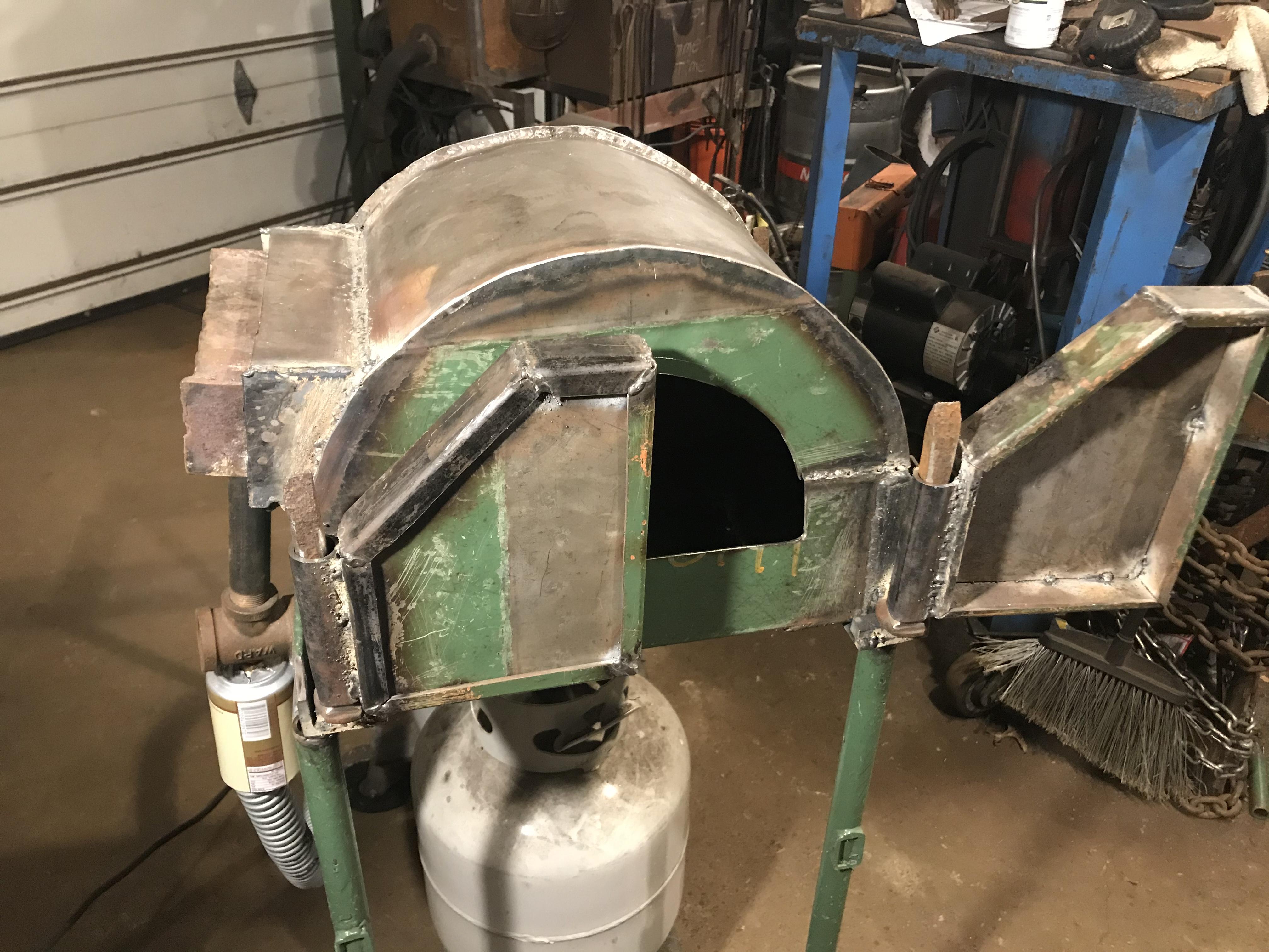

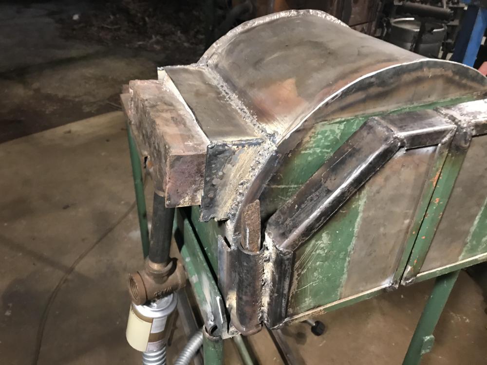

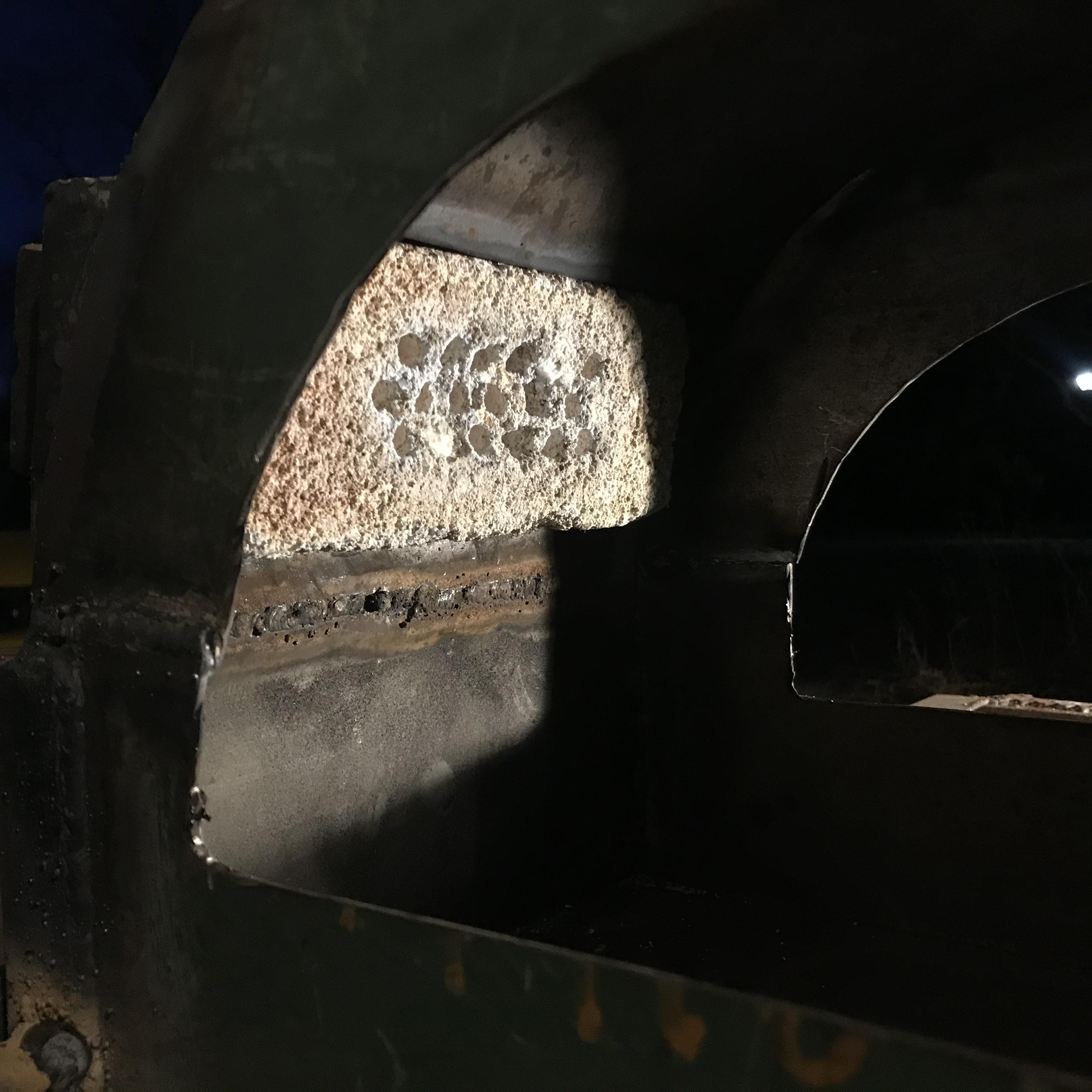

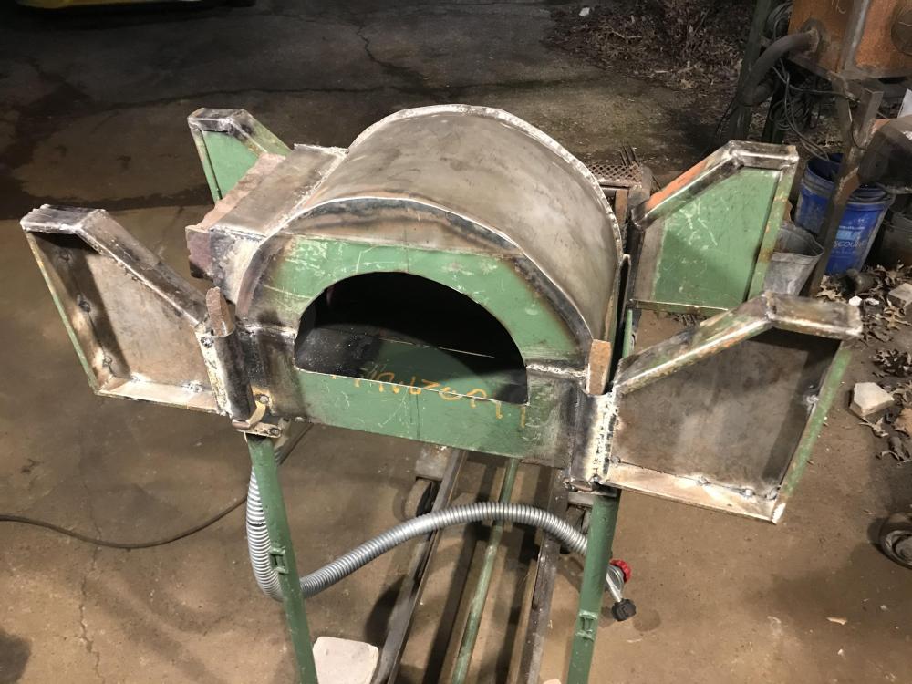

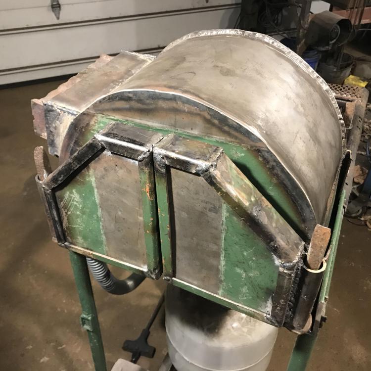

JHCC Posted April 3, 2020 Share Posted April 3, 2020 Finished welding up the metal parts to the new gas forge. I ended up going with hinges made from RR spikes and 1" black pipe. The bottom of the pipe is squared off to register on the spikes as open, shut, or half open. The shafts of the spikes are rounded off about 1" from the head, to allow the squared section to turn. Front view, all doors shut: All doors open: Doors half open: Ribbon burner port and hinge: One side open: Inside face of burner block: Gap between forge shell and doors, to allow for hard refractory face on the forge-facing sides of the doors: The whole thing is mounted on my existing forge cart, at the other end from the brackets that hold my helium tank forge. Both forges simply drop in place, so I can store them both on the cart and remove whichever one I'm not actually using at the moment. Quote Link to comment Share on other sites More sharing options...
jlpservicesinc Posted April 3, 2020 Share Posted April 3, 2020 Nice job JHCC.. That is sharp looking. Can't wait to see it in action. Quote Link to comment Share on other sites More sharing options...
Irondragon Forge ClayWorks Posted April 3, 2020 Share Posted April 3, 2020 Looks super so far, love the hinges. Quote Link to comment Share on other sites More sharing options...
JHCC Posted April 3, 2020 Share Posted April 3, 2020 Here's a little video of the hinges in action. Note the gentle birdsong, which is to be found in far too few blacksmithing videos. Next steps are to line with ceramic wool (which I already have) and cast the hard refractory flame face (which I will need to buy). Quote Link to comment Share on other sites More sharing options...
CtG Posted April 3, 2020 Share Posted April 3, 2020 I'm sure less wiggle will be needed with refractory weight added. Indexing hinges, nice! What a pleasant song- we are being graced by the calls of grackles of late Quote Link to comment Share on other sites More sharing options...

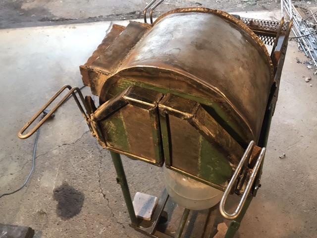

JHCC Posted April 3, 2020 Share Posted April 3, 2020 Decided to put some handles on the forge doors. They stick out a bit, but I’m planning to add a shelf in front of the door anyway; that should help. I tried a couple of other versions, but then I realized that they would either (A) not work well or (B) probably get too hot from the dragon's breath. Quote Link to comment Share on other sites More sharing options...

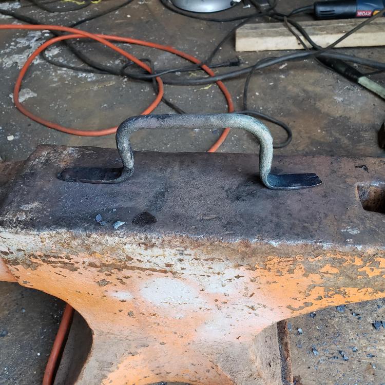

Welshj Posted April 4, 2020 Share Posted April 4, 2020 ^ I like that JHCC! Well thought out, and well done. Got my forge fired up today after re-lining it. It's not much, and not exactly ingeniously done... but it's technically the first thing I've ever forged. New pull handle for the forge shed door. Quote Link to comment Share on other sites More sharing options...

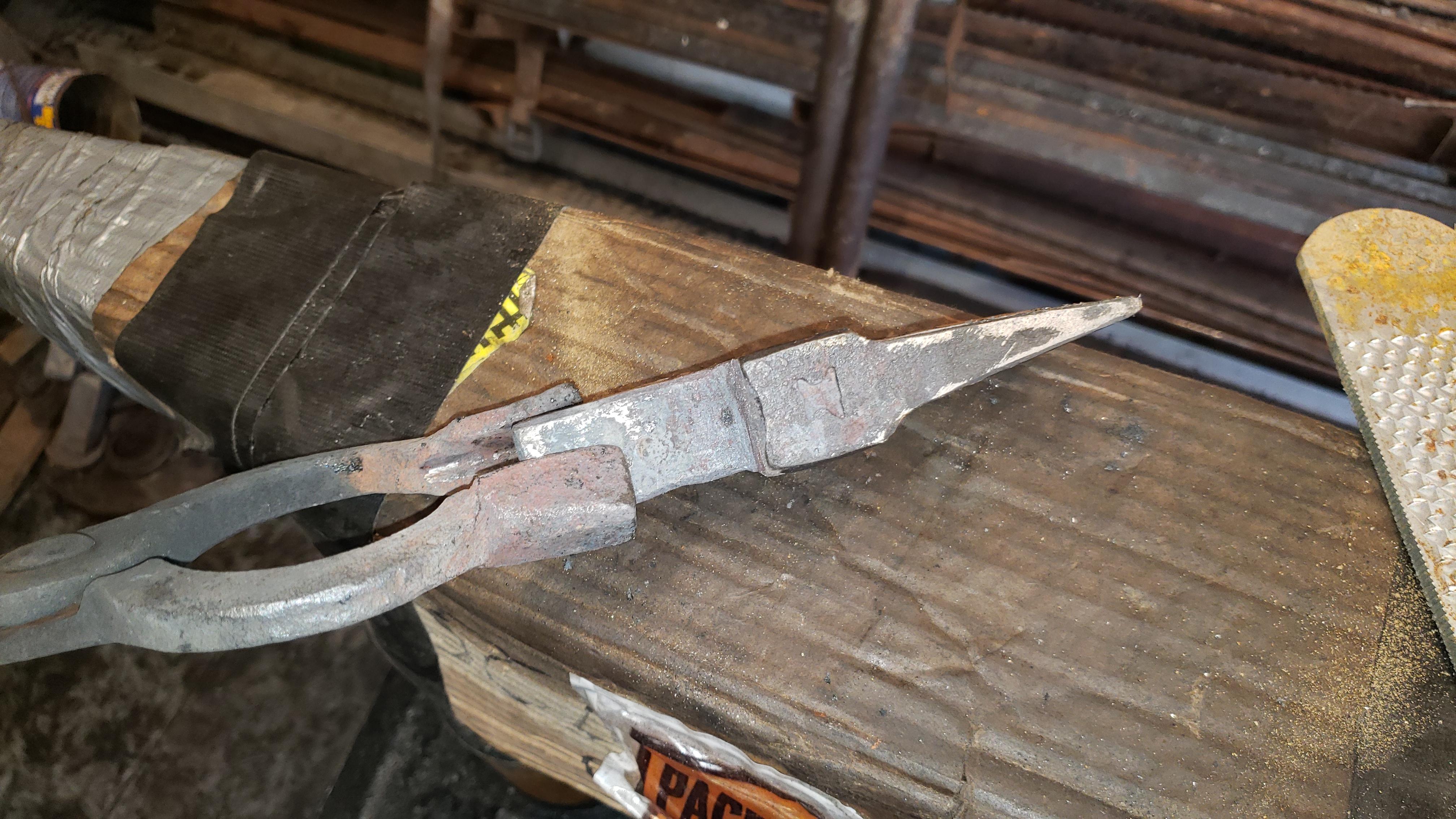

jlpservicesinc Posted April 4, 2020 Share Posted April 4, 2020 Hey, thats pretty awesome.. Well done. There are a few videos on forging finial. (pronounced Fin-E-el) I don't have any videos on it alone but the peening video shows how to move metal only in one direction. the hinge video does show forging a Finial but there are so many examples and shapes. Quote Link to comment Share on other sites More sharing options...
CrazyGoatLady Posted April 4, 2020 Share Posted April 4, 2020 JHCC, your forge looks great. It looks like it will withstand anything you throw at it. Welshj, nice work. Door pulls were some of the very first things I forged also. It was fun wasn't it? Keep it up Quote Link to comment Share on other sites More sharing options...
pnut Posted April 4, 2020 Share Posted April 4, 2020 14 hours ago, Welshj said: New pull handle for the forge shed door Be careful. The hardware rabbit hole is a deep one. Good work. Pnut Quote Link to comment Share on other sites More sharing options...

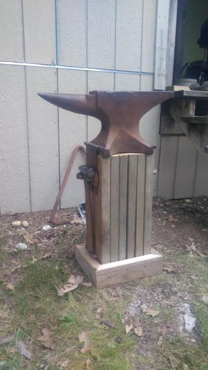

Shabumi Posted April 4, 2020 Share Posted April 4, 2020 It's raining enough to stop me from working outside, so I'll share something I did the other day. I moved my anvil from it's stand of sand filled nesting tire rims to a stand I made specifically for it from some scrap lumber. Used some gate hook bolts to hold it together and to make hammer holders on either side. Quote Link to comment Share on other sites More sharing options...
CrazyGoatLady Posted April 4, 2020 Share Posted April 4, 2020 I hear you on the rain Shabumi. Same here. Your stand looks really nice. Do you forge outside? Quote Link to comment Share on other sites More sharing options...
Shabumi Posted April 4, 2020 Share Posted April 4, 2020 Yeah I'm out in the elements for now. I have everything put up right now, Tess and Mariah have decided to visit on and off for the last few weeks, with Tess's cold cousin popping in now and then. Which is why I decided to spend some time to make a stand for the anvil instead of nesting the rims in the proper order for the right height. The rims were nice to find the right height for my anvil. Depending on how I nested them together I could vary the height of the anvil face from 24" to 36" Quote Link to comment Share on other sites More sharing options...
