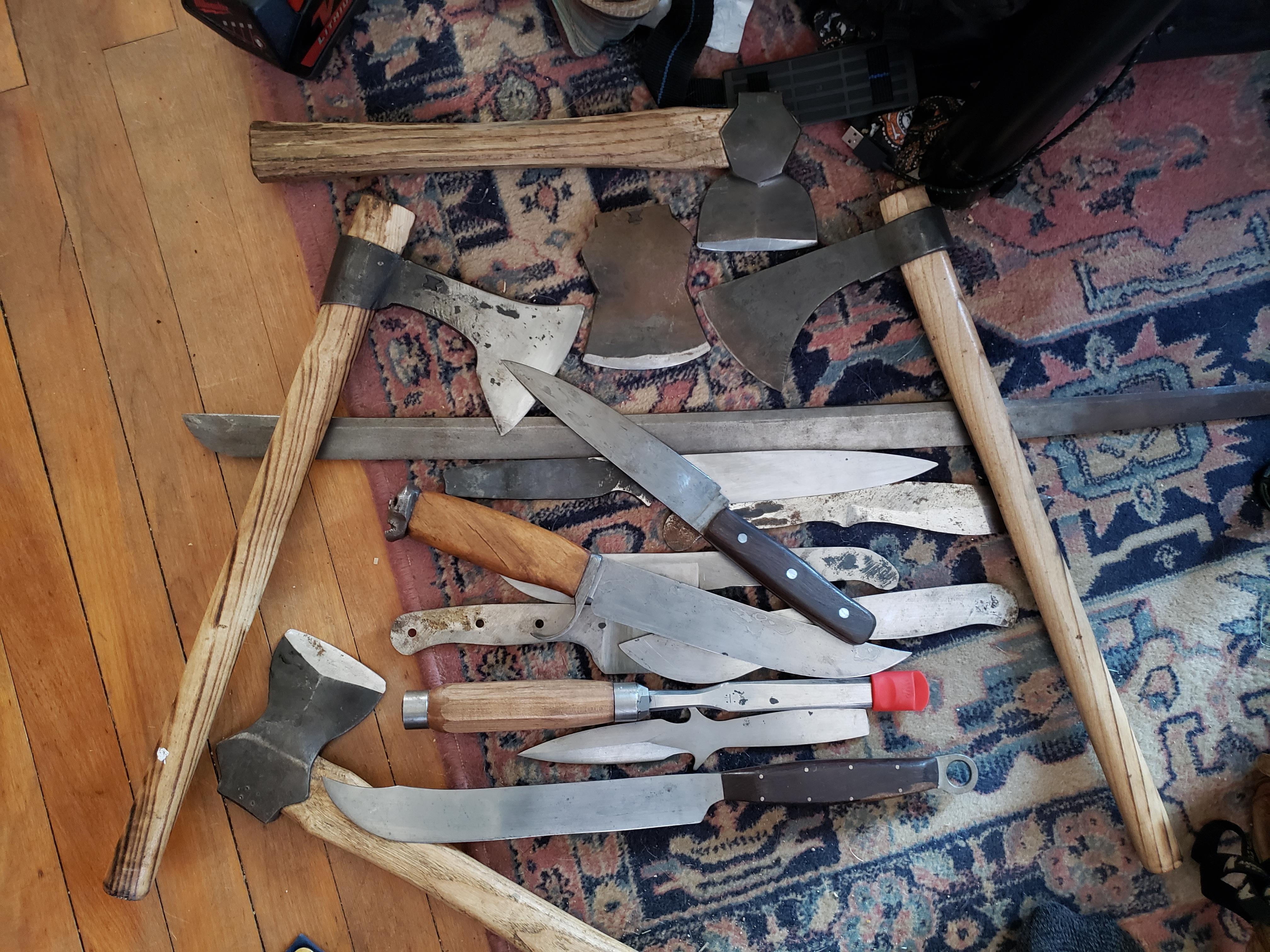

jlpservicesinc Posted March 18, 2020 Share Posted March 18, 2020 So I was asked to compile edged tools for show and tell. It's amazing to me for someone who forges so little how much I have done in the last 3 or so years of coming out of retirement especially since I only forge on average about once a month or less. This photo doesn't include all the knives or hatchets sold nor all the other thumblatches, hinges, handled punches, hammers, hardies, etc, etc. Funny really. Quote Link to comment Share on other sites More sharing options...
JHCC Posted March 18, 2020 Share Posted March 18, 2020 That's some good lookin' work right there. Quote Link to comment Share on other sites More sharing options...
