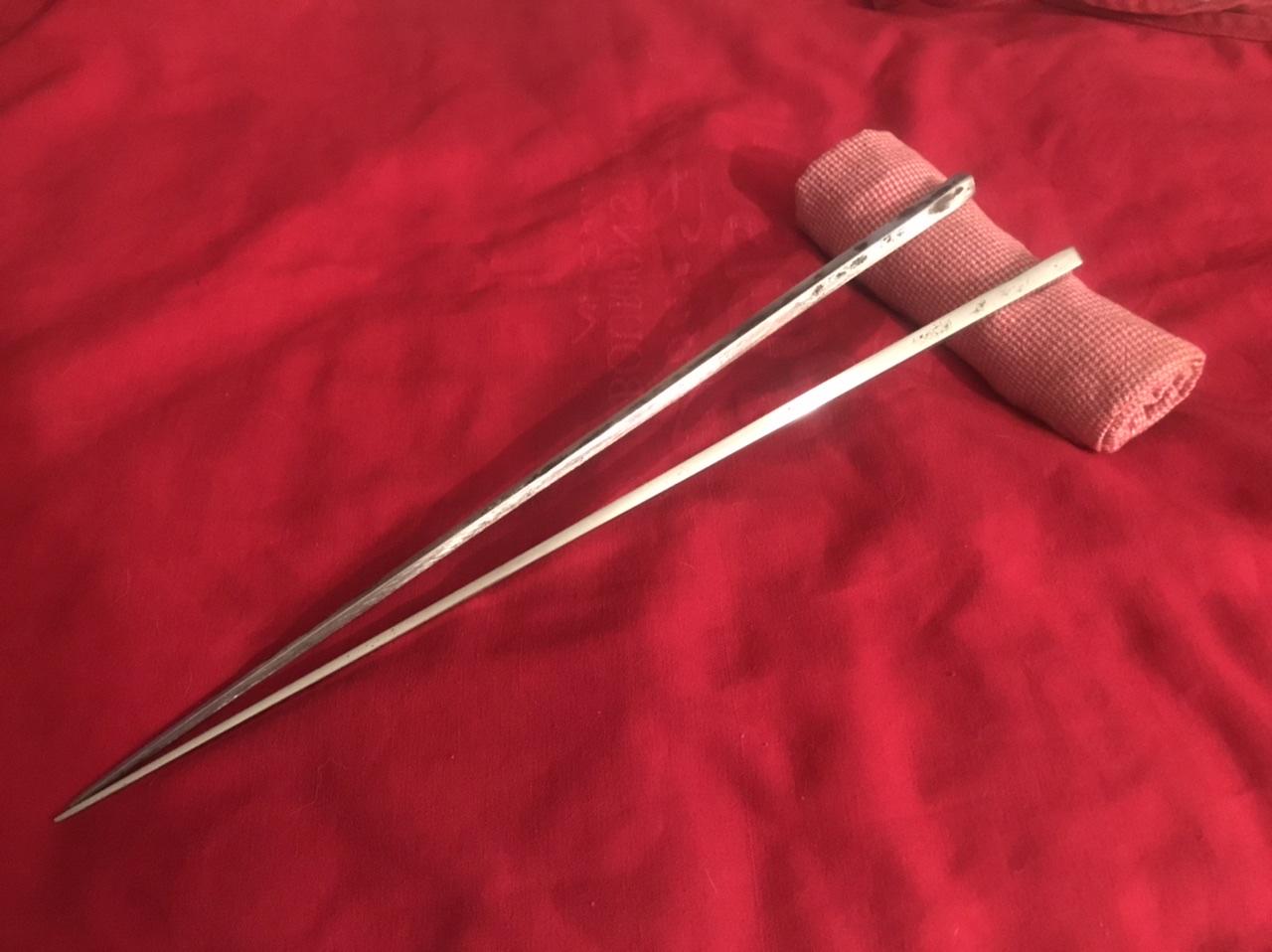

Goods Posted January 1, 2020 Share Posted January 1, 2020 Today, I got one half of a siabashi set(?)(cooking chop sticks) finished for my older son. They started as 7/16”dia x 6” (each) of 304 stainless steel. Taper forged out to 15 inches long from about 3/8” squat down to a little lest than 1/16” square. Draw filed, then a vinegar soak, finally (only one so far) hand finished down to 1000 grit. Intentionally left some of the forge finish as a nod to the fact that they were hand forged. Next time I may try a harden able stainless steel... Forge on and make beautiful things! David Quote Link to comment Share on other sites More sharing options...

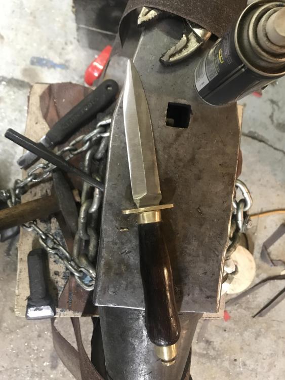

CheechWizard Posted January 1, 2020 Share Posted January 1, 2020 new grinder (2x48) 120 scr controller, added some extra filtering and kept the surge protection left over from the power conditioner i gutted mostly for the enclosure new anvil stand made from 4x12's and lag bolts. lastly a small dagger im working on. gonna switch to hand filing to work out some a-symmetry. Quote Link to comment Share on other sites More sharing options...

jlpservicesinc Posted January 1, 2020 Share Posted January 1, 2020 cheechwizard, love the anvil, and belt grinder.. What did you end up using for a motor? I know its from a treadmill, but what horse power? Max RPM? Quote Link to comment Share on other sites More sharing options...
