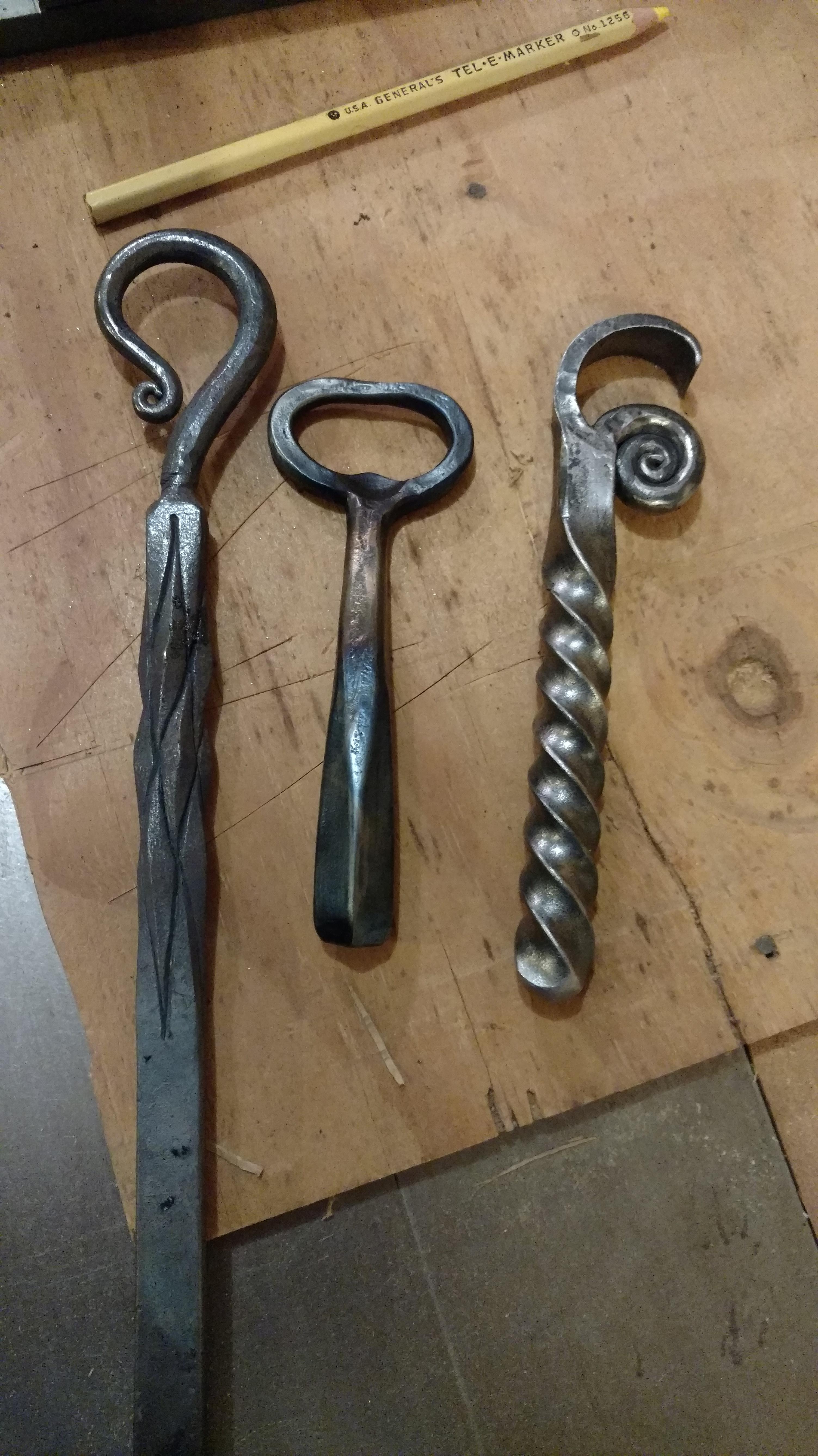

GolFisHunt Posted January 4, 2020 Share Posted January 4, 2020 My efforts from Thursday. A couple of bottle openers and a pineapple twist handle. I'm having a problem with stress crack when using a spring fuller. Working it too cold maybe. Quote Link to comment Share on other sites More sharing options...
Les L Posted January 4, 2020 Share Posted January 4, 2020 Nice looking work Quote Link to comment Share on other sites More sharing options...
Owen Hinsman Posted January 4, 2020 Share Posted January 4, 2020 Nice work GolFisHunt. I really like the one on the right. Quote Link to comment Share on other sites More sharing options...
GolFisHunt Posted January 4, 2020 Share Posted January 4, 2020 Thanks, gents. Feels like I'm making progress. Quote Link to comment Share on other sites More sharing options...
Owen Hinsman Posted January 4, 2020 Share Posted January 4, 2020 You certainly are. Quote Link to comment Share on other sites More sharing options...
