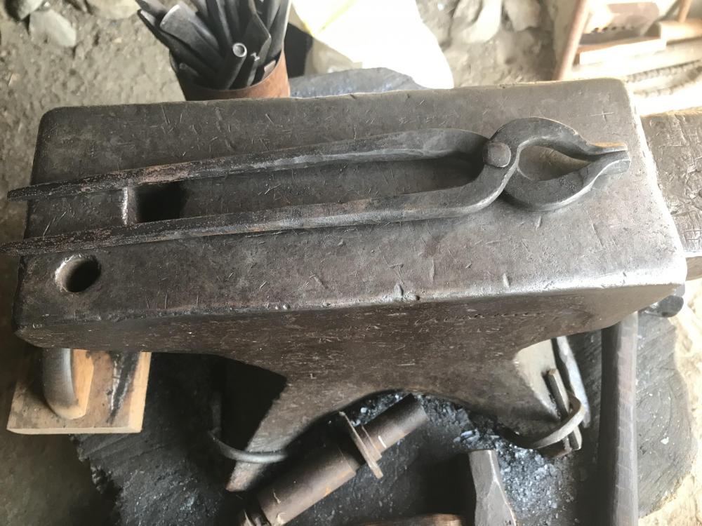

  1. I haven't had any issues, and I'm happy that I repaired it. The 4140-ish steel also has been plenty hard enough for my use.
  2. Thanks! I used two pieces of tine. One is horizontal acting as the face of the heel, and the other is angled at around 30 degrees below the first. Looking back I'm not sure if that was the most efficient arrangement, but it ensured all the welds were full penetration.

  7. Here is a link to the method: https://www.anvilmag.com/smith/anvilres.htm I used this method when I repaired the heel of my anvil, and had good results (although I avoided welding on the face as much as possible): I don't think welding just around the perimeter will give you good results. There will always be a small air gap in between the plate and what's left of the anvil face. I think building up the face is a much better option, although it will be a lot of work and the rods are quite pricey.

  10. Those don't look too bad to me! I always find it interesting to see the tongs I've made and how they've evolved. Here are pretty much all the ones I've made, more or less in chronological order from right to left. I still use some of the earlier ones occasionally.

  18. Update: It's holding up fine so far. The heaviest work I've done on the heel is drifting a couple hammer eyes with a 6lb hammer in the hardy hole.
