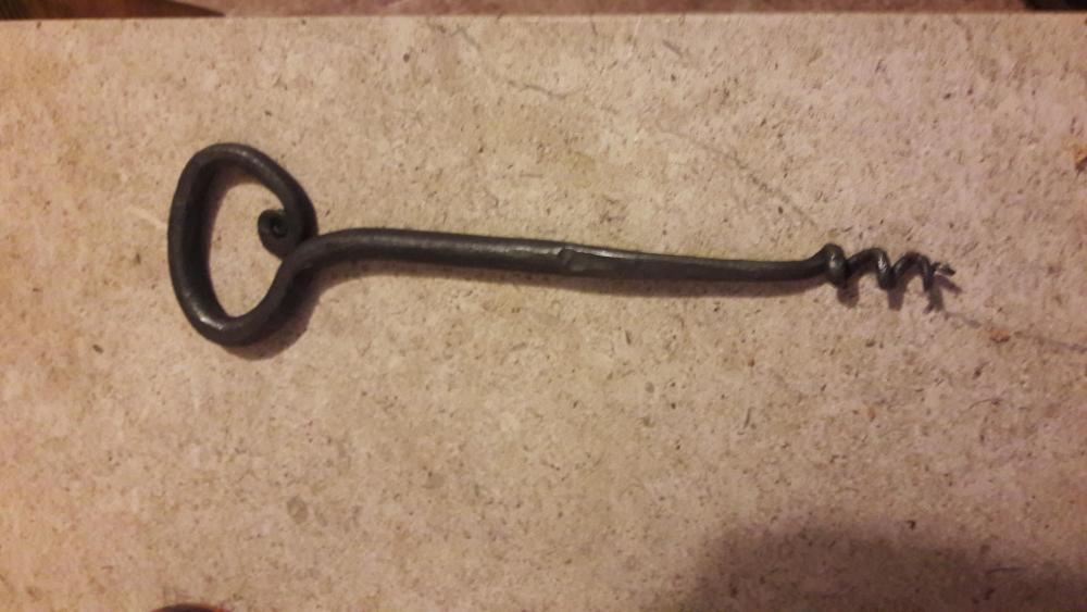

Zeroclick Posted January 7, 2018 Share Posted January 7, 2018 I made another bottle opener today and did my first corkscrew took a few goes to get it right but looks like it works. I also made a drift out of 25mm. Quote Link to comment Share on other sites More sharing options...

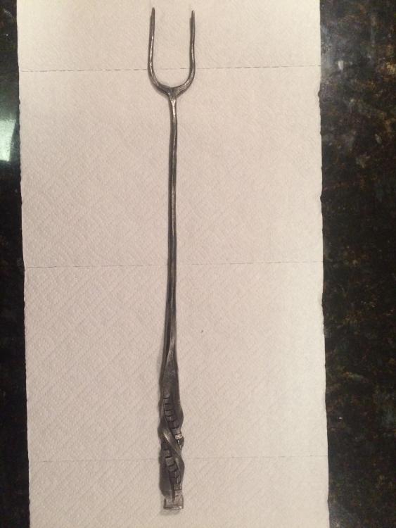

CWest Posted January 7, 2018 Share Posted January 7, 2018 Made this toasting fork last night, with a rubics twist handle. I am happy with the twist seeing as it was my first. Starting stock was 8” of 5/8” sq. Quote Link to comment Share on other sites More sharing options...

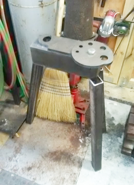

Stitch Posted January 7, 2018 Share Posted January 7, 2018 Looking good! I would really like to see whatcha' make with it! I worked on my Dial a hole anvil today. A bit more drilling, fabrication and welding to go but it's going to work great! I added an oval for Tomahawk heads and such. I hope to have it finished tomorrow. Quote Link to comment Share on other sites More sharing options...

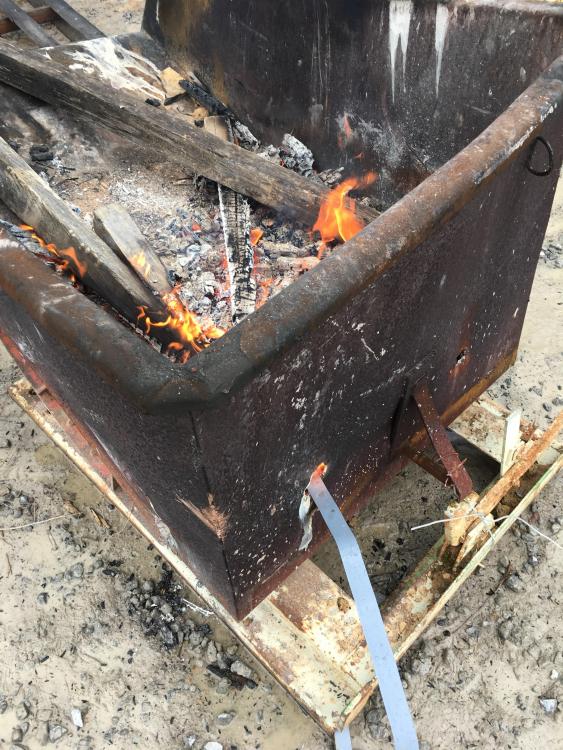

Michael Cochran Posted January 8, 2018 Share Posted January 8, 2018 Used the burn barrel at work to test some metal strapping to see if would harden. Used a mud puddle right by it for the quenchant. Muddy water isn’t the greatest but it worked well enough. The wide bands our bundles of pipe are held together with didn’t get brittle hard but tough hard so I’ll take some home to see if it’ll harden better with a more proper setup. The bands holding the cross ties together we ordered are hardening brittle hard so there’s something good there to go with my bandsaw blades I’m getting. Quote Link to comment Share on other sites More sharing options...
