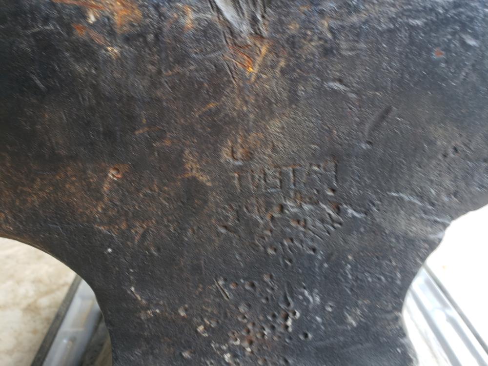

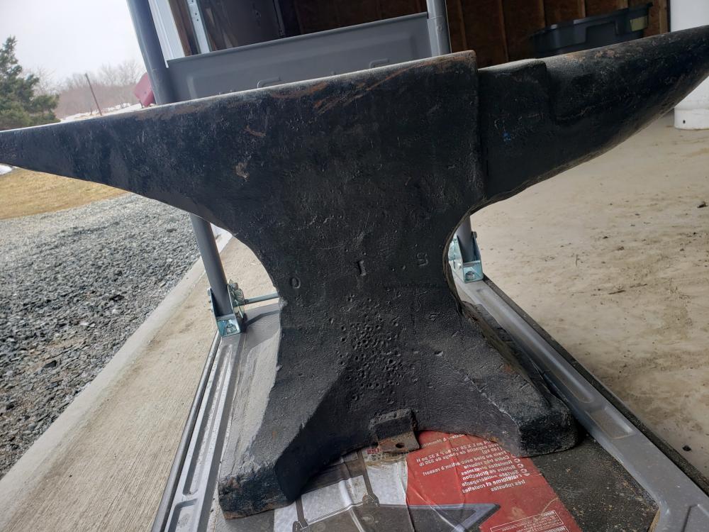

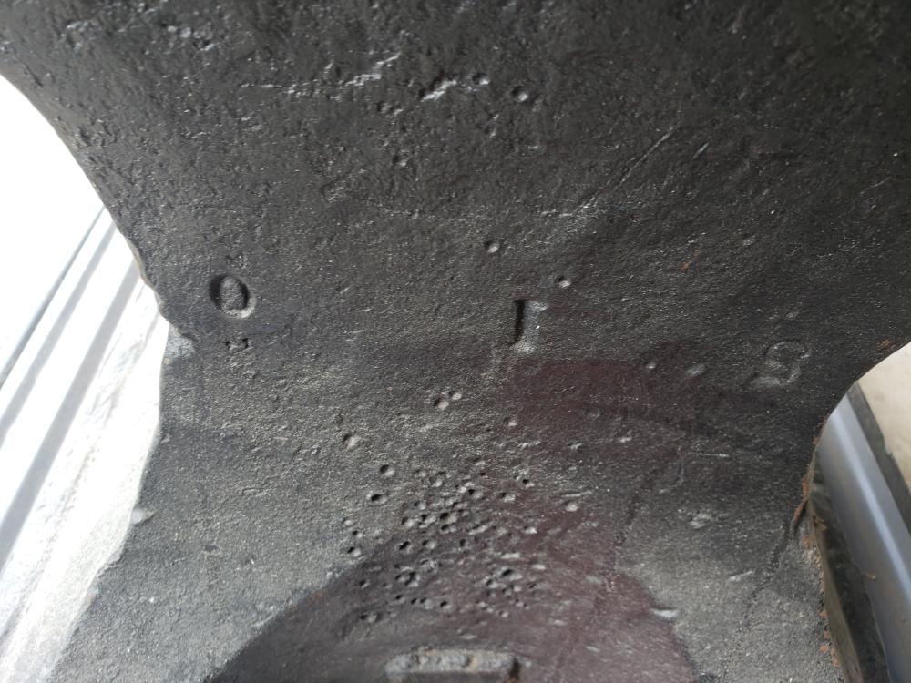

  17. Thxs Irondragon i wasn't sure on english stone weight and it wasn't the weight i was intrested in it was what the 210 meant in weight maybe i didn't word my ques right initially.To me in my limited experiance with PW anvils its a PW because of where the word patent is on the body what do you think is it a Peter Wright or am i wrong.
  18. The # is reversed in photo but its 210 the word is patent so whats the verdict Peter wright or something else.
  19. I break the wifes scale i'm dead lol i'll get some pics up shortly.
  20. Did a search can't match # to check age and weight i was just given this anvil it says patent on body but the name is rubbed out and 210 is punched into base the same as my 120 pound PW.Has anyone have an idea on age and weight i'm guessing over 200lbs on weight..
