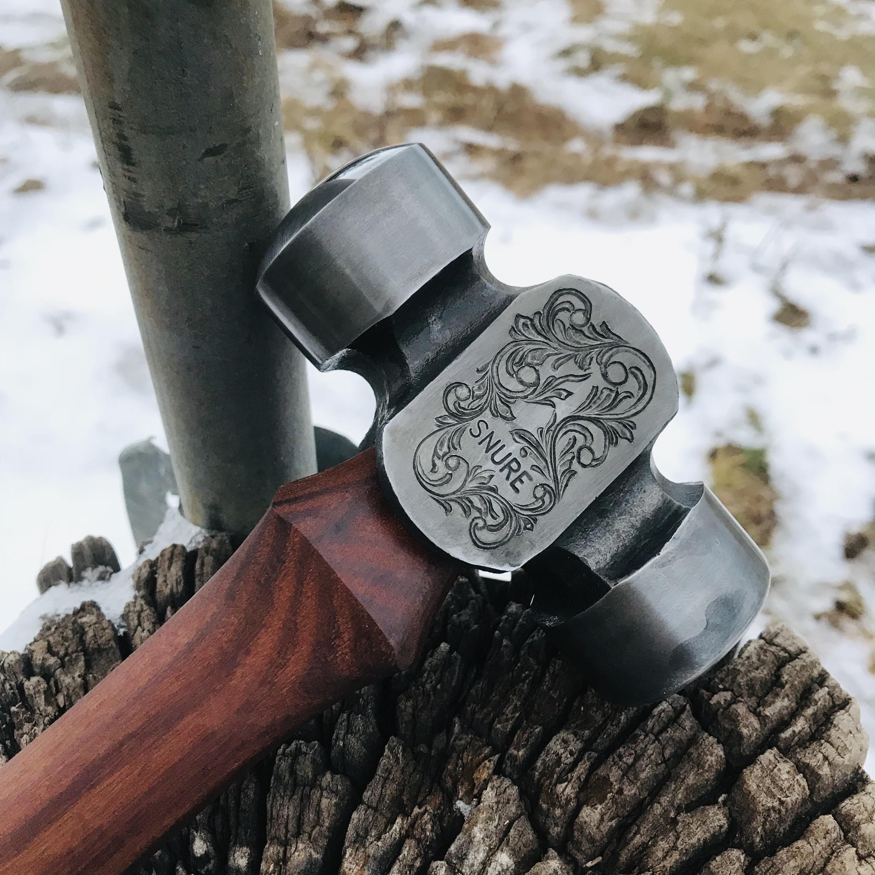

Ranchmanben replied to Mark Ling's topic in Blacksmithing, General Discussion
A few weeks ago I posted a batch of hammer heads with one that wasn’t quite like the others. I’d teased that I had plans for it. It’s finally done. 2lbs with bois d’arc handle wedged with hickory. I had my dad do the engraving. Cold blue finish. -

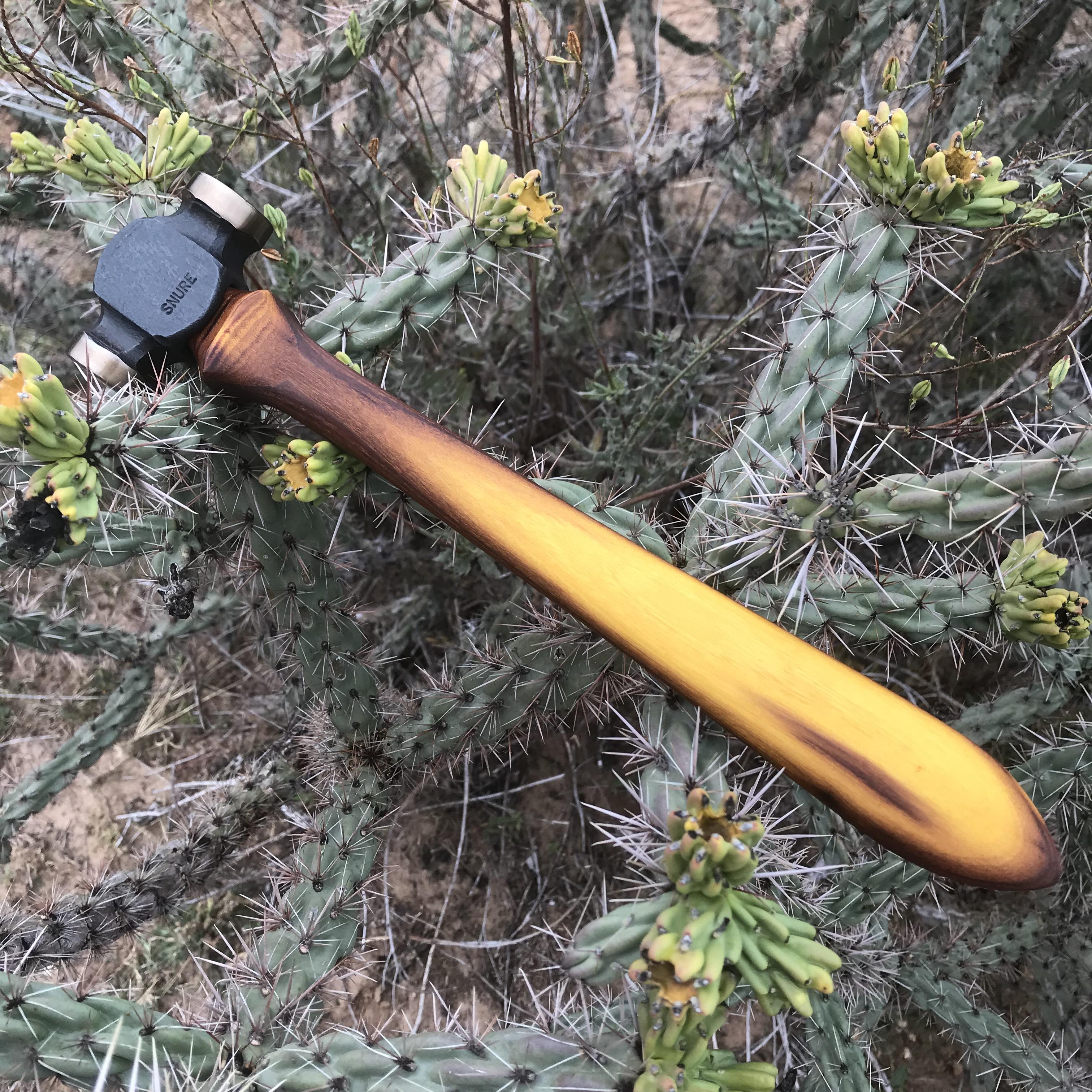

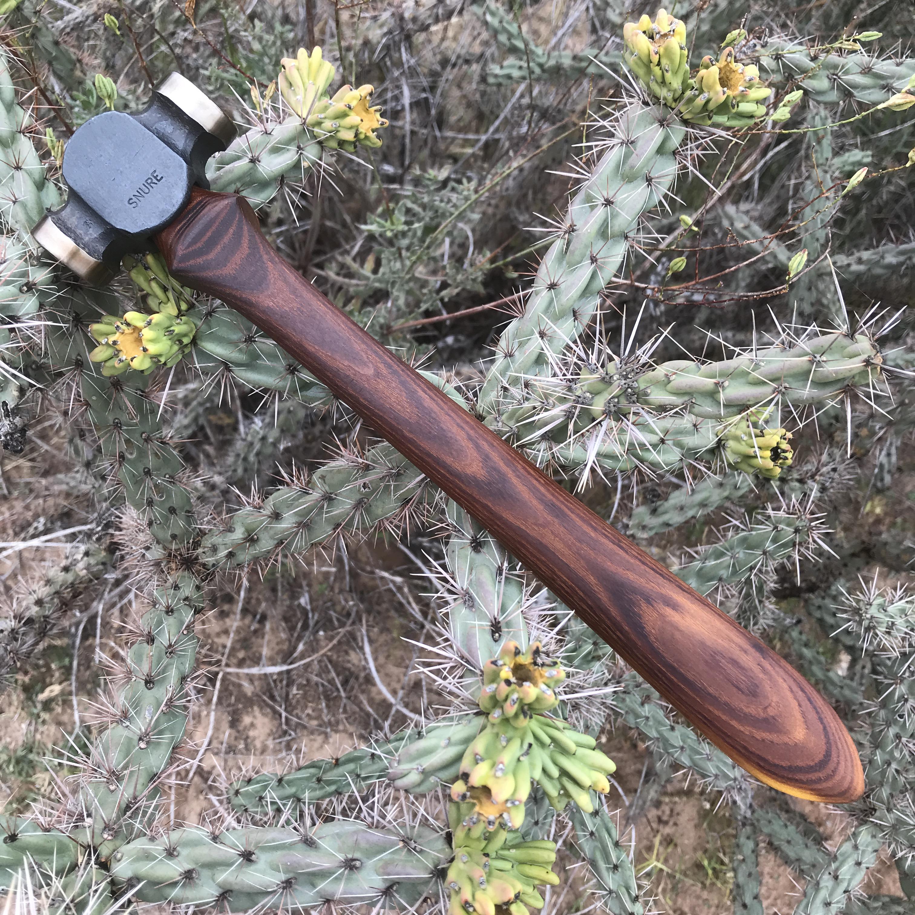

I ran out of time and had to ditch the Damascus hammer for now. I ended up making it out of 4140. I had a really hard time handing this hammer over, I really really liked it. The bois d’ark handle is just so pretty and the grain is really tight. The head is just a hair over 10oz. -

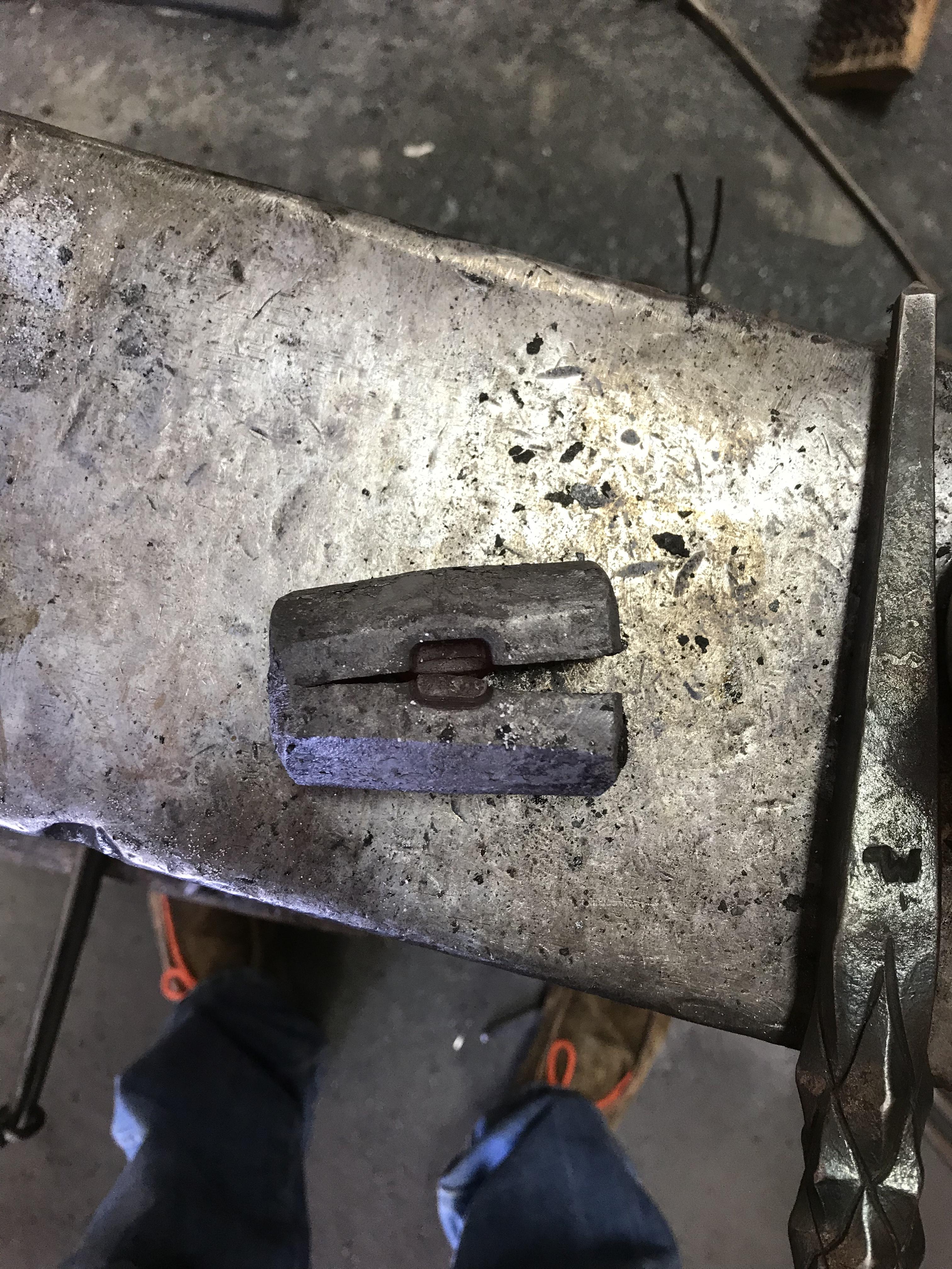

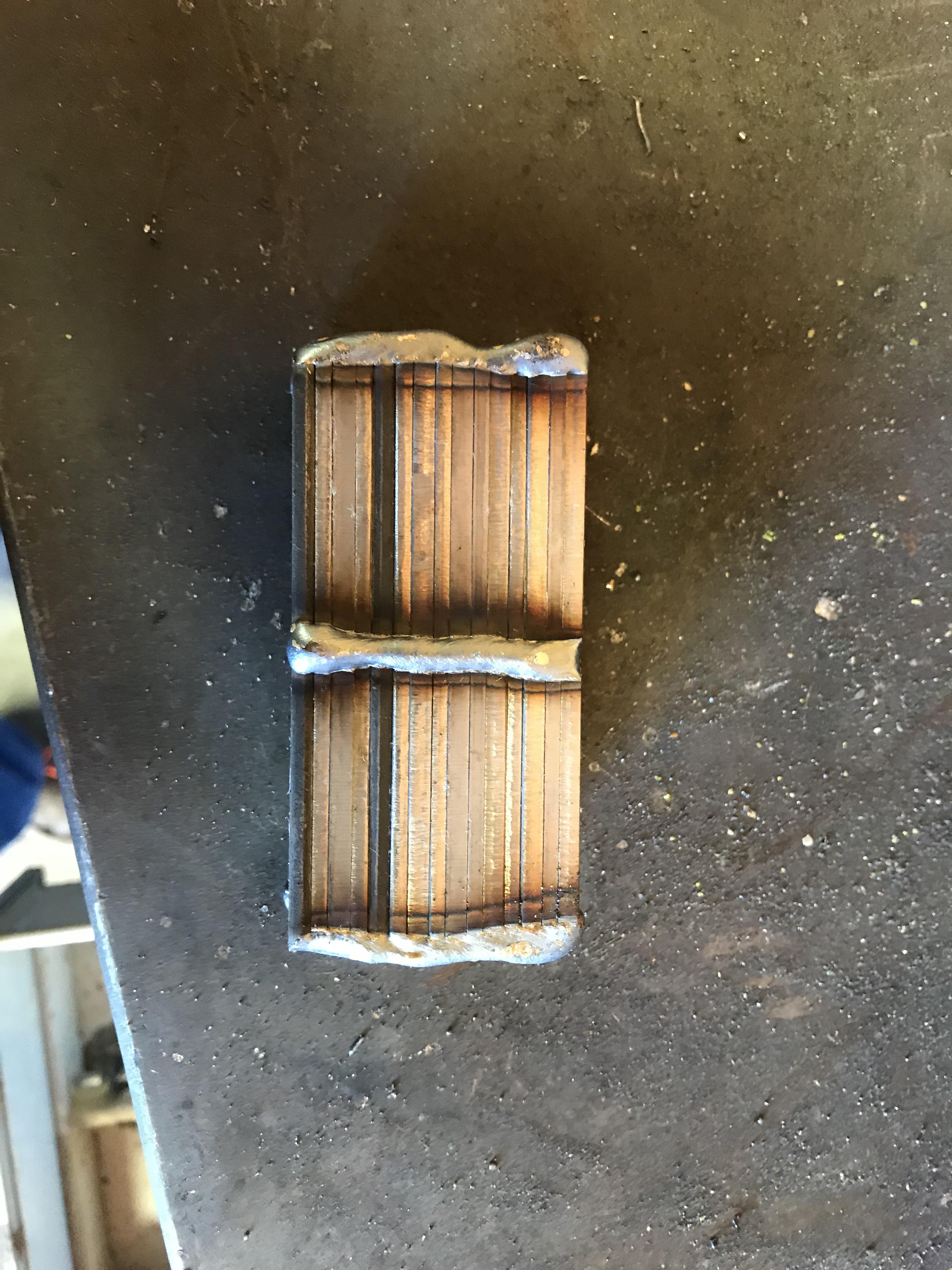

Two failures in a row. The hammer billet with the twists split when punching the eye. Next was a layered billet that split when I was nearly done forging. I’ve learned that there are no shortcuts when fooling with damascus. Once I get done licking my wounds I’ll give it another go. -

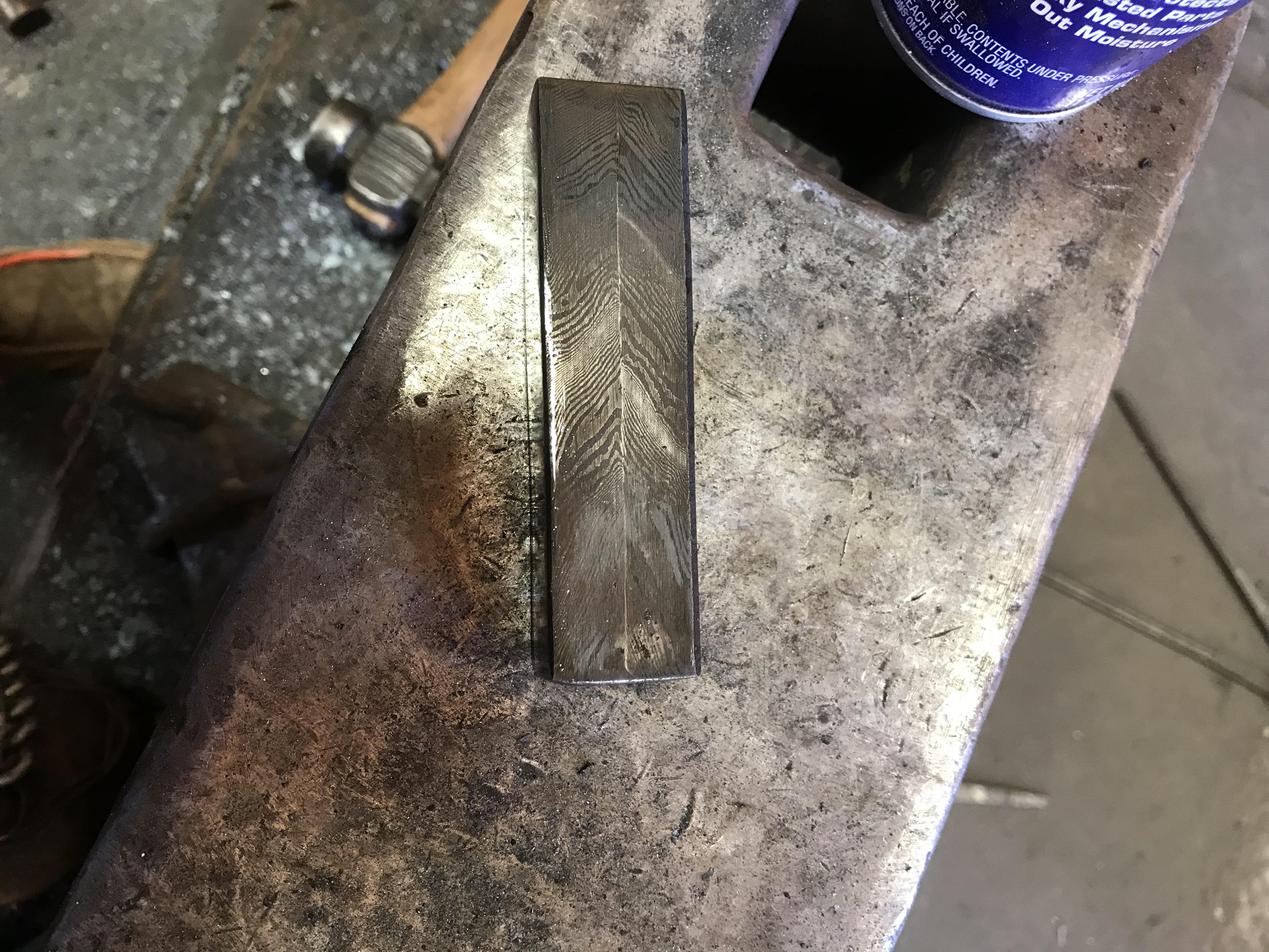

Played with Damascus again today. Hopefully, this will end up being an 10oz rounding hammer with 2 flat faces for a knife maker.
