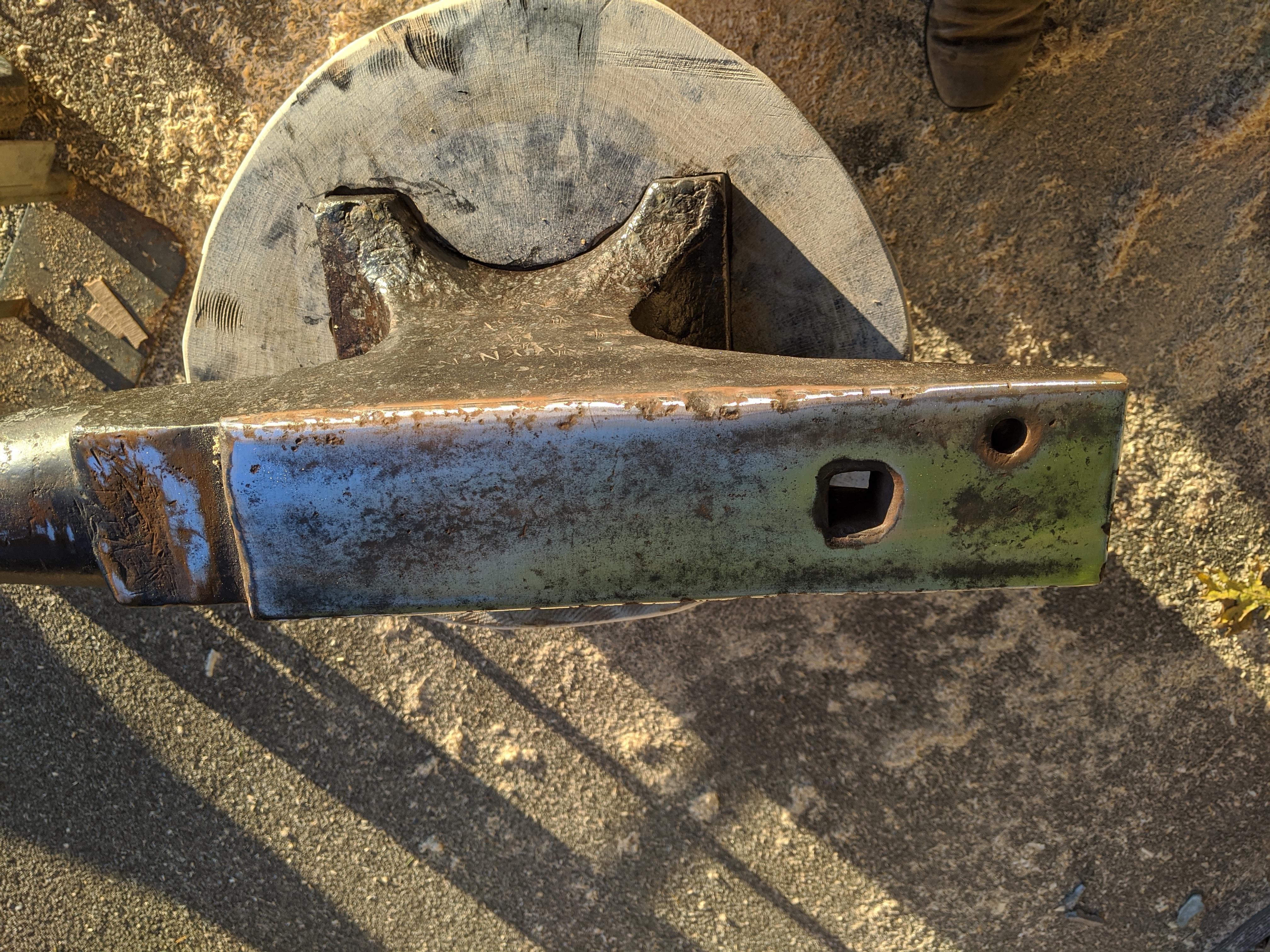

    140-lb pre-1910 Peter Wright. Aged, badly abused, and severely chipped, but no cracks or large chunks broken off. Stand fabbed from scrap angle, strap iron and some fresh 1" square tubing. Two "cutout

On 12/19/2019 at 8:27 PM, Irondragon Forge & Clay said:
Good looking MH you have. I hope you have read about not doing any grinding, milling or welding on the hardened steel face. The small amount of sway is actually a plus for straightening longer stock.
I have not tested it or attempted any type of cleaning or restoring.  I saw where one was for sale on Ebay for $700 and was wondering if that was a creditable value.  I saved this one from being taken to the scrap yard.

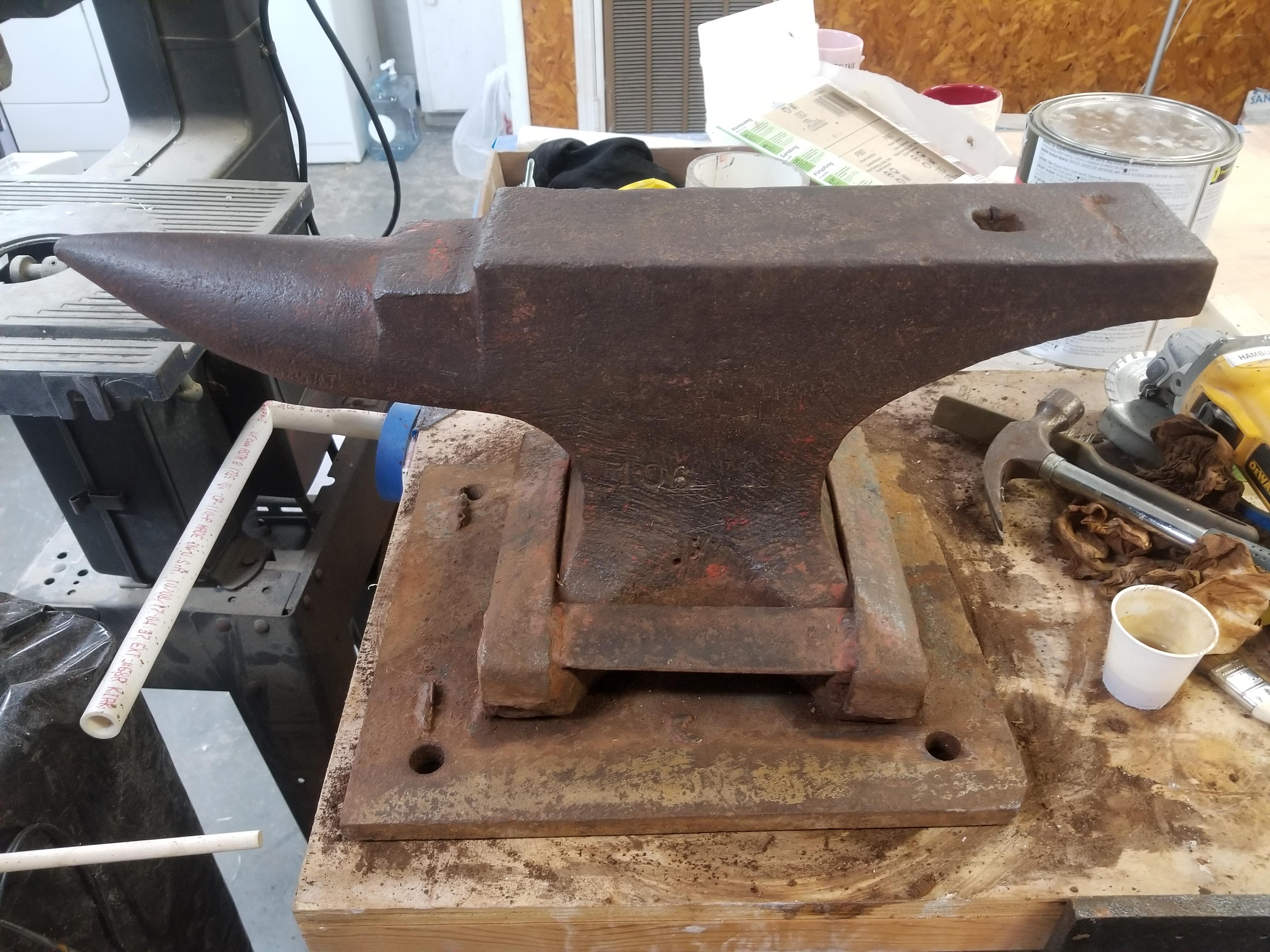

My in-laws got me an antique Hay Budden (I believe that's what it is - markings are very eroded) for Christmas. It's roughly 150lbs. This is my first anvil and I'm going to work with it a while, but it does look like it will need a bit of repair if I'm going to get serious. Any suggestions, thoughts, etc. are welcome. I'm in the process of mounting it to a stand - we just lost an oak tree in a windstorm so I've got a section of trunk that will serve as the stand. So far the only refurbishing I've done is to sand the top with 80 grit belt sander, and hit the bottom with some rustoleum as it's on a fairly green bit of wood.
First of all, welcome to IFI! If you haven’t yet, please READ THIS FIRST!!!
There is NOTHING wrong with that anvil, and it will give you a lifetime of service. Don’t do any more sanding; just let the hot iron and scale polish it up with use.
(Also, you’re probably about to get jumped on for taking abrasives to your anvil’s face. Don’t take it personally. Folks here get passionate about not risking an anvil’s longevity.)
Looks like a perfectly usable anvil as is. Yup, Hay Budden.
Got it. No more sanding! Thanks for the tip and the warning. I've also now read the intro post and some of the links thereof.
The wire wheeling suggestion from Daswulf makes sense, but I think I may leave the rest of the surface with the aged finish unless someone wiser than I suggests it's risky. I imagine the old rust is actually a pretty good protective surface and it looks great, in my opinion.
And, FWIW, I did my first bit of hammering today to make some brackets to secure it to the stump. I'm leaning towards the chain attachment method that Essential Craftsman used in this video, as I have all the bits and pieces:
Sanding in general is bad, as it removes material from an already thin faceplate, so in general, don't do it.
Wire wheeling, is OK for cleanup. I don't get why the braided/knotted wires would cause an issue over normal wires ... I find normal wires to be "floppy" and "softer", but the material removal rate is the same as for braided/knotted wire ...
For mounting; please check this one - especially the video in it, and listen-. 2 identical cast tool steel modern anvils. one secured with straps, one glued down to the stump.
https://www.iforgeiron.com/topic/61423-glue-to-hold-an-anvil-down/
Oak is fine for a stand, just make it absobutely seamless (or fill it with glue :D) and make sure it resonates as "one" object, not as two seperate objects (anvil & stand). This is why bolting it down securely is so helpfull in reducing the noise.
You may want to put the chain on the anvil 90* from that was suggested in the video. With the adjustment under the horn or heel there is less chance of hitting it with your knee or leg.
