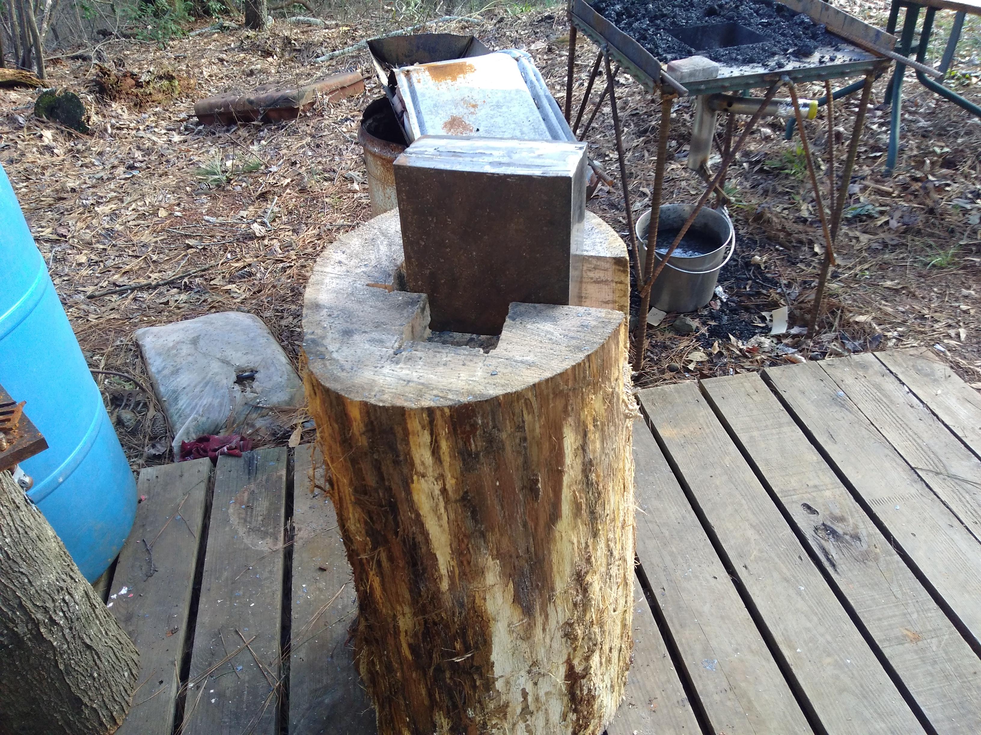

I plan to make a good end to use, as well. That way I can flip it to end or edge.  I don't know what steel it is, but I suspect a low to medium carbon content, (based upon sparks) around 30 or so, but don't know the alloy. It has a slight ring to it, when struck on end.  It's made from the piece that it's sitting on.  I cut two 12" pieces, surfaced the mating surfaces, beveled, and sewed them together with 7014 rod. (what I had on hand)
Blue rooster, that is going to make a nice anvil.

bluerooster, I reckon that anvil will save you some hammer swings. Great project.
