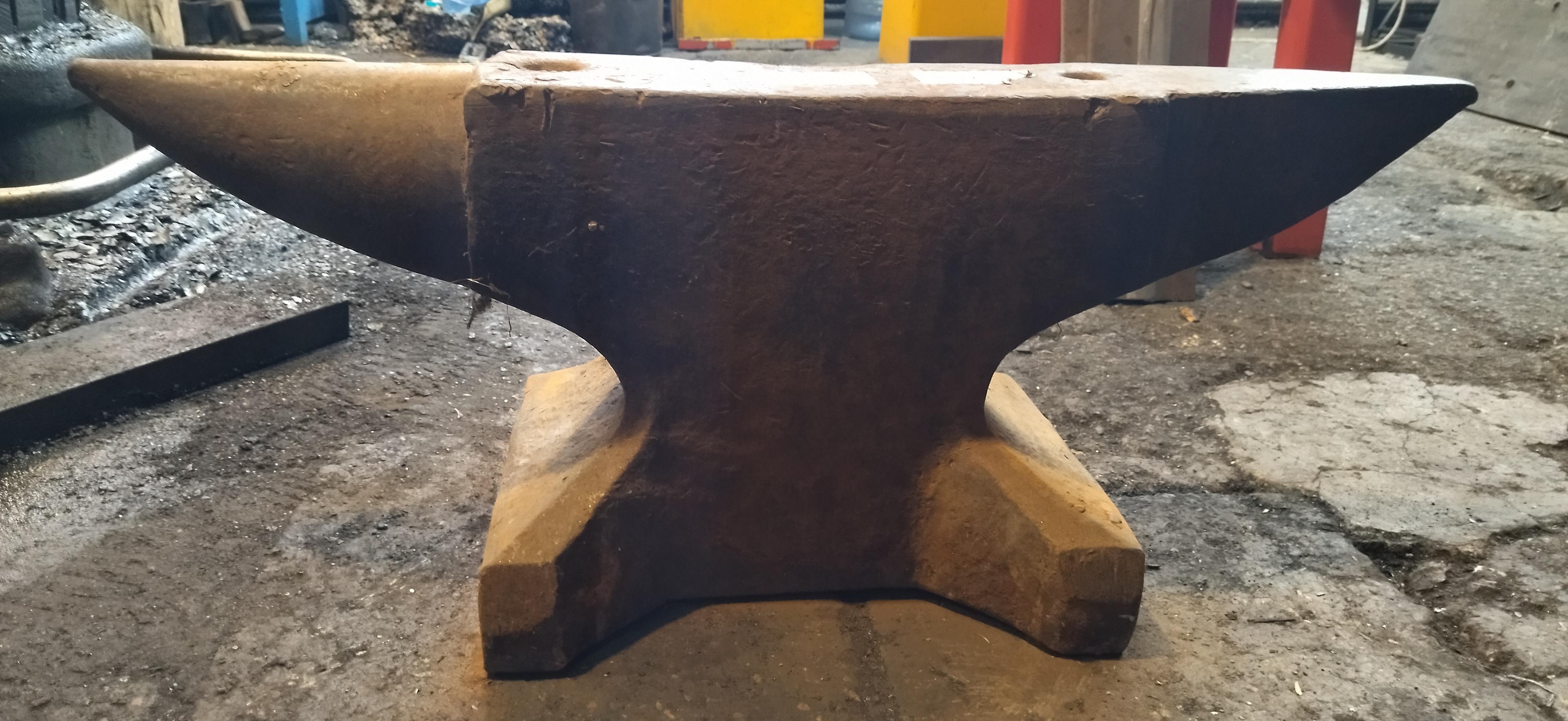

Davor Posted March 25 Share Posted March 25 Well it's not my anvil but I wouldn't want to start a new topic for a potentially a stupid question. I'm on vacation and there is little bar called Old Forge (closed at the moment, it is still out of season), there is an anvil for decoration. I thought that the holes for moving the anvil mean that it is a forged anvil and the absence of the holes that it is cast. Now this anvil has legs that look cast but also has holes. What am I missing? Quote Link to comment Share on other sites More sharing options...
Frosty Posted March 25 Share Posted March 25 Handling holes in anvils were used to grind the face against BIG grinding wheels too. Frosty The Lucky. Quote Link to comment Share on other sites More sharing options...
Davor Posted March 25 Share Posted March 25 And there it is. Thanks Frosty. Now it seems obvious. Quote Link to comment Share on other sites More sharing options...

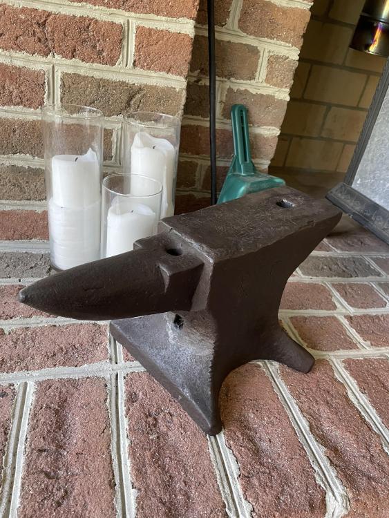

Casteel_Ironworks Posted April 12 Share Posted April 12 Meet Haelga. I got this PW about 3 years ago, found her in flea market outside of Conway, AR called "Rusty Gold Antiques" (they've had others in recent years). She's about 160# once you acount for metal loss and sits on a few spruce 2x6s that were the cutoffs from floor joists of my parents house. If anyone asks yes she has been to the mill for her face was marred and scarred from the abuse she has suffered. She has may holes from likely drill bit testing on her face, but she sings beautiful and works hard nowadays. Quote Link to comment Share on other sites More sharing options...
Frosty Posted April 12 Share Posted April 12 Welcome aboard Caststeel, glad to have you. If you'll put your general location in the header you'll have a much better chance of getting together with members living within visiting distance. Do the drill marks show chatter or are they reasonably smooth? Have you run a sharp file across the face to check for hardness? A drill bit being able to cut an anvil face makes me suspect it's been through a fire and run the temper out of the face. She's a beauty though, looks to be in pretty decent condition. What do you have for a forge, tools, equipment, etc.? What are you planning on making? Frosty The Lucky. Quote Link to comment Share on other sites More sharing options...

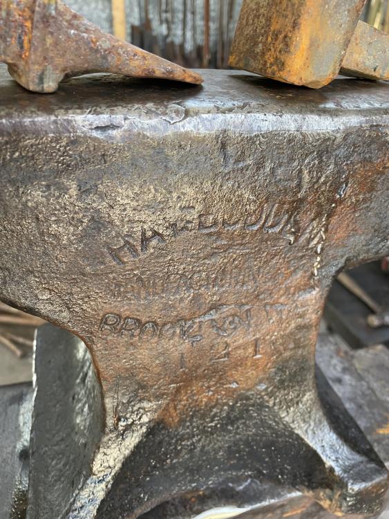

Ridgeway Forge Studio Posted April 14 Share Posted April 14 I thought I would share my 121 lb Hay Budden - Sadly I'm parting with her, I have already more anvils than I need. Quote Link to comment Share on other sites More sharing options...
jlpservicesinc Posted April 14 Share Posted April 14 Hey, in todays market it might be a good move to pass it along. Your journey has been pretty amazing and have done such a great job at setting up your shop.. I still have my first real anvil HB 175lb and have had it nearly 40 yrs.. Quote Link to comment Share on other sites More sharing options...
Ridgeway Forge Studio Posted April 14 Share Posted April 14 Jennifer, I recently picked up a later 180 ish lb Hat Budden with a very rough face- but it’s hardy hole matches the size of most of my hardy tools (they were a gift from a downsizing friend) I will post a picture once I clean up my shop- I recently got into ceramics and haven’t forged since Christmas… my first “real” anvil I moved inside next to the fireplace- 75lb London pattern, pre- 1860s with a retrofitted Pritchel on the cutting table. It’s a beautiful little anvil, the face is almost worn through on the sweet spot. the 121lb I traded a 300ish lb Austrian anvil for- found I didn’t use it that much. I try and cap my anvil limit so I don’t get accused of hoarding! Quote Link to comment Share on other sites More sharing options...
