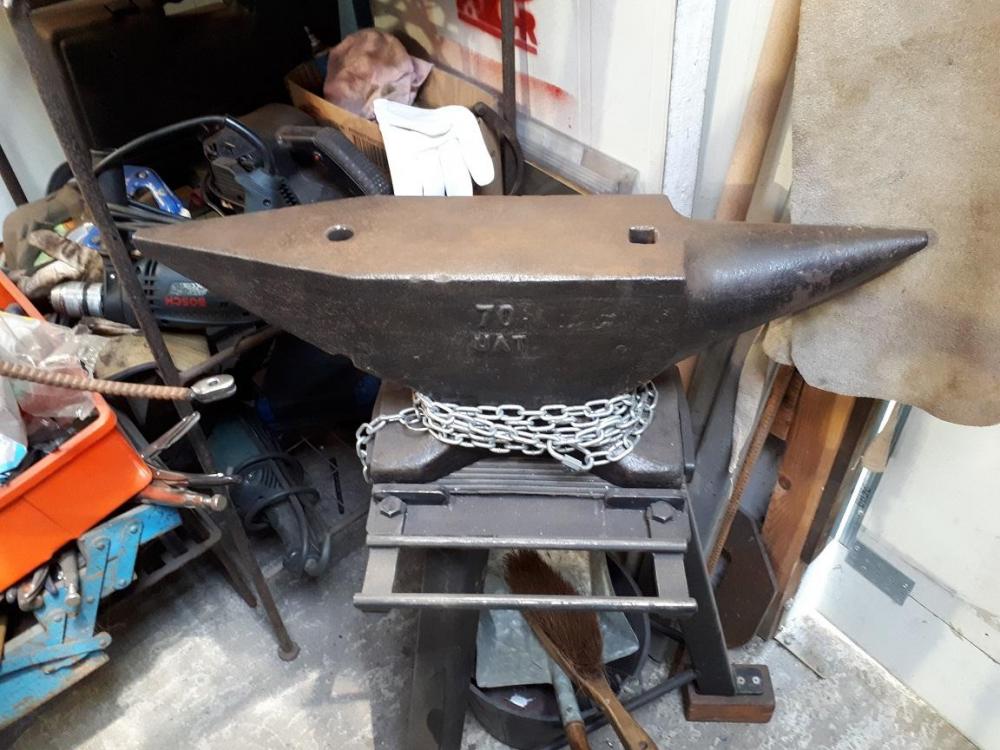

KingAether Posted December 15, 2019 Share Posted December 15, 2019 Took me months to find something local and within my budget but it was worth the wait. #301 John Powell all ready to put in some work Link to comment Share on other sites More sharing options...
Frosty Posted December 15, 2019 Share Posted December 15, 2019 300 lbs. is a nice shop size. Did it come with the stand or did you make it to fit? I assume this isn't it's new home in the shop is it? Close up pics please? Anvil porn is popular here you know. Frosty The Lucky. Link to comment Share on other sites More sharing options...
Irondragon Forge ClayWorks Posted December 15, 2019 Share Posted December 15, 2019 Here's a thread about the Powell anvils. Link to comment Share on other sites More sharing options...
KingAether Posted December 16, 2019 Share Posted December 16, 2019 Irondragon, Thank you for the thread, i did try and find some more info on them as a whole but couldn't find a lot. I could only see that a lot of them are missing the heal so im going to mount a 1" x 12" x 12" plate i have to another stump to use for a hardy. Frosty, It didn't come with the stump, i found one locally for free and chiseled out the anvil shape by hand. Its no longer sat there now, i did try it as i've only 10' x 10' shop space, minus a 7' x 2.5' bench and was getting a lot of condensation due to lack of ventilation but it only took a few days for the weather to tear apart the gazebo so now its back inside all nice and cozy. Got a CO monitor and sorted out the ventilation situation so i'm comfortable working in there now. Ill see what pictures i have and edit them in, lacking that ill get some tomorrow and add to the workshop and vices forums too Link to comment Share on other sites More sharing options...
