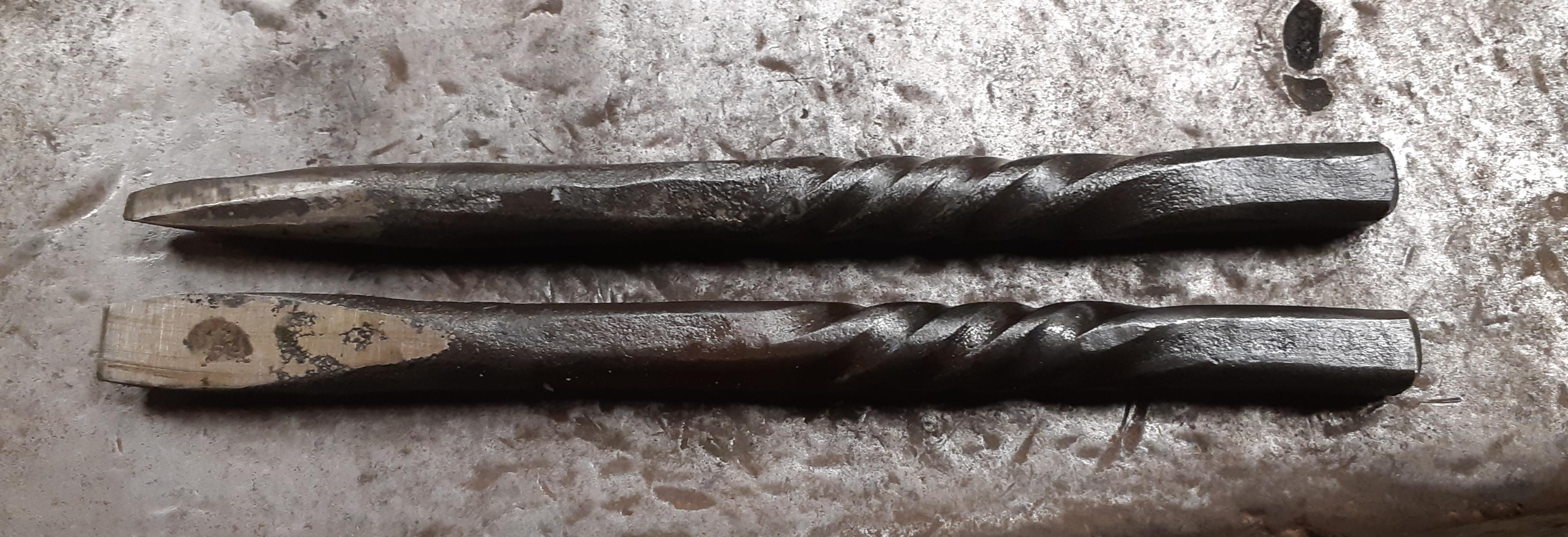

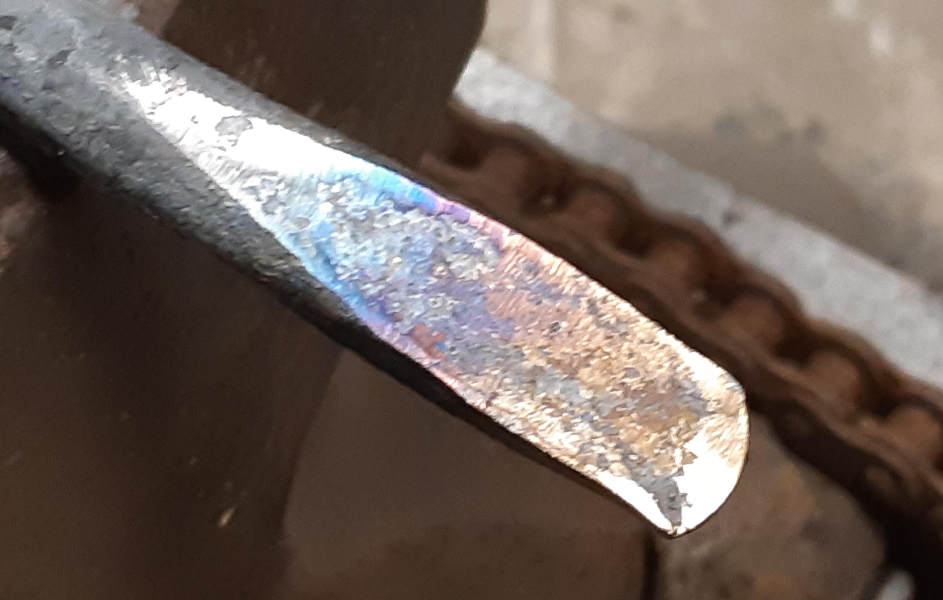

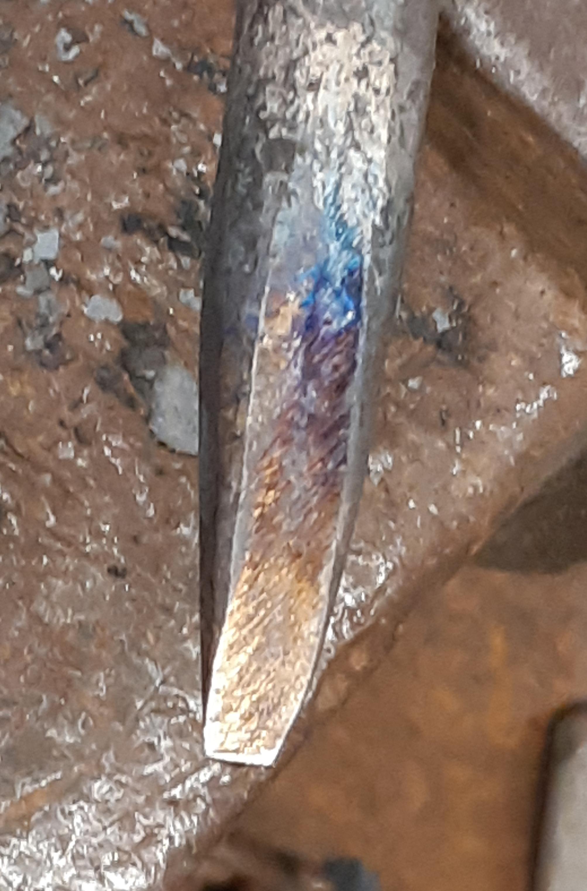

Spent a little time at the forge tonight, finishing a pair of chisel for a touch mark.
Had some nice tempering colors. :D

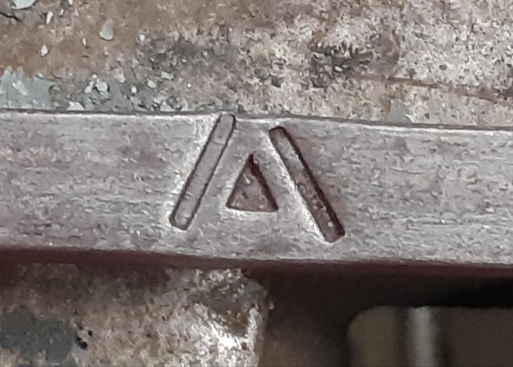

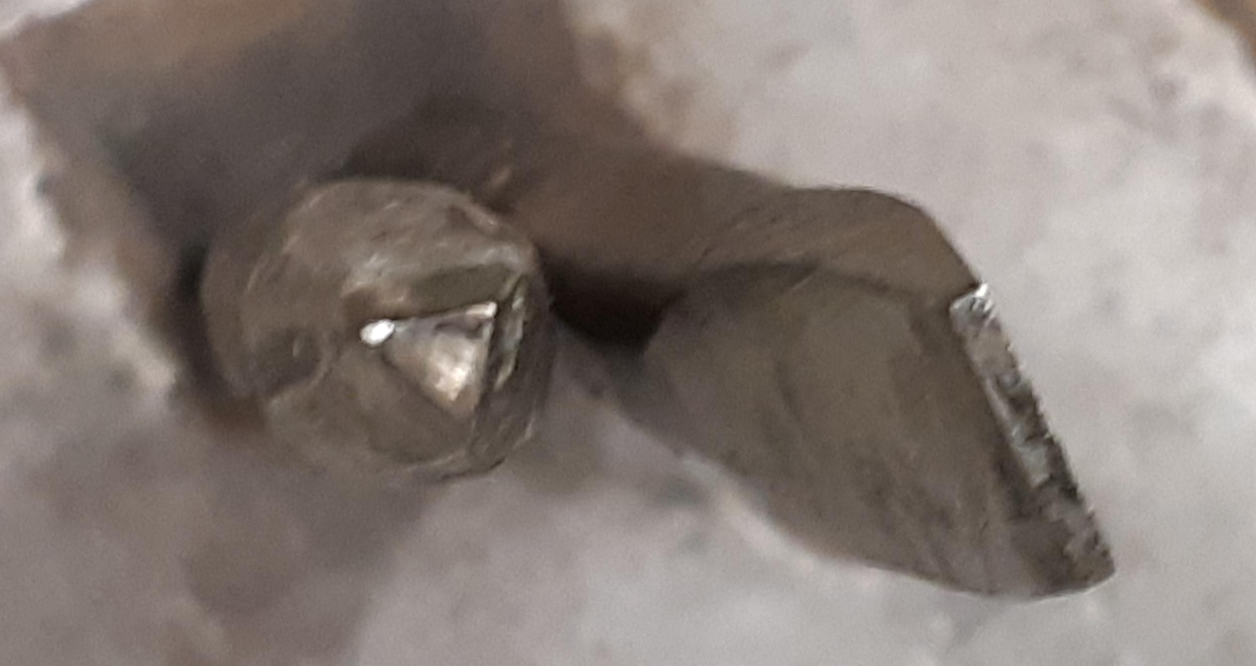

Tested them and the touch mark on a piece of 1/2" square. It is a fairly simple mark, a composite A. The alignment is a bit off, but I should get better with practice.
Then I started practicing forge welding. First attempt was a fail. I think the steel was not quite hot enough, and there may have been a little scale between the pieces - there were sparks shooting from the sides when I tapped them together. Next time I will add a little borax.

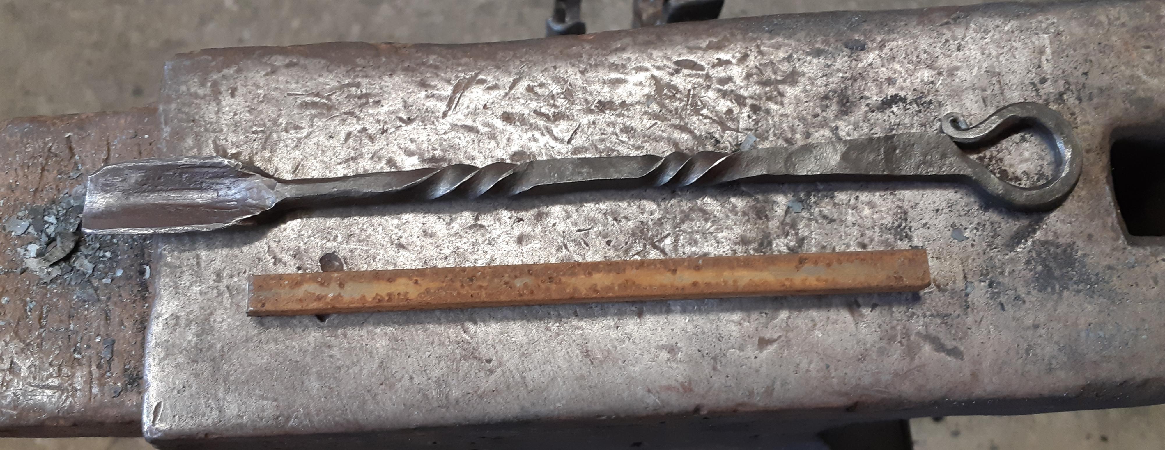

Chopped up some charcoal into smaller pieces for my next attempt at forge welding and made a small flux spoon from an 7" piece of 3/8" square.

Nice flux spoon Arthur, I'd say more but your timing stinks.

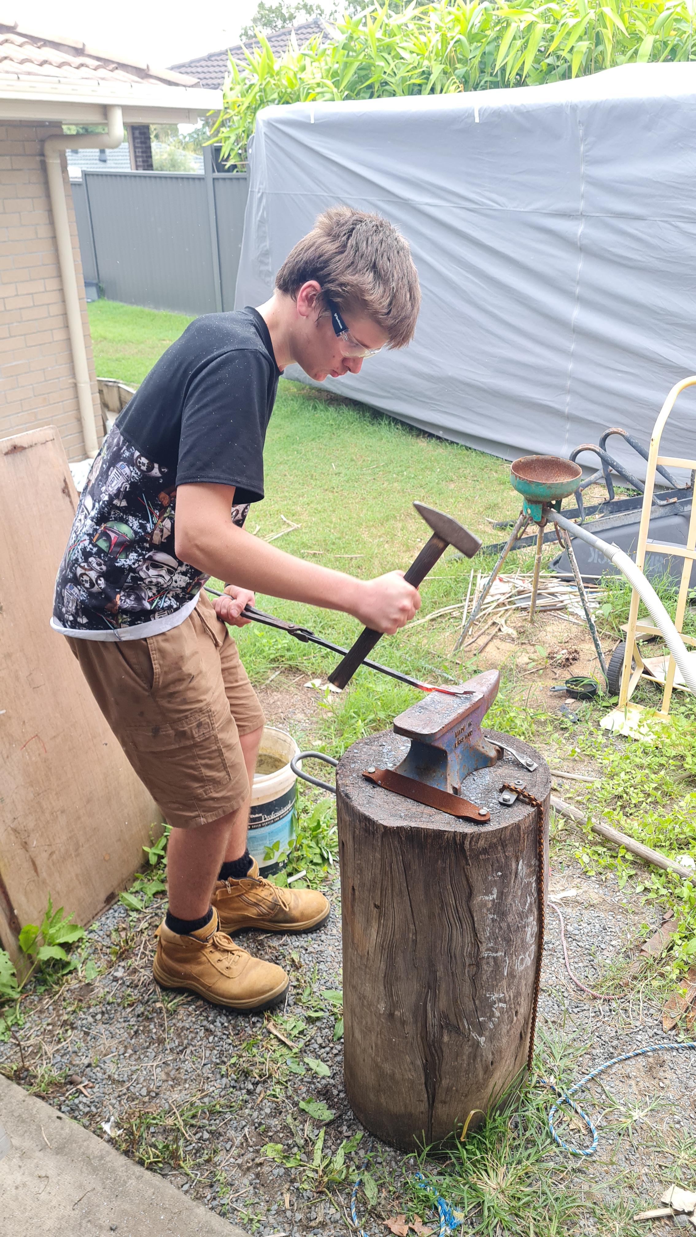

Had a productive day in the shed. My son joined me and worked on a leaf key ring for a bit

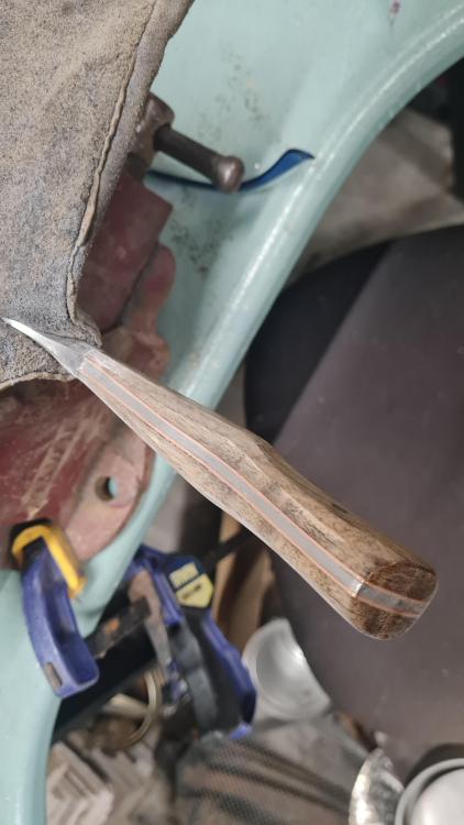

I continued working on a knife for my Head of Department who gave me some coil springs. I'm working on a superglue finish on the handle but I keep sanding through it in certain spots.

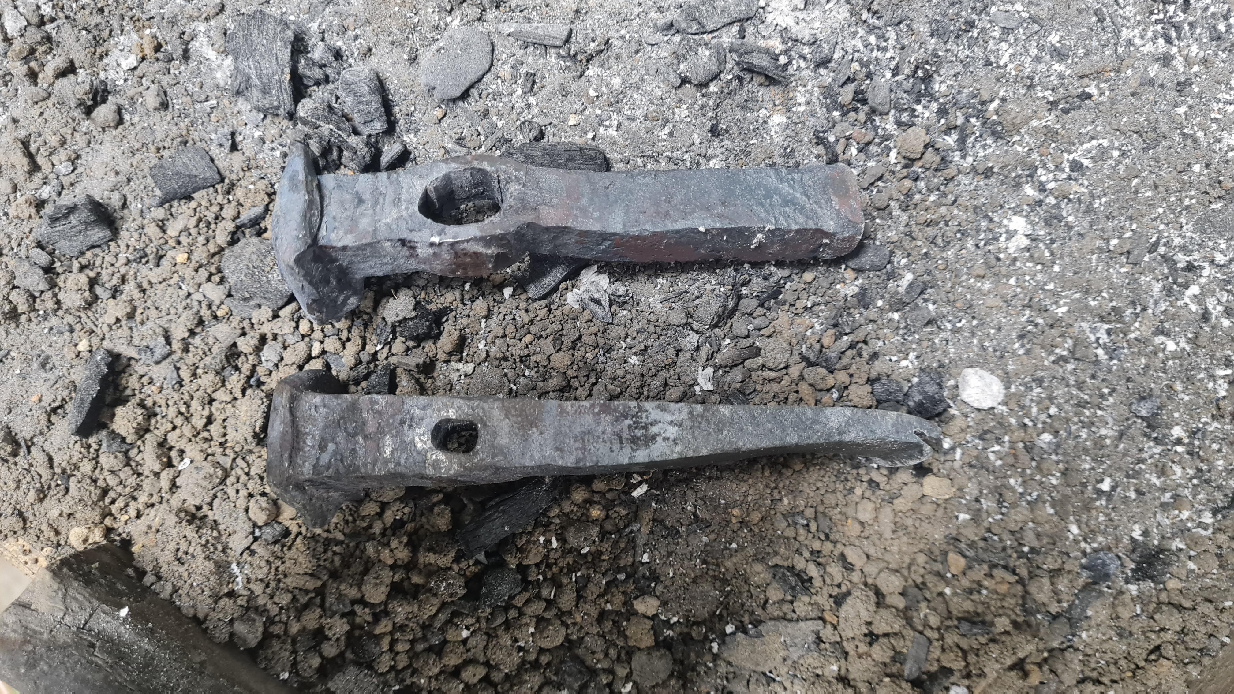

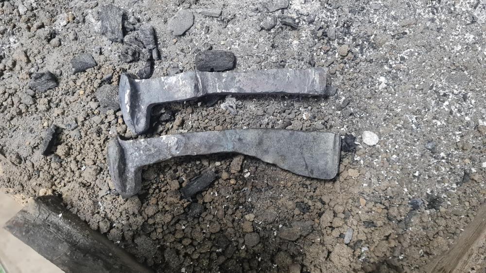

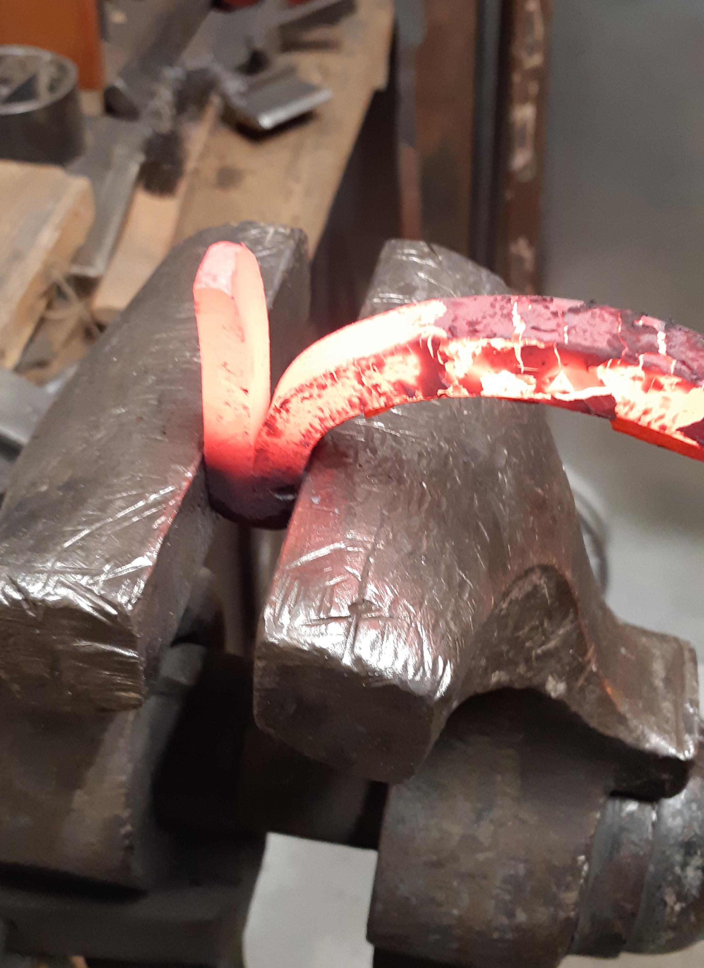

And I kept working on a small RR dog spike hatchet idea.
The spikes appear to be WI. I've got one that I've tried to punch, drift and prep for a steel bit entirely hot at the anvil and vise and one that I've drilled, slit and drifted and I'm trying to upset the end a little before prepping for the steel bit. Both have pros and cons so I'm interested to see how they both turn out. The slit and drift has opened up much more easily.

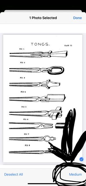

When you select a photo to add it from your phone, you can change the size before it uploads. First, click “Actual Size” in the lower right-hand corner:
This will give you some choices. Select “Medium”:
The selected size will now show instead of “Actual Size”:
Click “Done”, and you’re ready to upload:
If you not select additional photos, they will all upload at the new size:
Click “Add”, and the files will be uploaded when you save your comment.
Be ready to go back and re-order your photos once you’ve saved, though. I’ve seen photos get shuffled in the saving process, and I haven’t yet figured out how to fix that, other than adding them one at a time.

Hefty: Your son needs a higher anvil, one easy indication is the angle between the stock in his hand and the work on the anvil. His grip looks good about waist height but the angle being forged tells the story.
I've never tried a super glue finish on anything though it does last. I've used 2 part resins diluted with the appropriate solvent (Acetone for polyester resin, Tolulene for epoxy resins) for better penetration. The solvents retard curing until the solvent evaporates. This allows it to penetrate more deeply into the wood. I used the technique for applying fiberglass on plywood by pre treating the plywood with a thinned coat of resin. My fiber glassed pieces didn't delaminate.
The real knife guys use heat curing epoxy and a vacuum chamber for 100% penetration to stabilize knife handles.
