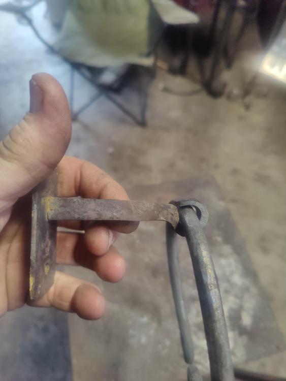

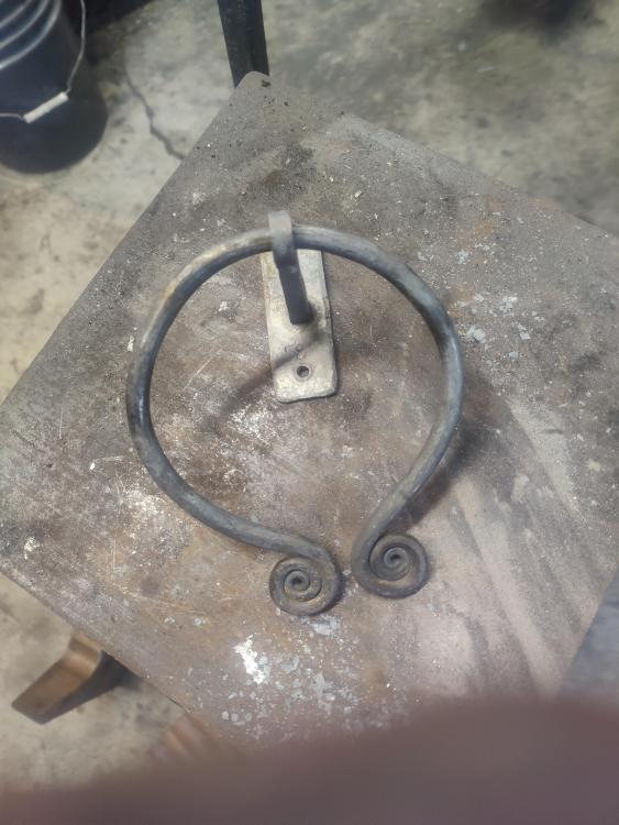

Made this hand towel holder yesterday. Trying to stay with the same motif as the towel bar i made earlier.
3/8" round for the ring, 1/2" square, tapered, for the post, and 1 1/4" x 3" x 1/8" flat for the mounting plate.
The post is tapered some and the end drawn out, upset corner then scrolled around to hold the hoop in place. A 1/4" tenon on the bottom for the mounting.

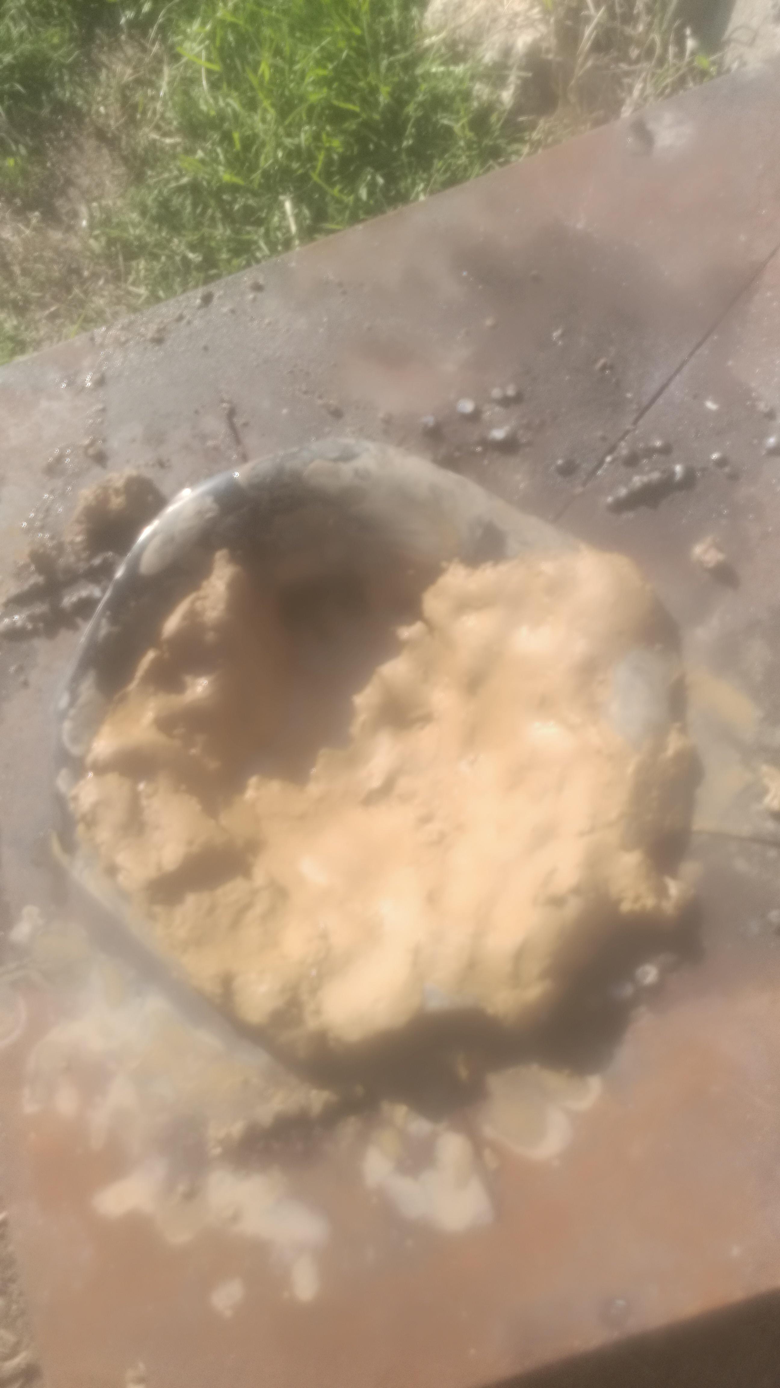

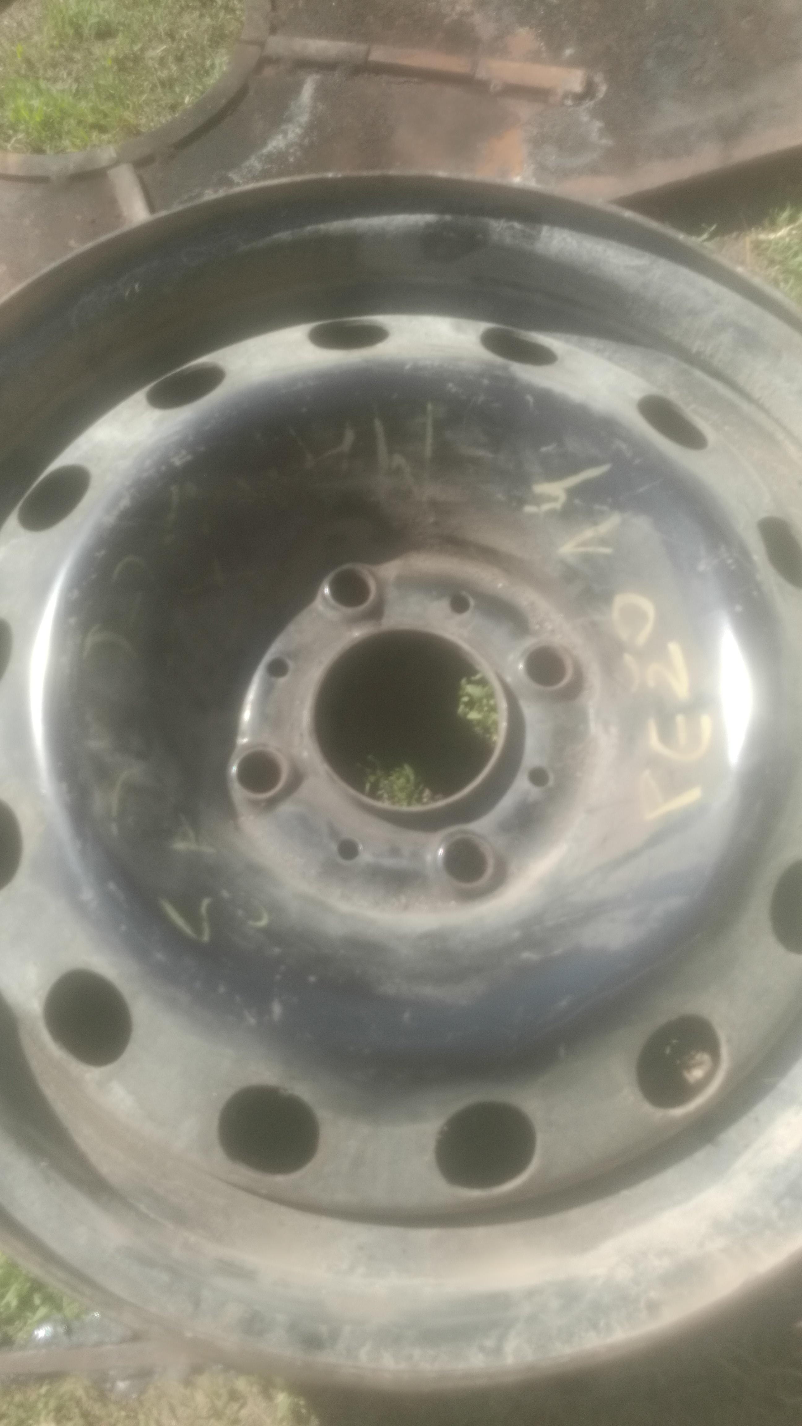

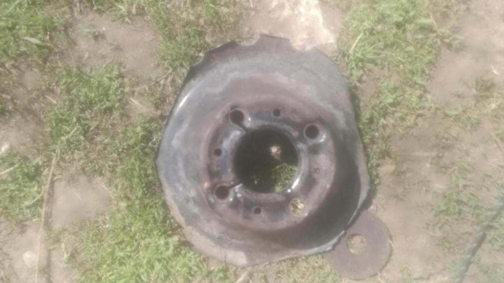

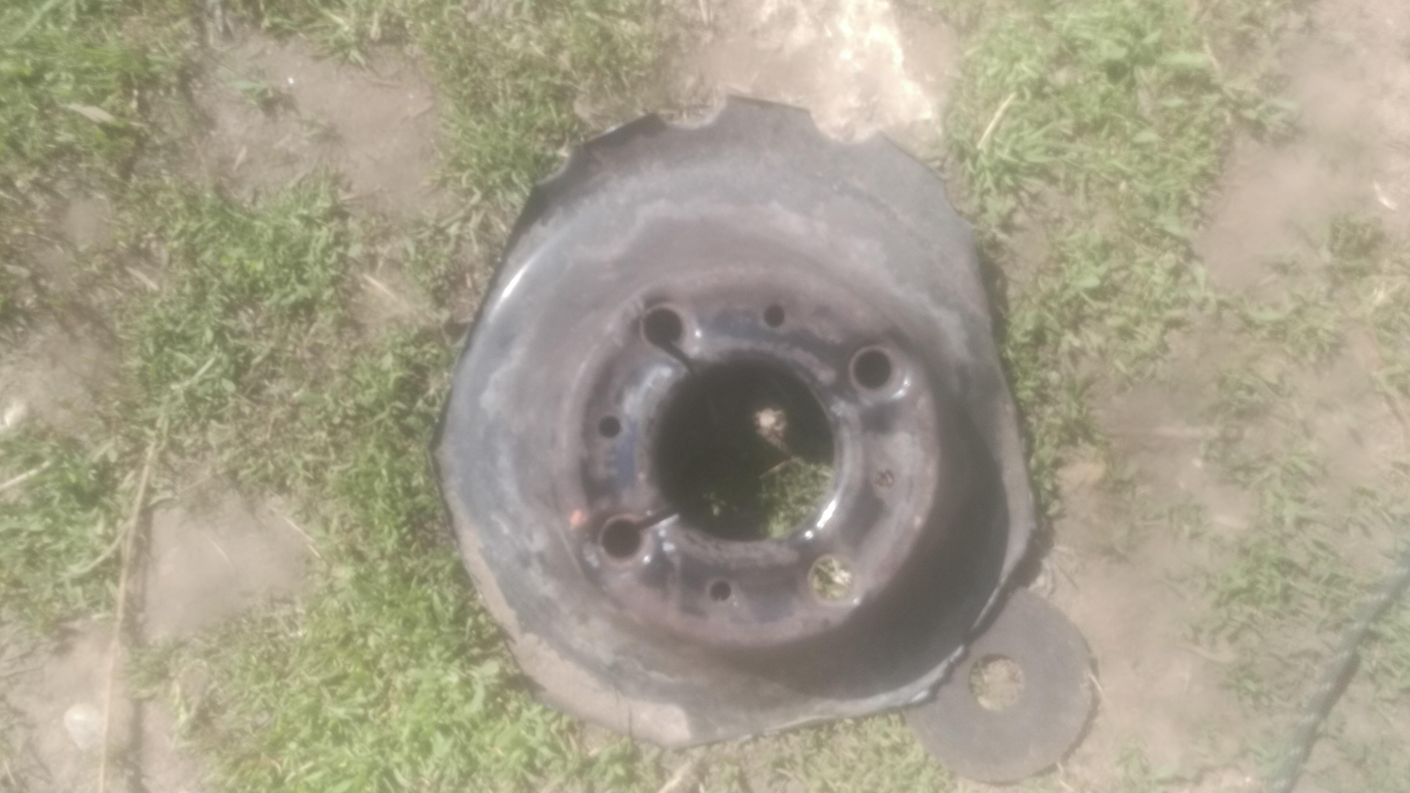

I made new "jabod" ruinig old rim to make it.
I have question for charcoal forge users or coal users , how you heat long pieces, i wanted to heat my tonga project and i couldnt because all fuel was under it i cant dip it in fuel.
There is top plate in wich this rim fit in.
You need cutouts on the sides as a pass through for stock to get into the sweet spot of the fire.

IF i did that my embers will go away to that cutout.

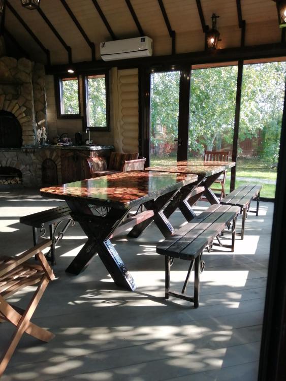

22 hours ago, LeeJustice said:
How does the resin hold up to wear and tear?  Scratches, scrapes, etc.,  Must one treat it with great care?  (Everyone should treat their things with care)
The resin is strong enough. But I usually use flexible "glass" The resin is easy to grind.
This is one reason we don't recommend using a wheel rim for a fire pot, they're too large and it's too hard to access the hot spot with long stock. Disk brake rotors make much better fire pots as they're not so deep and are easy to adjust with a little packed clay. A steel topped table with an angle iron rim and a hole to set the brake rotor in makes a really nice forge. You can store coal or charcoal on the table top and rake more in as needed. The stock can lay on the table and be well in the fire if you need it deeper just prop up the outside end.

WEll i cout it out so it is not that large.
 Maybe deep only 3 -4 inches but i feel like iam wasting fuel.
That can be overcome by cuting slot higher and puting pipe ther.
I used sheet metal since i could weld  good floor for it.
I placed sheet metal and i put clay over it
Well i will play along it.
Fuel just need to be gathered at one place, i need bowl for that, i noticed smaller pieces dotn fly off and its better that way.
