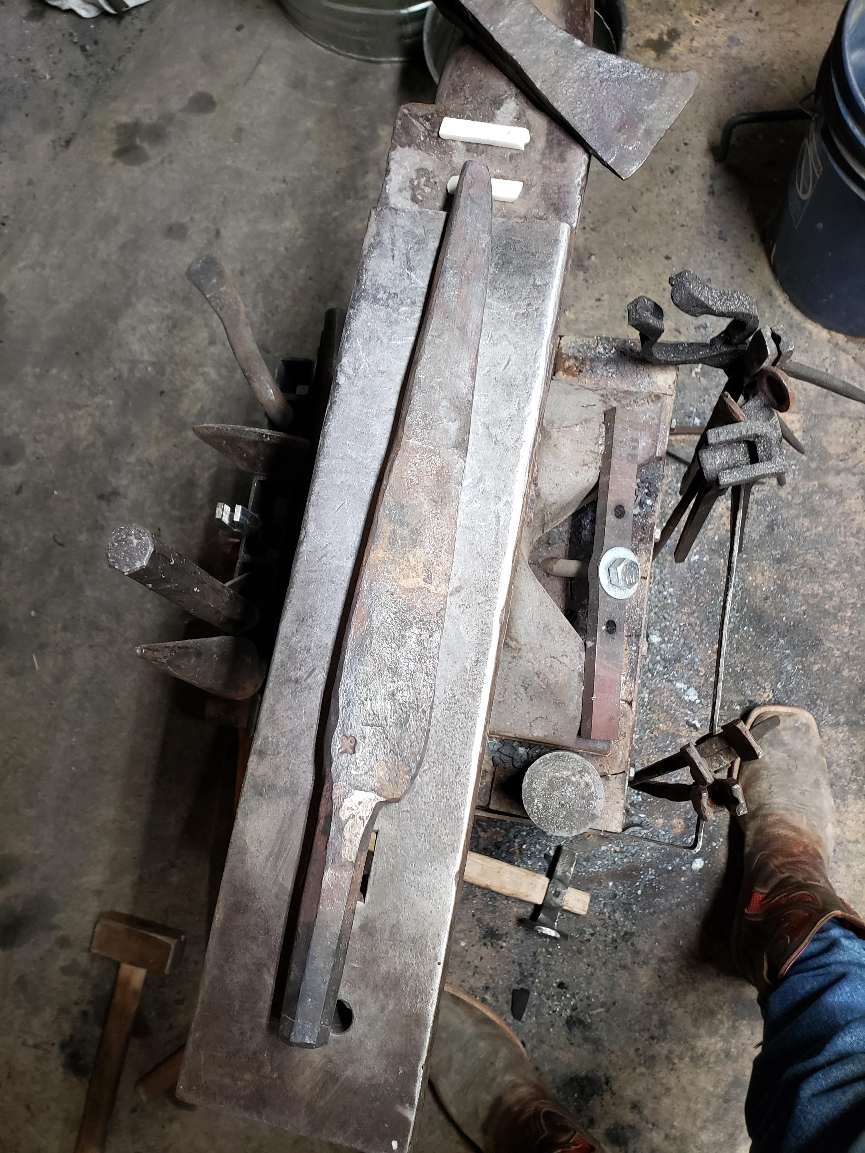

I'm in the middle of a knife build off between some friends. We all will forge a 5" blade and then torture test them. We also are forging a gift to give to the winner. We have throigh the month of July to forge our blades and gifts. We will have the torture test in August and the winner will choose the next forging challenge to make. I finished my knife and started on my gift. It will be a little camp ax out of some trailer axel. After 2 laid back nights of forging, I have it to the annealing stage. The knife is made from 8670 btw. My first time forging and heat treating that alloy, but I must say I'm really impressed with it so far. The test to failure in August will tell.... -

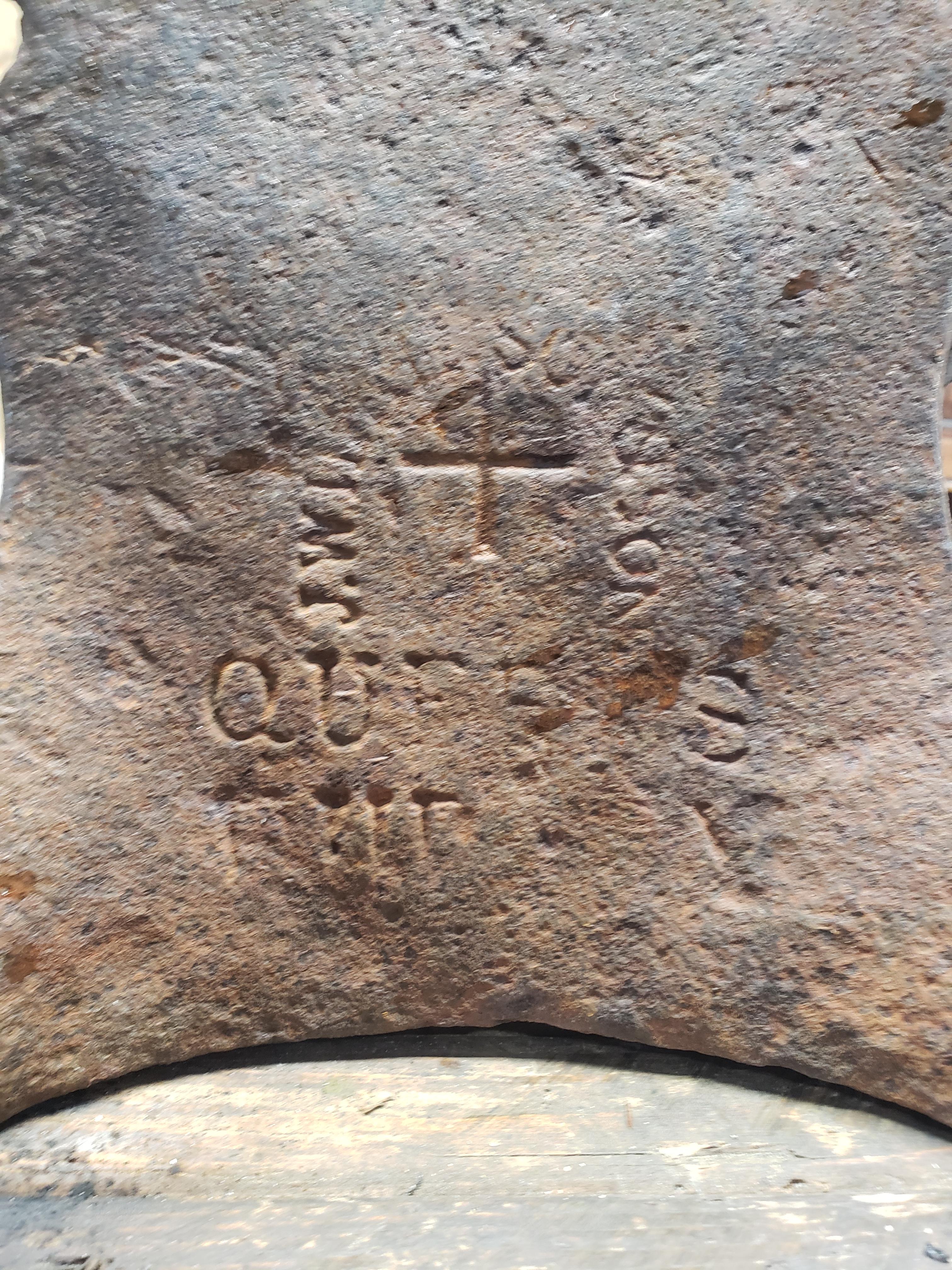

ChiefLittleBair replied to ChiefLittleBair's topic in Anvils, Swage Blocks, and Mandrels
I know its completely usable as is. I already have several other anvils i use on the regular though. Bought this one for a fun project. It would definitely be germish lol. My main question was on the variation of the cross since I can't find any pics of a j wilkinson with this style of cross. -
Hello all, I picked this up for a song while I was visiting a friend in North Carolina. I was wondering if anyone had seen the cross on a J Wilkinson like this instead of the classic "hot dogs"? The stamp around the cross looks to say "J WILKINSON & SON" and underneath is the remnants of "QUEENS DUDLEY". The only other markings are the hundred weight on the other side, 0 3 7. No stampings i can see on the feet under the horn or where the heel used to live. My original thought for buying it was to use as a striking anvil, but I'm toying with the idea of standing some 3/4 inch plate on edge and rebuilding the heel in a German square horn pattern. Maybe add a cute little upsetting block? I could also add a section of round stock to the far edge of the face like some German anvils have to aid in drawing out? Just playing with ideas. Rebound is probably 85% or so, and it rings nicely. I think a little 100lb German/English anvil would be fun, and im not out too much money if it fails. I'd give it the typical preheat and post heat, but honestly probably just weld with 7018. Not doing any welding on the sweet spot of the face where heavy hammering would be done, and what I'd be welding on shouldn't ever see much heavy work. Thoughts on my crazy and evil intentions? And back to my original question, has anyone seen this style cross on a Wilkinson? Thanks, Keith
