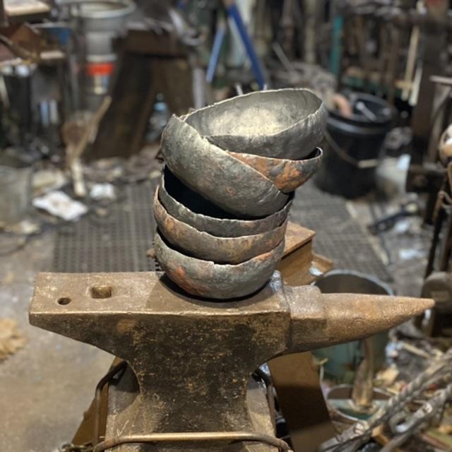

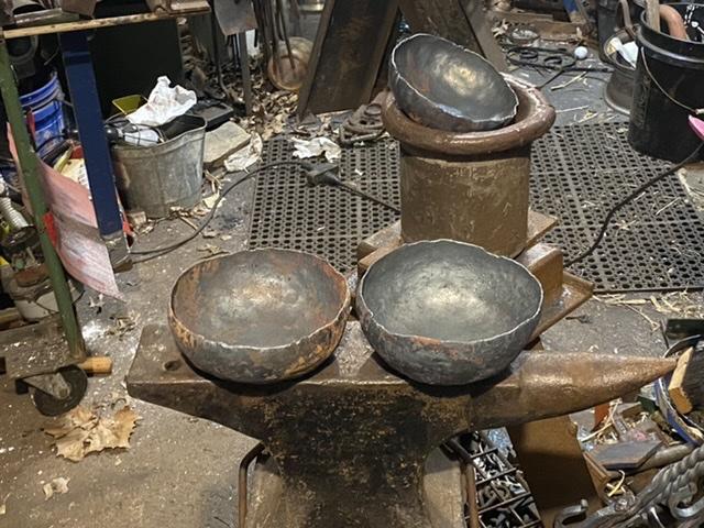

Some bowl work:

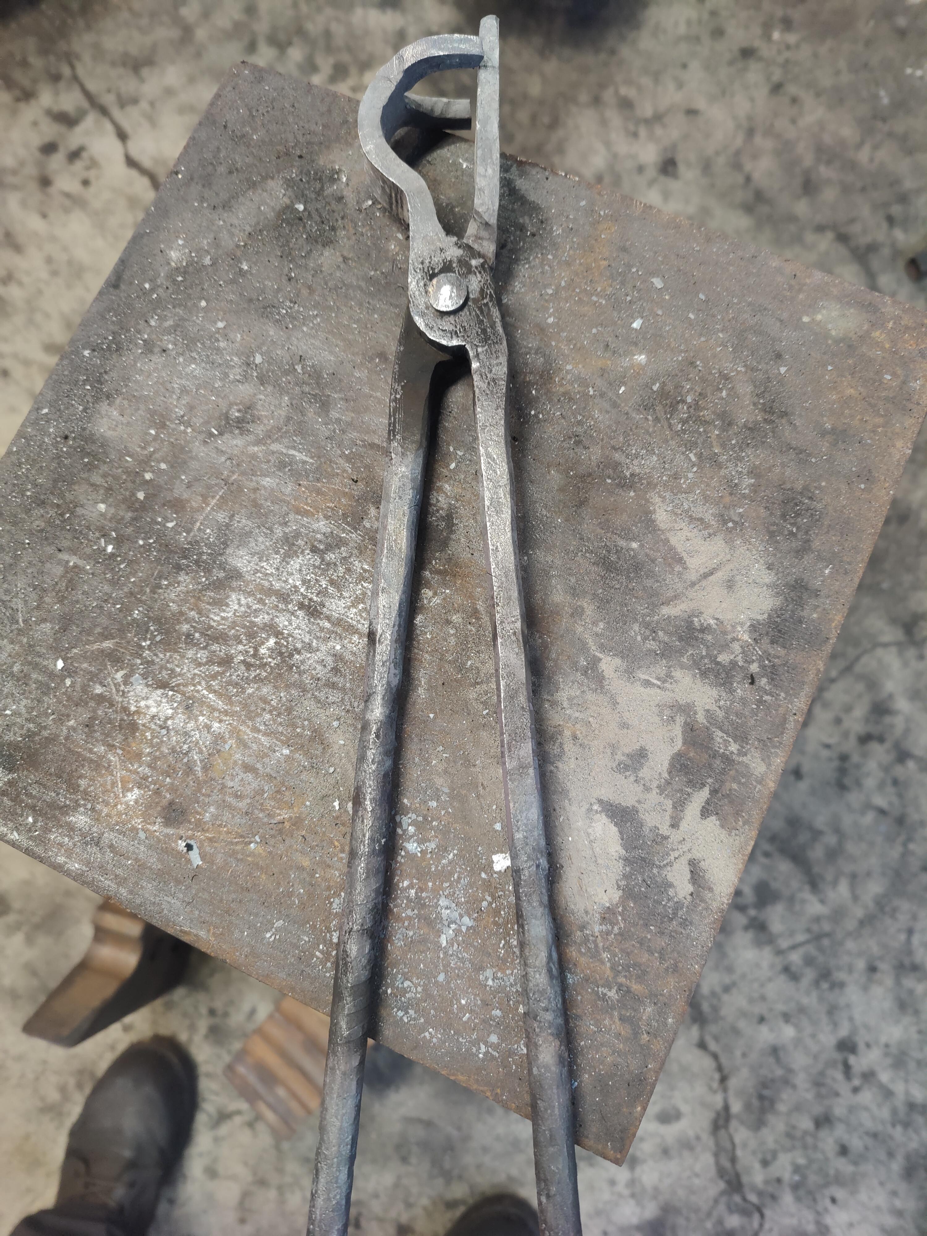

It was need a tool, make a tool day. Need some tongs to do stuff like hold hinges from the eye end or over finials. I was thinking the forked end would make them useful for different widths and hold nice and tight, and they do hold nice and tight on stuff. Made from 1 1/4" x 1/2" flat bar with 1/2" re-bar reigns welded on. I am finding that i do not like working with re-bar.

9 hours ago, JHCC said:
Some bowl work:

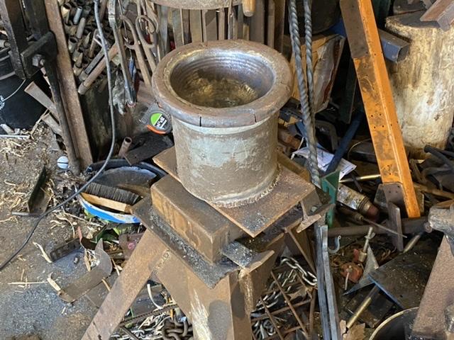

JHCC, what’s that thing the third bowl is setting on?
BillyBones, those look really handy, I saw a pair of similar tongs for holding flat bar awhile back

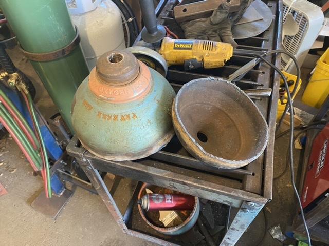

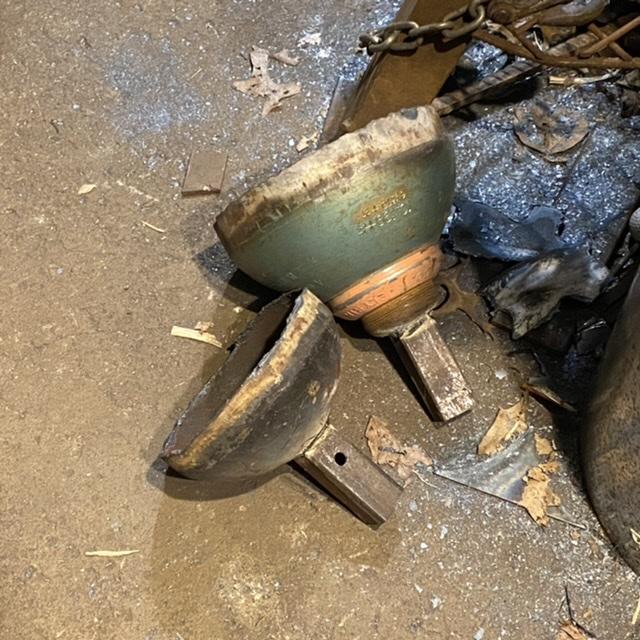

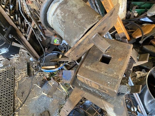

One of my bowl swages. This one is made from the top end of a scuba tank and is designed to fit in the hardy hole of my striking anvil.
I’m working on some others at the moment, from the ends of a couple of different sizes of welding tank.
Unlike with the first one, I’m going to leave the valve holes of these unplugged, as I’ve discovered that closing the hole leads to scale building up inside over time.
Some scraps of 3/4” round, forged to shape, welded on, and ground smooth. On the next one, I’m going to try heating the edge in sections with the torch and rolling them over like a large bead. I don’t really need the mass on the edge, but I didn’t have the torch when I made this one.
Thanks for sharing the pictures!
I haven’t tried making any bowls yet but Your work is kinda motivating me to give it a shot!

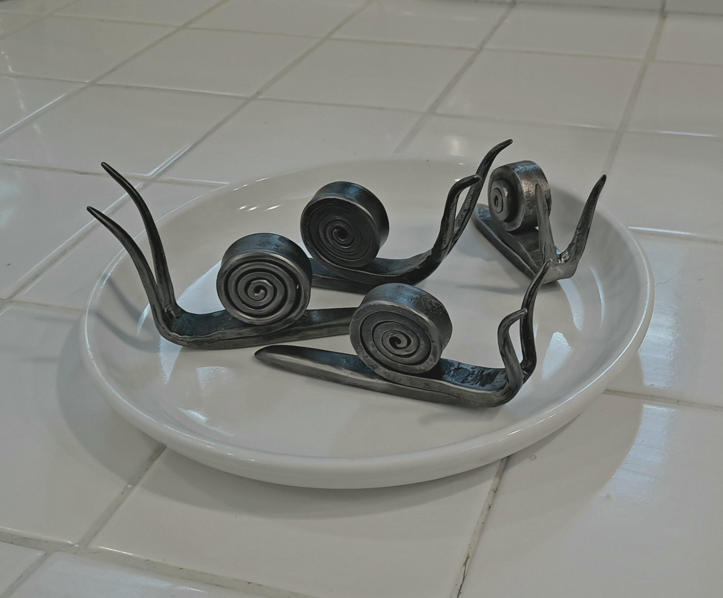

It occurs to me that if “escargot“ were Hebrew, it would be the plural of “escargah”.
Struggling with the inconsistent material and ridges gets old pretty quick.  It has its uses.
Ted, great snails!

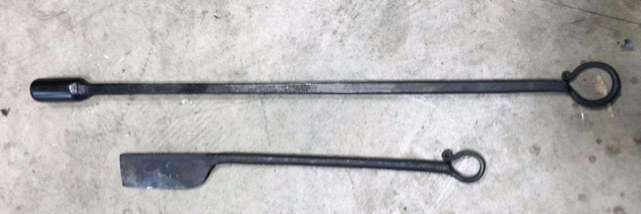

Today was the first forging session with my new power hammer. What better than to start tooling up?
Started with a hack from a piece of railroad clip. Hack was used to cut a section of 2” dia med carbon rod to make a flatter (not show, annealing overnight). Finally moved to a fuller. Good day in the forge and I’m getting a good feel for the hammer.
Good thing Ted made four of them!
Nice snails Ted, I thinking a darned marketable product. Do you sell many?

Thanks Frosty. A couple of those will go to the grandkids, the others I'll sprinkle around the house.
I've only sold one thing I made because it was a request from my boss. Even then, I only charged him because I didn't like his attitude. Otherwise. I much prefer giving stuff away.

 In my own shop, I roughed forged a few more bowls; I’ll do the finishing later. Probably would have gone a lot faster if the handle on my dishing hammer hadn’t snapped….
Also welded the stems into a couple more welding tank tops, for a couple more sizes of dishing form.

I just calls em like I sees em Ted. Those are really attractive and should sell well at almost any scale.
I'm not trying to talk you into anything but one of the highest forms of praise for one's work is people willing to give you money for it.
