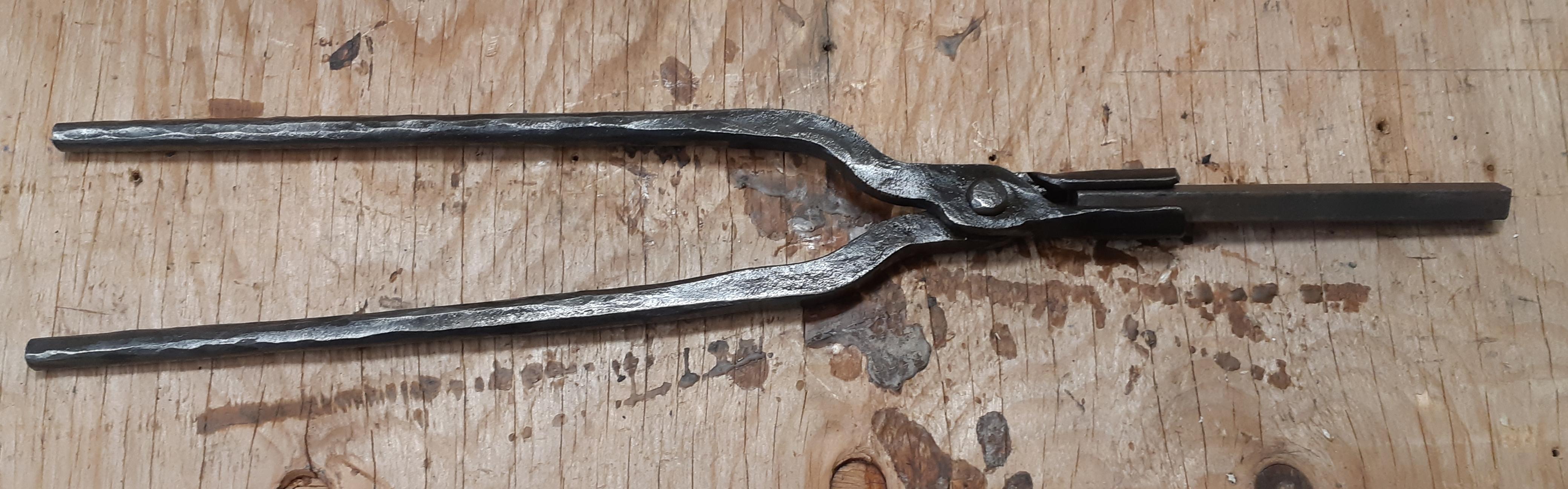

Finished my tongs tonight. I didn't like the way the reins angled, so I curved them a little so that they would be parallel to each other when grabbing stock (next time I will do that before rivetting them). Adjusted them for 3/8" bars. Wire brushed then coated in beeswax.
  • Replies 30.4k
  • Views 2.9m
Yeah, your top tool handles should be a LITTLE tighter than that D.
Nice looking tongs Arthur. I don't know about bending them to lay parallel when closed, I've never tried a pair like that. I might have to do a little bending on a pair and see.

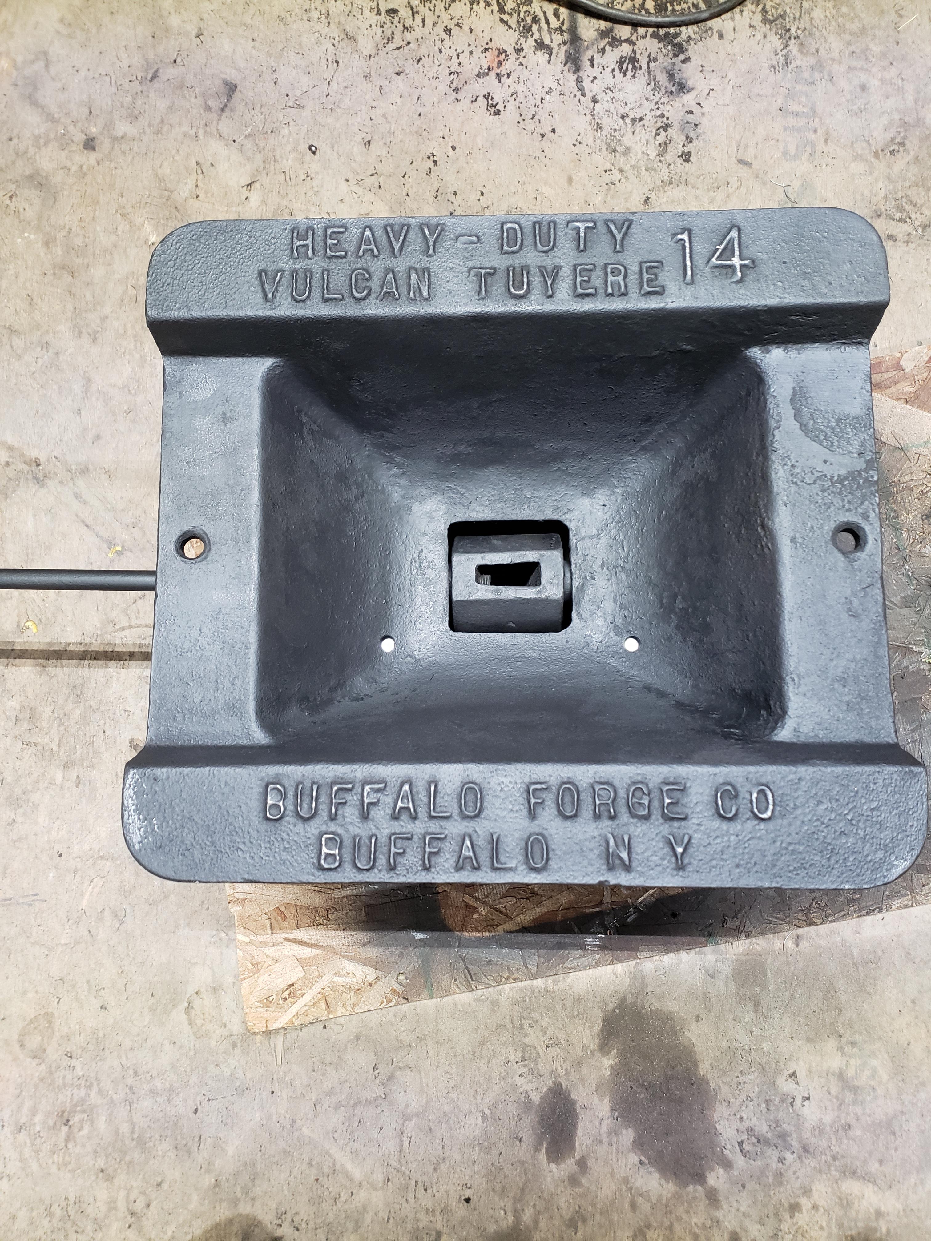

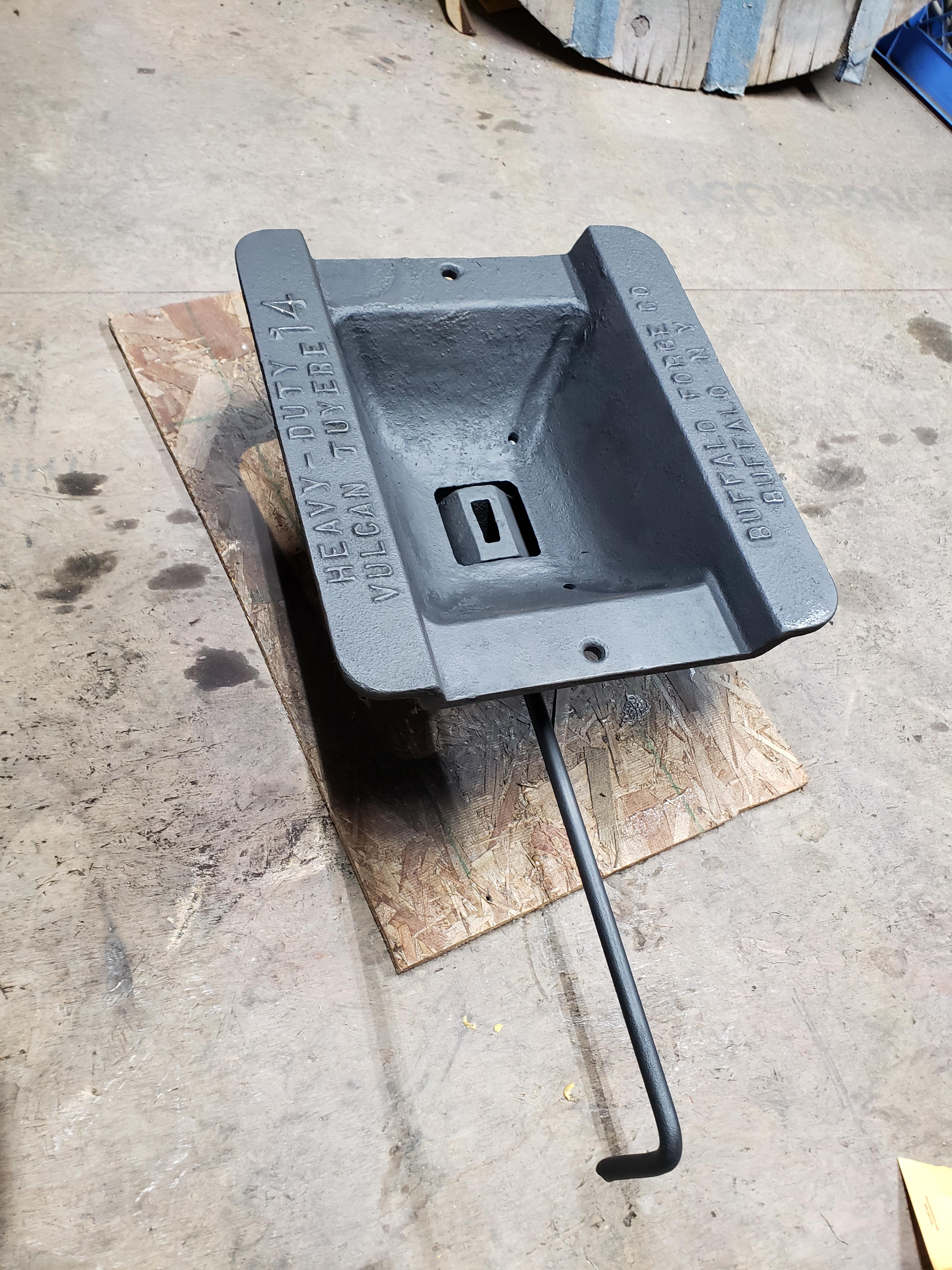

Worked on refinishing the fire pot i got in a bundle with a buffalo 300 blower. Next up I just need to refinish the blower then build a more permanent forge in the shed to replace my rivet forge I've been using. REALLY looking forward to the increased air flow and work space with a more permanent forge and bigger blower20220316_220729.thumb.jpg.0972adec15c09c21f8d6fff2f3047d80.jpg20220316_220757.thumb.jpg.b4a446449afa25999bd45b53d692efc2.jpg20220316_220741.thumb.jpg.80574d9132cdbee4f4441c7cdd4a2ab8.jpg

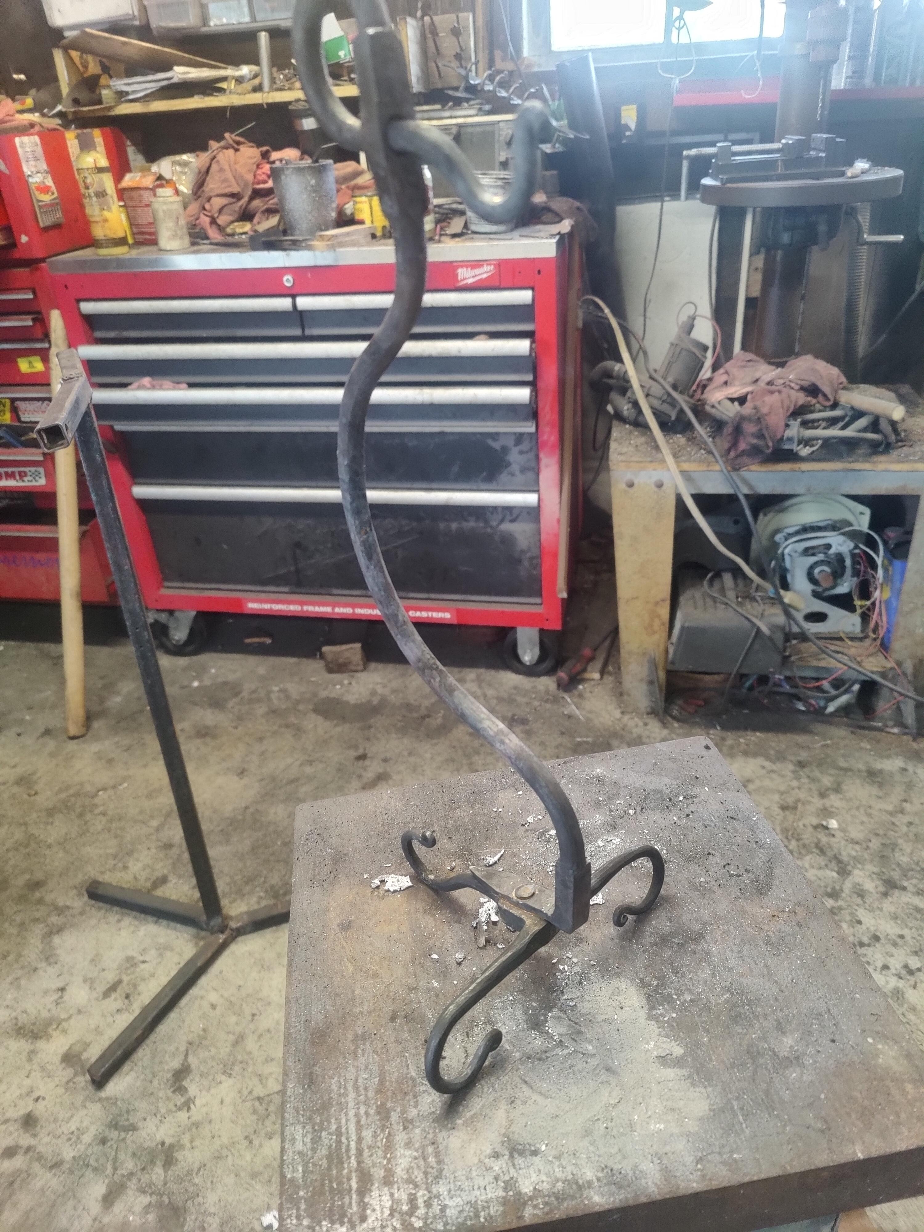

Tried out making a banana holder, or i guess you could also hang grapes, tomatoes or what ever. Had this idea kicking around in my head for a couple weeks. So i had yesterday off work, not much else to do so i gave it a whirl. Some things i am not happy with but over all a few design tweeks and i may be on to something.
Looks cool. How's the balance?
Balances good. The back leg is a little higher than the front so it leans towards the back some.  One of the tweaks i want, to get the hook to be more directly over the rivet, center of gravity and all that.
My big problem now is getting the whole thing hot enough to wax. I am thinking the oven on 500* for an hour or so should do it.
I'd just go over it with a torch, one section at a time. You don't need it any hotter than a hot cup of coffee for the wax to melt; hotter than that, and it tends to burn.

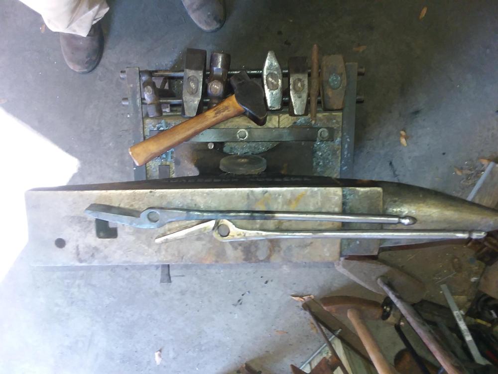

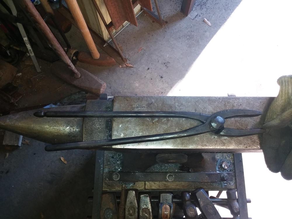

welded reins, used some old pitted half inch round so I had to hit them with a flap disk.  snapped one of my signature acorn tong ends off while adjusting.  just needed something quick for 1 inch stock.
All you need to do is rig it so it'll play "Day-O" when bananas are hung from in. Doing a little hula would probably be a bit much but not too much too much.
I like it a lot, it has a natural flow and motion I find very attractive.
I have a Buffalo railroad fire pot that I have been using for over 40 years and it is still in great shape
