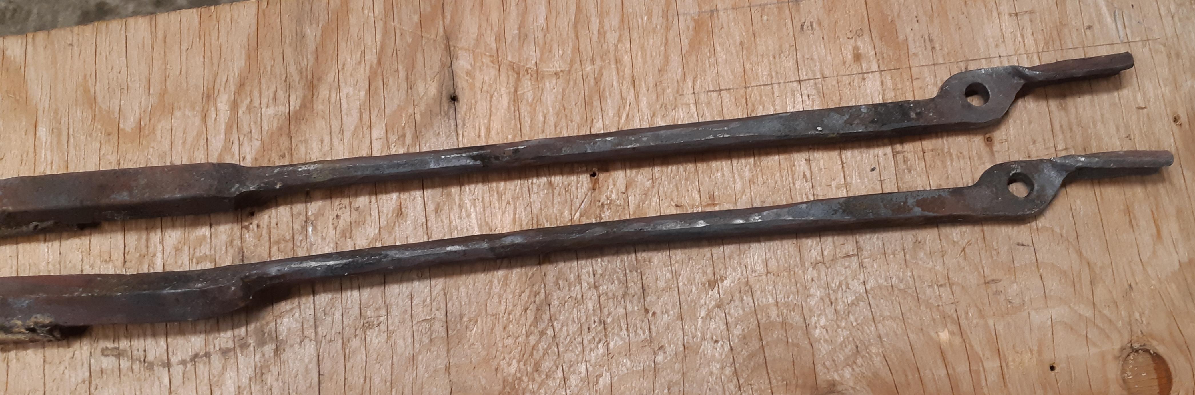

Tonight I spent 2 more hours on the tongs, drawing out the reins.

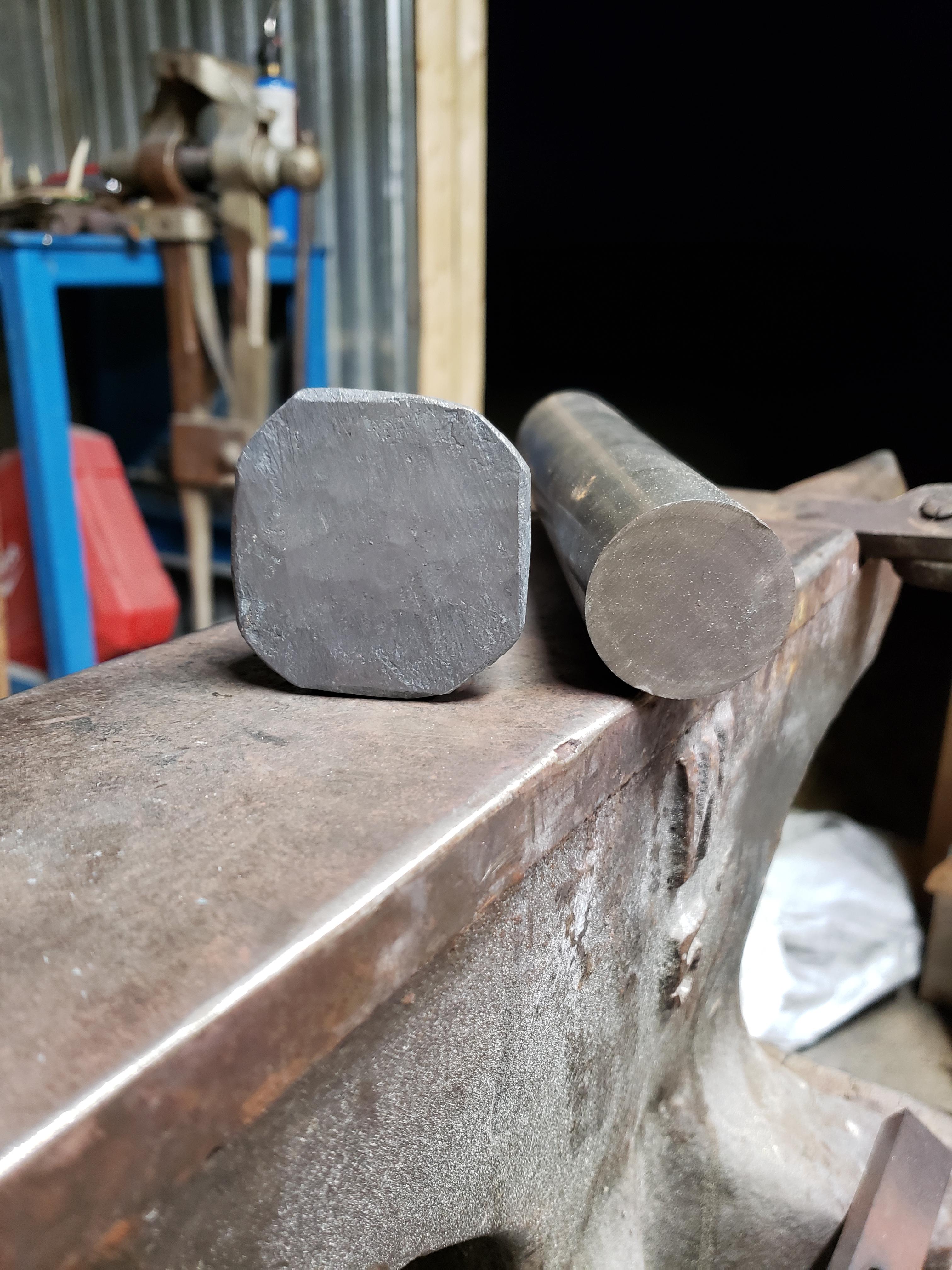

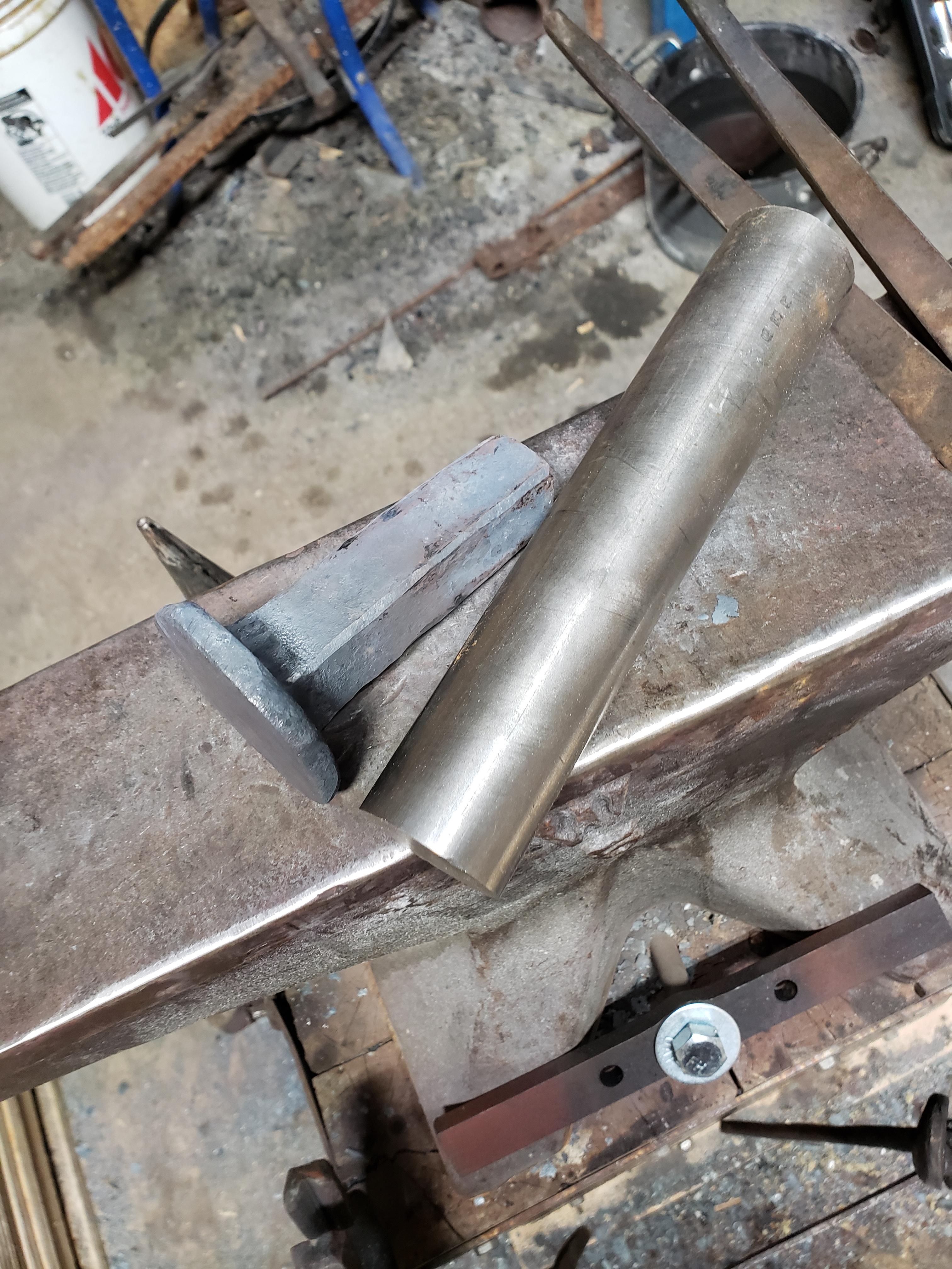

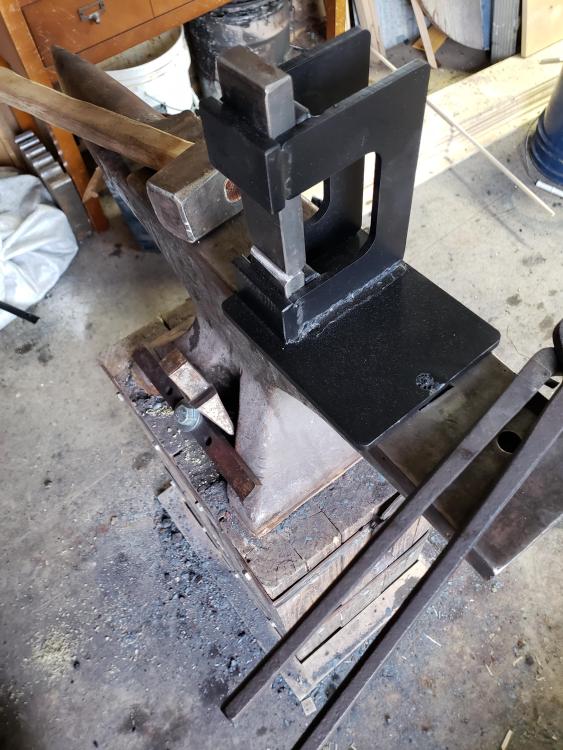

I assembled a guillotine kit from Roy at Christ Centered Ironworks on Sunday, and its maiden voyage was drawing out the body on a flatter. Flatter is made from 1.5 inch round, squared the body to 1 inch, upset the head in my hardy hole and squared it to a 2 inch square with heavily broken corners. I'll punch and drift the eye next time I light the forge and touchmark it. Then all it needs is a little filing and a heat treat.

P. S. Do you guys wedge the handle on a flatter, or let it float a little and rely on the taper as its a struck tool?
For top tools that aren't swung like a flatter, punch, top fuller, etc.  I just jam a piece of wood in with a fiction fit.  IMO it does not need to be as secure as a hammer head.
I do about the same as George, variations depending on the top tool's eye, they were punched a little more casually than hammers.
Good Morning Chief,
A Struck Tool should not be wedged, You don't want the force to travel up the handle and hurt your elbow. Some people like to wedge anything, some people like Purple with Orange Polka-Dots too. Think about your body, not trying to please someone else!

Top tools, i wedge mine but with a small wedge that is kind of loose. Just enough to hold it snug but you can wiggle it with your hand with medium effort. A couple handles are just a branch from the tree out back whittled down on one end. The handle just needs to be something you can hold onto and keep the tool in place where you want it.

When the handle on a top tool loosens with use, you hold it vertically and slam the back end of the handle on the anvil face to tighten it up. Old hockey sticks make great top tool handles.
Thanks for the advice everyone. I was leaning towards not wedging it, so you just reaffirmed my plan. I actually really enjoy making handles. From the cabinet shop I work at I have pretty much unlimited access to hickory, maple, and oak. Although the hockey stuck idea is a really good one!
Hickory is my preferred handle wood, with ash a moderate second. The fact that I've got a decent supply of both is just gravy.
As for the handles of top tools, consider them to be a consumable and expect to replace them as needed. In other words, don't get fussy, and don't spend anything on the material.
I got my hammer handle stock from a cabinet supply that closed a few years ago. He used to keep a couple 5/4" x 4" pieces of clear straight grained hickory for those of us who made our hammer handles. I don't know what I'll do when my last few feet is gone. <sigh>
Yeah, hockey sticks make perfect top tool handles, I use a whittled wood wedge to keep them from just falling off.
You can "tie" the top tool to the handle in a pinch, I recommend baling wire.

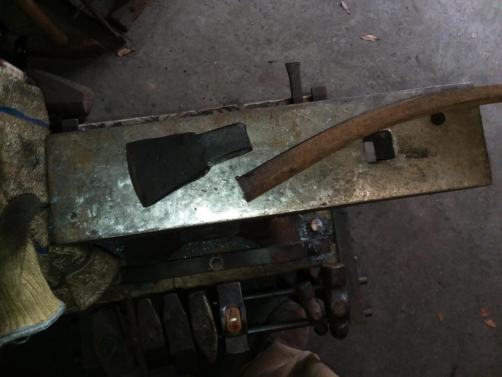

Small forged to finish (except edge) hotcut from mobile home spring.
Be careful with that; you don't want it moving around too much.
