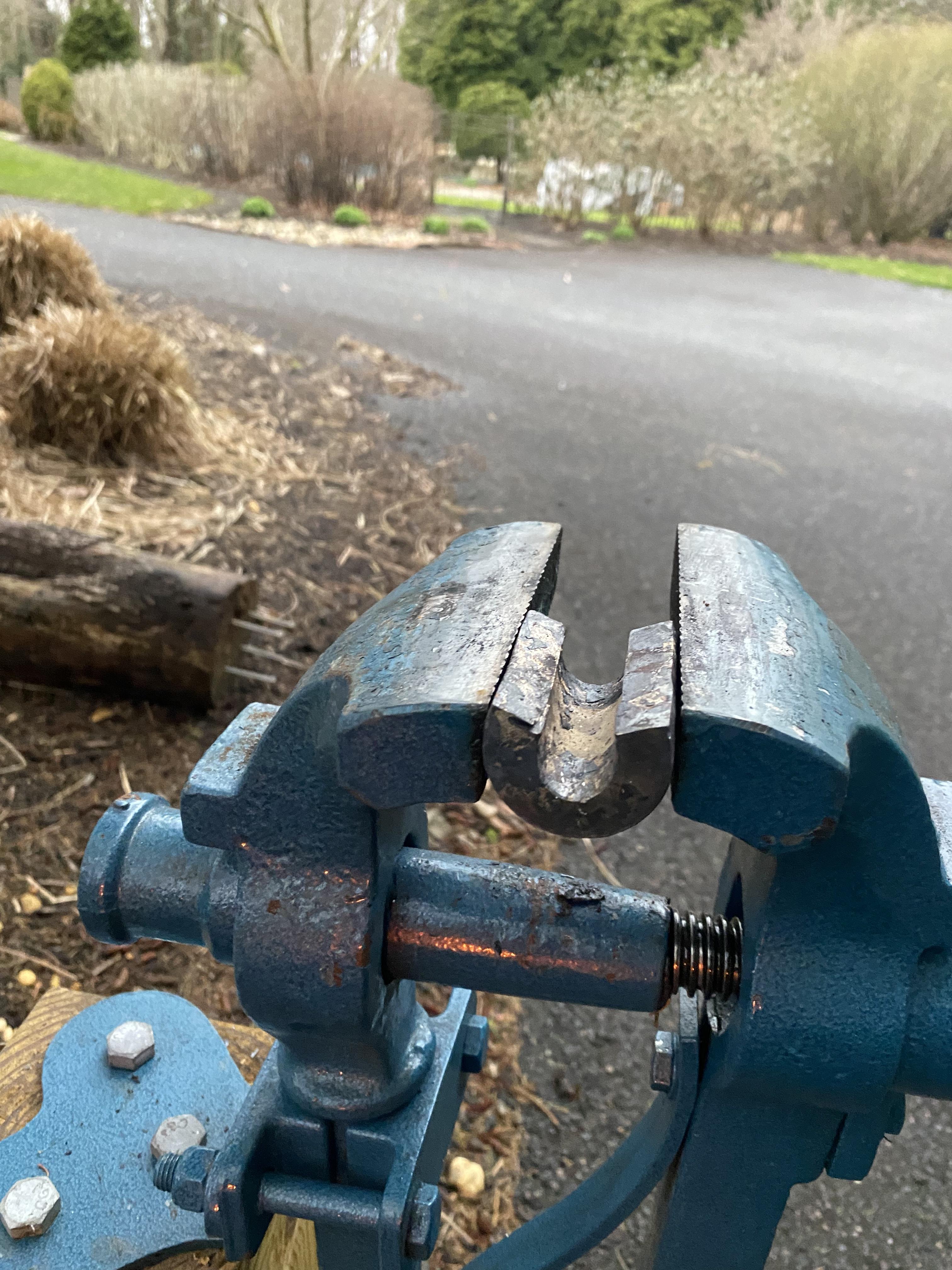

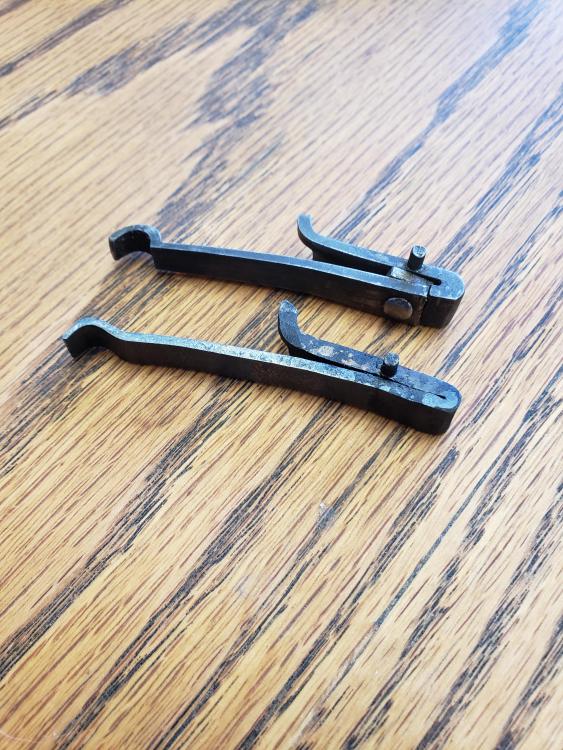

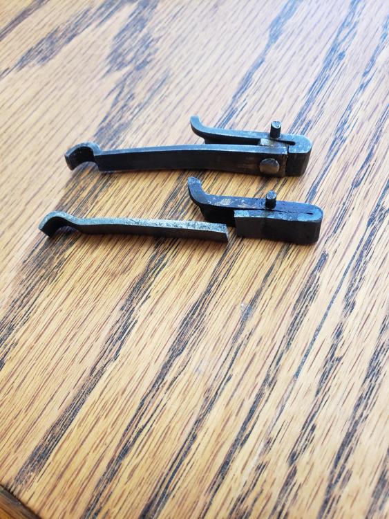

Yesterday I made a new mainspring for my flintlock since the old one had been broken and riveted back together. It had some good snap to it and threw great sparks, but nay have been a tad stiff. Gently worked it back and forth about 50 times until I got it to full cock then worked it back and forth from full cock to all the way down. Felt comfortable with it so I fit the lock back into the gun and on about the 5th test fire the spring broke.... so does that count as making 2 springs?

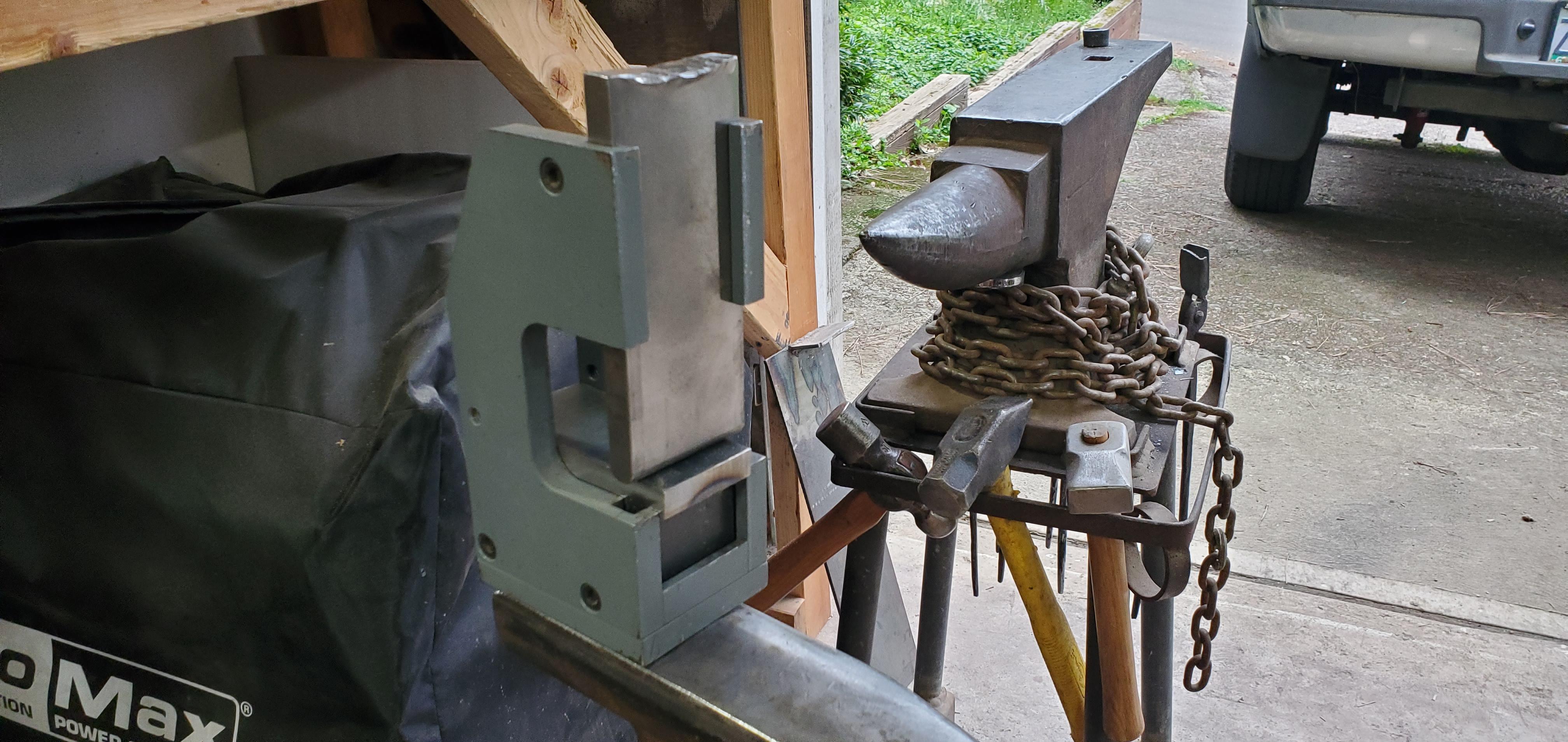

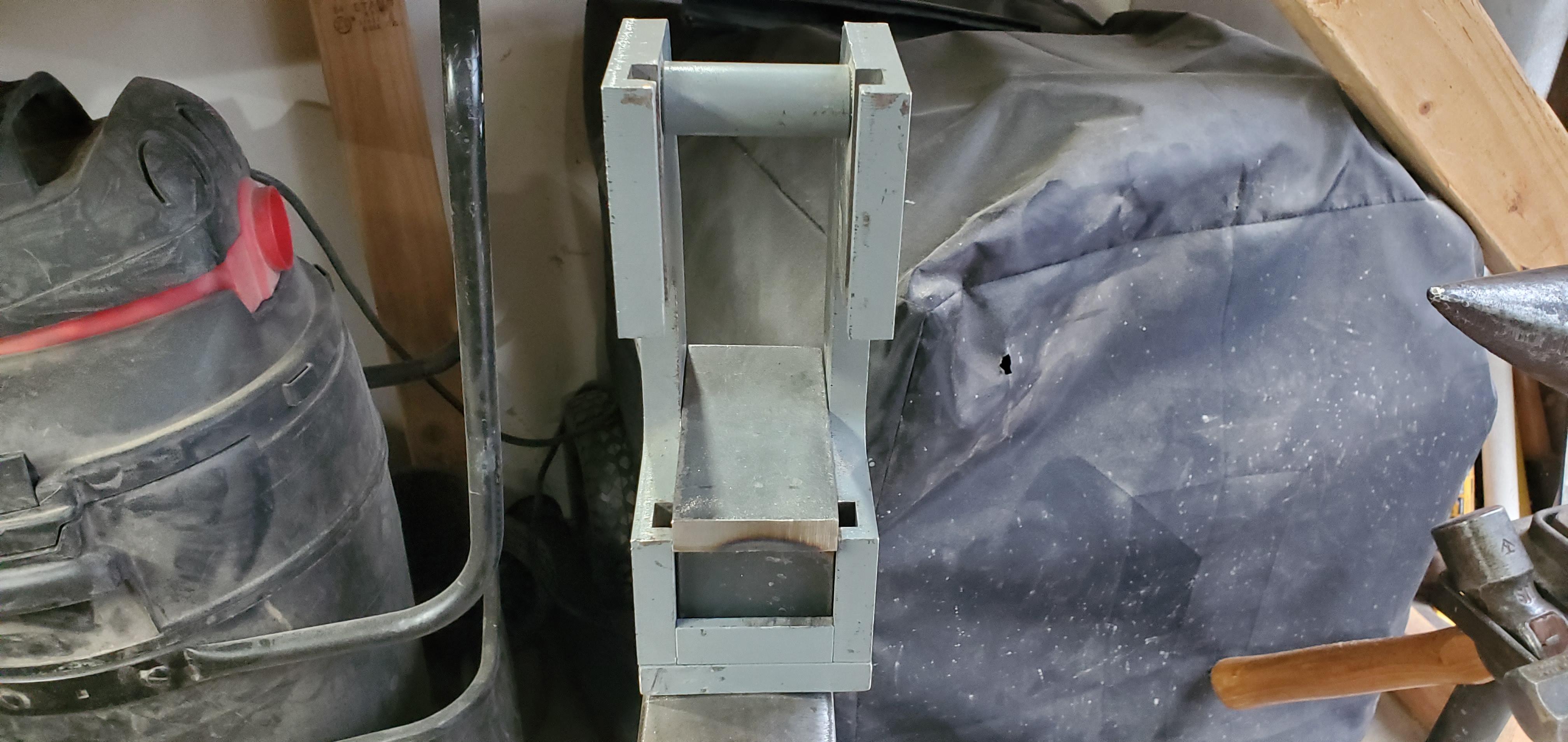

I got some time Friday evening and Saturday to dink around in the shop. Finally got a chance to weld up a simple little tool shelf/strike table for the bottom of my guillotine tool. I think it will make a handy little tool all that more handy for those times you want to fuller or cut into only one side of your stock.

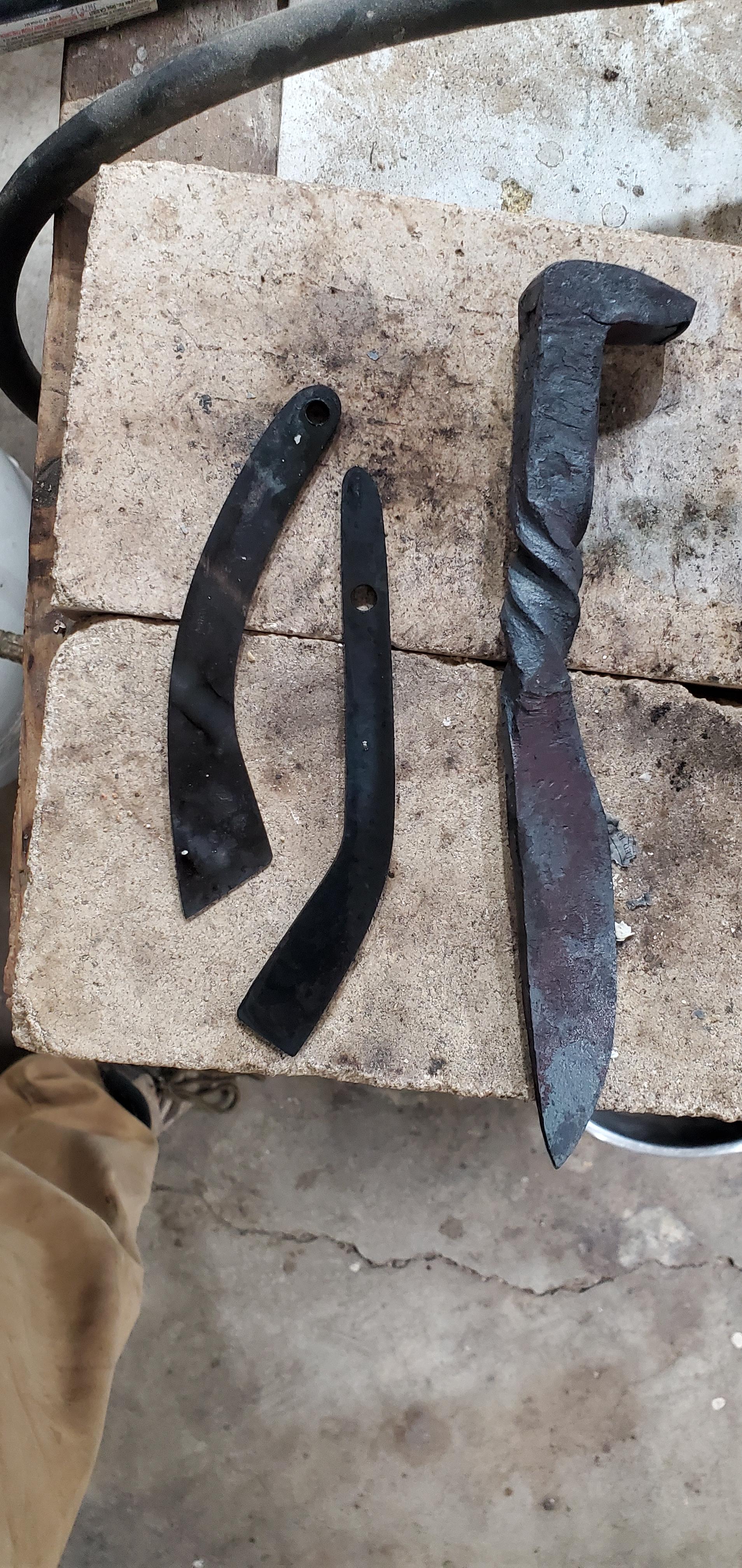

I also played around with, ugh, a RR spike knife that I started recently the first time I went to a local weekly hammer in. I'd planned to use some RR spikes to make RR spike tongs, but the pro blacksmith who helps out with advice at the hammer in was pretty sure there isn't enough material in a spike to do what I wanted, so in order to have at least something to work on that evening I make into a blade. Now I need to decide whether or not to make up a batch of Superquench to attempt hardening it or to just chalk it up to forging practice and move on.
I also tried to harden the two kiradashi blades in the pic below. Unfortunately, neither hardened at all in my gass forge, quenched in Parks AAA. The steel for these is a thin bar my pops gave me when I was visiting to steal an anvil and post vice. He thought it was some 5160 someone had given him, but he could have mis-remembered. His shop is utter chaos and the steel could have been switched around by him or my younger brother. It does spark like decent steel.
I'm going to cut a piece from a bar of 5160 I bought from my local steel yard, spark test it against a chunk from my dad's bar and then test harden the known steel. If I can harden the known steel appropriately, I'll repeat with the mystery piece and go from there.

Chieflittlebair, to bad about your spring.  How do you temper your springs?  I have had good luck using the procedure from the Brownells catalog.  Wrap the formed spring in iron binding wire tightly enough to hold the quench oil well,  heat it all until cherry, then quench.  Remove from the oil and light the oil on the wire wrapped spring and let it burn until its gone.  You either have a spring or you don't.
CLB, what does the grain structure look like on the broken pieces?
I have used the Brownell's method of tempering springs and for me the failure rate was about 40%. I have also used melted lead to temper after quenching. I prefer the molten lead method because I have a lead pot for casting round balls & bullets and the failure rate is about 10% using lead.  The melting point of pure lead is 600° F so the tempering makes the spring a little softer but still springy. I leave the spring in the molten lead for about 5 minutes.
The other problem I see with the broken spring is there is no gap where the back bend is which makes the pivot point farther along the main leg. There should be a gap making the pivot point closer to the rear bend.

To harden, I heat to what I see as a bright red/dull orange. It is at that point that it is non magnetic. A blacksmithing buddy of mine sees it as more of a cherry red, I just see glowing metal differently I guess lol. Quenched in warm motor oil. It passed the file test. Shined it really quick with some paper and tempered it with my little propane torch to a bright peacock blue. Set it on my anvil and let it cool down slowly.
The grain was really fine. I couldn't see any cracks that would have developed during the quench. I'll see if I can get a closeup of the grain.
Very good point. I actually noticed this while comparing the two springs and made another one but this time left a gap where the spring folded on itself. Heat treated the same as the first one and it works great. Just waiting on some new flints to arrive. This was actually a really fun project that required a lot of tedious hammering and careful attention to detail. I'd like sometime to make an entire lock. Maybe wrought iron and case harden it.....

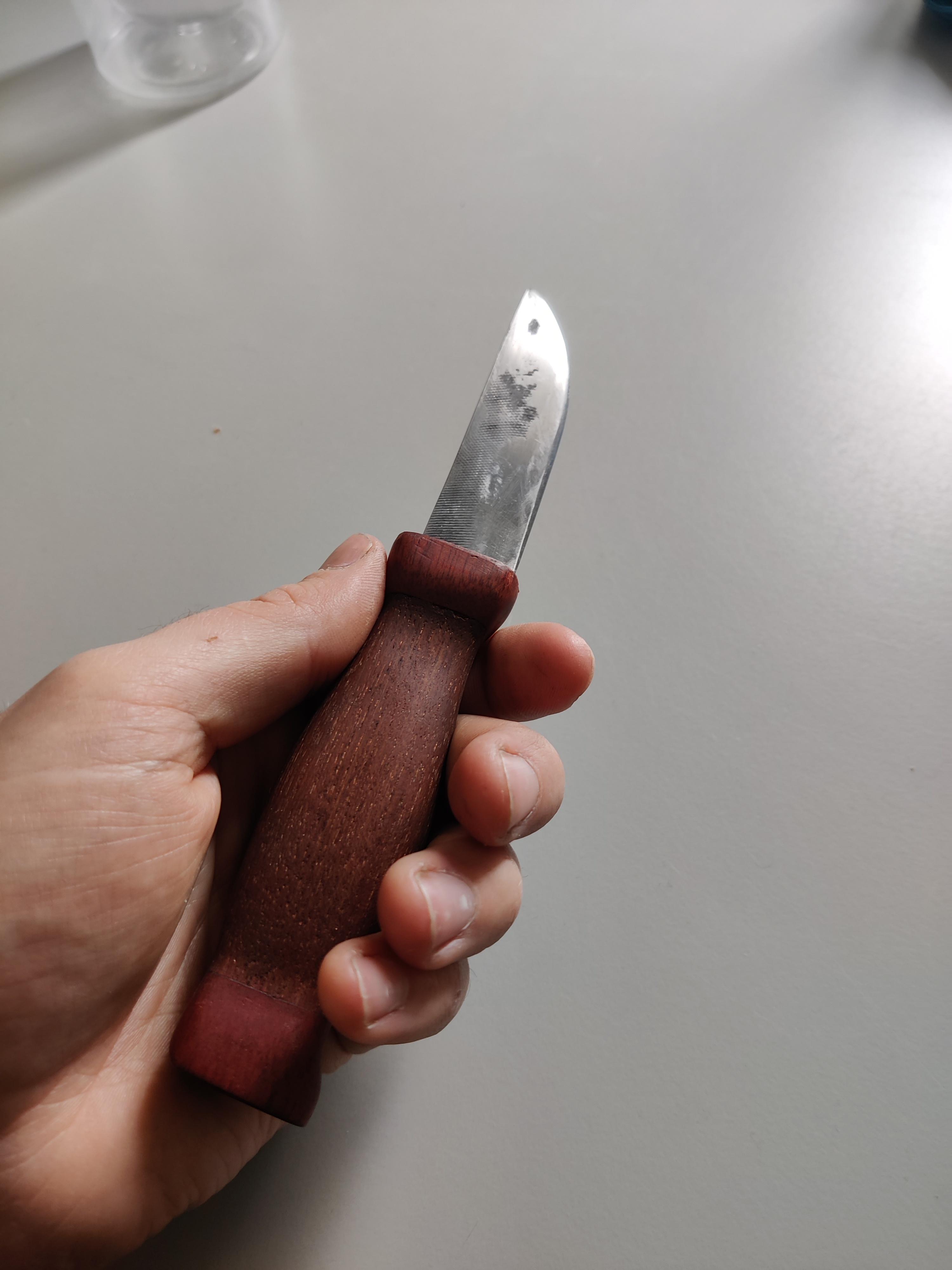

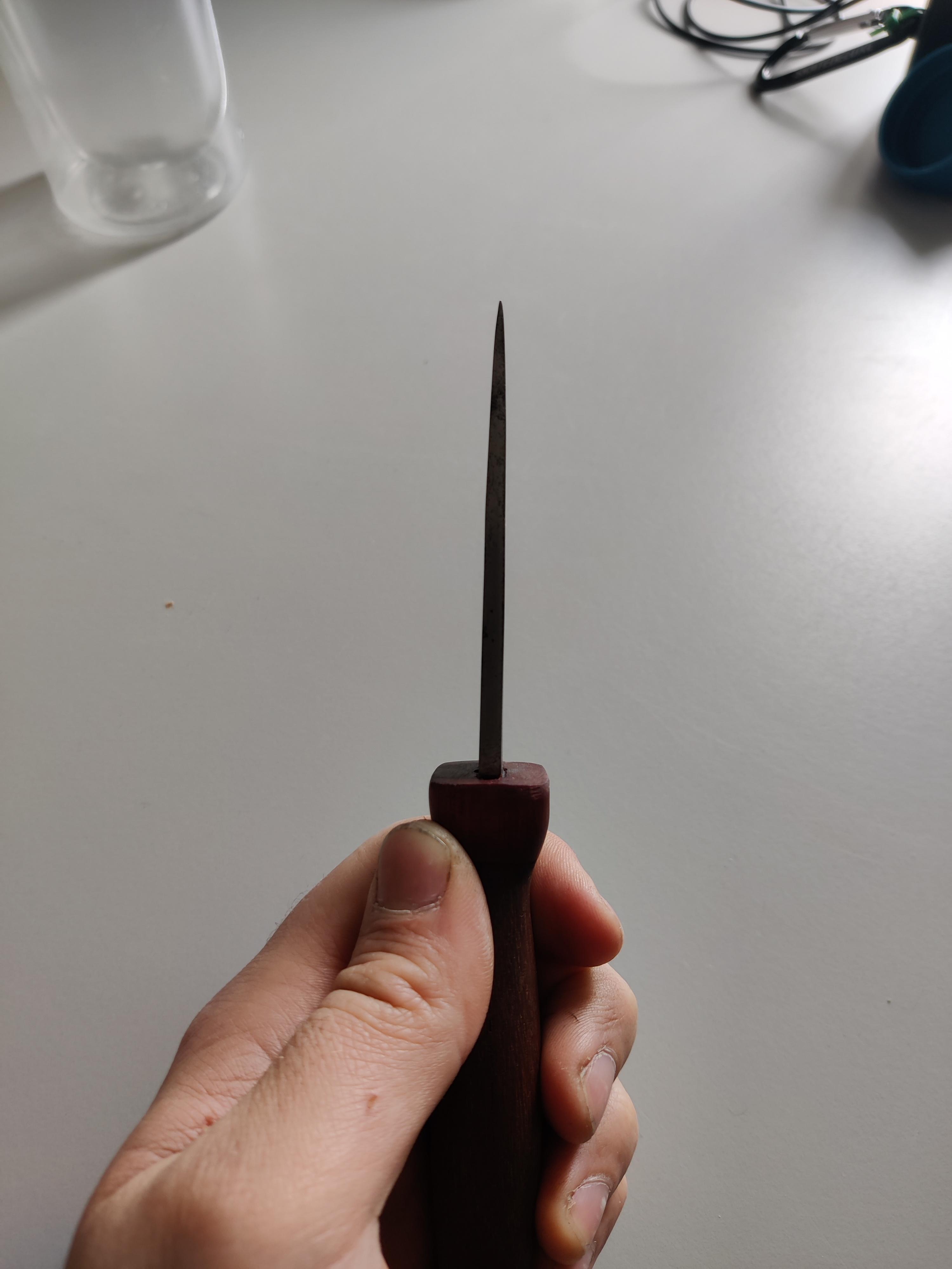

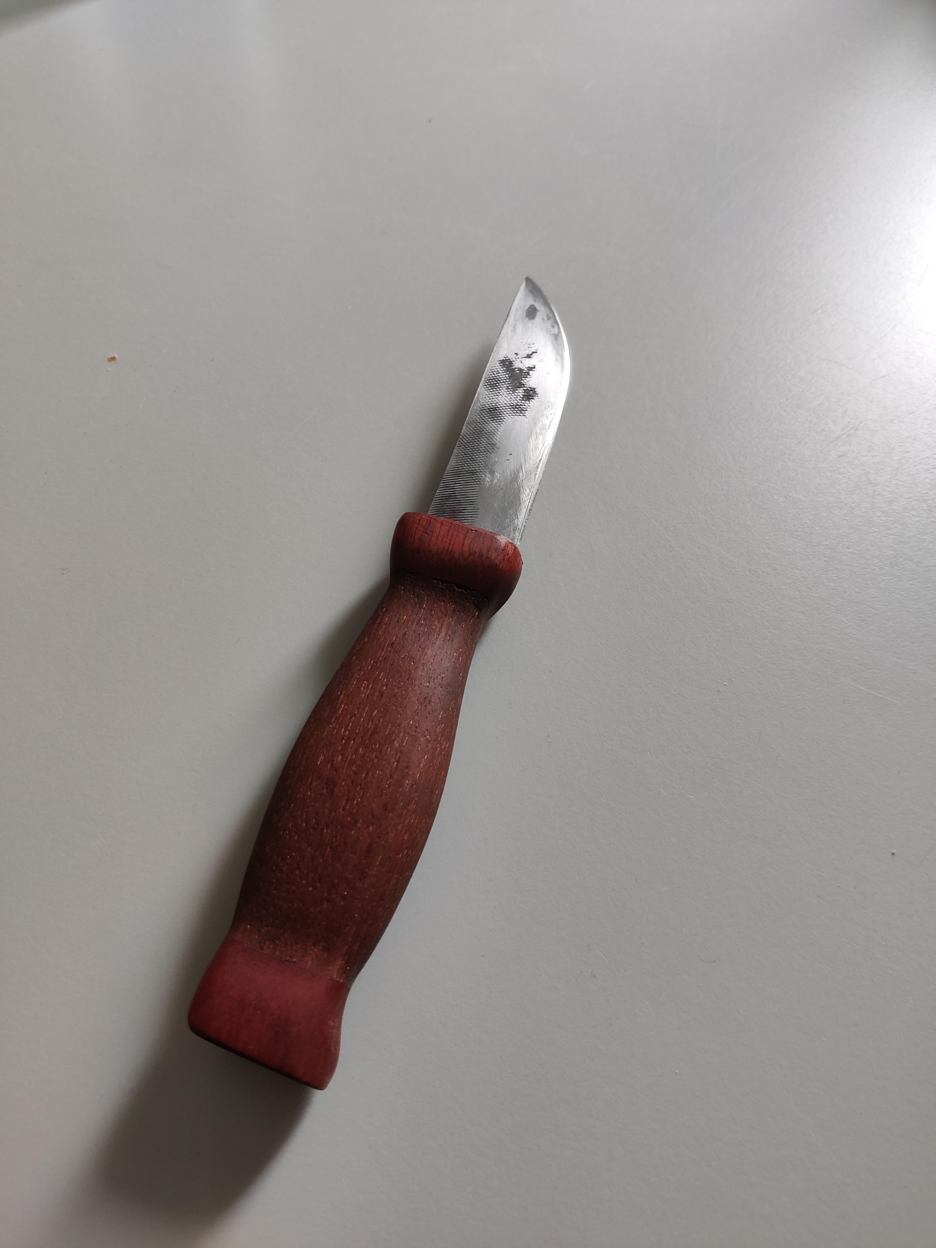

Finally got some time again to make some stuff inbetween these past few weeks, and I've tried to make my first knife from an old file.
it even has somewhat of a distal taper going on.

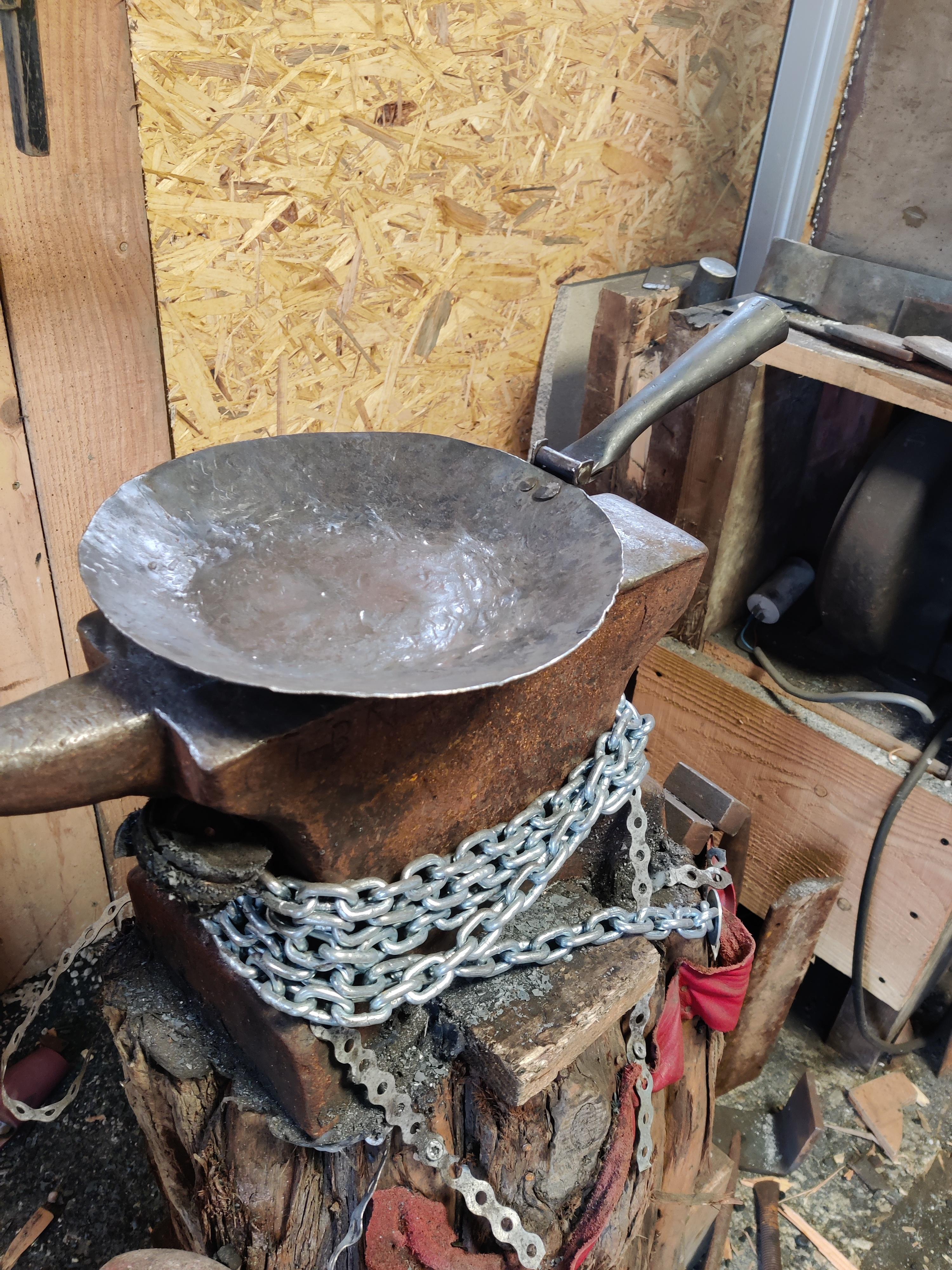

I also did some sheet metal forging for the first time and made a skillet. The handle can be closed into the skillet for easier storage.
~Jobtiel
Nice knife - what’s the handle material? Folding handle for the skillet is pretty clever lol I like that.

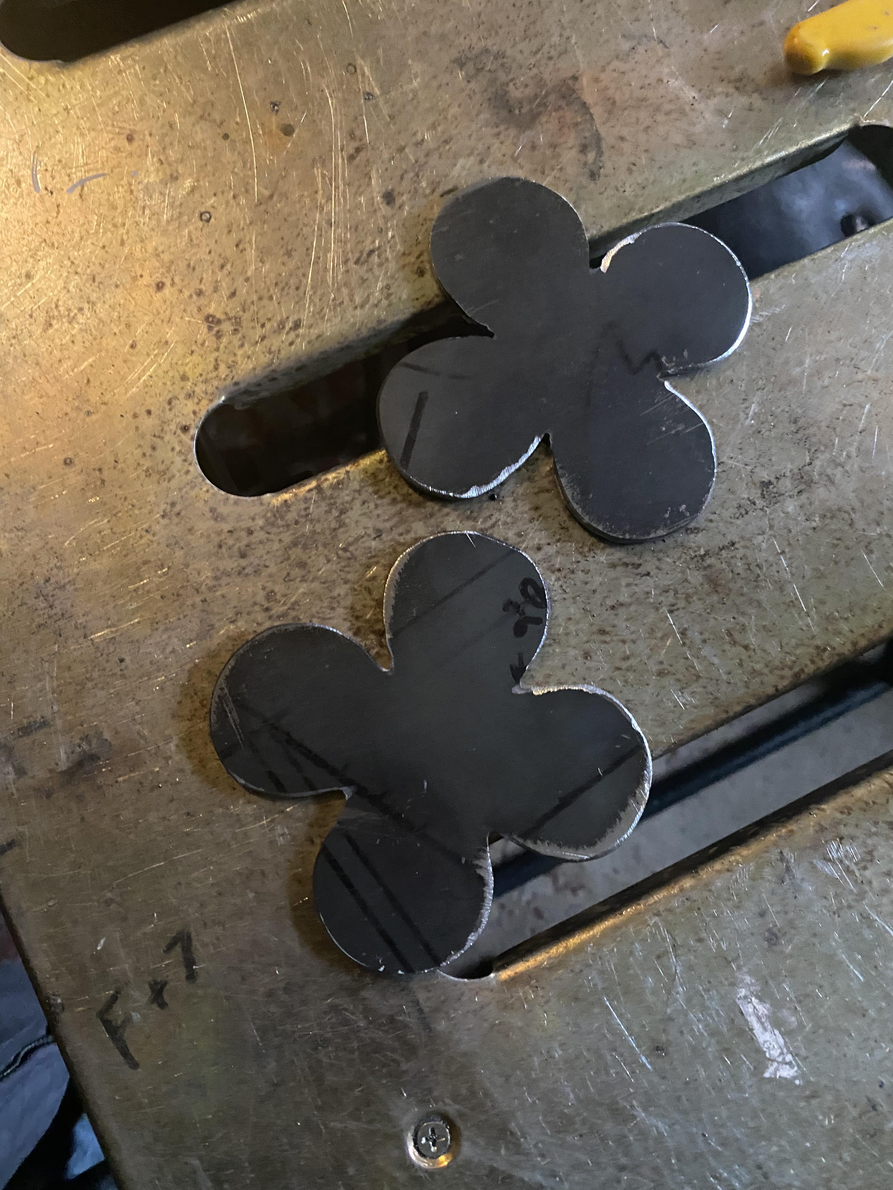

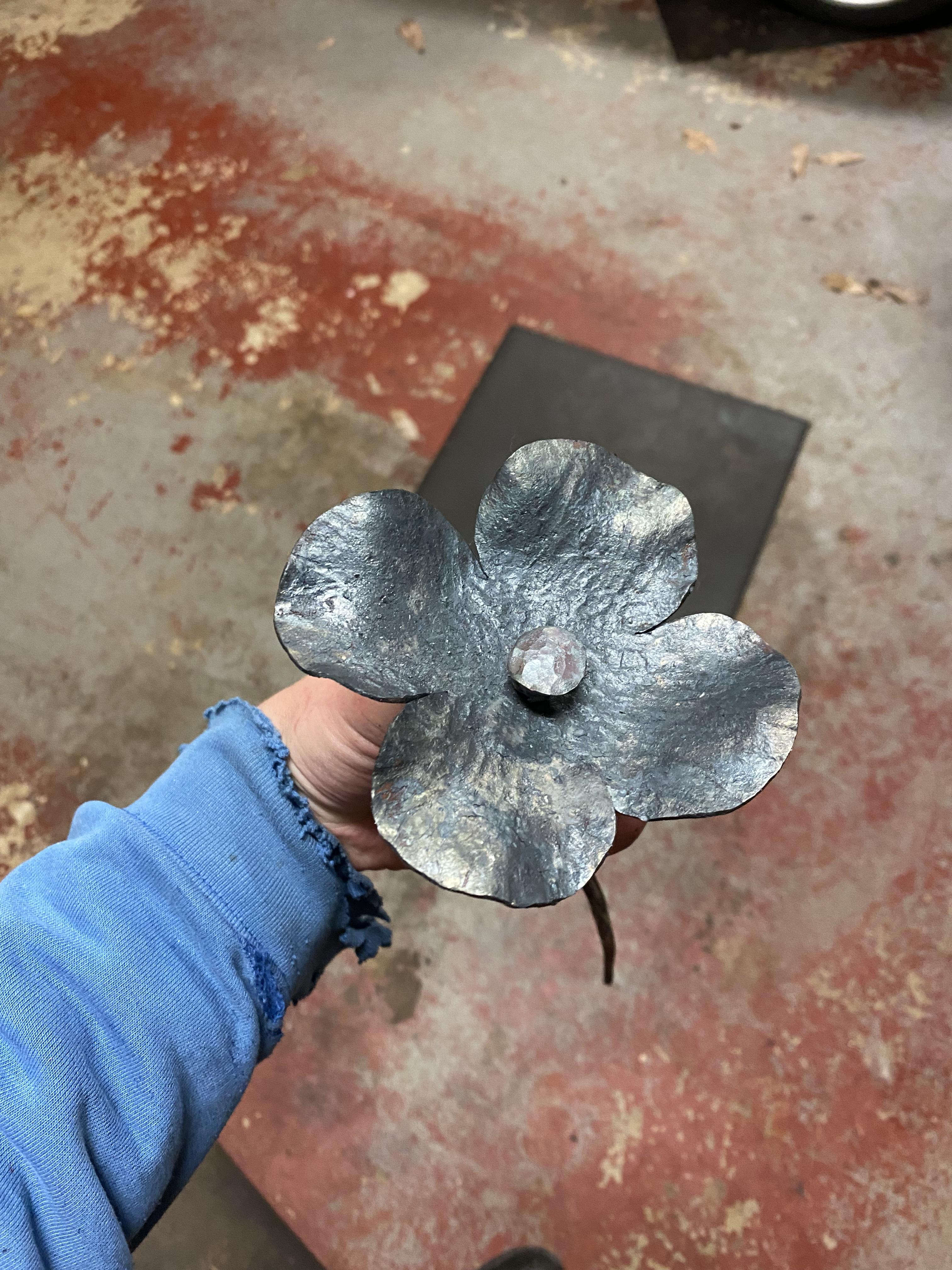

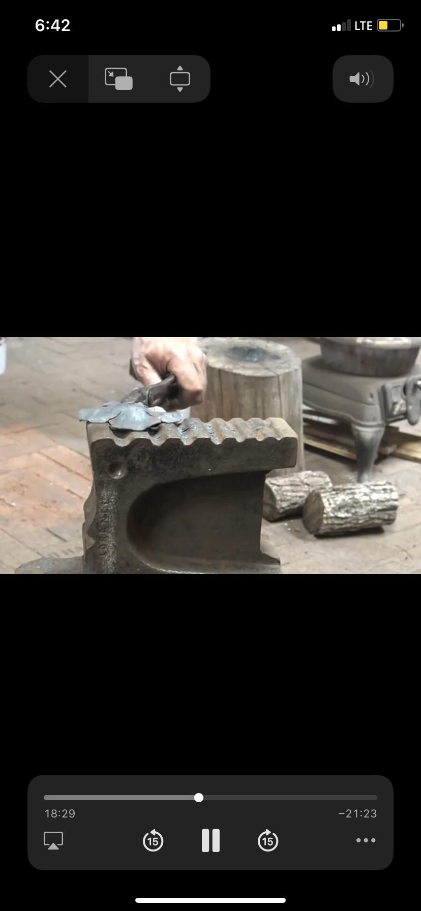

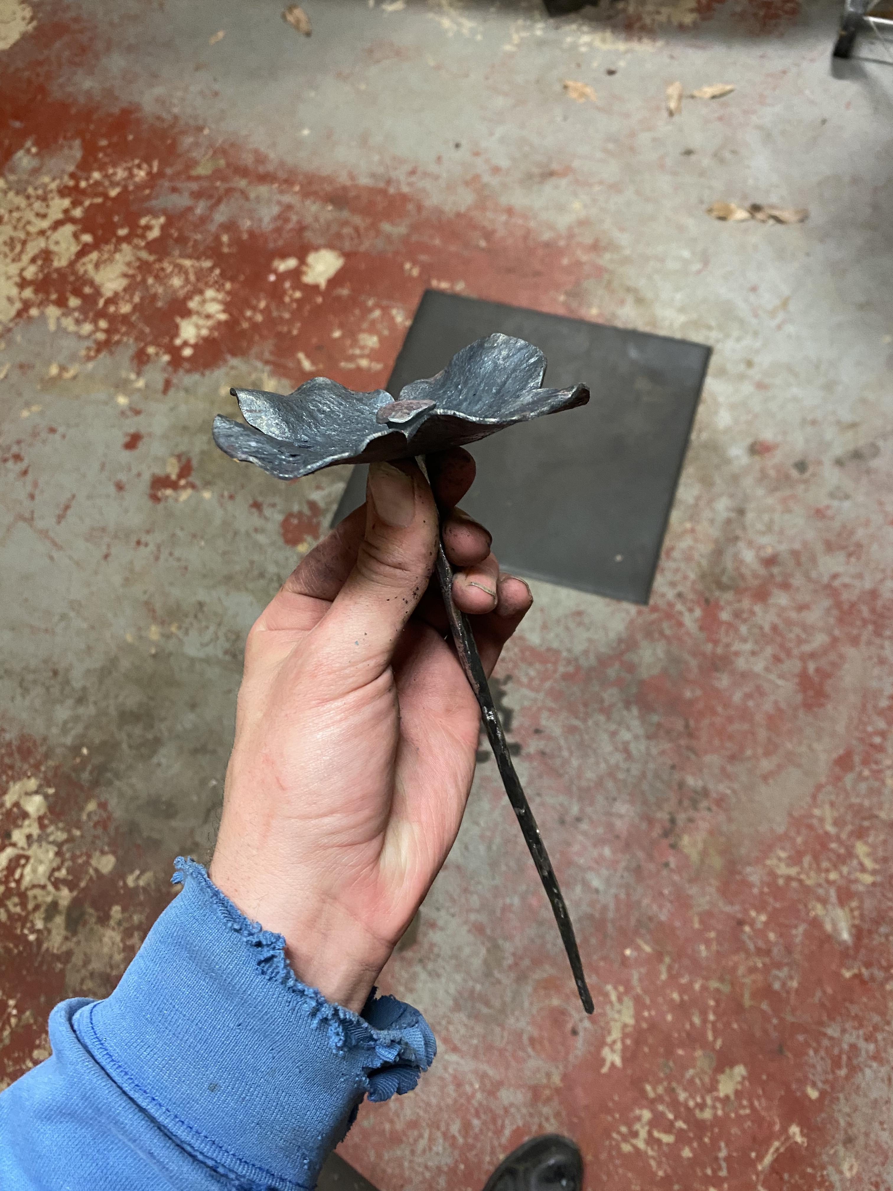

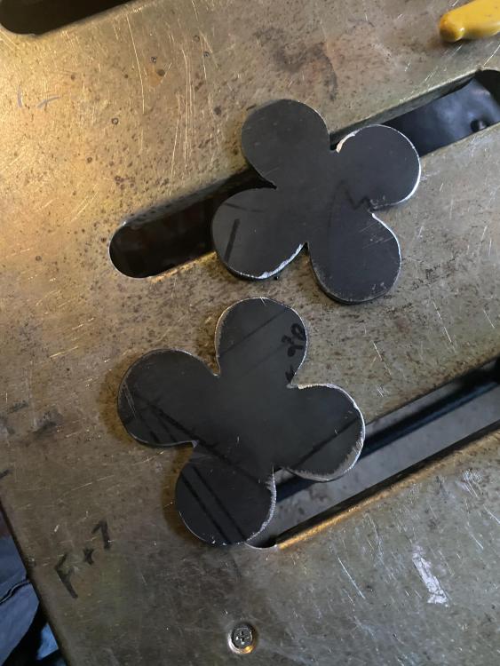

My cousin is making some kind of display in one of the corners of his apartment. I didn’t get details of exactly what but he asked for two forged poppy flowers. Black Bear Forge once again had an awesome video on it. I didn’t use the links he had for patterns - I kinda of just free handed onto some 1/8” plate and went for it. Probably should’ve used the pattern. Been having fun with these though. Got the first one almost totally forged. I have to do some clean up and more upsetting on the middle part - called a stamen I believe. I wanted to do a couple leaves on the stems but the pics I’ve found show leaves that look very complicated so I might just leave the stems alone. A while back I also got a couple of what I think are some kind of bushings from work. I cut one in half and was planning to use as drawing dies for the log splitter press but instead I threw one half in the forge and closed it a bit to substitute John Switzers awesome swage block. I used it in the vise and it worked great to put some curves in the petals so now I’m thinking about keeping the other half the original size and welding some hardy shanks on them to use at the anvil or make using at the vise easier. Not really happy with the texture of the petals but I think once there all put together, cleaned up and have a little brass brush going they’ll look ok. I found some bernzomatic brazing rods - was thinking about trying to use them to connect the stem and petals but I’ve never brazed before. I’m assuming that bernzomatic brand brazing rods can we be used with a bernzomatic mail torch. And my custom touchmark is supposed to arrive today - so excited. I really need a good hot cut. I have so much trouble deciding on which tools to buy when there’s 25 different good choices for one single tool. Right now I improvise with this giant chisel haha but it works.
