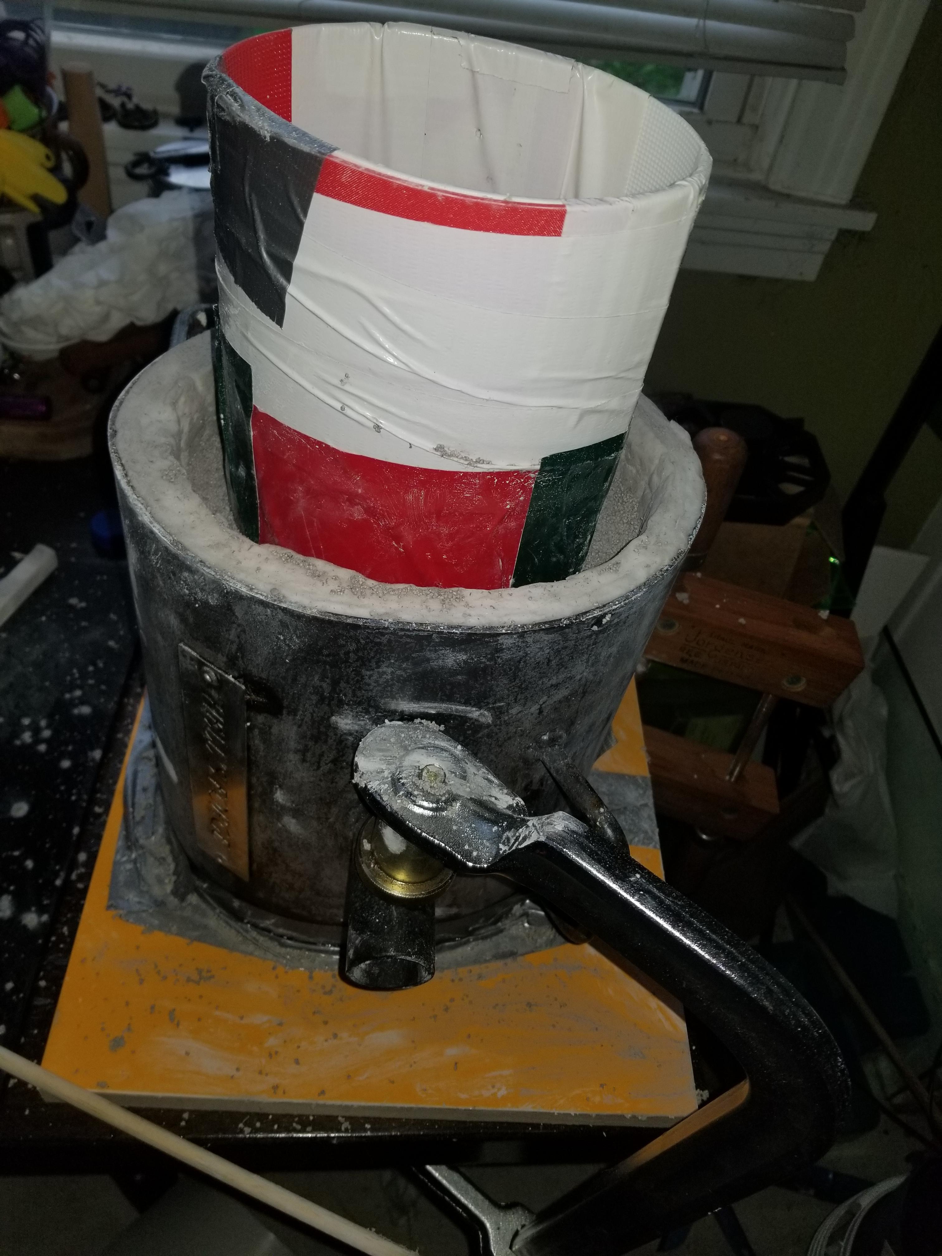

pat they look great. I hope to make one soon. getting my supplies together now to start round 2 of KOL using a form this time lesson learned.

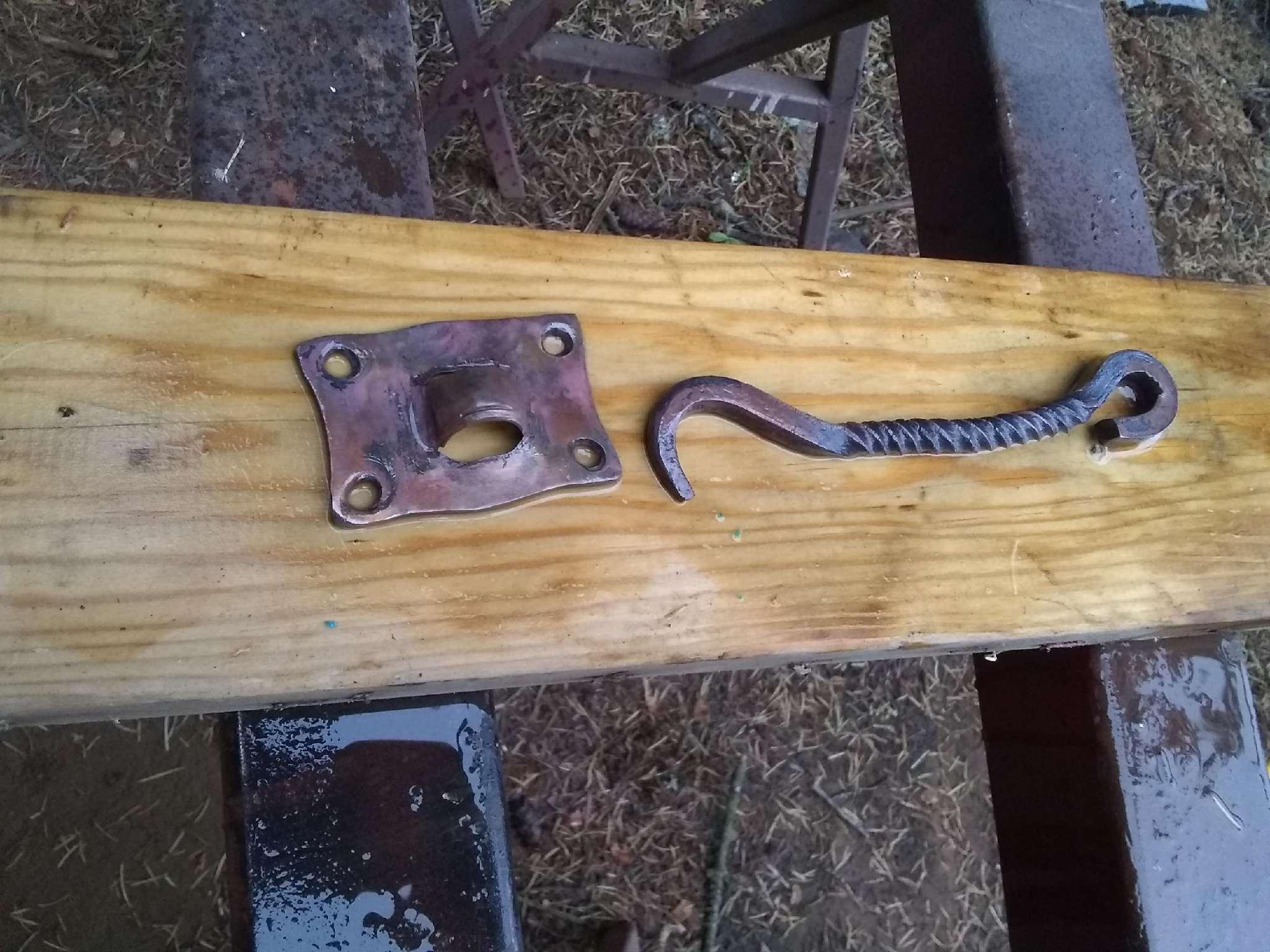

Experimenting with copper finish. Glad I did it outside, muriatic  acid is nasty stuff.
Lary, I usually put the acid in a container when i use it, it may eat through those boards and stuff. :lol:
Seriously though how did you do the finish? Electroplating or just clean the metal and do a hot rub like with a brass brush? I ask becuase i tried electroplating a few weeks ago and failed.

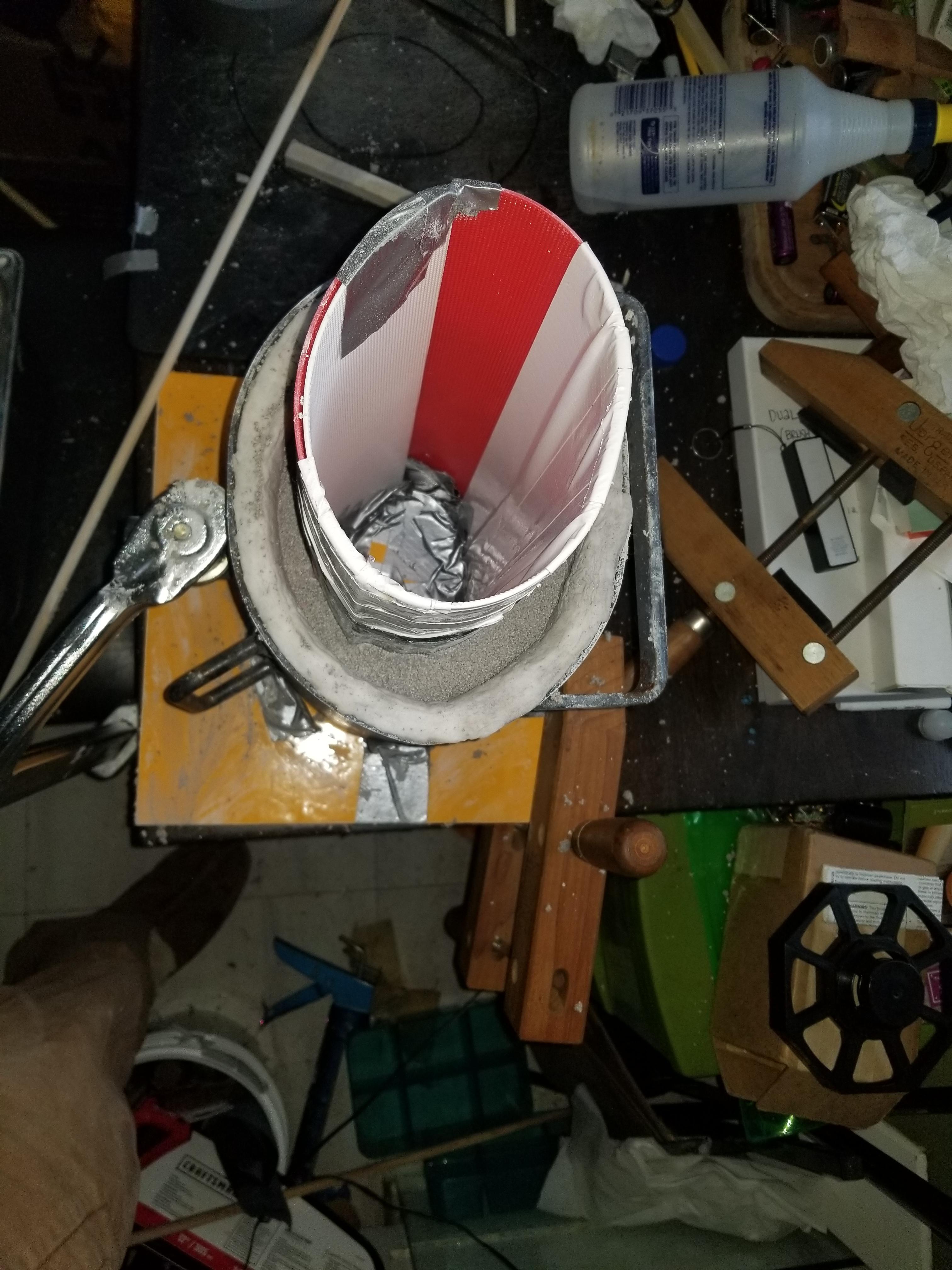

well that's a bummer. I was able to complete KOL use this time but ain't it my luck I run out about 1 inch from top and no ends done.  2 hours to wait then pull from form and let this cure. then will have to order more to finish.
I wouldn’t pull the form until you have more. Hopefully someone more experienced will chime in here.
I'd recommend leaving the mold in place until you've finished casting. The curing of the existing KOL won't be hurt by having it there, and you won't have to re-insert it to finish casting the top and sides.
That said, the texture of your KOL looks perfect.
sounds like a plan. probally order tonight or tomorrow morning whenever I see my accountant.  think I will soak a towel and insert into trash bag here shortly.  and wait to see when that lovely lady gets home.
Sounds good.

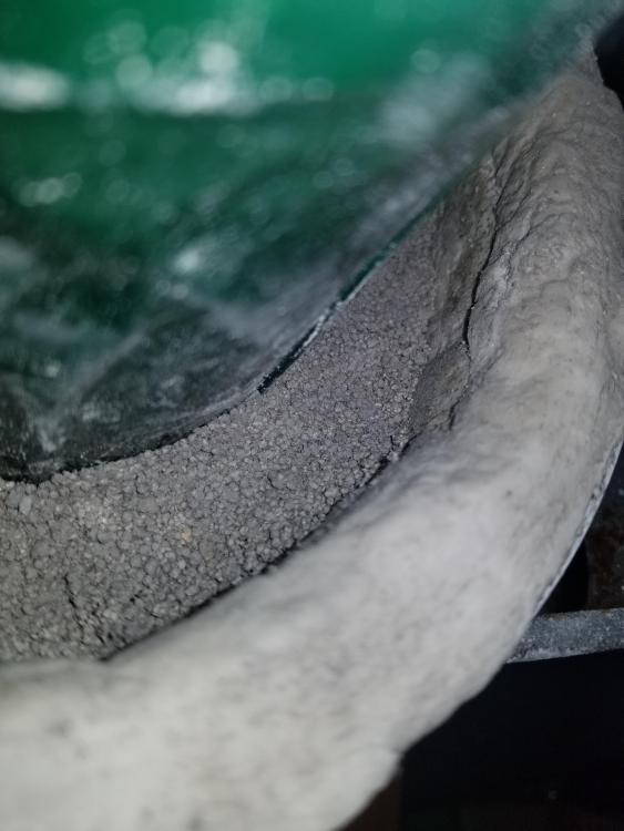

Gandalgreen is that a Hell’s Forge single burner or an entirely homemade forge? I ask because I can see a small chrome looking logo type thing in one of the pics that looks similar to the ones on hells forges but can’t make out what it says. If it is Hells Forge did you not go with the lining materials they provide because you just wanted something stronger right off the bat? I have a single burner Devil Forge which looks basically the same as the hells and the refractory they sent lasted quite long - I guess it’s almost a year now and it only really started going down hill quick after I started using flux. I now have new kaowool and kastolite on the way so I’m curious to see how yours comes out as I’m guessing mine will be a very similar process. Did you rigidize the kaolwool first? I believe my forge originally came with the kaowool already installed and rigidized, then I just put the included refractory on it but I could be remembering wrong.

Pat yes it is the hells forge single burner. it did come with a product to use but the info I read about it I was not impressed. it came lined with wool that I had to rigidize.  after reading about the product they send and then KOL I decide to do KOL. soon as I get some more KOL ordered and delivered I will finish and post.
