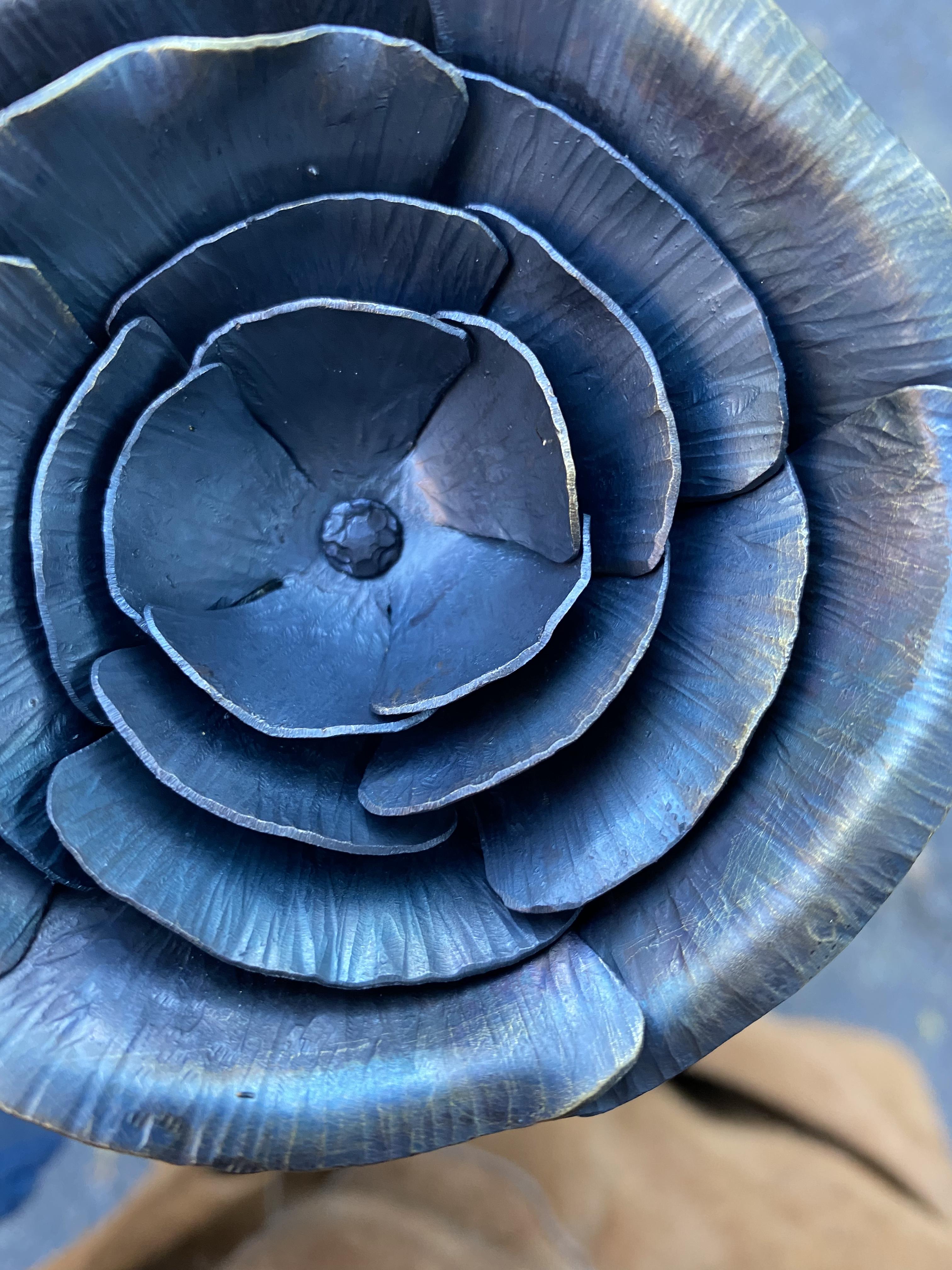

lary Posted October 31, 2021 Share Posted October 31, 2021 On 10/29/2021 at 9:49 AM, BillyBones said: I ask becuase i tried electroplating a few weeks ago and failed. Billy I'm not convinced my technique will work just yet. But, poring muratic acid over item then rinse with copper sulfate granules mixed with water. Doing this cold. Using just the copper sulfate, the finish rubs off. Quote Link to comment Share on other sites More sharing options...
Jobtiel1 Posted October 31, 2021 Share Posted October 31, 2021 Did you try the plating on clean steel? I can imagine that scale will prevent better bonding between the two metals. ~Jobtiel Quote Link to comment Share on other sites More sharing options...

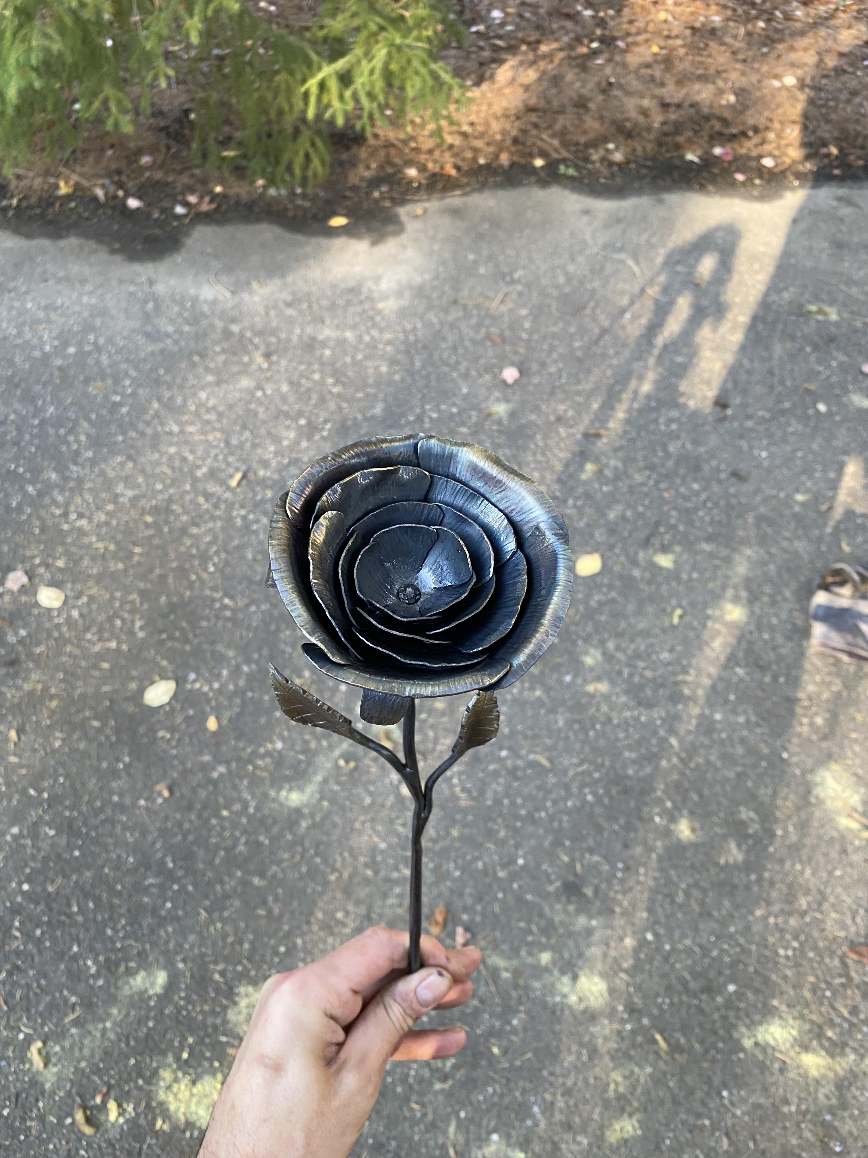

Les L Posted October 31, 2021 Share Posted October 31, 2021 Lary, I use copper sulfate on several of my projects. I just wire brush the project when I finish forging and apply the copper sulfate mixed in water. it will not stick to areas where scale is left, but sticks to the clean areas with no problem. I wash it in hot water after applying, let it dry and brush it with a stainless brush to achieve the finish I want. Quote Link to comment Share on other sites More sharing options...

lary Posted October 31, 2021 Share Posted October 31, 2021 Jobteil, Les Yes, I noticed the steel needs to be clean. Some scale helps the look, like with those roses. But that definitely takes practice to get the right balance. Very nice Les. How long do you wait before brushing? Quote Link to comment Share on other sites More sharing options...

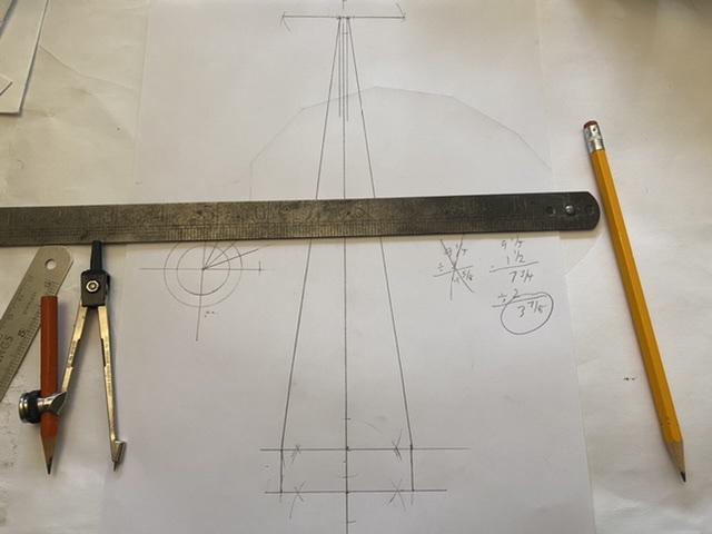

JHCC Posted October 31, 2021 Share Posted October 31, 2021 No shop time, but a little design time. Quote Link to comment Share on other sites More sharing options...
Les L Posted October 31, 2021 Share Posted October 31, 2021 Lary, when you put it on, I use a chip brush, the color is there no waiting time needed. Depending on the project I’ll leave scale on purpose, or I can’t clean it 100% like the roses, to add details. I haven’t tried the electroplating, like Frosty described, but it’s on my list Quote Link to comment Share on other sites More sharing options...
Les L Posted October 31, 2021 Share Posted October 31, 2021 47 minutes ago, JHCC said: No shop time, but a little design time. John, you’re heading in the right direction working it out on paper first, I’m waiting to see the finished project Quote Link to comment Share on other sites More sharing options...
JHCC Posted October 31, 2021 Share Posted October 31, 2021 It definitely helps with any technical issues and critical details. Quote Link to comment Share on other sites More sharing options...
Gandalfgreen Posted November 1, 2021 Share Posted November 1, 2021 what are you designing? Quote Link to comment Share on other sites More sharing options...
JHCC Posted November 1, 2021 Share Posted November 1, 2021 An idea I’m playing with, to be revealed later. Quote Link to comment Share on other sites More sharing options...

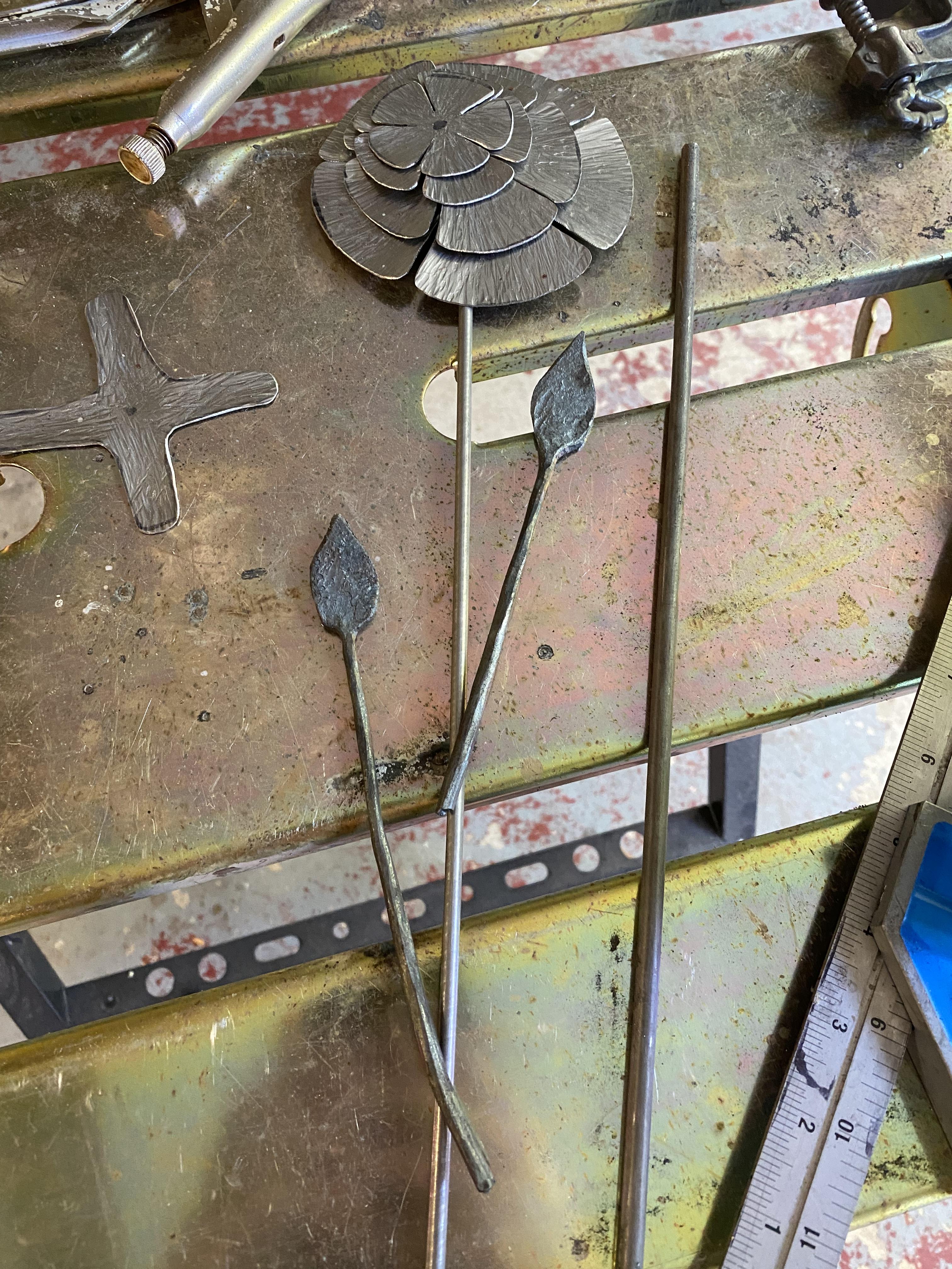

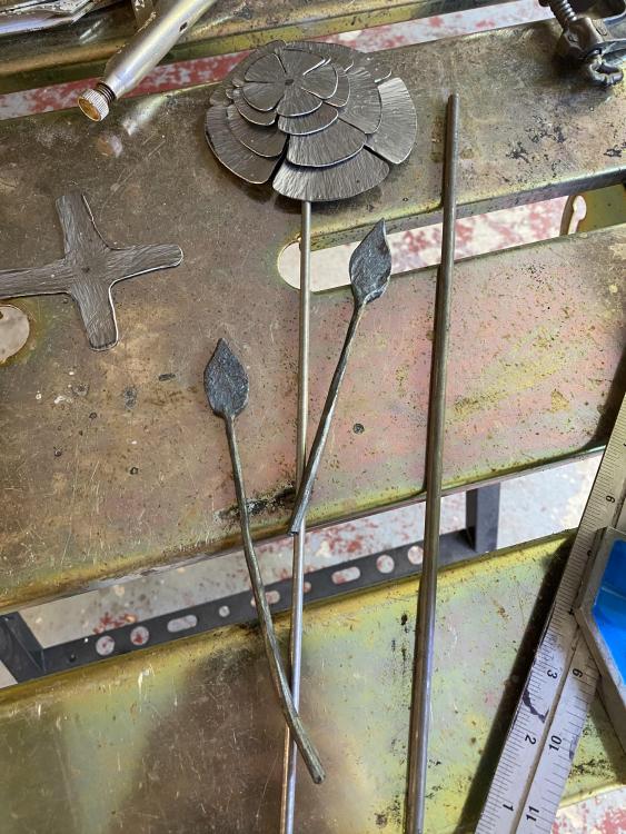

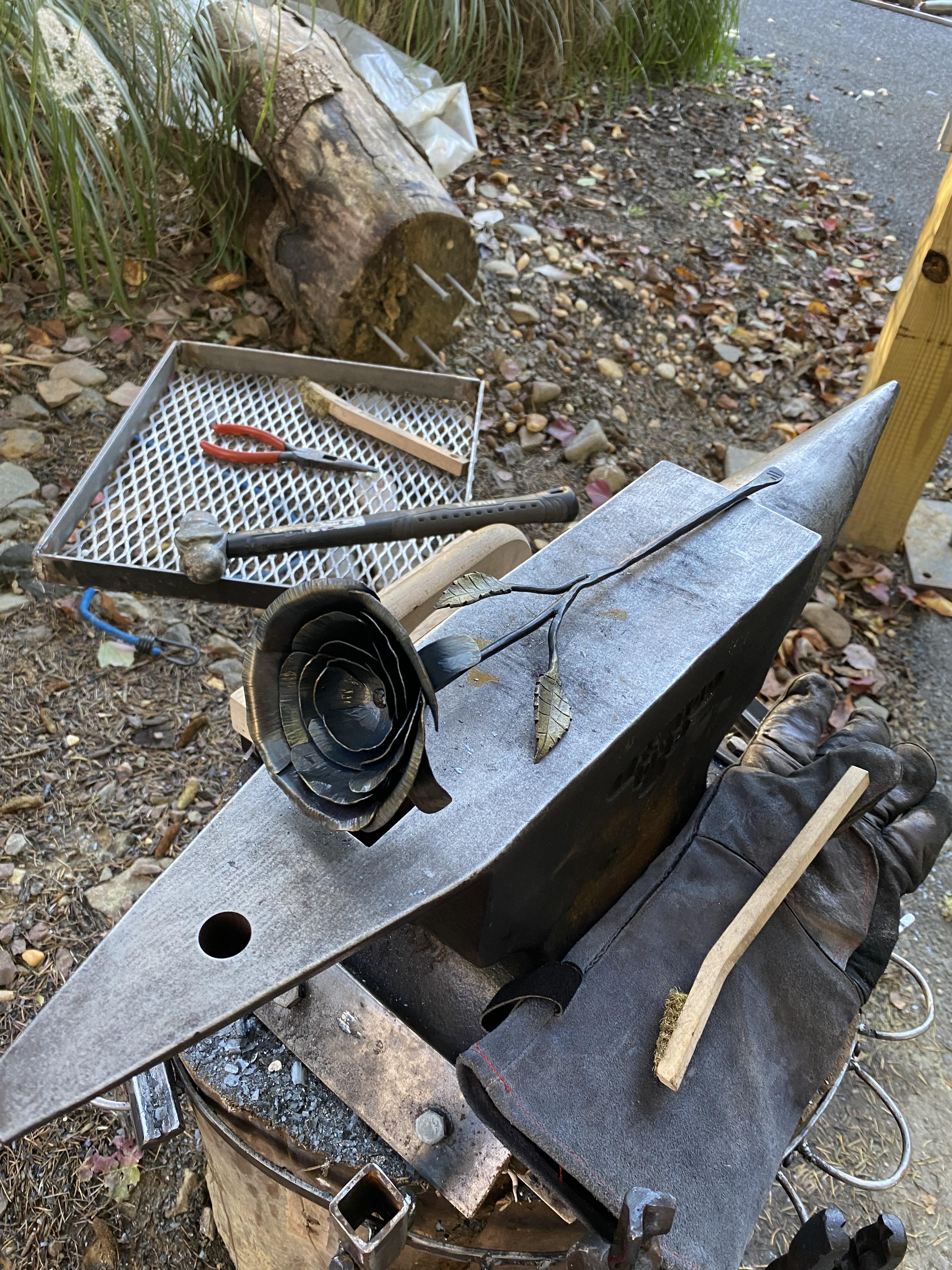

Pat Masterson Posted November 1, 2021 Share Posted November 1, 2021 Funny I came on here to ask about the rose I’m attempting from the pattern Les sent me and it’s already being talked about. Question about welding the leaves on - although after looking at the pic Les posted I think my leaves may be a bit too small. But is there a certain forge welding technique for this type of joint? Stem lengths will most likely change from pic. Considering just going with a regular arc weld or this solder stuff that comes with the plumbing torches which I feel like would be best for blending the joints. Never tried it on anything before. Anyone know if this stuff would hold? And great, now I have to look into copper sulfate because those roses look amazing Les! Quote Link to comment Share on other sites More sharing options...
Les L Posted November 1, 2021 Share Posted November 1, 2021 Thanks Pat, I arc weld my leaves on Quote Link to comment Share on other sites More sharing options...

Purple Bullet Posted November 1, 2021 Share Posted November 1, 2021 Arc welding works. Joining small stuff where the weld will not be hidden I like to acetylene weld. It gives a little more control and its easier to reheat if I think it needs a little more hammer work without going back to the forge. That IS a nice finish with the copper sulfate. I may have to give that a try. I've just been hot brushing with brass wire brush and was considering brazing with copper wire to get a richer contrast. Just so happens I have some copper sulfate. Its what I use in my cooling water for my induction forge. Quote Link to comment Share on other sites More sharing options...

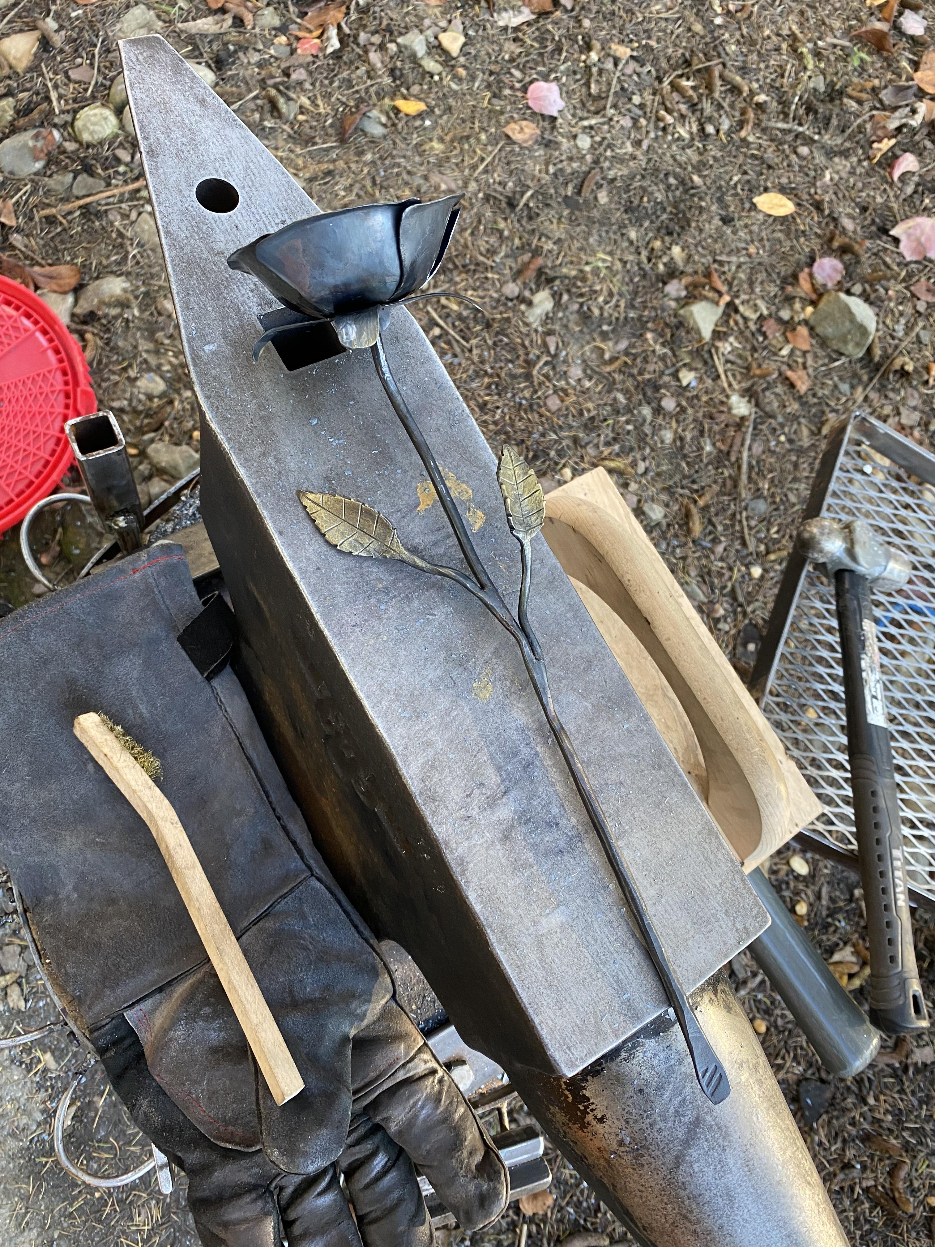

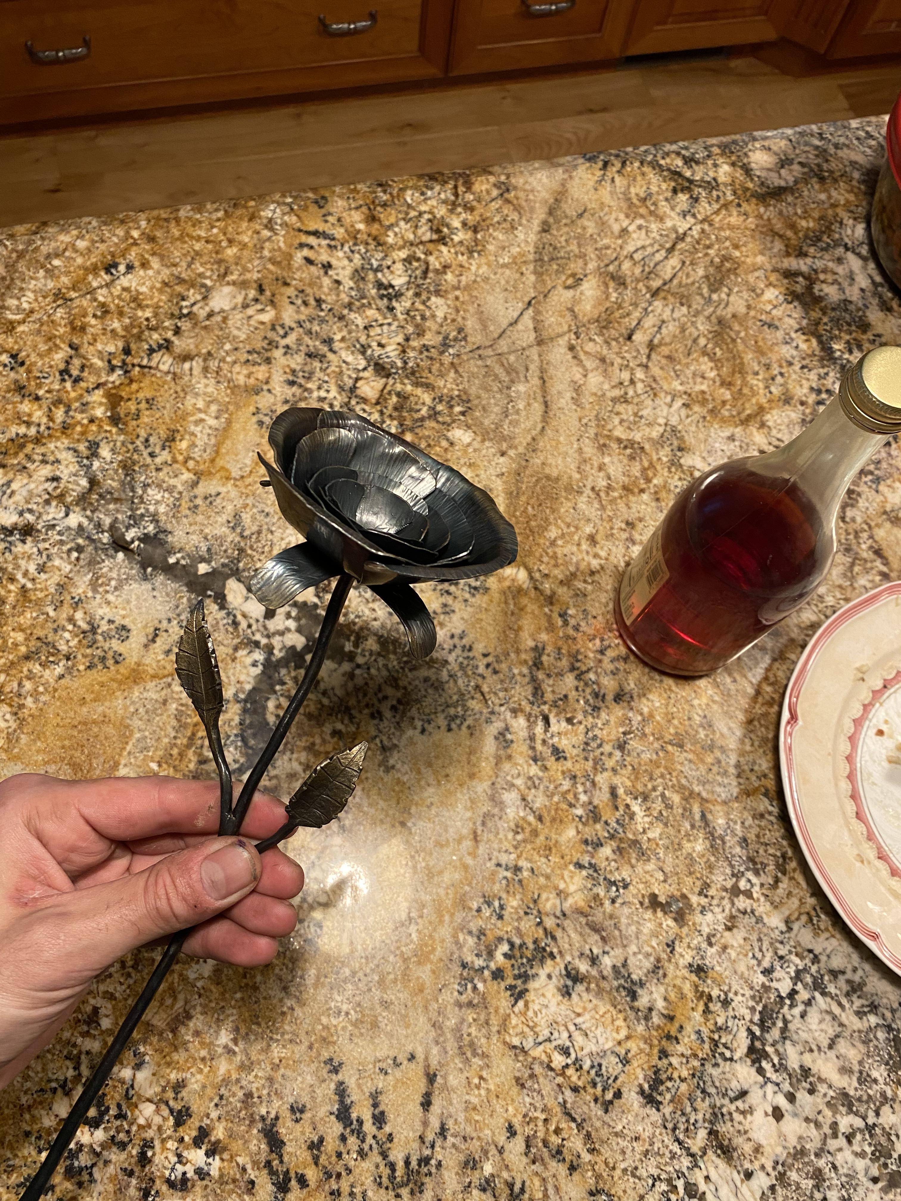

Pat Masterson Posted November 1, 2021 Share Posted November 1, 2021 I should wait until we make it to next page so this isn’t on the same page as Les’ roses but oh well. Same issue as last time setting the river part to hold everything down. Got everything all bent out of whack while trying to do it. I just don’t have a way getting that localized heat - the little 14oz propane torches just won’t do it. Finally used a very small ball punch and pushed down the sides. Had a real nice five point flower type pattern going but ended up ruining it to get it tight enough. Had the leaves and stem in much more appealing positions at first but once I got it here I decided to just leave it alone. All in all I’m not thrilled with it but it’s a major improvement from my last try. I’m sure my mom will like it as her Christmas present. Ended up arc welding the leaves as well. Quote Link to comment Share on other sites More sharing options...

Daswulf Posted November 1, 2021 Share Posted November 1, 2021 Nice Pat, she will love it. Quote Link to comment Share on other sites More sharing options...
ThomasPowers Posted November 1, 2021 Share Posted November 1, 2021 Pat; only 11 more to go! Quote Link to comment Share on other sites More sharing options...
