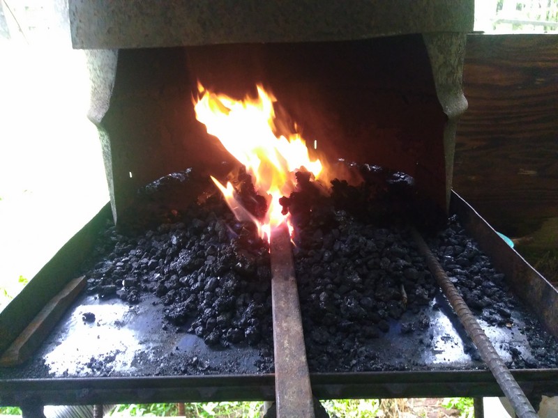

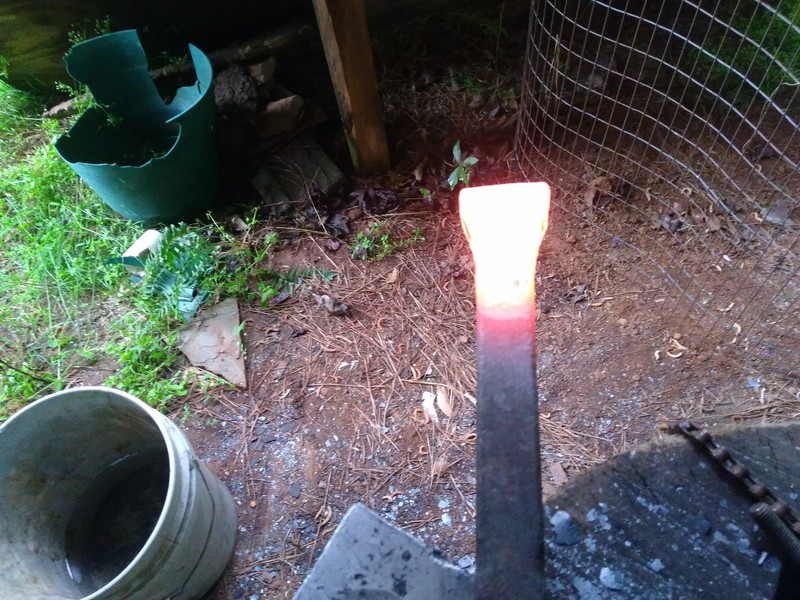

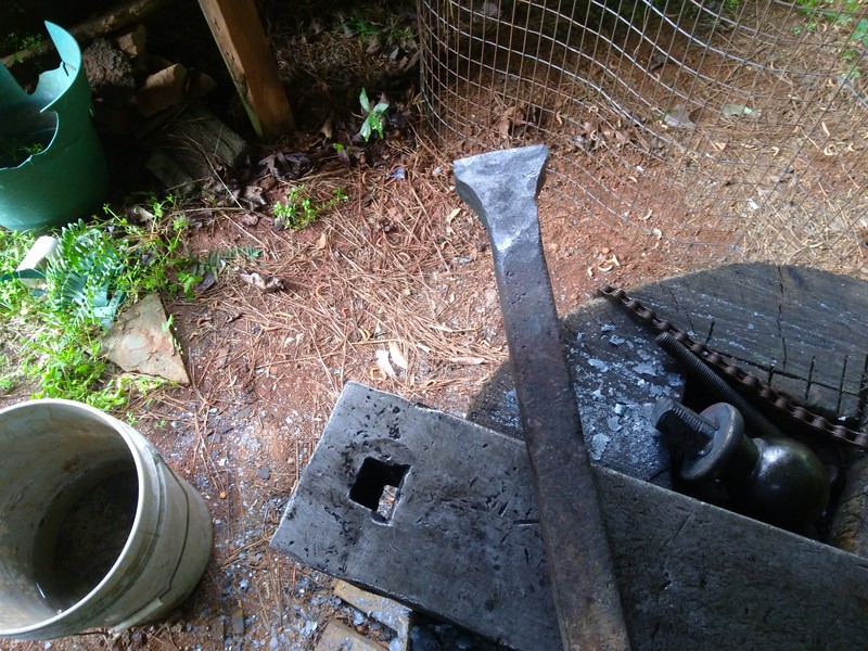

bluerooster Posted May 3, 2021 Share Posted May 3, 2021 I need a post vise. Being not the brightest bulb on the tree, I decided that I want to make one, rather than buy one that needs complete overhaul for $300+. (going rate in these parts) So, I spent the past couple hours at the forge, upsetting and flattening, upsetting, flattening, upset, flat,.... On a chunk of Kelly bar. Pretty much the largest thing I've had in the forge for a while. I got tired of cranking the blower, and my hammer shots started getting off, so I called it quits. Quote Link to comment Share on other sites More sharing options...

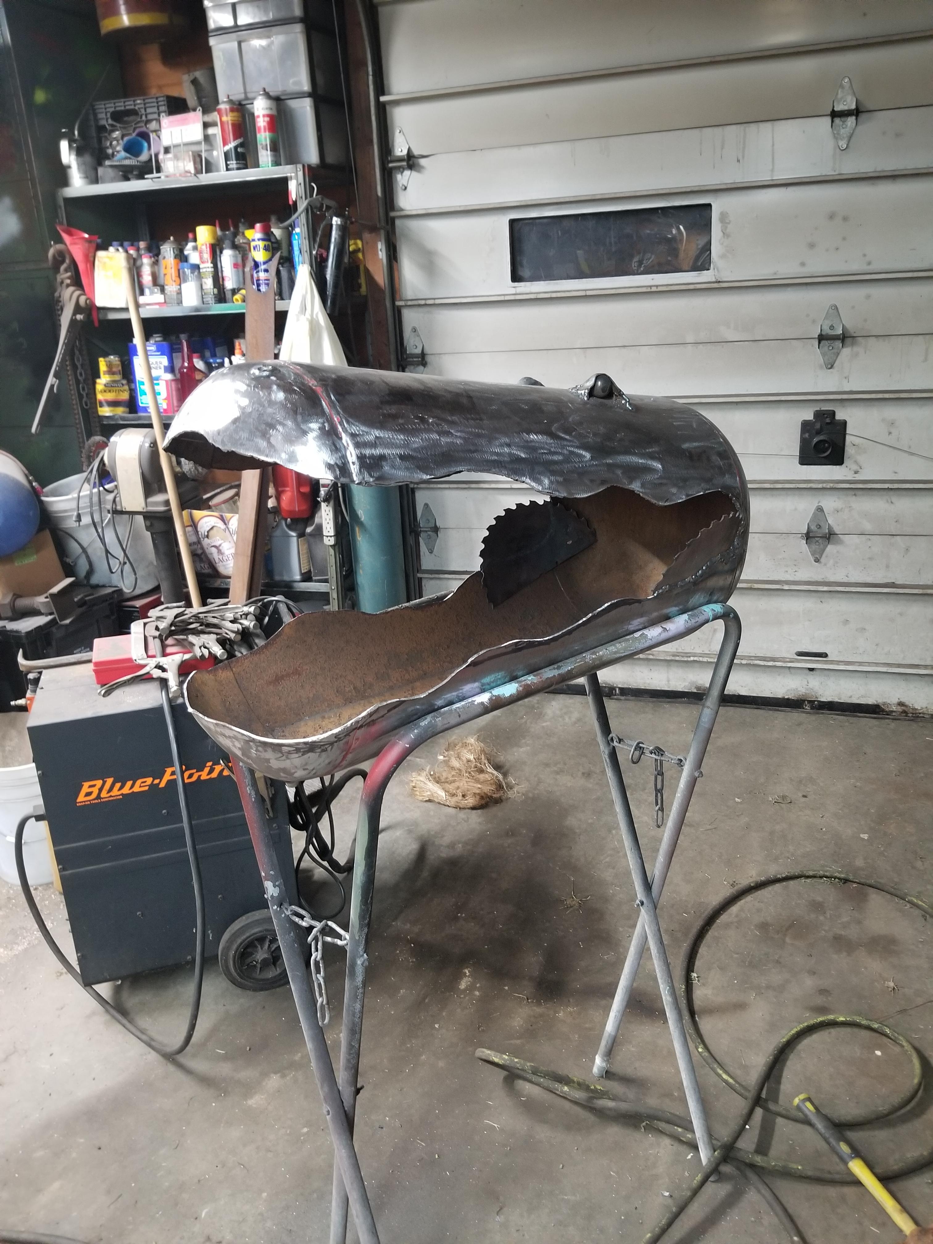

Daswulf Posted May 4, 2021 Share Posted May 4, 2021 Deffinately ambitious bluerooster. I've seen some beautiful miniatures forged but not sure I've seen any forged to size recently other than some fabricated ones. I've been working on grinding some teeth out of rebar for an alligator woodburner commission. It's a little more rushed than I'd like but working out ok. The idea is a large gator head as the burner coming off the ground like it's coming out of the water and opening its mouth. I might do a tail to lay out behind it. I hope once the teeth are in it looks less like a hippo. Ugh. Quote Link to comment Share on other sites More sharing options...

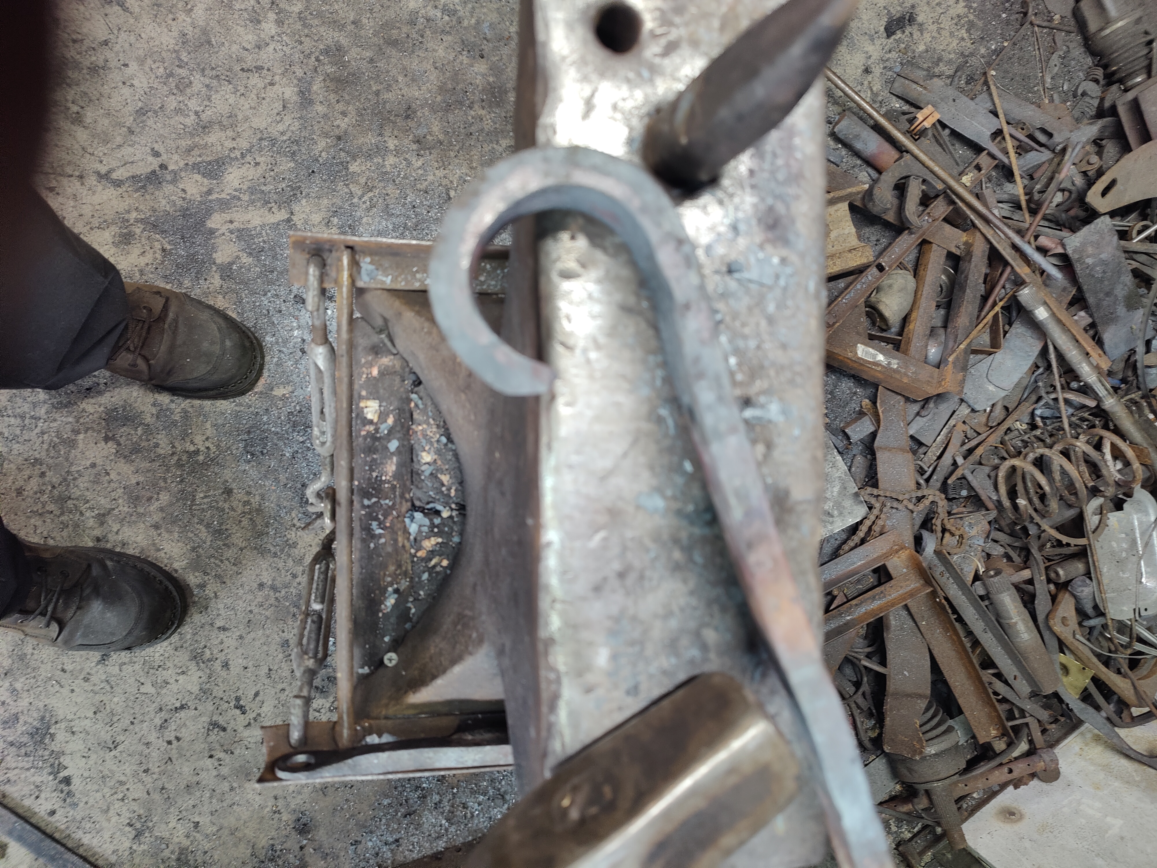

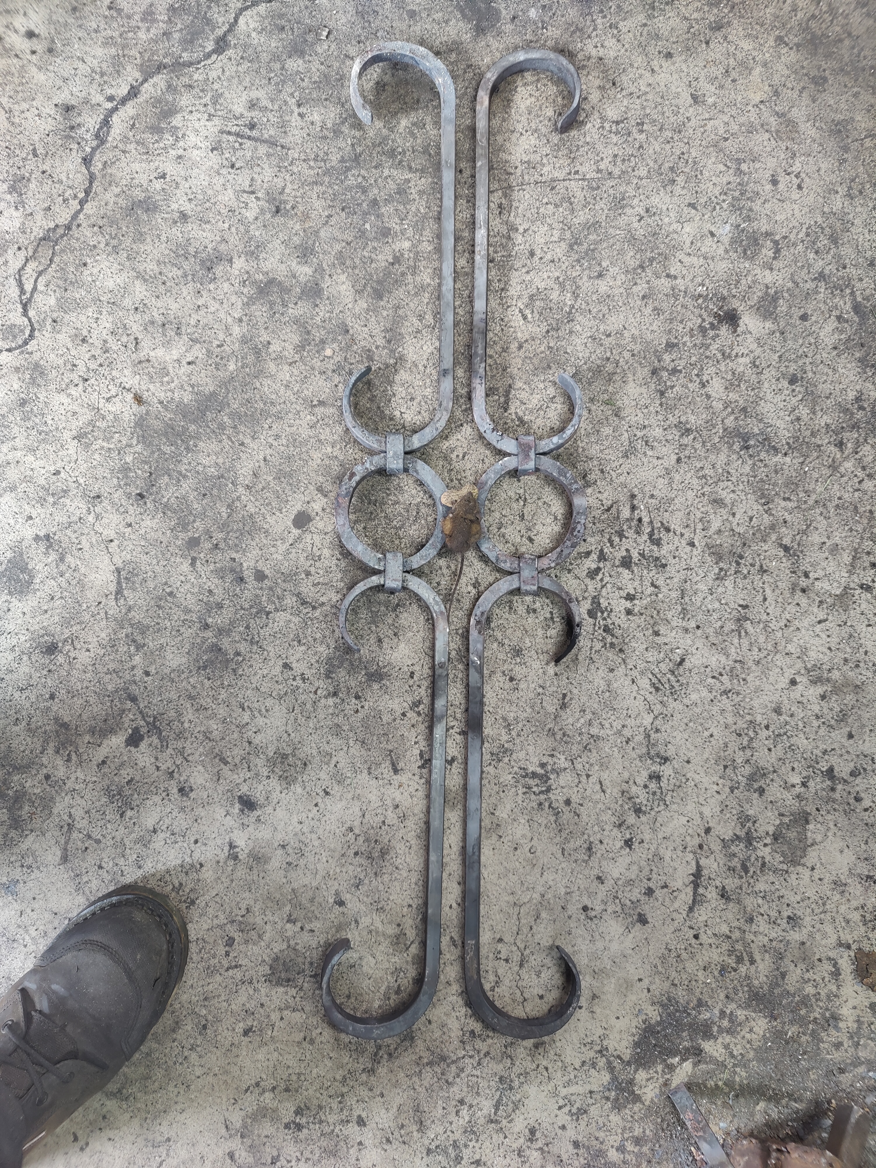

BillyBones Posted May 4, 2021 Share Posted May 4, 2021 Started another coffee table. Needed a better jig for my scrolls out of a little heavier material. The one i have been using i made as a one off for something else and is kind of flimsy. This one is pretty stout. 1 1/4" x 1/2". I also got the bottom supports done and the crossbars. I will start the legs this week. I am thinking maybe walnut for the top, the people i am making it for want a darker wood. But we will see what the hard wood guy has. Quote Link to comment Share on other sites More sharing options...
pnut Posted May 4, 2021 Share Posted May 4, 2021 1 hour ago, BillyBones said: Started another coffee table Looking good. I need to practice collaring. Mine still just don't look quite right. I haven't done very many though so I'm hoping to improve. Pnut Quote Link to comment Share on other sites More sharing options...

JHCC Posted May 4, 2021 Share Posted May 4, 2021 9 hours ago, Daswulf said: an alligator woodburner commission. [...]I hope once the teeth are in it looks less like a hippo. I love the idea, but I see what you mean about the hippo look. Any way to add a gator-skin texture? Quote Link to comment Share on other sites More sharing options...
ThomasPowers Posted May 4, 2021 Share Posted May 4, 2021 Perhaps point the snout more? Quote Link to comment Share on other sites More sharing options...

BillyBones Posted May 4, 2021 Share Posted May 4, 2021 6 hours ago, pnut said: I need to practice collaring I made a jig for doing collars. In one of Mark Asprey's videos on the lvl 4 grille he shows collaring the pieces and i copied his jig. Basically 2 pieces of angle iron that fit the vice with 2 smaller pieces welded on a bit from the edges. This provides a space to shape the collar while supporting the sides and bottom of it. He does make it, like everything else he does, look much easier than it actually is though. Quote Link to comment Share on other sites More sharing options...

Frosty Posted May 4, 2021 Share Posted May 4, 2021 Yes Pau, those are probably Acme threads and are useful for many things, jacks and vises to start with, a slow boat "jaws of life" comes to mind. Bluerooster: Were I upsetting a bar that size I'd put my anvil on the floor and hold the bar vertically and drop or slam it on the anvil. If I couldn't hold it vertically say weight or length I'd set my helpers (stands) to support the bar at the same level as the waist on my heavier anvil and hit the end with a sledge hammer. There's NO WAY I'd hit that thing with a single jack hammer more than a couple times say to dress or adjust it. Buzz, you forgot to list "Bragging Rights" making your own leg vise would be worth some serious bragging rights. Frosty The Lucky. Quote Link to comment Share on other sites More sharing options...
Daswulf Posted May 4, 2021 Share Posted May 4, 2021 4 hours ago, JHCC said: Any way to add a gator-skin texture? I have a few ideas on how to go about that. I've debated pointing the snout more. I also want it more functional as a wood burner. Quote Link to comment Share on other sites More sharing options...
ThomasPowers Posted May 4, 2021 Share Posted May 4, 2021 I was thinking of a sheet metal add on for the snout. Quote Link to comment Share on other sites More sharing options...

Daswulf Posted May 4, 2021 Share Posted May 4, 2021 I see what you're saying Thomas. Quote Link to comment Share on other sites More sharing options...

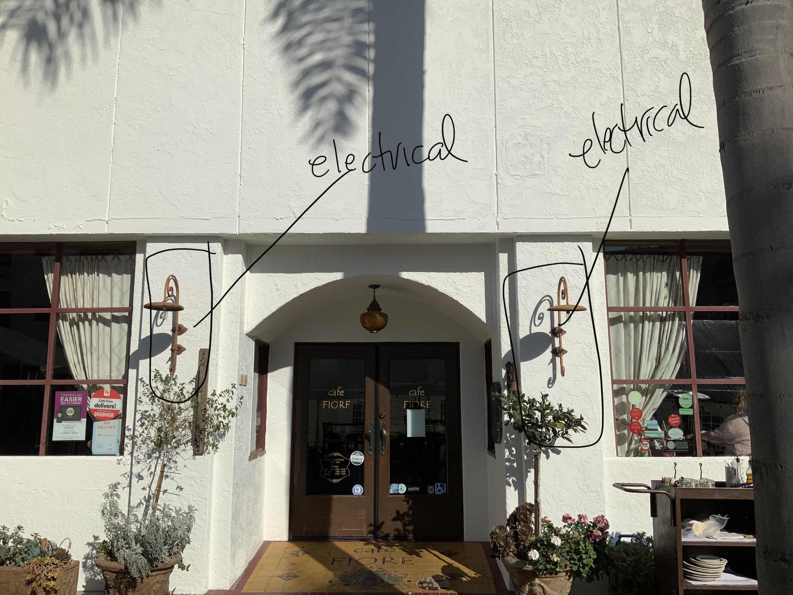

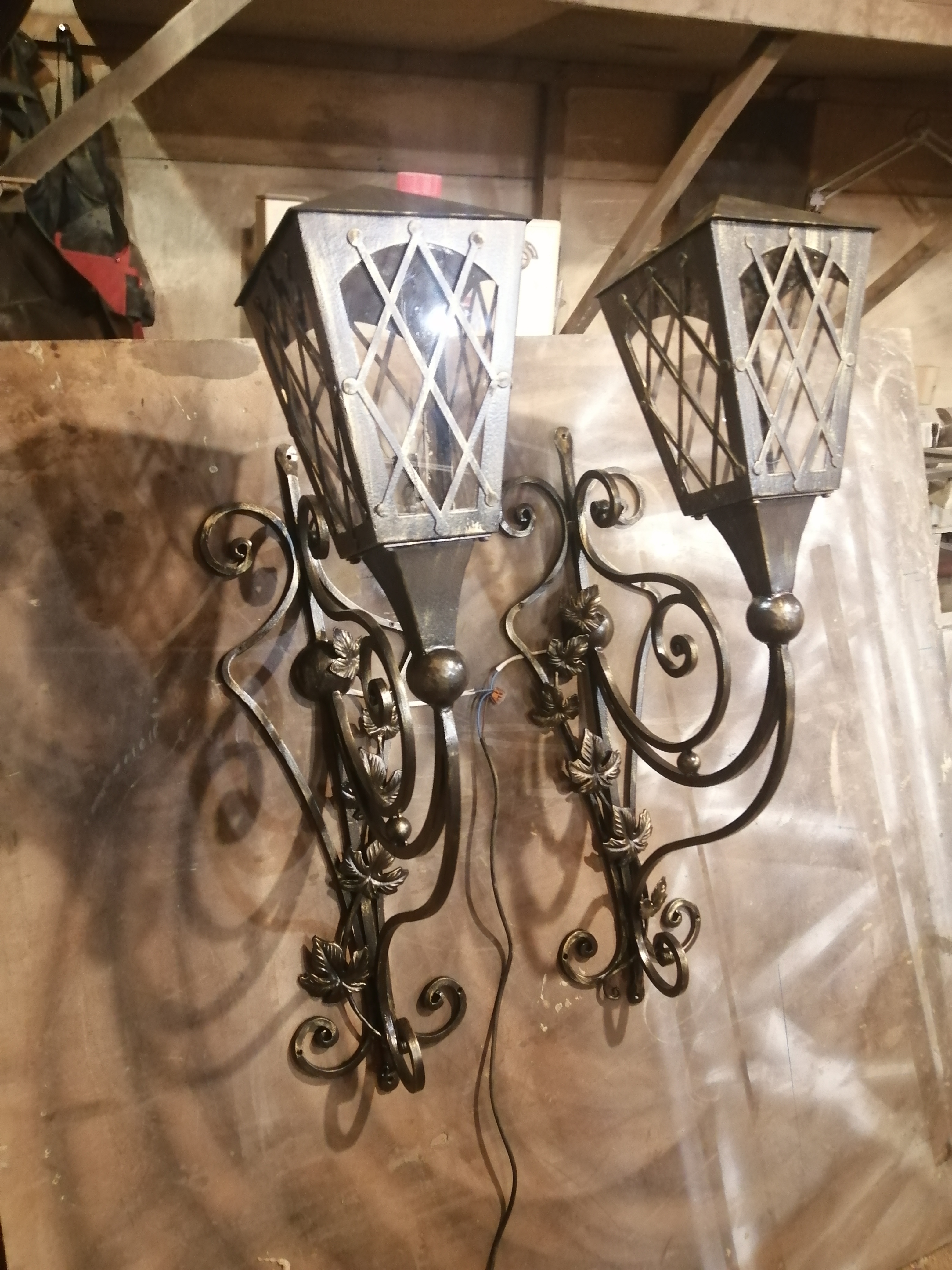

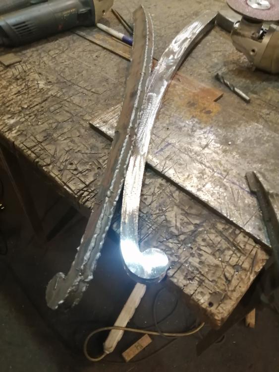

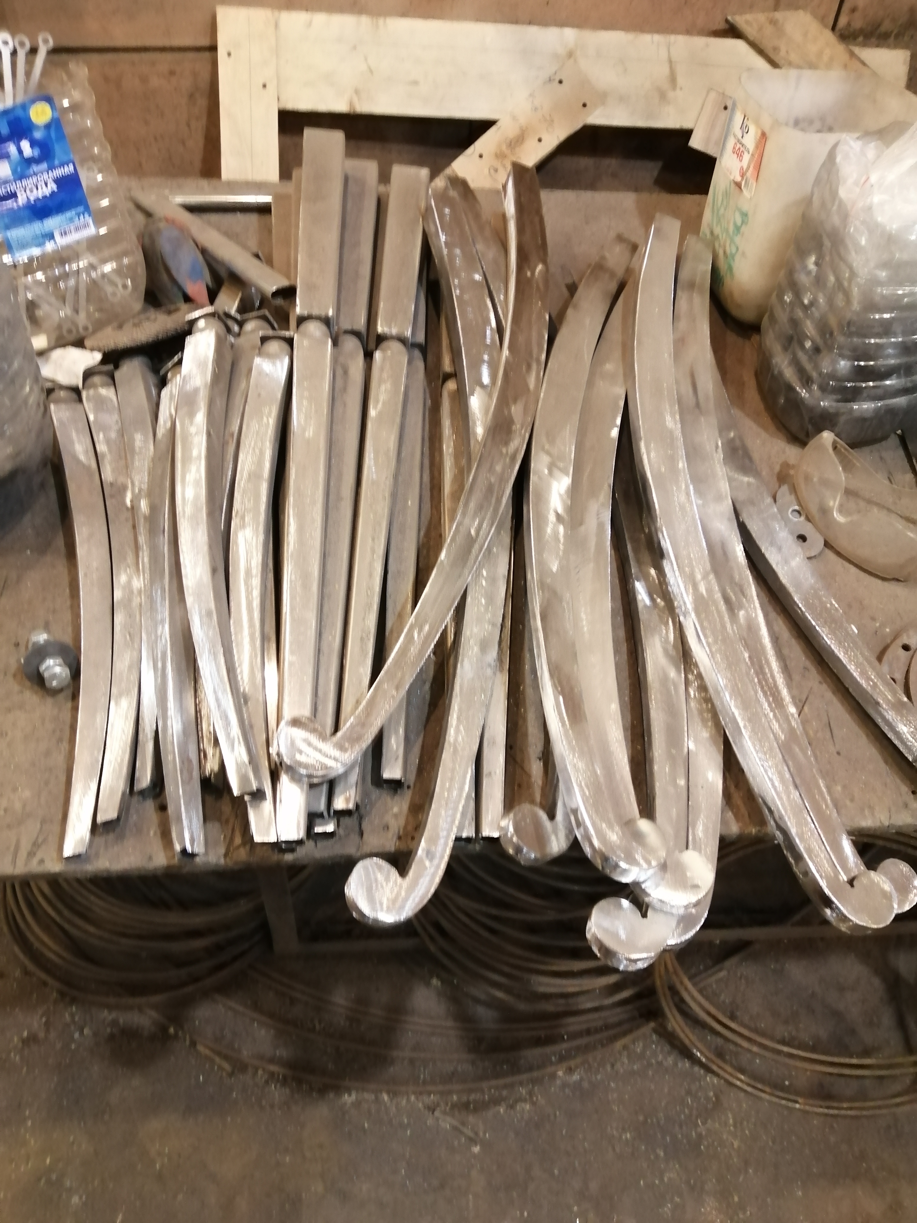

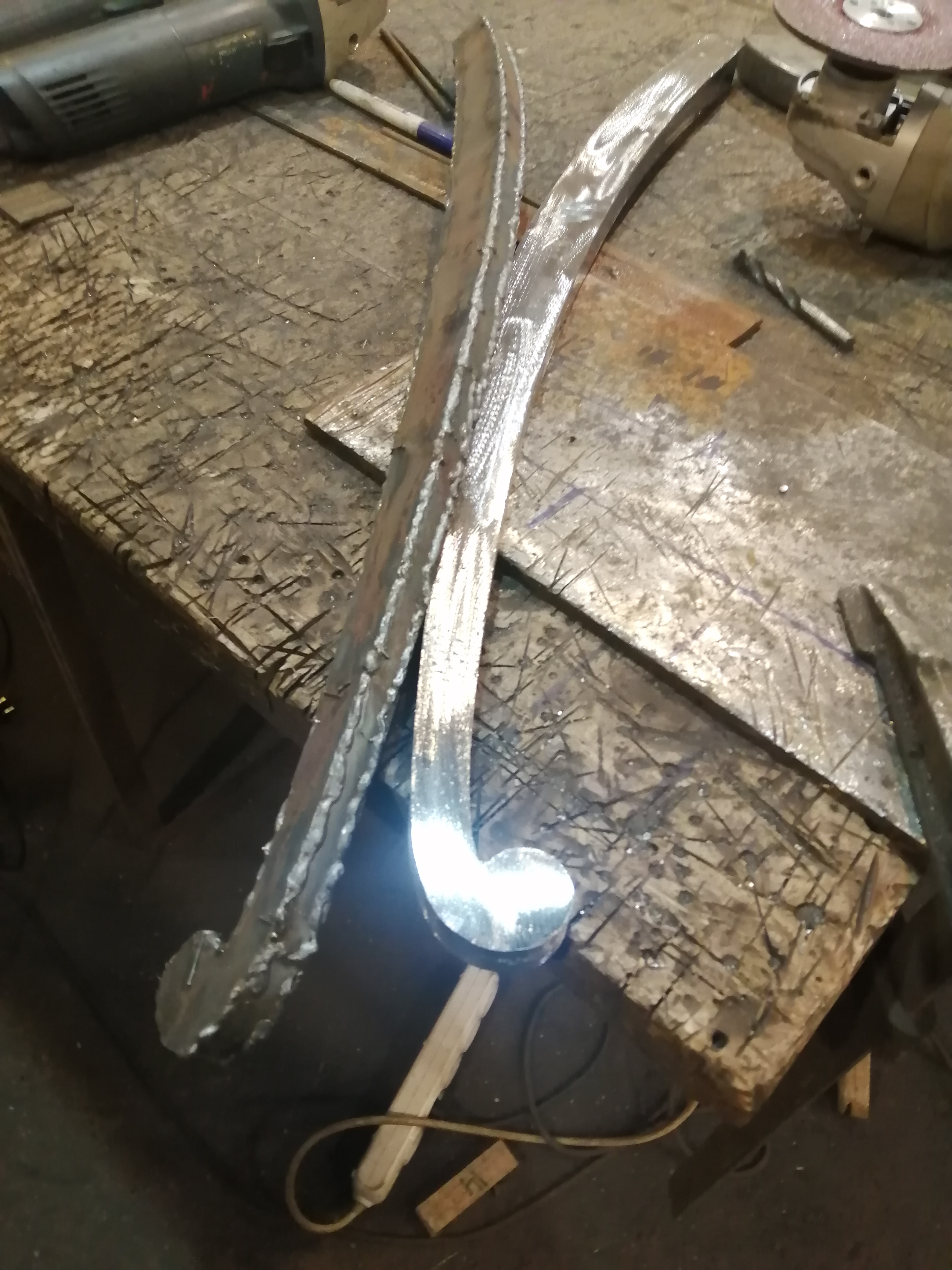

alexandr Posted May 4, 2021 Share Posted May 4, 2021 Completed the lights for a restaurant in Ventura. Finished the nastiest job, cleaned the "legs" for the bar stools. Quote Link to comment Share on other sites More sharing options...
M.J.Lampert Posted May 4, 2021 Share Posted May 4, 2021 wow Quote Link to comment Share on other sites More sharing options...
