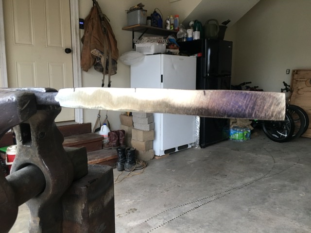

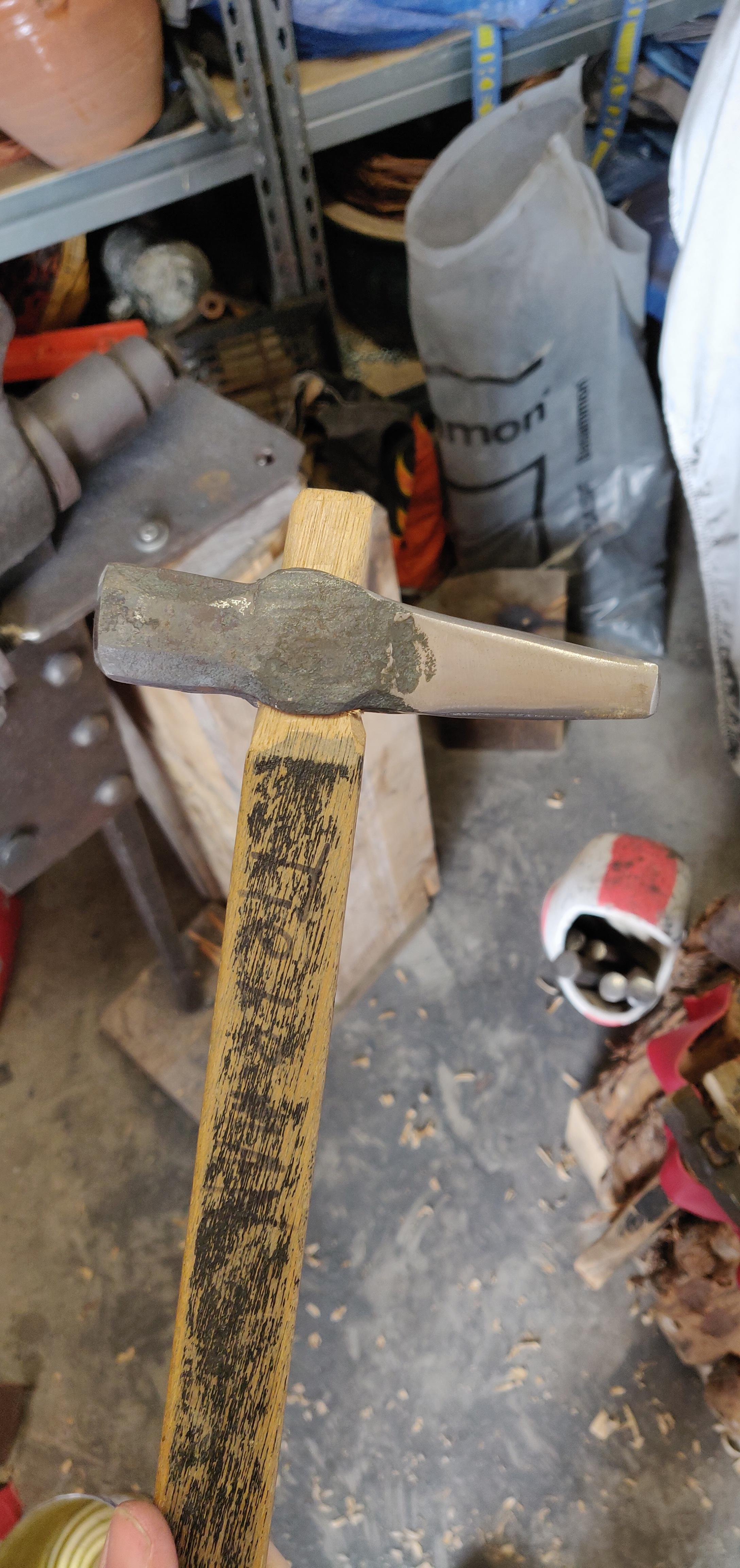

Snapped a picture of the handled eye punch I made on monday.
After hardening I noticed a crack in the punch, after tempering and grinding it was too deep to grind out. I wanted top tools for use with a striker, but I don't think a cracked tool is safe to use. Can I still use it for solo use?

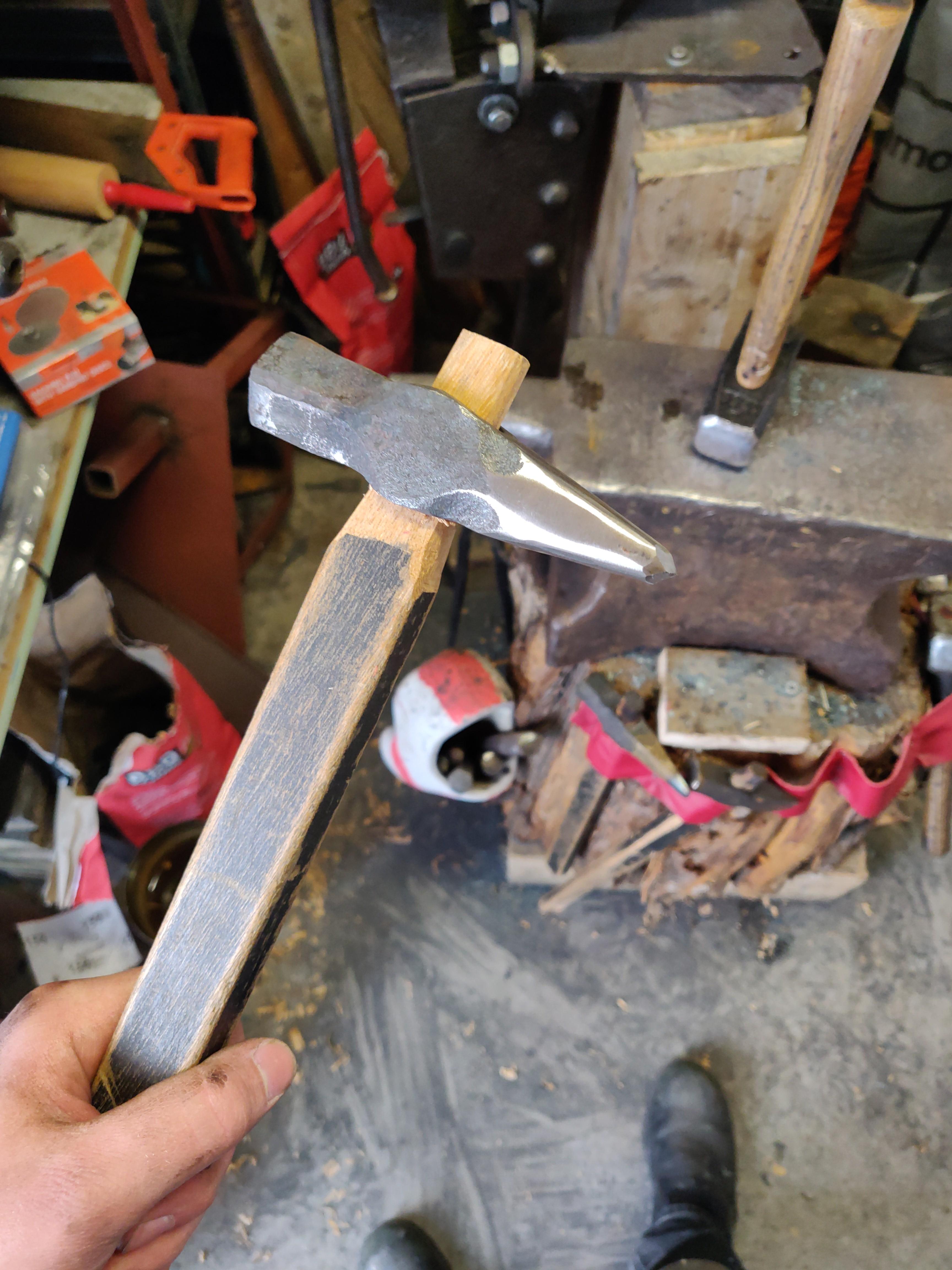

Nevertheless, I finished a second one. Now the punch is perpendicular to the handle, as I initially intended the first one to be. I might have made the punch too thick, but I'm testing it out soon so I'll see if I need to forge it thinner.
~Jobtiel
It's not, and No.
Put it this way: what in your shop would you be okay with having damaged when a cracked tool shatters under a sledgehammer blow and sends shrapnel in all directions?
(On the bright side, the quality of your forging appears to have improved from the first punch to the second. I would suggest leaving the second one alone and making a third if you need a smaller one.)
JHCC, Thanks! I'm really starting to feel the improvement during forging compared to when I started.
I thought so, I have used the first punch to make the second, so that'll be it's first and last time being used. I thought of just making a new one too, as the second one cost me maybe 1.5 hours of forging. and the thicker punch might be useful when working thicker stock. my concerns are that it'll leave too thick a hole for 27 mm (1.06 inch) hex stock, which is what I make all my top tools from.

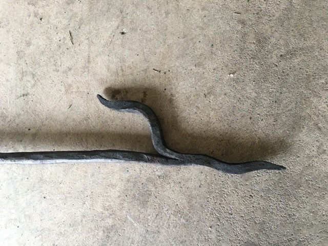

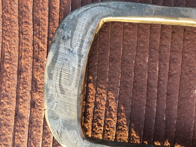

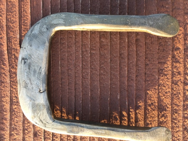

I made my first and second successful attempts at "Damascus".
The beginnings of a belt buckle was chainsaw chain. The bar is from 1 1/4" cable.

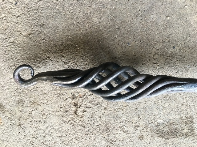

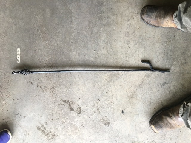

I also finished up a fire poker. The basket is 7 rods. And the whole thing has 5 forge welds in it. I'm really enjoying learning how to weld!

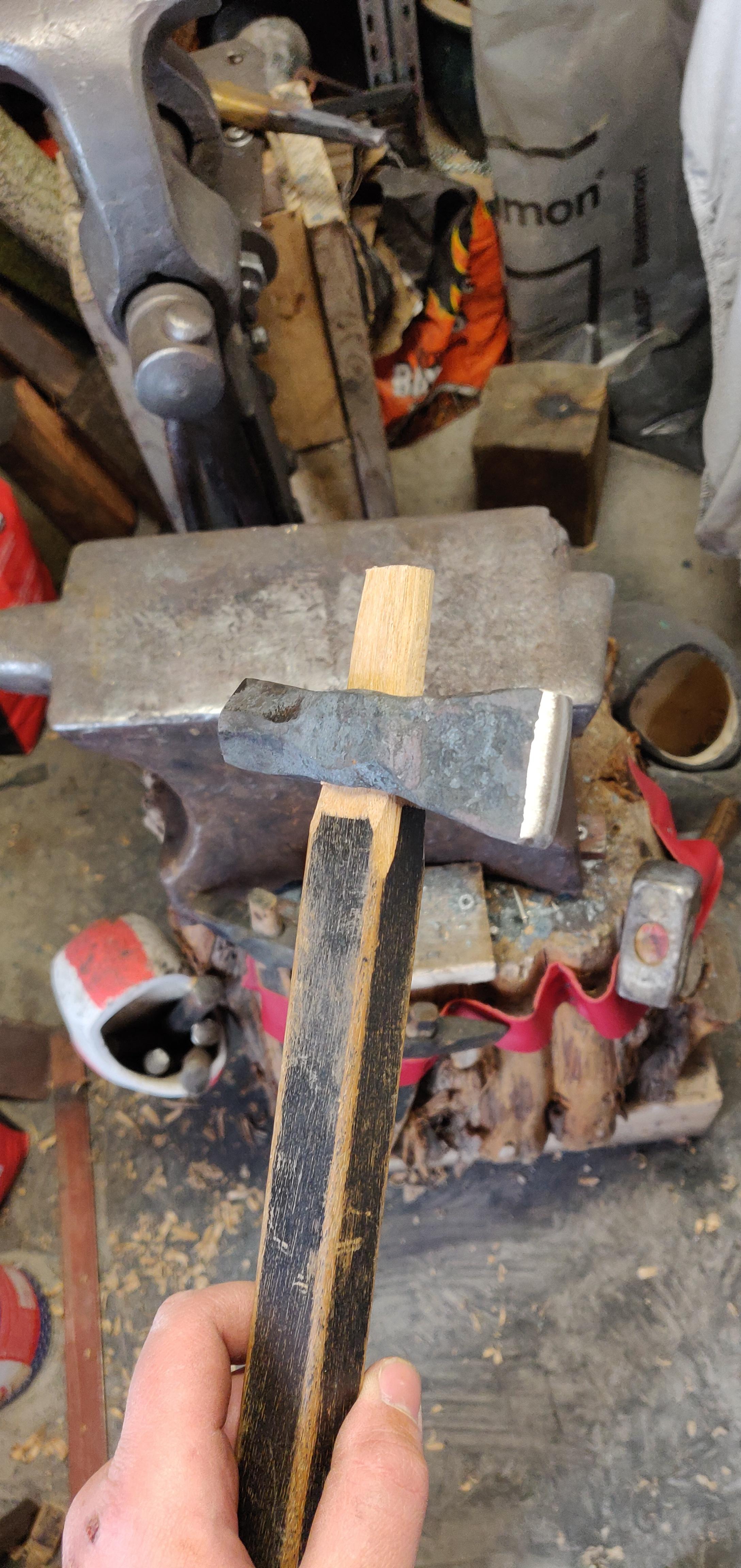

So today I forged a top fuller, using the eye punch I finished up yesterday.
It works well enough, but the slug teared in the middle instead of the sides when punching the eye, was this my mistake of leaving too little mass for the slug? Or should I grind the eye punch to have a less sharp point or forge it smaller like the previous ones I had, which all worked fine?
nevertheless, here is the picture, I don't like the striking end, so maybe I'll throw it back in the forge and tidy it up. It works great!
Looks like a good top fuller to me. The nice thing about making your own tools is you get to make them however you want!

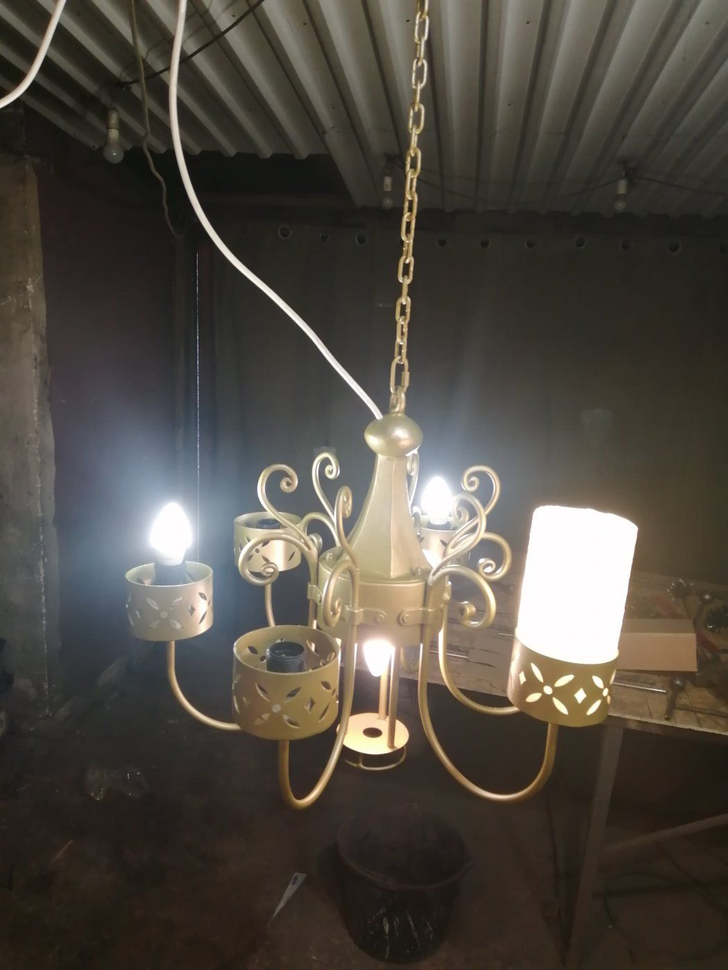

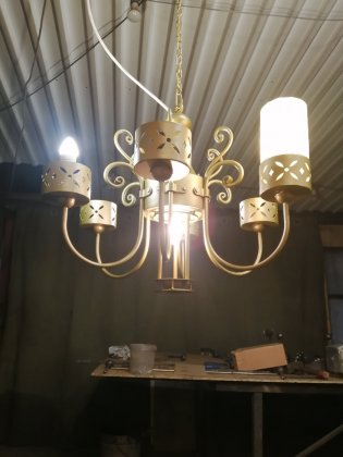

Another new chandelier. It remains to install.
That's kind of a small chandelier for you isn't it Alexandr? It's beautiful but we've come to expect your chandeliers to be dining room table sized.
