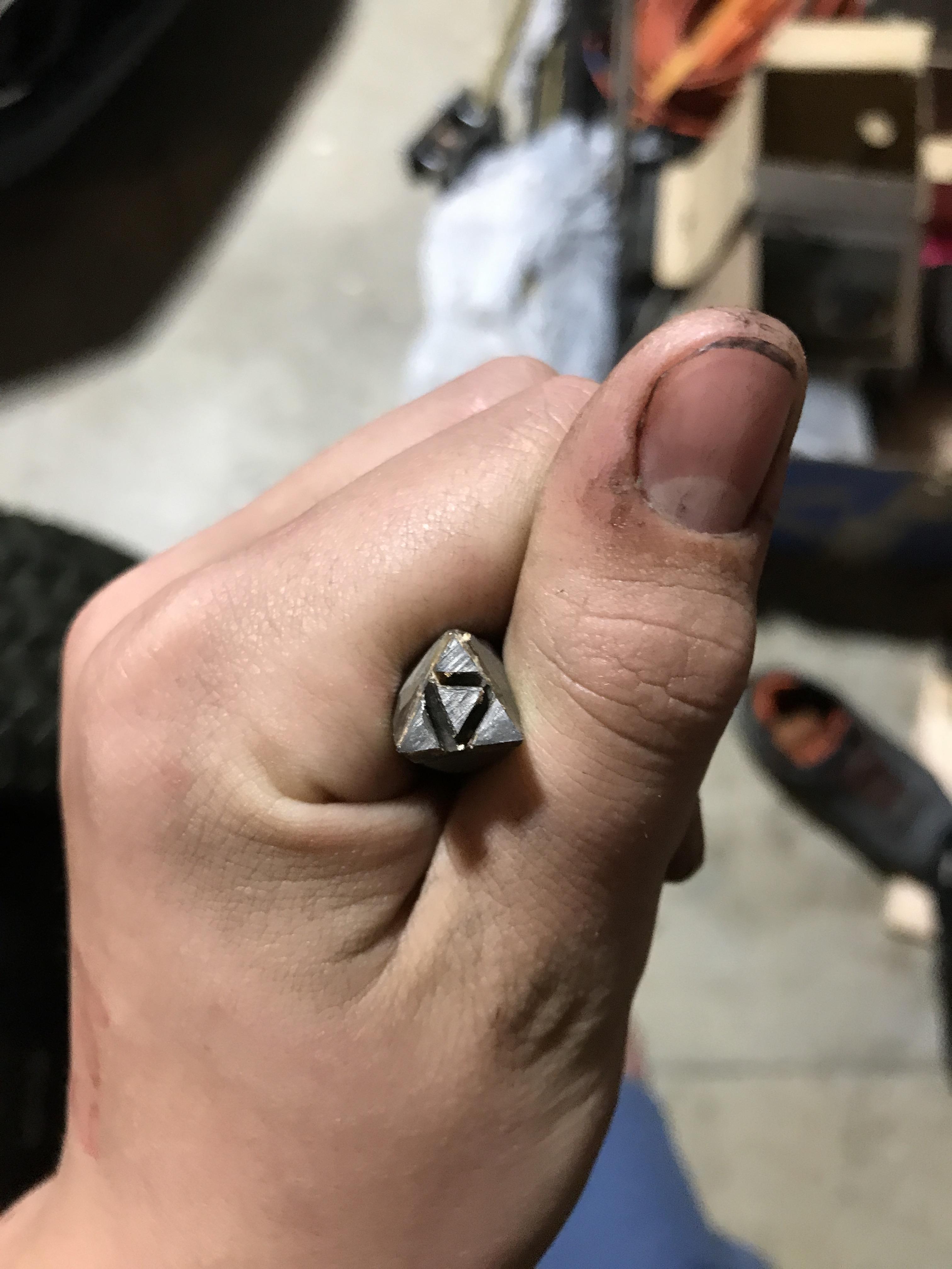

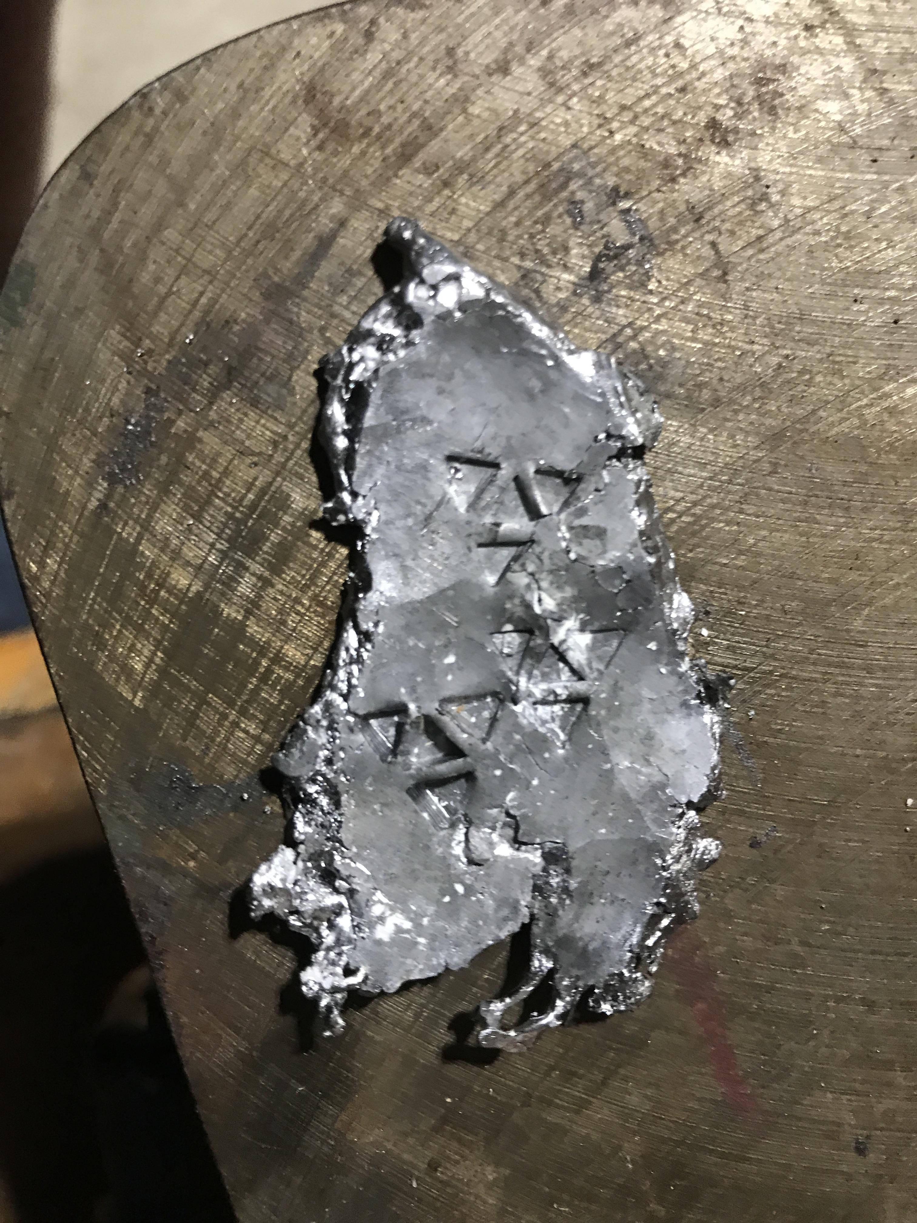

Chimaera Posted April 28, 2021 Share Posted April 28, 2021 I made a touch mark! Not the design I wanted, but one I like. A2 tool steel. Need to heat treat and polish. First tests in lead are promising. Link to comment Share on other sites More sharing options...
arkie Posted April 29, 2021 Share Posted April 29, 2021 Tool steel is pretty hard untreated. No need to heat treat it. After several strikes on hot steel pieces or double-strikes 'cause the first one wasn't deep enough, the temper probably will be gone. My touchmarks are just coil spring with the design, no heat treatment, and they have been working for me for years. Link to comment Share on other sites More sharing options...
Chimaera Posted April 29, 2021 Share Posted April 29, 2021 Alright. I’ll just polish up the face a bit (it’s really rough) and call it good. Link to comment Share on other sites More sharing options...

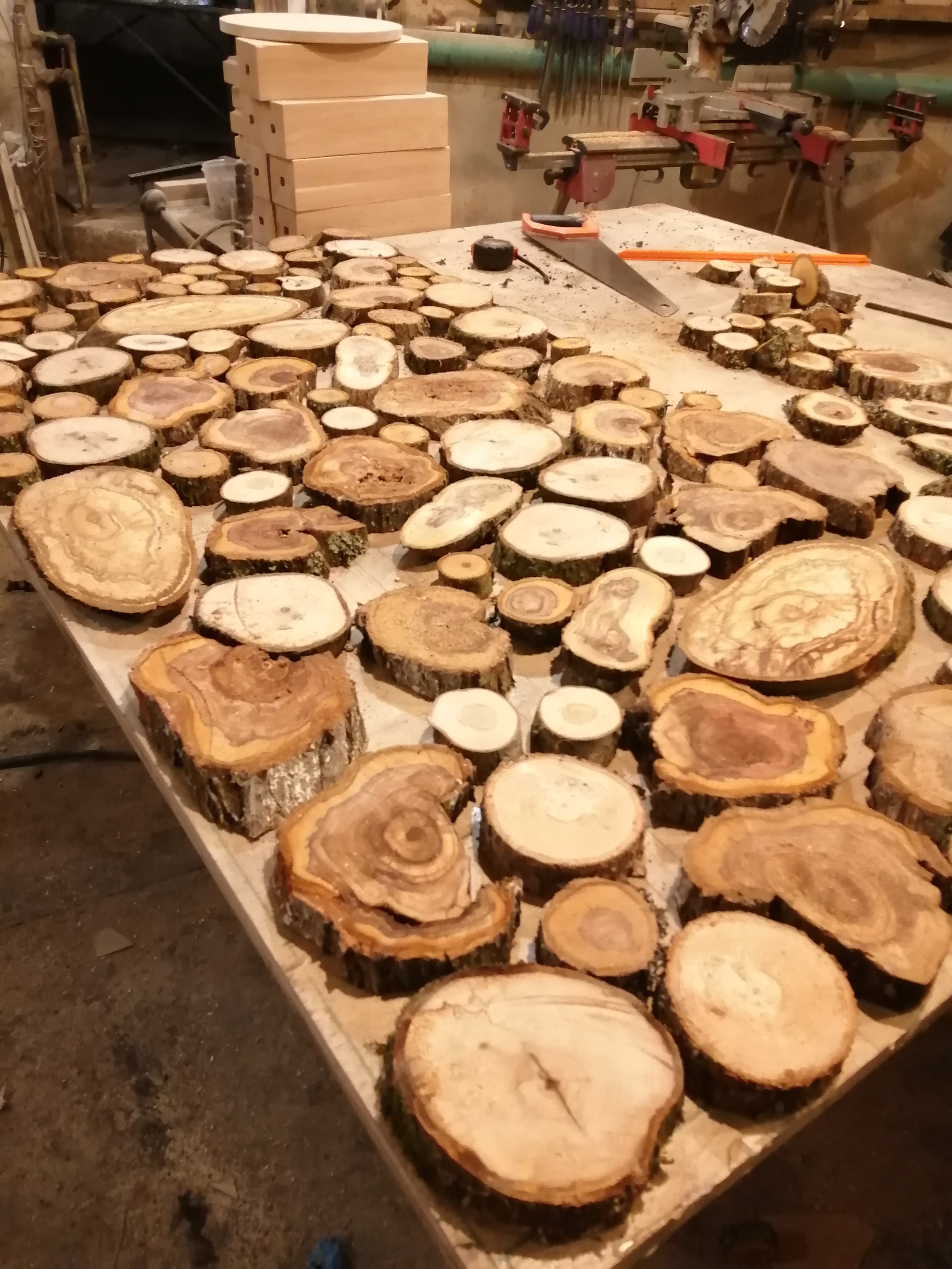

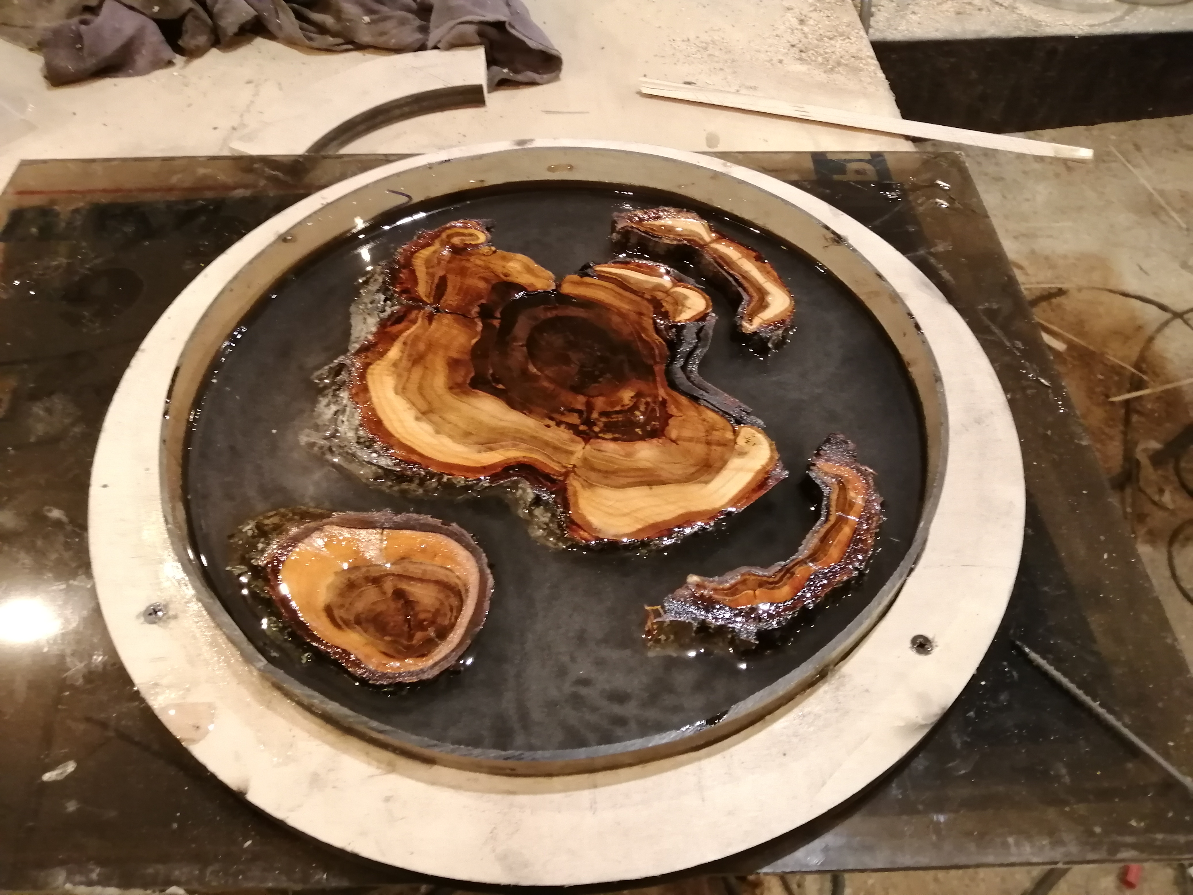

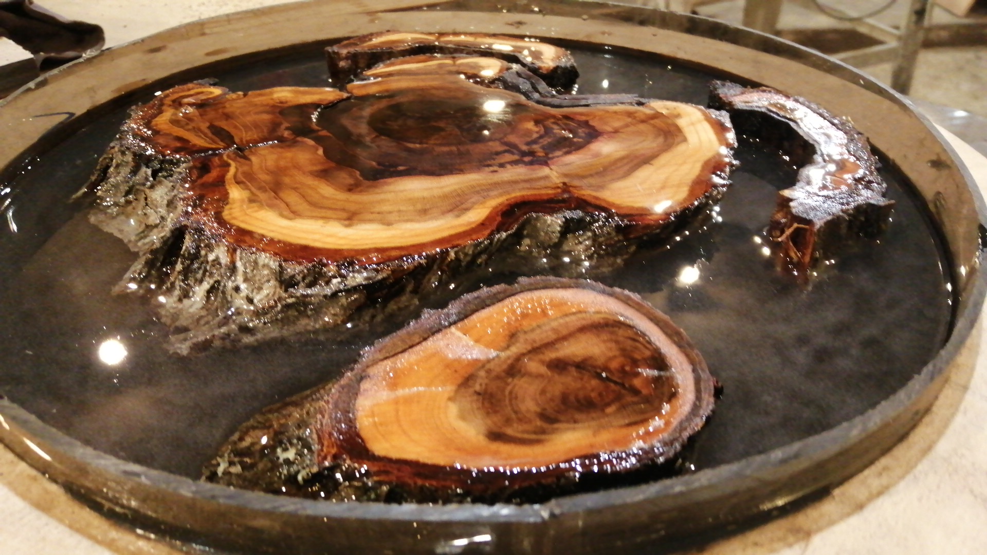

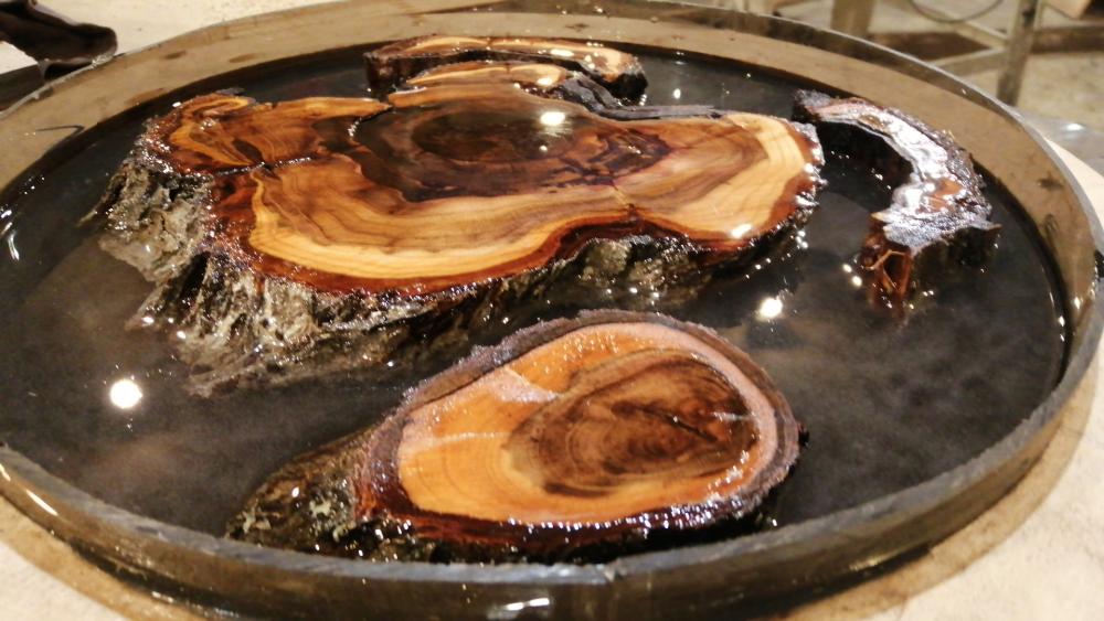

alexandr Posted April 29, 2021 Share Posted April 29, 2021 Ordered an epoxy table. I decided to start training on the clock. Link to comment Share on other sites More sharing options...
Chimaera Posted April 29, 2021 Share Posted April 29, 2021 Looks great! What wood are you using? I love the different colors between the sapwood and heartwood. Link to comment Share on other sites More sharing options...
Goods Posted April 29, 2021 Share Posted April 29, 2021 Be careful with A2 for a struck tool. If I remember correctly, it’s an air hardening tools steel. Personally, I’ve wondered what the best way to deal with air hardening tool steels in this type or application. Hopefully, someone here with more experience with give some direction... David Link to comment Share on other sites More sharing options...
Chimaera Posted April 29, 2021 Share Posted April 29, 2021 It is air hardening. It is by no means soft, but I don't believe it will shatter when hit. I've made a few chisels and punches from it with no issues. The only reason I have it is that it was dirt cheap, and I thought it might work for chisels and kiridashis. Link to comment Share on other sites More sharing options...
