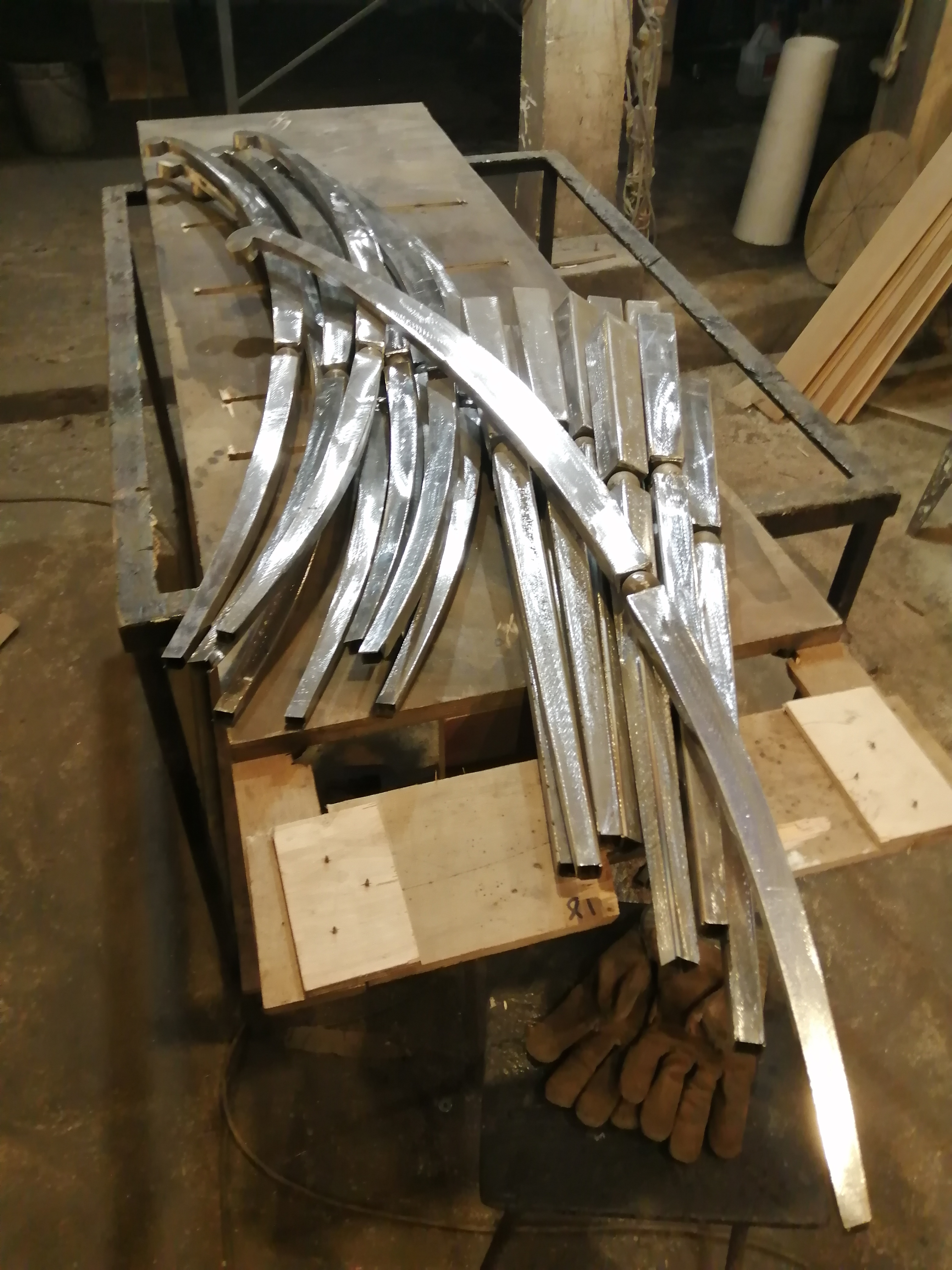

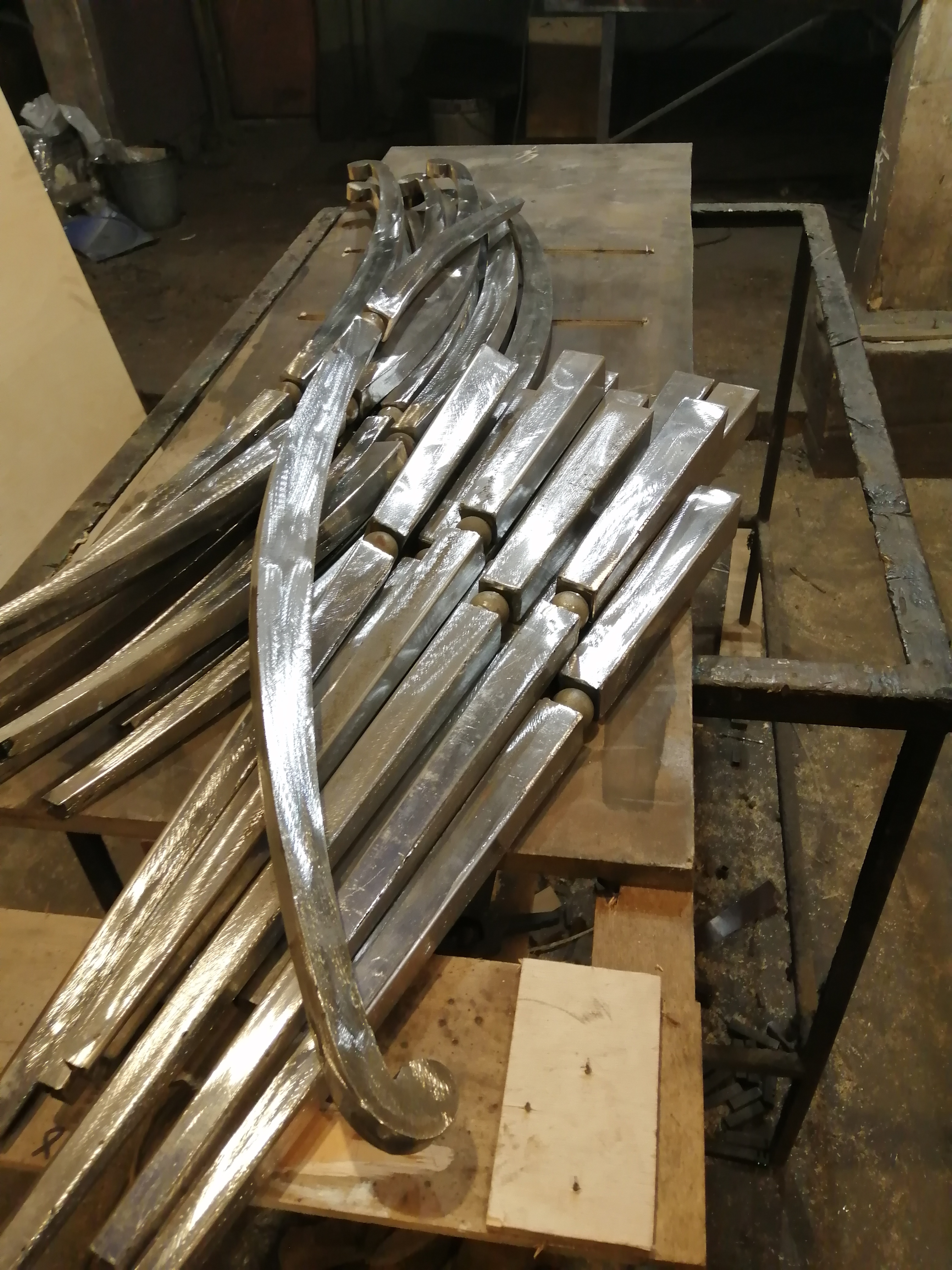

Finally I finished the "legs" on the bar stools.  Hard work.

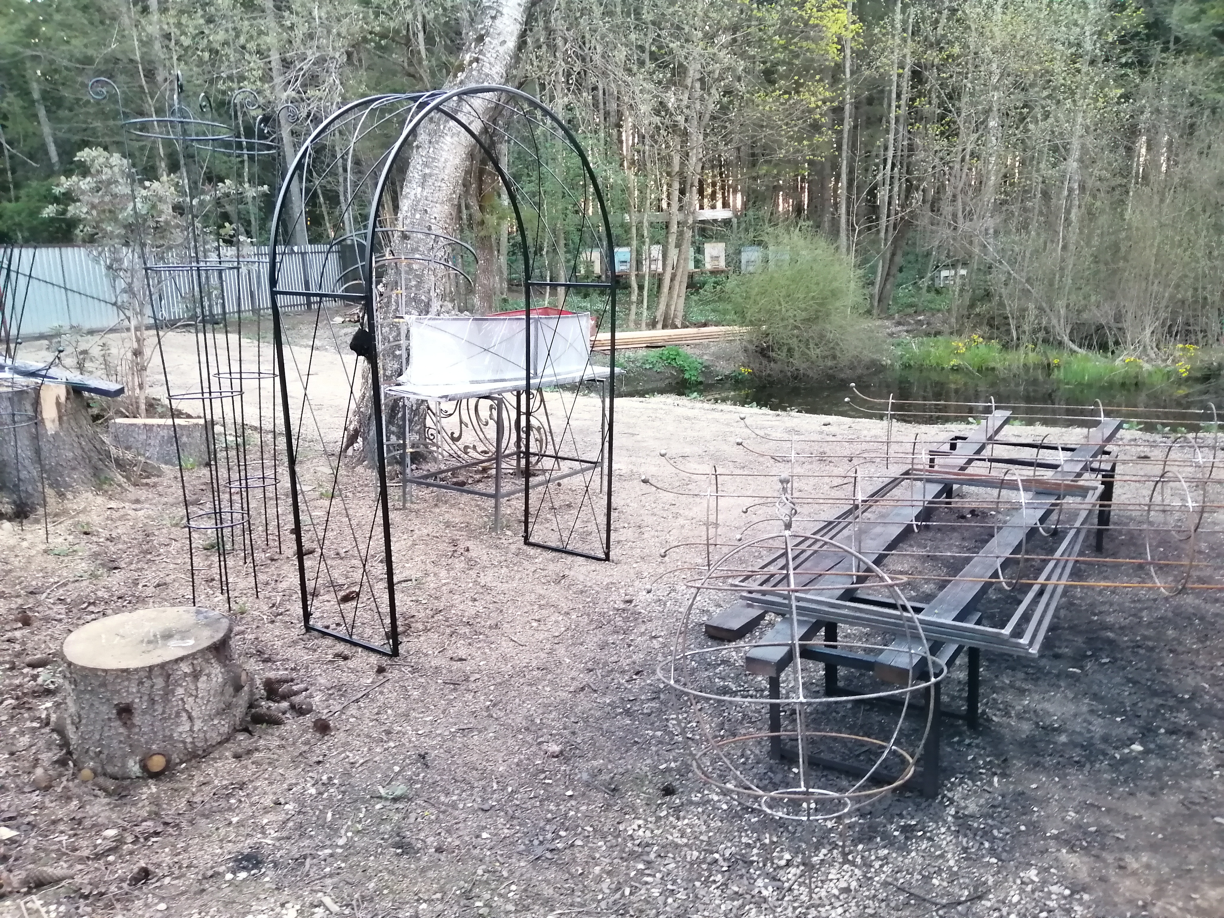

And start to make a table. The customer really liked it.

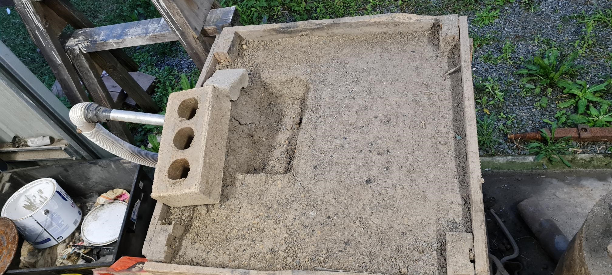

Here's one of the re-shaped fire bowl from before I fired it up. I'll try to remember to get a pic of the split bar. It was literally a half hour session just to forge again!
9 hours ago, Frosty said:
How did your JABOD work for you, better, worse, about the same? Hmmm?
Much better! a more defined "one-brick-size" shape to the fire bowl, a slight downward angle to the tuyere and a had a little bit of a sparkler much faster than expected on my second heat. You can just see the tuyere...right at the bottom of the big crack...<_< The bricks are partly to bank charcoal against and partly to stop the tuyere from breaking all the way out!
Looks pretty believable JABOD you have there Jono.
If / when you rebuild it again I'd suggest moving the fire back a little farther from the edge. This will put more insulation between fire and wood box and lessen the leverage the tuyere pipe has on it so you won't need the brick to hold it down.
Next pic should have fire and steel making out in it. :)

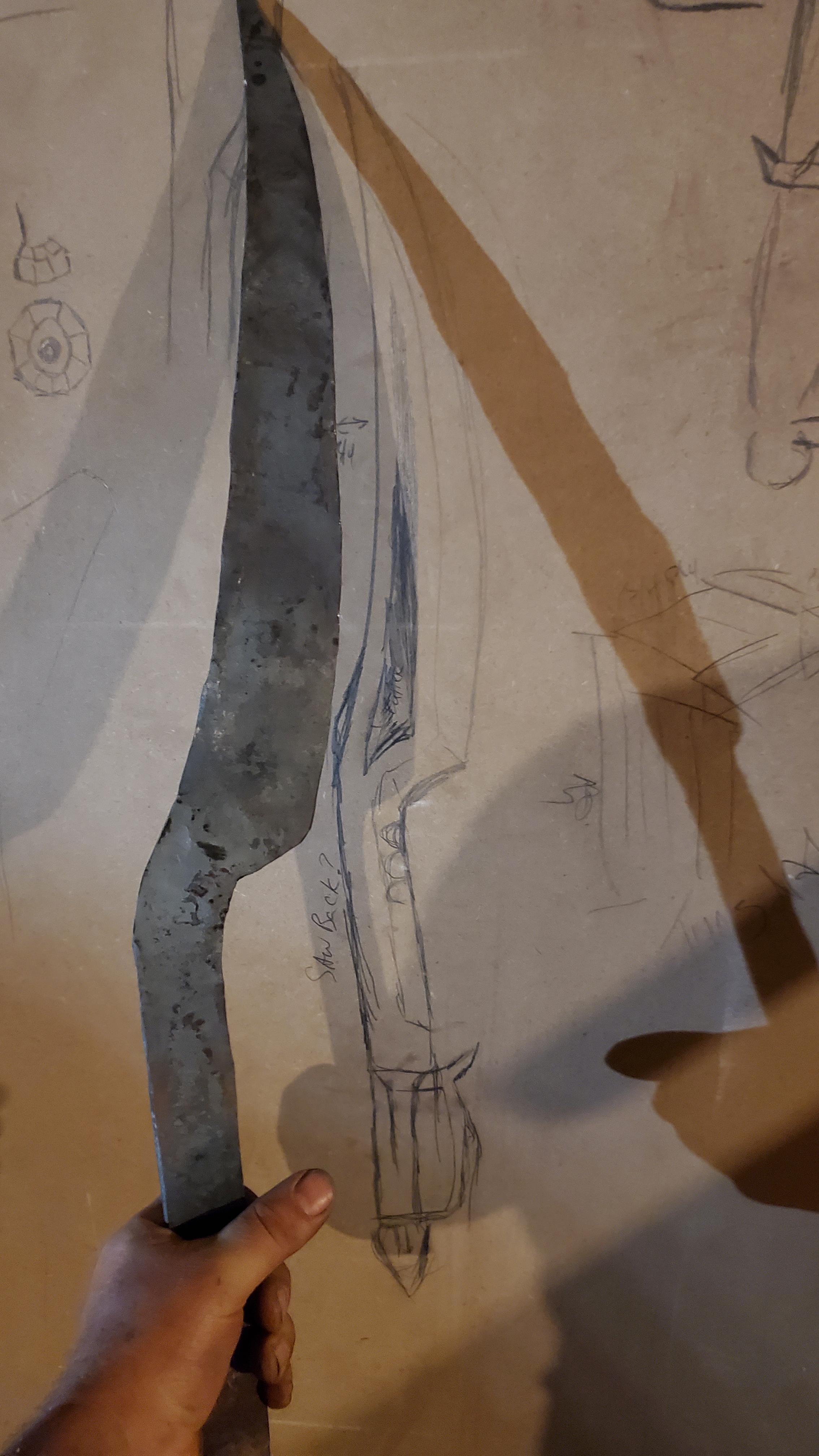

I started this the other day and this is actually my second attempt at this design as the first tore at the handle and is now going to be 2 smaller knives and a razor.  This design has really challenged me and made me think about how v to get the metal to move to where I wanted.   I still cut the blank too big, gonna be some serious grinding later to keep my shape.  I was going for post-apocalyptic shape.  Right now it's about 26 inches long and I have work to do on the lower part of the blade and the tang.  I'm happy with how it's forced me to think about what I'm doing.
