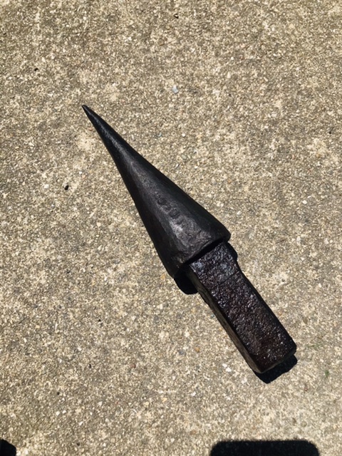

Goods Posted May 8, 2021 Share Posted May 8, 2021 I went to our hammer in today and had a good time in the forge with the other guys. Made a hardie cone and while I wasn’t real happy with it, I stopped before I over thought it and ruined it. Could have used one at the forge during the demo two weeks ago, so I put both the shops touch mark on it as well as my own. It will be there next time someone needs it. 52100, hot rasped, wire brushed and just normalized with beeswax for some rust prevention. Keep it fun, David Quote Link to comment Share on other sites More sharing options...
Irondragon Forge ClayWorks Posted May 8, 2021 Share Posted May 8, 2021 That's a good looking cone. Quote Link to comment Share on other sites More sharing options...
Jobtiel1 Posted May 8, 2021 Share Posted May 8, 2021 Great looking tool! Quote Link to comment Share on other sites More sharing options...
BIGGUNDOCTOR Posted May 8, 2021 Share Posted May 8, 2021 BillyBones, Vernors Ginger Ale is the best I have had. It used to be aged 5 years in oak barrels, then 1, now it is probably just poured over an oak plank, but still excellent. I also like a good sharp ginger beer. Goods, why 52100 for the cone? Quote Link to comment Share on other sites More sharing options...
Goods Posted May 9, 2021 Share Posted May 9, 2021 Honestly, because it’s readily available to me. Part of the regular PM’s for stamping dies at work I’d to change the guide posts (high tolerance parts). I can get them in different diameters and lengths. When I first looked up the specs, I thought they were 1045, so made a ball pein hammer from one and water quenched it. That didn’t go well! So I double check and I was wrong, was 52100. 52100 may be a bit excessive for for a cone, but I figured it would make a durable one and be a reasonable use for this material... David Quote Link to comment Share on other sites More sharing options...

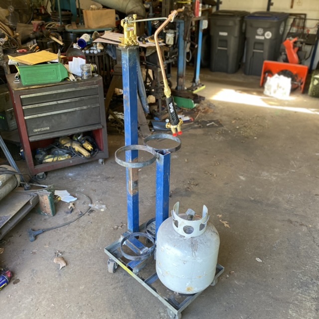

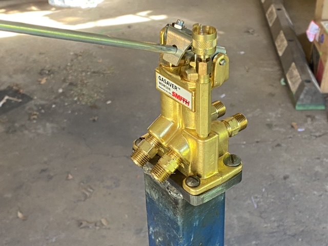

JHCC Posted May 9, 2021 Share Posted May 9, 2021 Welded up a combination welding cart/torch stand and attached the gas saver. Still need to get a cylinder or two of oxygen and figure out a control pedal. I’m also thinking that some kind of retractable feet to keep it from moving around in use would be a good idea. Might get a larger tank of propane at some point too. Quote Link to comment Share on other sites More sharing options...

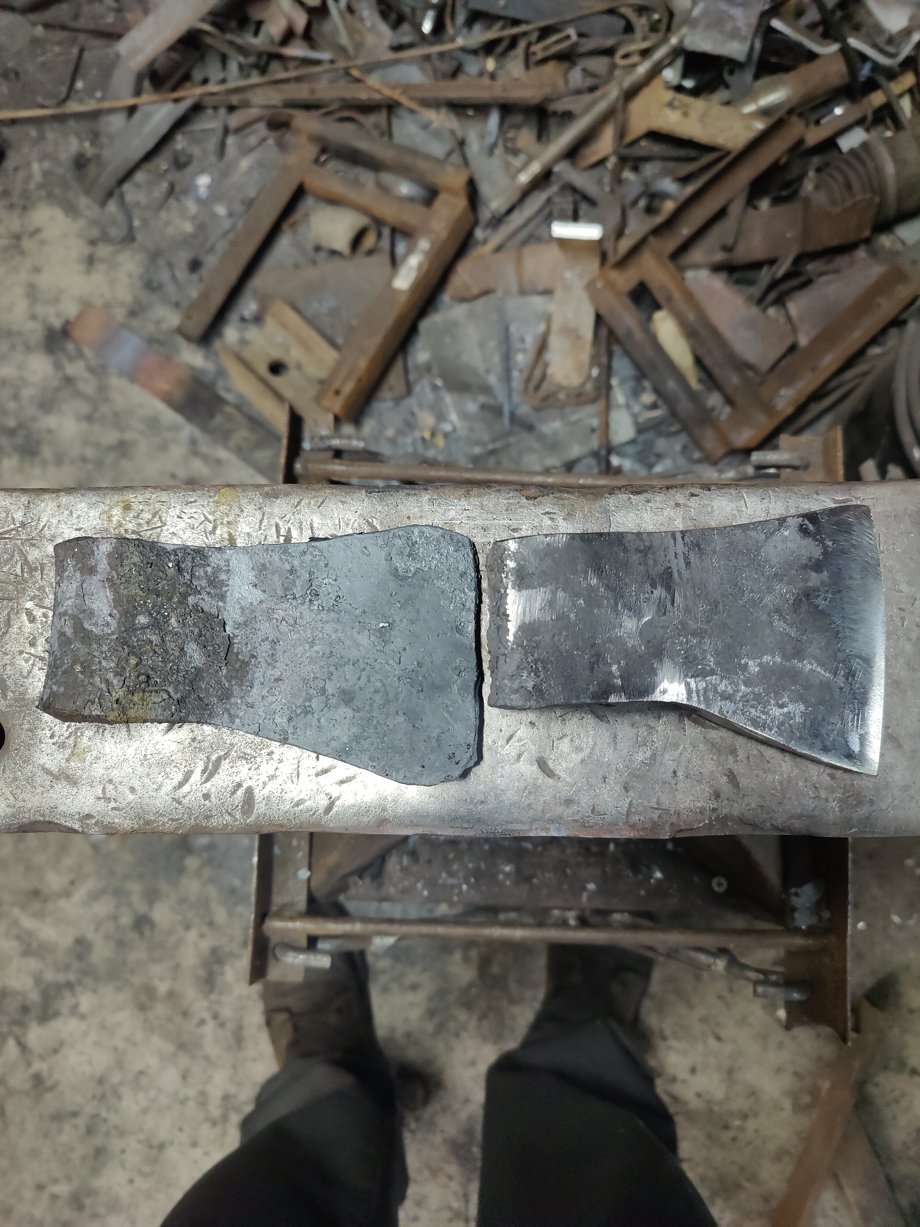

BillyBones Posted May 9, 2021 Share Posted May 9, 2021 8 hours ago, DHarris said: made something to hold a trash bag open Minions, that is what minions are for. Got an order for a couple hatchets, a while back ago. Made these with some mild flat bar i found in the barn and a piece of old rasp for the bit. Been working A-36 for so long now i had nearly forgotten how nice plain mild works and welds. The one on the left is fresh out of the forge from welding, still needs some hammer time, the one on the right is about ground to shape and ready for heat treat. One day soon i need to get the shovel and skootch my scrap pile back before it over takes my anvil. Quote Link to comment Share on other sites More sharing options...

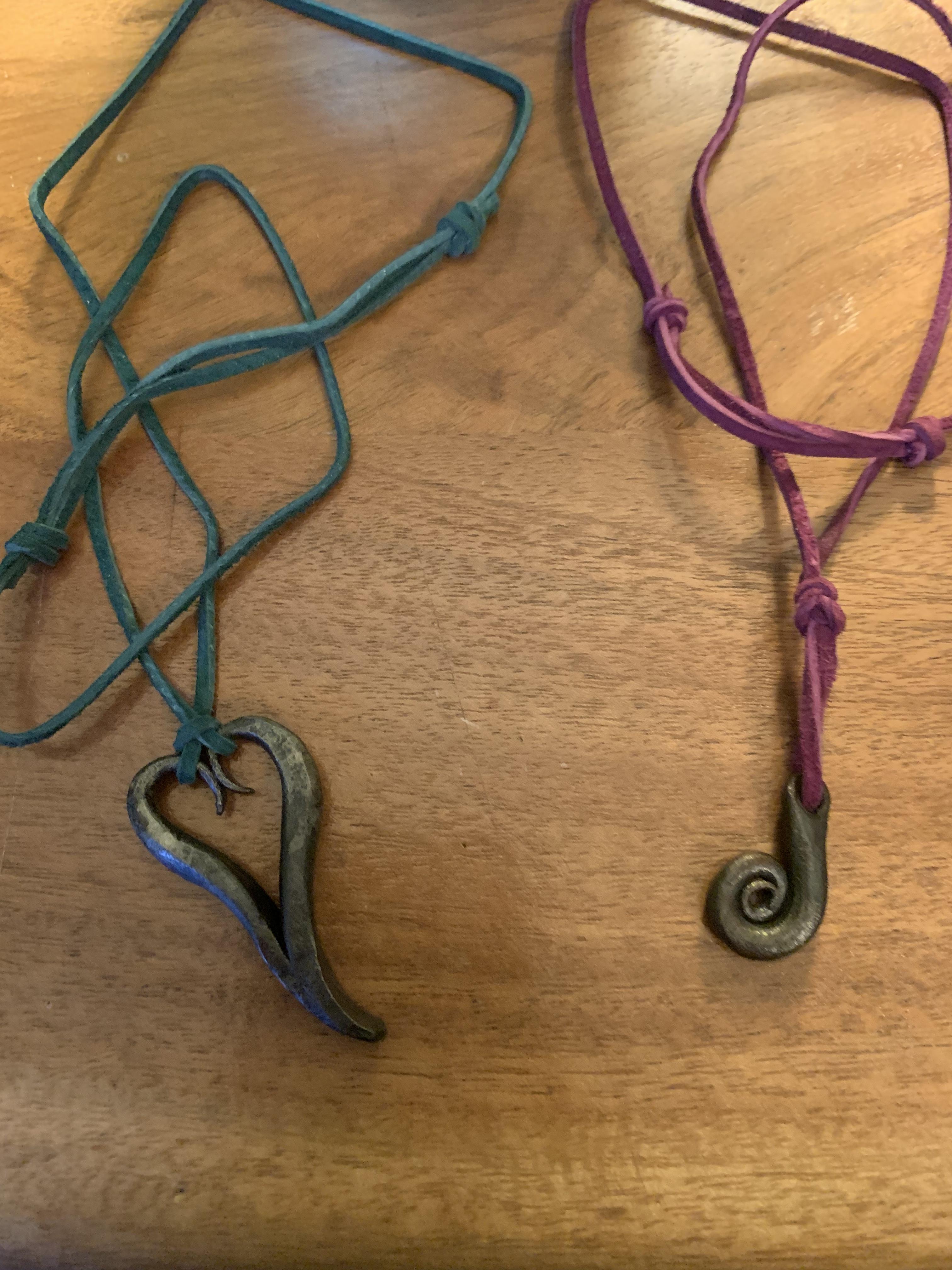

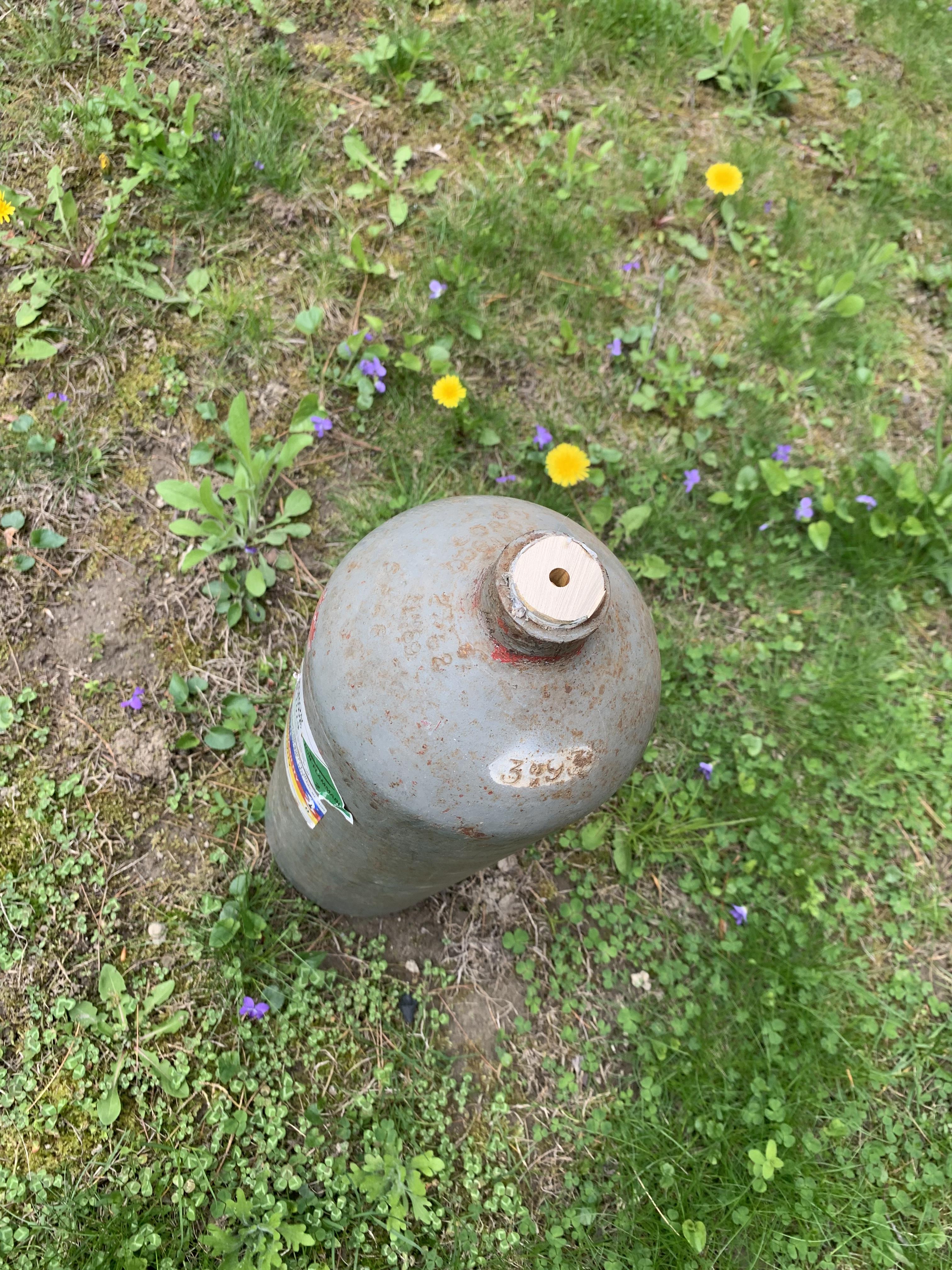

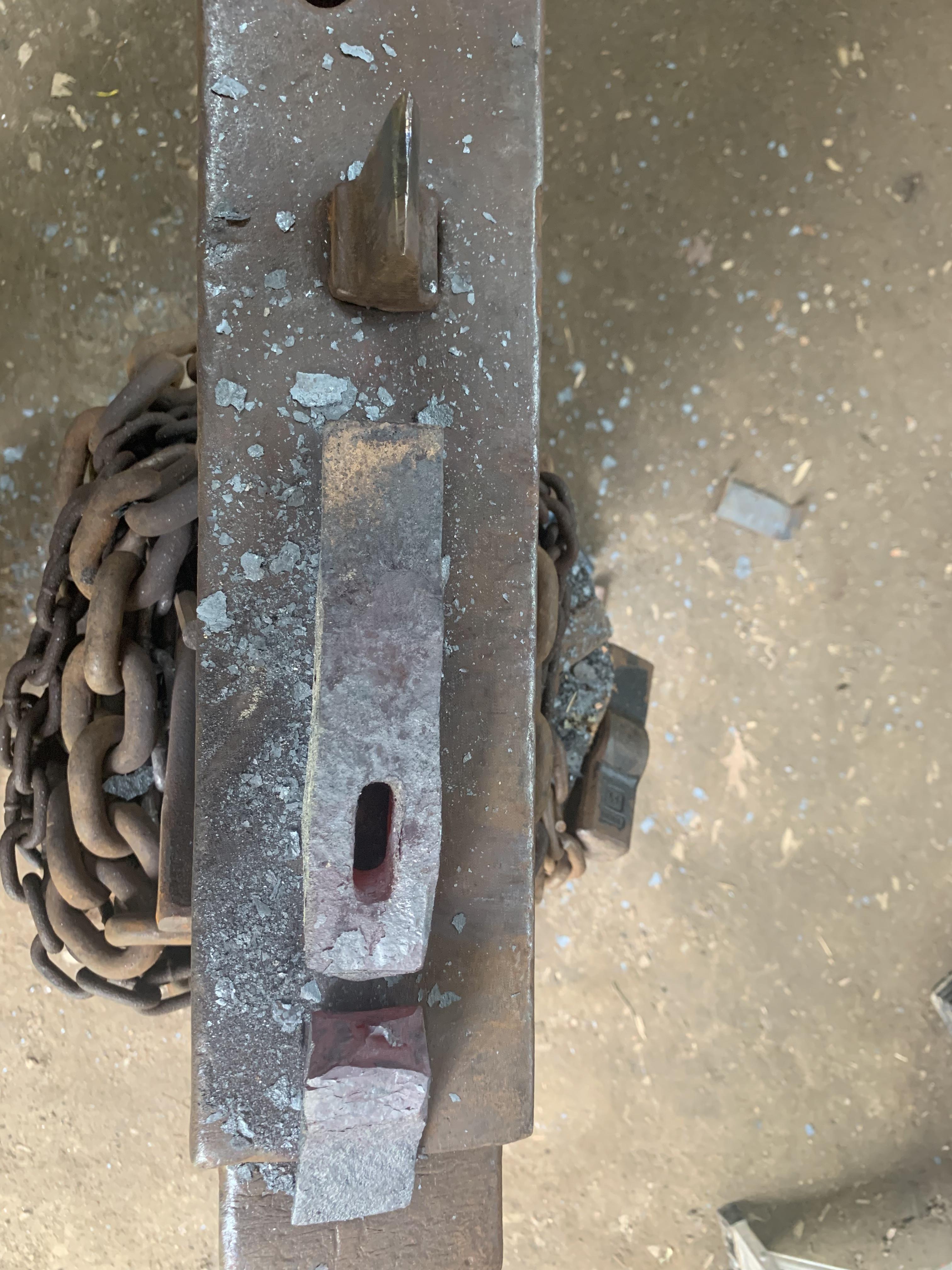

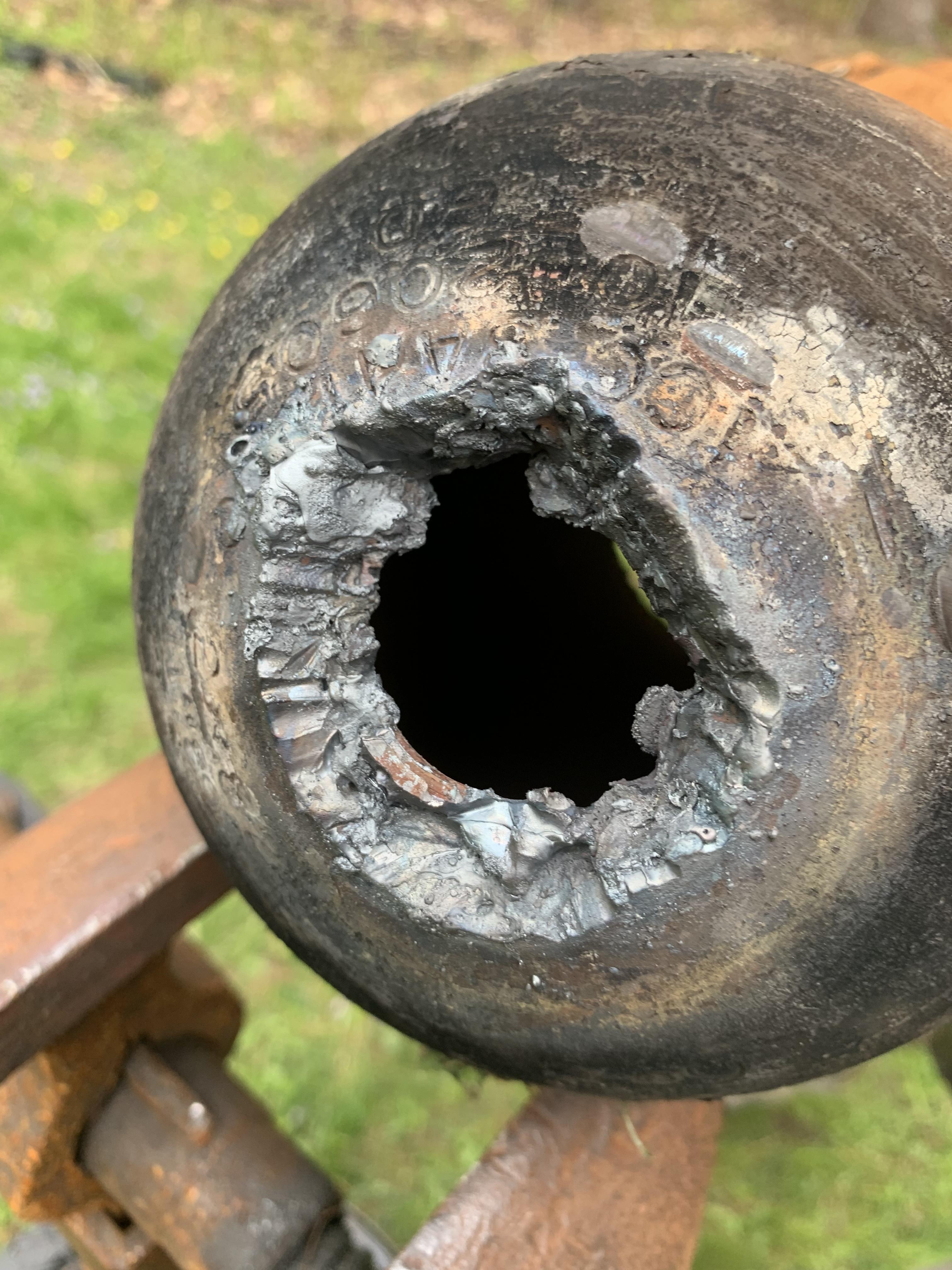

Owen Hinsman Posted May 9, 2021 Share Posted May 9, 2021 I made my mom a little heart pendant (seen here next to another kind I make) for Mother’s Day. I also hot-cut an old mill pick (I think) so that I could turn it into a handled hot cut. Then my dad wanted to turn an old CO2 tank into a bell, so we cut the top off with a portaband and then torch cut the bottom and neck. I also tried to burn, or lance, out the brass left inside the neck, but it didn’t act like steel at all. It would just melt a little, and then spit a chunk off. I check my torch settings and I was running 5 psi acetylene, 20 psi oxygen, and then I went and lopped through an 1 1/4” tie rod, which went easily. Can you cut brass with a torch? Quote Link to comment Share on other sites More sharing options...
Frosty Posted May 9, 2021 Share Posted May 9, 2021 1 hour ago, Owen Hinsman said: I also tried to burn, or lance, out the brass left inside the neck, but it didn’t act like steel at all. Oh MY WHAT A SHOCK, brass not acting like steel! Quick Owen, announce this discovery the world soonest! Thanks for the great straight line, you've made my morning. Kidding aside, you aren't the first person to discover this the hard way. An oxy fuel torch only works if the metal being cut has a higher combustion temp than the melting temp of it's oxides. The torch flames only preheat the steel to a point the oxy jet can ignite it. The oxy jet is literally BURNING steel to produce the necessary heat to make the cut. There was a really neat demo put on by the factory rep from Victor where his torch has a thumb valve that turned the preheat flame off and he finished the cuts with just the oxy jet. No, metals OTHER than STEEL don't cut with an oxy fuel torch heck many steel alloys won't. You CAN use electric arc gouging rod on most metals but be prepared for the excitement, especially if you aim it INTO a closed container. Drill it then use a keyhole saw and take it out in sections. IF you didn't leave enough to get a pipe wrench on it. a CO2 tank will be right handed threads, Flammable gas tanks have Left handed threads. Welcome to the club Owen. Frosty The Lucky. Quote Link to comment Share on other sites More sharing options...
Owen Hinsman Posted May 9, 2021 Share Posted May 9, 2021 1 hour ago, Frosty said: Oh MY WHAT A SHOCK I wasn’t really surprised, but I thought that I could at least melt the brass out. You live you learn. Also, thanks for the explanation of HOW the torch cutting worked. I always figured it was just melting the steel away, not actually burning it and then using the heat from burning to continue cutting. Makes more sense now. It made one heck of a ringing noise when I was cutting. Probably a good thing, cause I’m making a bell out of it. Quote Link to comment Share on other sites More sharing options...

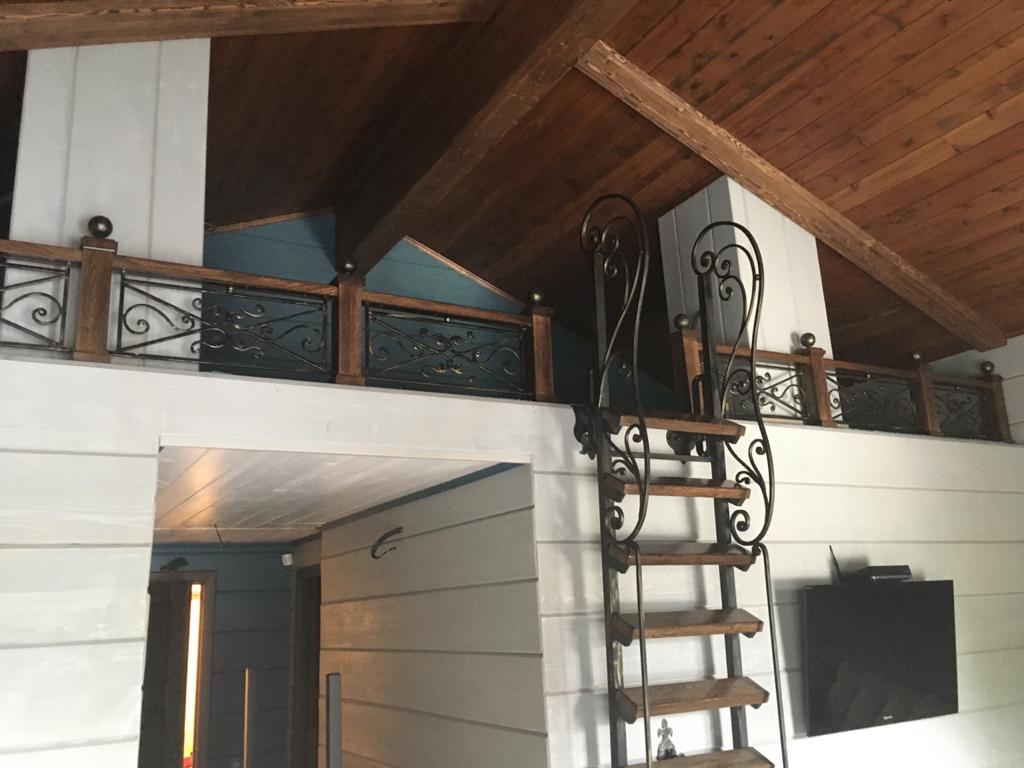

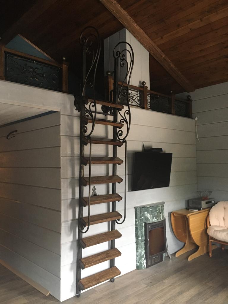

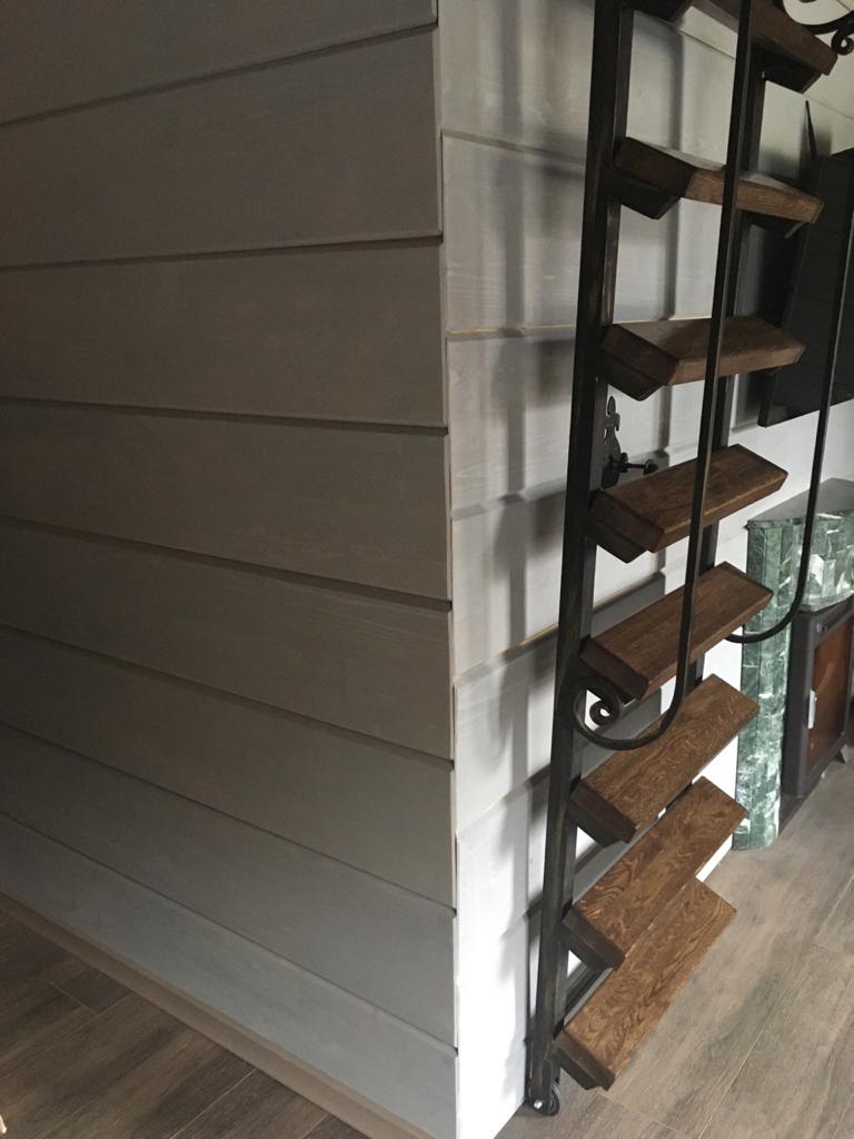

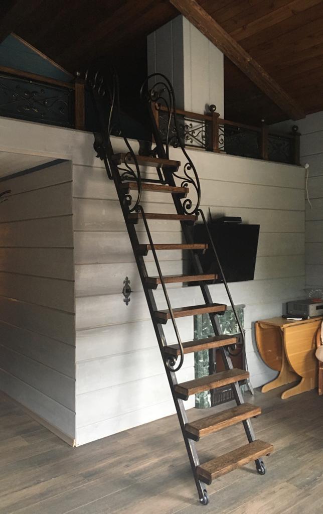

alexandr Posted May 9, 2021 Share Posted May 9, 2021 Another completed work. Retractable staircase. The first time I did this. Quote Link to comment Share on other sites More sharing options...
JHCC Posted May 10, 2021 Share Posted May 10, 2021 Very nice; both aesthetic and practical. Quote Link to comment Share on other sites More sharing options...
bluerooster Posted May 10, 2021 Share Posted May 10, 2021 Rule of thumb; "If it doesn't rust, a torch won't cut it". Quote Link to comment Share on other sites More sharing options...
JHCC Posted May 10, 2021 Share Posted May 10, 2021 Does that apply to stainless steel? Quote Link to comment Share on other sites More sharing options...
Irondragon Forge ClayWorks Posted May 10, 2021 Share Posted May 10, 2021 Don't know about a torch but the plasma cutter zips right through stainless steel. Quote Link to comment Share on other sites More sharing options...
Frosty Posted May 10, 2021 Share Posted May 10, 2021 That's pretty cool staircase Alexandr. How solid does it feel to climb? John: Rusting is combustion and even it SS will rust chromium oxide has a much higher melting point than it has combustion temp, SS won't oxy fuel torch cut. Rust is just a first look evaluation rule. Rust means maybe, cast iron rusts but doesn't oxy fuel torch cut. A plasma cutter and oxy fuel compare about like apples and squid. Plasma cutters cut conductors. No combustion involved in the process. In your cuffs or socks maybe. Frosty The Lucky. Quote Link to comment Share on other sites More sharing options...
ThomasPowers Posted May 10, 2021 Share Posted May 10, 2021 I remove the valve stems on EMPTY tanks using a large pipe wrench and a large open end wrench and cheaters on both Helps to have a friend to stand on one of the cheaters. I had a bucket of tank valves, 21 pounds worth, that I took to the scrapyard Saturday; US$13+ paid for what I took out and still had money coming with me. Much easier than trying to remove the brass plug in the neck of a tank! Today was more cleaning and sorting out another load of copper and brass to go to the scrapyard. I'm turning loose of some stuff I realize I will probably never need; but could really use the space in the shop. 52100 can be brittle for impact uses; I'd use a truck axle and trade 52100 to knifemakers! Calling the electrician tomorrow to check status. Quote Link to comment Share on other sites More sharing options...
