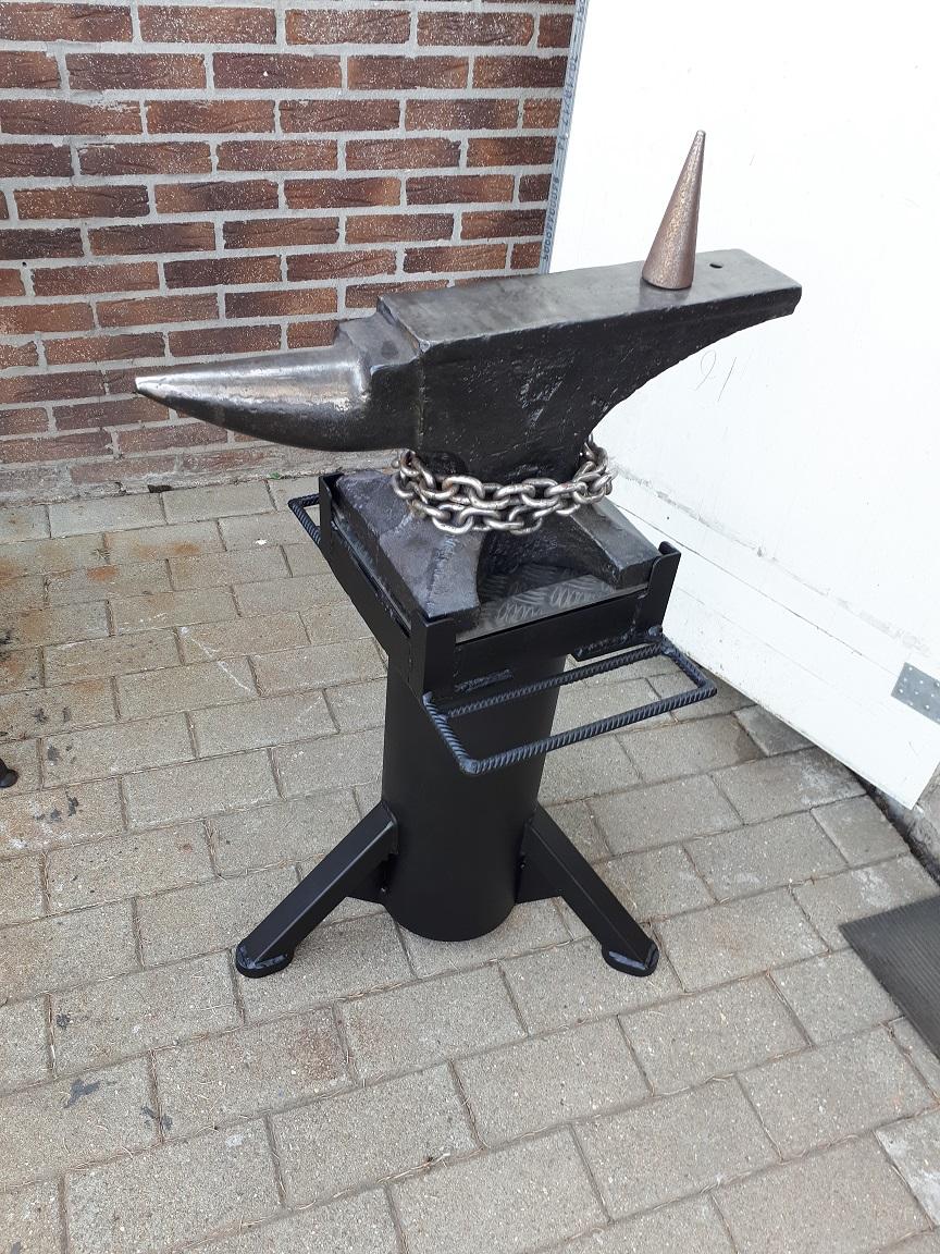

jlpservicesinc Posted May 10, 2020 Share Posted May 10, 2020 Hans Nice work.. I am intrigued by your new stand.. Well designed. Did you put a foot for the center section to hit the ground or will you shim it? JHCC.. OOOOHHHH I"m so excited.. I made a little progress me self in the Ax department. Quote Link to comment Share on other sites More sharing options...

Hans Richter Posted May 10, 2020 Share Posted May 10, 2020 13 hours ago, jlpservicesinc said: I am intrigued by your new stand.. Well designed. Did you put a foot for the center section to hit the ground or will you shim it? Hi Jennifer, in this case end because of the small size, I put the anvil base in the centre of the stand. Try to make sure that the stand legs and their radius are the same as the ‘staking out parts’ of the anvil (this take care of stability without stumbling over the legs). Pushed and beat on them (horn and heel) as well (while stack welded) to see if hi will react instable. No way, and I can use pritchel hole and hardy hole to stick long material in them. Count the weight of the whole stand around 50lbs. Gives still a good rebound of ca. 85%. Silenced the 'crying little baby' with a rubber plate below the base, and a double twist op 1 ¼ “ anchor chain. Will use this anvil together with the UAT to give some workshops to students and public, both are ‘light’ enough to carry in the trailer or car trunk together with the already known field forges. Carry on with the very promising axes , I soon have to make some scout knifes for the kids of a friend of me how already paid me with al delicious ‘French whiskey’ (empty now after Covid) an looks forward to the products. Quote Link to comment Share on other sites More sharing options...

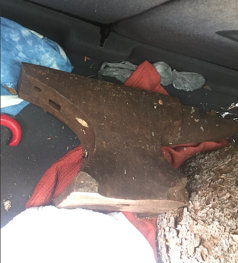

Awrksmokey Posted May 10, 2020 Share Posted May 10, 2020 I bought an anvil!!! It's in good condition other then the chip in the foot. It's 157 lbs and looks like a peter wright to me but it doesn't have a makers stamp. I might make an identification post if I still cant figure it out after some more research. Quote Link to comment Share on other sites More sharing options...
jlpservicesinc Posted May 10, 2020 Share Posted May 10, 2020 thanks Hans.. Looks great.. Awrksmokey: Nice find.. Gongrats for sure. Looks like you got a stump with it.. Quote Link to comment Share on other sites More sharing options...

Awrksmokey Posted May 10, 2020 Share Posted May 10, 2020 2 hours ago, jlpservicesinc said: Awrksmokey: Nice find.. Gongrats for sure. Looks like you got a stump with it.. Yeah, the guy was nice enough to give me a spruce stump for it too. He was a woodworker, and apparently it was from the site of a church he built! DSW, that is a cool funky hammer! Is there a certain reason why it's shaped like that? Quote Link to comment Share on other sites More sharing options...

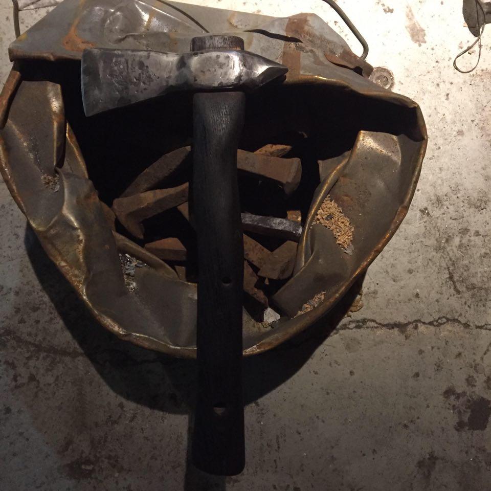

CheechWizard Posted May 11, 2020 Share Posted May 11, 2020 finally finished the hawk, the first couple inches to just over critical. quenched in heated veggie oil, turned off forged, wire brushed and sanded lightly the first 2 or so inches and used the forge to relieve some hardness, ended up at a nice medium brown on the cutting edge broken sledge handle i repurposed wasnt quite wide enough so theres a little gap on the tapered side, need invest in some wider stock. so... can i get some honest opinions? with the welding issues aside aesthetically wise lay it on me. to me the drift is made for more your classic hand axe style hatchet then a hawk. but idk what do yall think Quote Link to comment Share on other sites More sharing options...
Latticino Posted May 11, 2020 Share Posted May 11, 2020 First I'd like to say that I wish my first real solo forged hawk looked as good as yours. That being said, I agree that the eye shape is more characteristic of a typical single bit axe than a hawk (even though there are a lot of eye shape variations for hawks, including pointed D shape, egg shape, diamond shape, round...). Aesthetically I would say that the cheeks and body of the piece are more on the order of a small belt axe rather than a hawk. Possibly because the eye is so narrow, but it does appear that the cheeks and body are a little thick visually. As for the spike/skull breaker... well it looks like you haven't made up your mind how you want that to look. If a spike, I'd like to see it drawn out further. If a hammer poll (a very useful addition IMHO) it would need to be reshaped. Still, all in all a great first effort. For myself, this weekend I worked on a project for a friend that was a little unusual, or at least out of my wheelhouse. He needed a replacement for his adjustable scythe handles. Fortunately he is a woodworker and will be doing that part of the project. I made them a little extra robust so he can file them down to fit as required. Quote Link to comment Share on other sites More sharing options...
