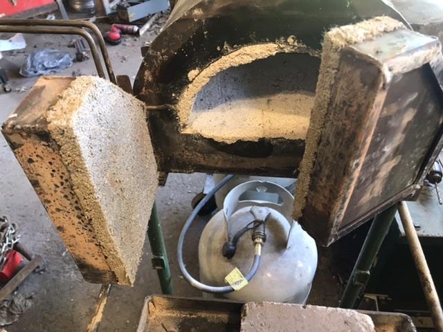

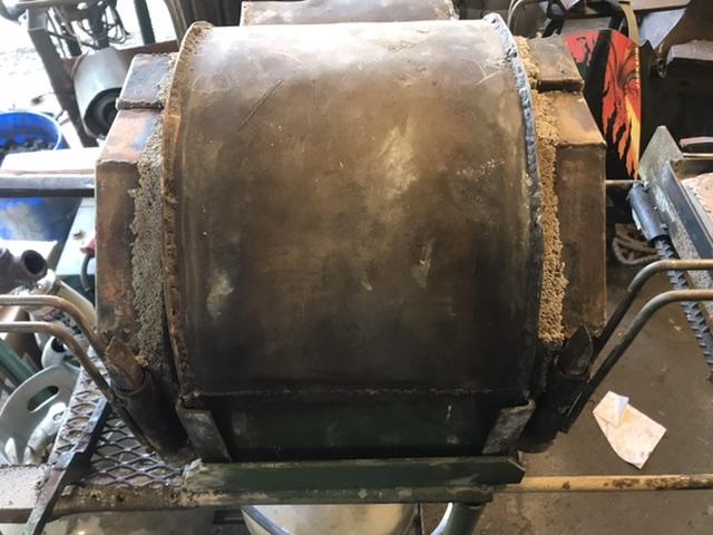

JHCC Posted May 13, 2020 Share Posted May 13, 2020 Unmolded and mounted the doors. Took the sides off the ribbon burner mold as well, but I decided to let it cure a while longer before trying to pull out the skewers. Back in the bag for another day or two. Quote Link to comment Share on other sites More sharing options...
Rojo Pedro Posted May 14, 2020 Share Posted May 14, 2020 Super cool forge JHCC. Look forward to seeing it running. I need to start thinking of a new forge and there is a lot of inspiration here Quote Link to comment Share on other sites More sharing options...
jlpservicesinc Posted May 14, 2020 Share Posted May 14, 2020 that is a great looking forge.. Can't wait to see it in action.. Will you have a smaller opening door? Or will you just leave the door kinda ajar? Quote Link to comment Share on other sites More sharing options...

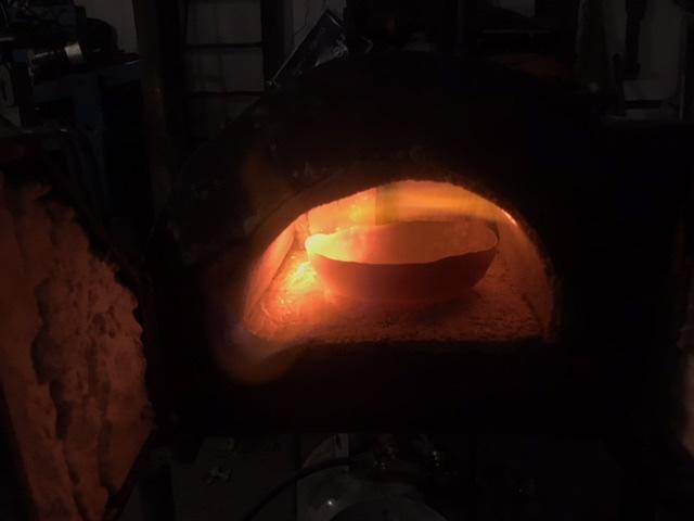

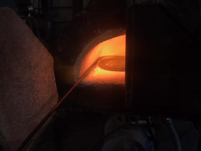

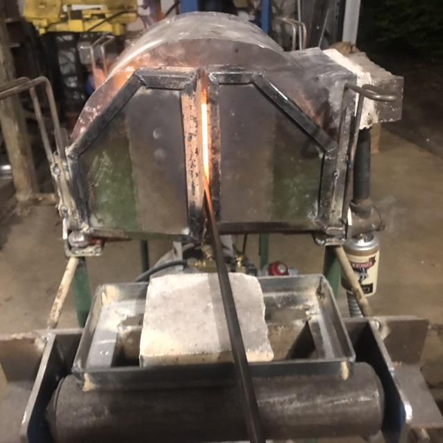

JHCC Posted May 14, 2020 Share Posted May 14, 2020 I fired it up last weekend to cure the Kastolite in the main body of the forge. Low power for the most part, so it never got up to full forging heat. There was enough of a hot spot to do some work on a bowl: This is from before the lining went on the doors, and you can see how much flame is escaping around the edges. I'm curious to see it there's going to be a problem with backpressure, now that that gap is largely closed. 54 minutes ago, jlpservicesinc said: Will you have a smaller opening door? Or will you just leave the door kinda ajar? I designed this forge primarily for short, wide pieces, like the bowl in the photo above. I still have my other gasser for longer, narrower pieces, so I've got a lot of flexibility (at least, I will once I reline the old one; it was my first go at Kastolite and is currently falling apart). The new one has built-in stops on the hinges at fully closed, half open, and fully open, but there's enough slop that I've been able to crack the opening enough to sneak in a long, thin piece (although this was before I added the Kastolite to the doors, so that gap may no longer exist. I just had an idea to make a block of Kastolite that would fit inside the forge and cover half of the opening, but with a cutout in the lower corner for longer stock. That way, I could work thinner pieces without losing too much heat out of the door. It would be pretty easy to make the mold, and I'm getting pretty good at mixing and casting the refractory. Hmmmm..... Quote Link to comment Share on other sites More sharing options...
Rojo Pedro Posted May 14, 2020 Share Posted May 14, 2020 The notch is a good idea. I use a kastolite block as a sliding front door and now wish it had that feature Quote Link to comment Share on other sites More sharing options...

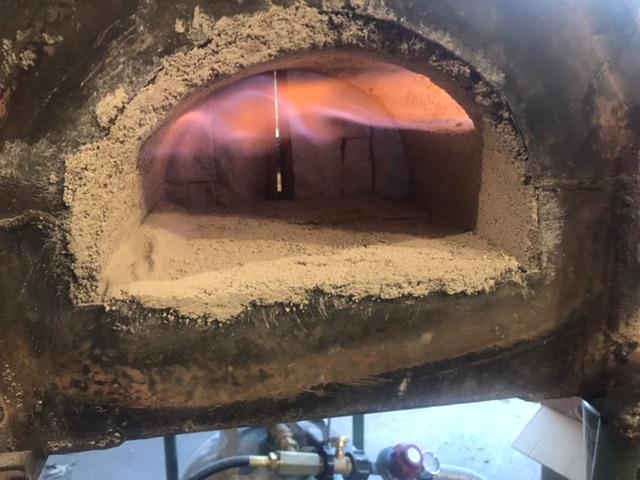

JHCC Posted May 15, 2020 Share Posted May 15, 2020 Unmolded and test-fired the new ribbon burner. Quote Link to comment Share on other sites More sharing options...

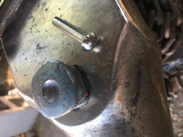

Rojo Pedro Posted May 16, 2020 Share Posted May 16, 2020 Got a few hours in today. Love the longer days made a rivet setting hardy from a pavement breaker chunk and some curtain rod hangers for Bonnies she-shed. Lots of fun !! Quote Link to comment Share on other sites More sharing options...

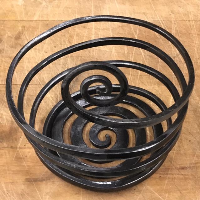

JHCC Posted May 16, 2020 Share Posted May 16, 2020 Put the old ribbon burner back in the new forge, fired it up, and made a knitting bowl for my cousin. Quote Link to comment Share on other sites More sharing options...

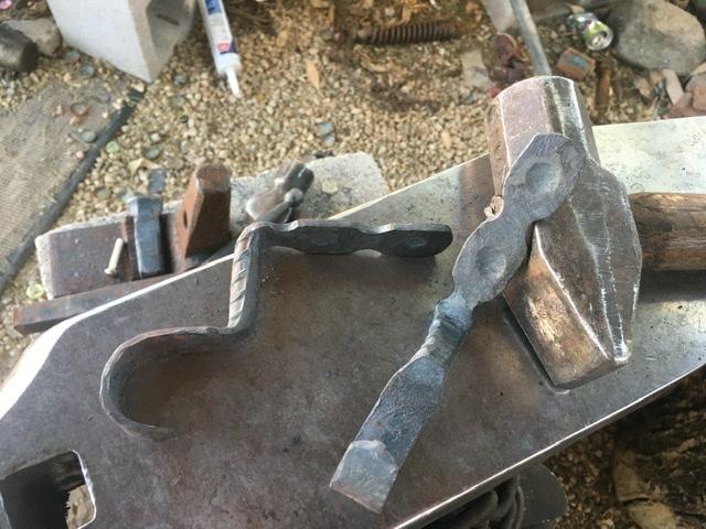

KYCATS Posted May 16, 2020 Share Posted May 16, 2020 Love the knitting bowl JHCC. How much stock did it take to make that. I finally got around to trying a horse head opener. Fairly satisfied with my first attempt. Quote Link to comment Share on other sites More sharing options...

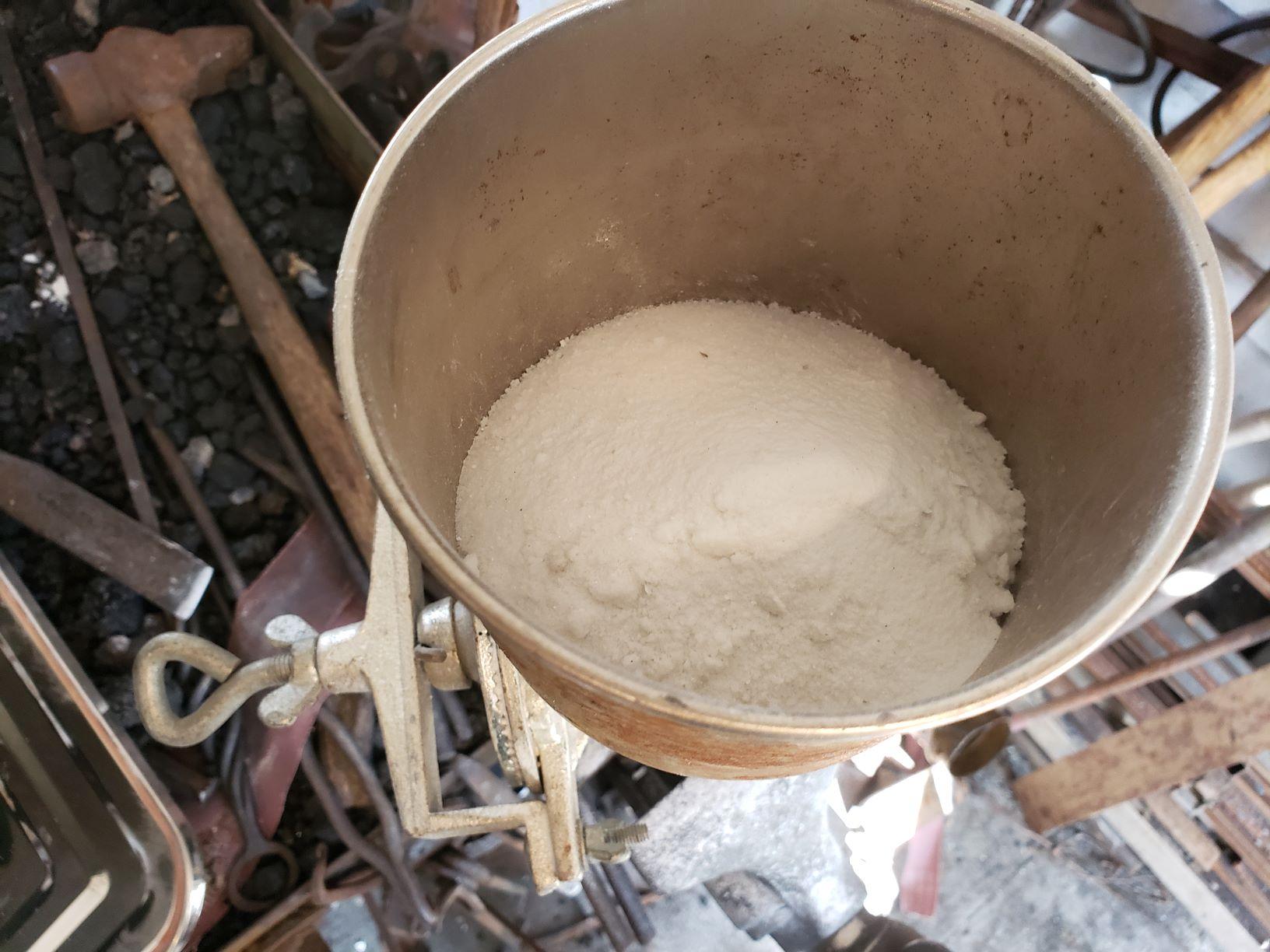

jlpservicesinc Posted May 16, 2020 Share Posted May 16, 2020 Nice work IFC, Rojo Pedro that should work nicely. JHCC love the yarn bowl.. Looks like you have them figured out nicely now.. Very clean. Kycats nice and clean.. Me, I cleaned up the last of the original borax I had from 1986.. I was given 80lbs and it lasted this long. I've used more borax in the last 4 years then the 30 before it.. This 5 gallon bucket was full 3 years ago. Quote Link to comment Share on other sites More sharing options...

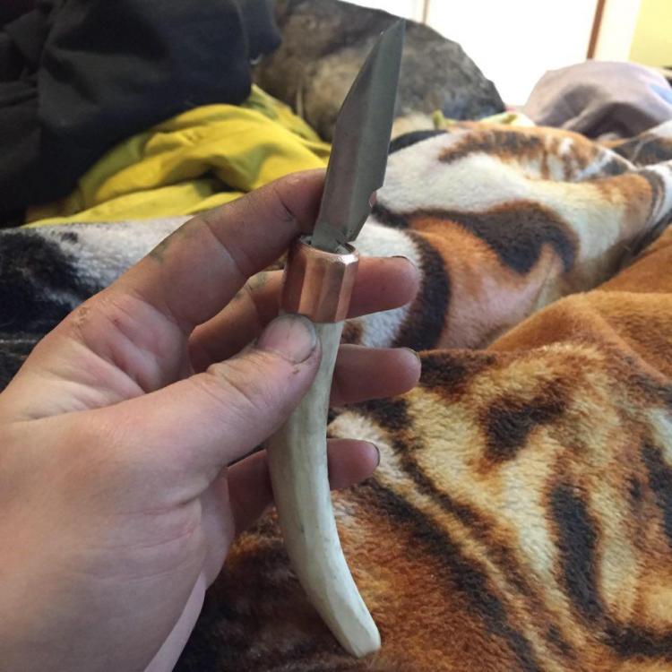

CheechWizard Posted May 18, 2020 Share Posted May 18, 2020 coil spring widdler, i was gonna do a traditional wooden carving knife handle but this little antler guy came together pretty effortlessly, the antler is dense down to the core so no problems there. also discovered you can get a cool surface pattern on the right copper with a wire wheel, kinda a wrinkley flowy type business Quote Link to comment Share on other sites More sharing options...
