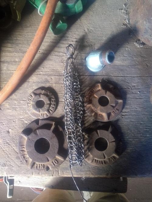

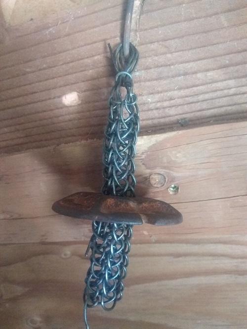

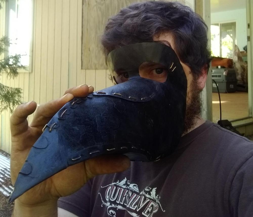

Shabumi Posted May 23, 2020 Share Posted May 23, 2020 Got the mask all put together, its not as flexible as the paper version so it doesn't fit as well, but not too bad for a first try at a mask, eh? There's a lot i'd do differently next time, like start collaring from the tip vs the opening, as well as changes to the template to make it easier to work in metal, but I'm proud of the effort i put in and the result that came out. Also tried out the viking weave in what passes for bailing wire these days to see how it would come out. I like how it went from a not so nice looking weave to halfway decent just by drawing it through the draw plates. Also shown are my draw plates and my sophisticated drawing method of hanging the chain from a nail in an overhead beam and using my whole body weight to draw it through. Went from 6 inches of ~1 inch round to 11 inches of 1/2 inch round. I want to see how it will look if i draw it through smaller holes at forging heat. Quote Link to comment Share on other sites More sharing options...

George N. M. Posted May 23, 2020 Share Posted May 23, 2020 Shambui: Now, you have to stuff the beak full of fragrant herbs to combat the infectious smells and miasmas. Cannon Cocker: Very nice idea but if I make a suggestion: Perhaps something of more visual interest on the sides, maybe a twist or something. The curled tails are cool but hidden under the napkins. "By hammer and hand all arts do stand." Quote Link to comment Share on other sites More sharing options...

Shabumi Posted May 23, 2020 Share Posted May 23, 2020 10 hours ago, George N. M. said: Now, you have to stuff the beak full of fragrant herbs That's the plan, though which herbs to use? I have some sage smudges drying, as well as as much fresh chocolate mint, rosemary, thyme, catsmint, horehound, mullein, lemonbalm, fennel and feverfew as I'd want. The lavender hasn't started blooming yet, but I can add that when it is. Also coming soon will be dill weed, oregano, basil, fresh coriander and chives. That doesn't count all the non fragrant herbs available to me. I had read in an old Italian manuscript (I think it had medico or medici in the title) that the "hot" herbs shouldn't be used, and mint was listed as "hot", but I can't seem to find it again to double check. I can't remember if it mentioned if dried or fresh herbs were used or if you stuff the beak with loose threshs or use a satchel. I am fudging on the details I did remember, like I should have used Heather oil to permeate the mask, but I don't think the Heather I know would let me press her for oil so I used BLO instead. I wish I could find the manuscript again, it was an interesting read. It also had a preventative for the plague that was made with mercury, cobalt and liver of sulphur mixed with herbs into a paste and added to your morning tea Quote Link to comment Share on other sites More sharing options...

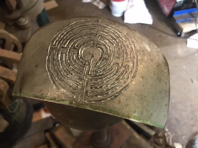

JHCC Posted May 24, 2020 Share Posted May 24, 2020 Trying out some cold work, chasing a design into some 16 ga. sheet. Quote Link to comment Share on other sites More sharing options...
CheechWizard Posted May 24, 2020 Share Posted May 24, 2020 not bad for such a complex design. hard to get the rhythm down innit? Quote Link to comment Share on other sites More sharing options...
JHCC Posted May 25, 2020 Share Posted May 25, 2020 The worst part was how much the workpiece bounced around. I’m starting to understand the concept of the pitch bowl. We’ll see how it looks once I’ve gone over the lines again and cleaned up the corners. Quote Link to comment Share on other sites More sharing options...

JHCC Posted May 25, 2020 Share Posted May 25, 2020 34 minutes ago, Forgingforfun said: Jhcc nice work , braclet? Show your tooling and share your angle of attack. Is that mild steel? It’s ultimately going to be a belt buckle, but I’m keeping it as part of its parent stock for now. Here are my two primary tools, both ground from small cold chisels. The one on the left has a rounded edge for working curved lines, and the one on the right is for getting into corners. I’m holding the tools basically perpendicular to the face of the stock, but sometimes angling slightly to nudge the line a bit one way out the other. (The workpiece is being supported here by my big ball stake. Yes, it’s mild steel: scrap left over from building the shell of my forge. Before that, it was part of a flow rack in a factory somewhere.) Quote Link to comment Share on other sites More sharing options...
Forgingforfun Posted May 25, 2020 Share Posted May 25, 2020 Thank you! So more of depression vs cutting I take? Thought may be braclet with curved ends, must take alot of patience, it looks professional! Do you draw pattern to depress /chase or just go to it? Quote Link to comment Share on other sites More sharing options...
JHCC Posted May 25, 2020 Share Posted May 25, 2020 It’s another thing to learn, which is always fun. I drew a grid with compass and ruler, freehanded some guide lines for where I wanted the pattern to be, and then did the rest by eye. I didn’t take enough trouble over the guide lines, and that caused some problems later on. Quote Link to comment Share on other sites More sharing options...
